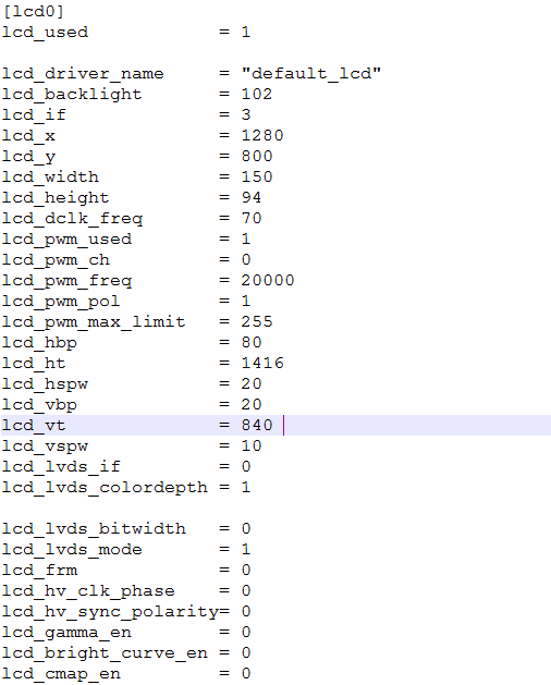

我的显示屏设备树参数如下(之前在Android7配置是可以用的)
问题:

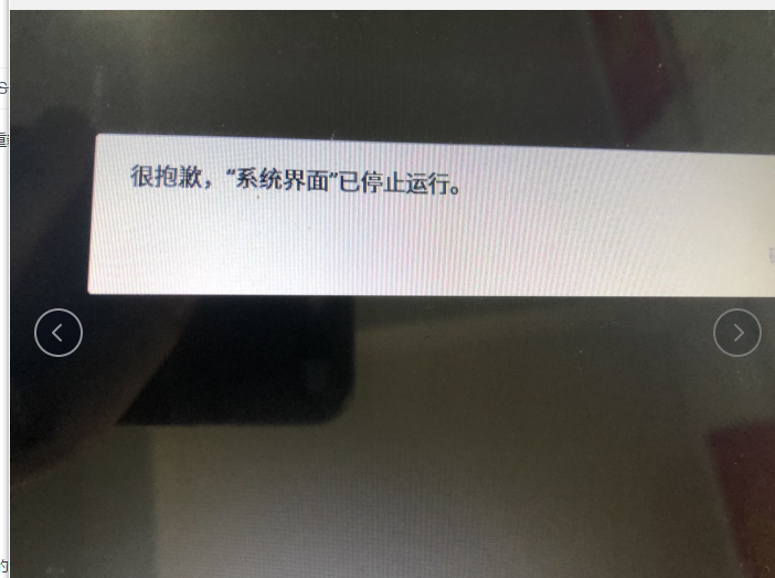

开机完成之后提示“抱歉 系统界面停止运行”如下图。希望看到的大哥可以指点一下,是不是我漏该了那些参数导致其的UI桌面没有办法正确地显示出
来。并且有一个奇异的现象就是当多次几点10次左右安卓界面居然可以显示了。真是奇哉怪哉。
处理:由于给系统给那个朋友之前使用的VGA800*400的显示屏,拿过来之后我出来做以上的设备树(sys_config.fex)文件的参数修改
并且修改了build.prop文件下面的两个数据,并且在ADB下面确认到是正确地设置进去的。但是这个问题还是没有解决。
(移植Android6时候是想用其CSI摄像头,要是有大佬发现摄像头这块又什么错误的也可以帮忙指点一下。谢谢)
ro.sf.lcd_density
PRODUCT_AAPT_PREF_CONFIG := xhdpi
在这里感谢各位大佬的帮忙了 ,谢谢
下面是开机串口打印出来的信息:节选: (这个ion重复多次地出现可能没有重点,我将文件都上传上来了)
[ 100.216217] init: Service 'bootanim' (pid 1960) exited with status 0
[ 100.224501] init: Starting service 'nand_trim'...
[ 100.275134] init: Service 'nand_trim' is being killed...
[ 100.286652] init: Service 'nand_trim' (pid 6806) killed by signal 9
[ 100.294466] init: Service 'nand_trim' (pid 6806) killing any children in process grou
[ 377.934924] sunxi-ion ion.4: Fail to allocate buffer
[ 377.943592] sunxi-ion ion.4: Fail to allocate buffer
[ 377.952551] sunxi-ion ion.4: Fail to allocate buffer
[ 379.326930] binder: 3221:3221 transaction failed 29189, size 92-0
[ 379.334598] binder: 3221:3221 transaction failed 29189, size 92-0
[ 379.342346] binder: 3221:3221 transaction failed 29189, size 92-0
[ 379.349541] binder: 3221:3221 transaction failed 29189, size 92-0
[ 379.375195] sunxi-ion ion.4: Fail to allocate buffer
[ 379.381337] sunxi-ion ion.4: Fail to allocate buffer
[ 439.080310] sunxi-ion ion.4: Fail to allocate buffer
[ 439.087750] sunxi-ion ion.4: Fail to allocate buffer
(全部打印信息在文章的最后,adblog就不发出来了 是在是太大了)
这里面是通过adb获取回来的log信息。节选查看到有关于systemUI这块的信息
01-01 11:39:06.167 1742 4830 E ion : ioctl c0144900 failed with code -1: Operation not permitted
01-01 11:39:06.167 1742 4830 E [Gralloc-ERROR]: int aw_ion_alloc(int*, size_t, size_t, unsigned int, unsigned int,
ion_user_handle_t*, int):144 int aw_ion_alloc(int*, size_t, size_t, unsigned int, unsigned int,
ion_user_handle_t*, int)(line:144)Failed to ion_alloc from ion_client:18 via heap type
DMA/CARVEOUT(mask:0x00000014) for 4096000 Bytes uncached buffer, err = 1, usage =
0x00000f02
01-01 11:39:06.173 1742 4830 E ion : ioctl c0144900 failed with code -1: Operation not permitted
01-01 11:39:06.173 1742 4830 E [Gralloc-ERROR]: int aw_ion_alloc(int*, size_t, size_t, unsigned int, unsigned int,
to ion_alloc from ion_client:18 via heap type DMA/CARVEOUT(mask:0x00000014) for 4096000 Bytes
uncached buffer, err = 1, usage = 0x00000f02
01-01 11:39:06.173 1742 4830 W GraphicBufferAllocator: alloc(1280, 800, 1, 00000f02, ...) failed -1 (Operation not permitted)
01-01 11:39:06.173 1742 4830 E: GraphicBufferAlloc::createGraphicBuffer(w=1280, h=800) failed (Operation not permitted), handle=0x0
01-01 11:39:06.173 1742 4830 E BufferQueueProducer: [StatusBar] dequeueBuffer: createGraphicBuffer failed
01-01 11:39:06.174 10725 10841 E [EGL-ERROR]: void __egl_platform_dequeue_buffer(egl_surface*):1691: failed to dequeue buffer
from native window 0xa01b3508; err = -1, buf = 0x0,max_allowed_dequeued_buffers 3
01-01 11:39:06.174 10725 10841 E libEGL : eglMakeCurrent:800 error 3003 (EGL_BAD_ALLOC)
01-01 11:39:06.174 10725 10841 W OpenGLRenderer: Failed to make current on surface 0xa01a6f00, error=EGL_BAD_ALLOC
01-01 11:39:06.196 10725 10725 D PhoneStatusBar: disable: < expand ICONS alerts SYSTEM_INFO back HOME* RECENT* clock
SEARCH* quick_settings >
并且在adb打印回来的几个log中发现了几个错误:
JniInvocation: Falling back from libart to libart.so after dlopen error: dlopen failed: library "libart" not found

最近编辑记录 2505300733 (2019-11-05 15:46:57)
有没有大哥 有空可以看一眼,帮忙定位一下问题啊
屏幕能显示,感觉硬件和驱动都没问题了。感觉是其他问题。
这个问题解决了,是ION内存没有分配够,所以开机一直提示和屏幕卡顿。 感谢关注
原来如此, 感谢分享!
具体的方法如下:
对应的设备树文件下 sun8ixxxx_pinctrl.dtsi 文件下,将CMA的内存(默认128M)分配到256M或者380M(手册说最大内存不能超过)。
在sun8ixxxx.dtsi 文件里面,将ion的内存模块协商,并且分配对应的内存上去。添加/memreserve/ 指定内存始地址和size
一步步排查到这个位置用时2天。累死人啊,只怪自己渣渣给大家参考下,避免跳坑
