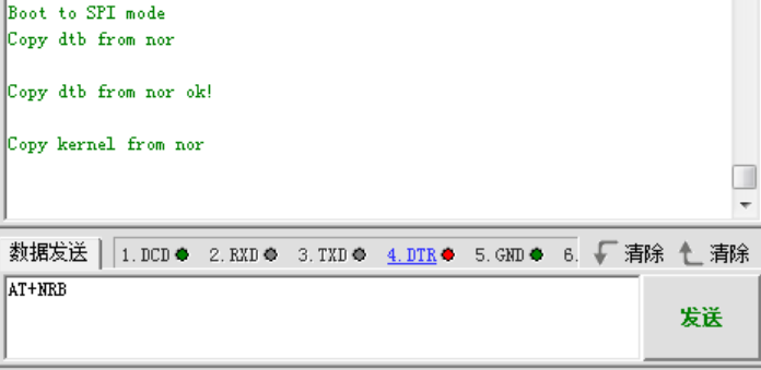

达克罗德大神的裸奔代码正好可以用上,在这个基础上加上引导代码即可。现在的问题是copy内核到sdram出现问题,卡在了拷贝内核到sdram的过程。如下:
引导代码:
#include <stdint.h>
#include <stdio.h>
#include <string.h>
extern void sys_uart_putc(char c);
extern void sys_uart_print(char *str);
extern void sys_spi_flash_init(void);
extern void sys_spi_flash_exit(void);
extern void sys_spi_flash_read(int addr, void * buf, int count);
static inline void sdelay(int loops)
	__asm__ __volatile__ ("1:\n" "subs %0, %1, #1\n"
		"bne 1b":"=r" (loops):"0"(loops));
int boot_main(int argc, char **argv) {
    void (*theKernel)(int zero, int arch, unsigned int params);
    void *sdram_dtb_start = (void  *)0x80030000;
    void *sdram_kernel_start = (void  *)0x80040000;
    /* 0. 从NOR FLASH里把dtb读入内存 */
    sys_uart_print("Copy dtb from nor\n\r");
    sys_spi_flash_init();
    volatile unsigned int spi_dtb_start=0x30000;
	sys_spi_flash_read( spi_dtb_start,sdram_kernel_start, 0x10000);
	sys_uart_print("Copy dtb from nor ok!\n\r");
    /* 1. 从NOR FLASH里把内核读入内存 */
    sys_uart_print("Copy kernel from nor\n\r");
    volatile unsigned int spi_kernel_start=0x40000;
	sys_spi_flash_read(spi_kernel_start, sdram_kernel_start, 0x260000);
	sys_uart_print("Copy kernel from nor ok!\n\r");
	sys_spi_flash_exit();
    /* 2. 设置参数 ,与内核约定参数存放地址,Uboot写个内核的遗嘱^^*/
    // puts("Set boot params\n\r");
    // setup_start_tag();
    // setup_memory_tags();
    // setup_commandline_tag("noinitrd root=/dev/mtdblock3 init=/linuxrc console=ttySAC0");
    // setup_end_tag();
    /* 3. 跳转执行 */
    sys_uart_print("Boot kernel\n\r");
    theKernel = (void (*)(int, int, unsigned int))0x80040000;
    theKernel(0, 0, 0x80030000);  //362:arm
     *  mov r0, #0
     *  ldr r1, =362
     *  ldr r2, =0x30000100
     *  mov pc, #0x30008000
    sys_uart_print("Error!\n\r");
    /* 如果一切正常, 不会执行到这里 */
问题现象:
楼主 #2 2020-07-04 13:33:38
已发帖子: 846
积分: 722
Re: 修改韦东山的简易bootloader遇到问题
取sdram地址搞错了,改成如下:
volatile unsigned int *sdram_dtb_start = (volatile unsigned int *)0x80030000;
    volatile unsigned int *sdram_kernel_start = (volatile unsigned int *)0x80040000;
    // void *sdram_dtb_start = (void  *)0x80030000;
    // void *sdram_kernel_start = (void  *)0x80040000;
启动kernel还有问题,继续。。。

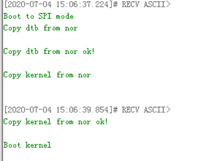

#3 2020-07-04 13:51:10
youge
注册时间: 2020-04-24
积分: 3.5
这句打印出来了没
楼主 #4 2020-07-04 15:12:54
已发帖子: 846
积分: 722
youge 说:
这句打印出来了没
打印了

现在有个疑问:使用设备树作参数引导linux的话,还需要传其他参数给linux吗?我记得uboot中还配置了如下参数:
bootargs修改
勾选 [*] Enable boot arguments;
在下方一项中填入 bootargs 参数:
console=ttyS0,115200 panic=5 rootwait root=/dev/mtdblock3 rw rootfstype=jffs2
楼主 #6 2020-07-04 15:39:44
已发帖子: 846
积分: 722
从uboot的启动日志看到,uboot对dtb文件做了处理后再放到内存的,还是要分析一下uboot的启动源码:
Loading Device Tree to 80e4c000, end 80e511c8 ... OK
#7 2020-07-04 19:38:54
zzm24
注册时间: 2018-05-07
已发帖子: 115
积分: 102
刚好之前分析过uboot,自己的bootloader成功启动过kernel,楼主参考下
1.
kernel_entry = (void (*)(int, int, u32))0x80000000;
kernel_entry(0, 0, 0x80c00000);
0x80c00000为DTB地址
2.kernel配置时 bootargs要配置为内置,这样bootloader省事多了
3.kernel dts文件加入内存信息,因为目前kernel内存参数靠uboot写dts传,这里我也是卡住了很久,直到将uboot bootz删减到最小才发现
memory_DDR0@80000000 {
    device_type = "memory";
    reg = <0x80000000 0x2000000>;
现在自己的bootloader使用spi dma读取kernel,启动速度缩短到2.xs液晶进界面
