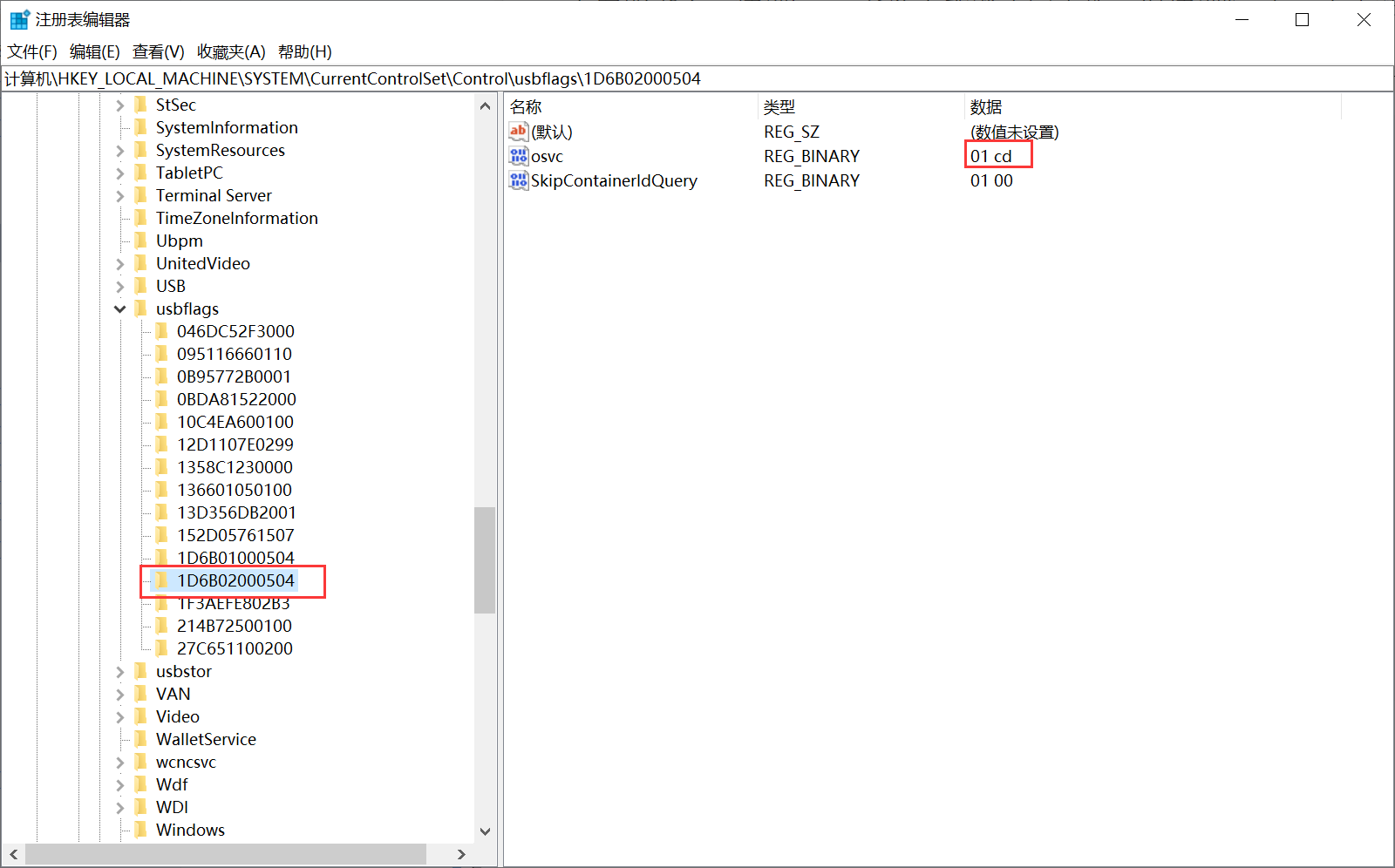

找到一份USB Gadget RNDIS支持Windows的资料,,没有完全成功
资料:USB Gadget RNDIS.pdf
根据资料的说明,我将tiny200上的/etc/init.d/S98uMTPrd的内容改成了:
start() {
    printf "Starting RNDIS: "
    mount -t configfs none /sys/kernel/config
    mkdir /sys/kernel/config/usb_gadget/g1
    cd /sys/kernel/config/usb_gadget/g1
    echo 0x1D6B > idVendor
    echo 0x0200 > idProduct
    mkdir strings/0x409
    echo "Widora" > strings/0x409/manufacturer
    echo "MangoPi R3" > strings/0x409/product
    echo "1234567890" > strings/0x409/serialnumber
    mkdir functions/rndis.usb0
    mkdir configs/c.1
    echo 120 > configs/c.1/MaxPower
    ln -s functions/rndis.usb0 configs/c.1
    mkdir configs/c.1/strings/0x409
    echo "Conf 1" > configs/c.1/strings/0x409/configuration
    ls /sys/class/udc/ > /sys/kernel/config/usb_gadget/g1/UDC
    [ $? = 0 ] && echo "OK" || echo "FAIL"
stop() {
    printf "Stopping RNDIS: "
    echo > /sys/kernel/config/usb_gadget/g1/UDC
case "$1" in
    start)
    start
    stop)
    stop
    restart|reload)
    stop
    sleep 1
    start
    echo "Usage: $0 {start|stop|restart}"
    exit 1
esac
exit $?
然后连接电脑,,在Deepin下可以正常使用这个网卡
但在Windows下不识别,,根据这个资料说需要添加一些设置,,
具体是在“ls /sys/class/udc/ > /sys/kernel/config/usb_gadget/g1/UDC”之前加入如下内容:
echo 1 > os_desc/use
echo 0xcd > os_desc/b_vendor_code
echo MSFT100 > os_desc/qw_sign
ln -s configs/c.1 os_desc
cd functions/rndis.usb0/os_desc/interface.rndis/
echo RNDIS > compatible_id
mkdir Icons
echo 2 > Icons/type
echo "%SystemRoot%/System32\shell32.dll,-233" > Icons/data
mkdir Label
echo 1 > Label/type
echo "XYZ Device" > Label/data

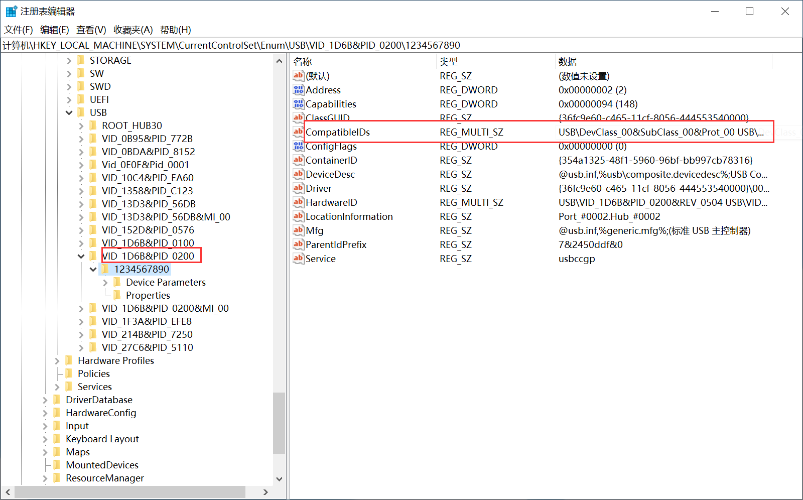

加入后,,连接电脑,,在注册表HKEY_LOCAL_MACHINE\SYSTEM\CurrentControlSet\Control\usbflags下看到这个设备的osvc变成了0x01cd,,说明设备返回了MSFT100
但是注册表HKEY_LOCAL_MACHINE\SYSTEM\CurrentControlSet\Enum\USB下该设备的CompatibleIDs不包含WINUSB
该设备不能被识别成WINUSB,,无法安装驱动,,不知道是哪里的问题,,那位大侠知道原因,,请指点下,,谢谢。。

Re: 找到一份USB Gadget RNDIS支持Windows的资料,,没有完全成功
functionfs daemon程序需要写入winusb相关的描述符字段,参考代码
https://github.com/NXPmicro/imx-uuc/blob/master/ufb.c
