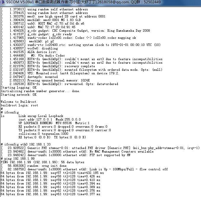

晕哥好热心
这是我编译好的uboot, linux&dtb, rootfs: V3s_TFCard.7z
荔枝派Zero 开发板网卡确认没有问题:
你试一试, 有什么问题在后面跟帖。

请问开启eth0后出现下面信息正常吗?
# ifconfig eth0 192.168.1.100
[ 3647.260168] Generic PHY stmmac-0:01: attached PHY driver [Generic PHY] (mii_bus:phy_addr=stmmac-0:01, irq=-1)
[ 3647.272133] dwmac-sun8i 1c30000.ethernet eth0: No MAC Management Counters available
[ 3647.279920] dwmac-sun8i 1c30000.ethernet eth0: PTP not supported by HW
# [ 3649.366434] dwmac-sun8i 1c30000.ethernet eth0: Link is Up - 100Mbps/Full - flow control rx/tx

是啊,我的也打不开eth,是设备树没有emac设备。
