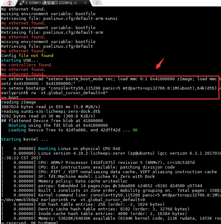

请问各路大神直接烧录荔枝派zero提供的预编译u-boot和固件,出现这个错误, 应该如何解决?

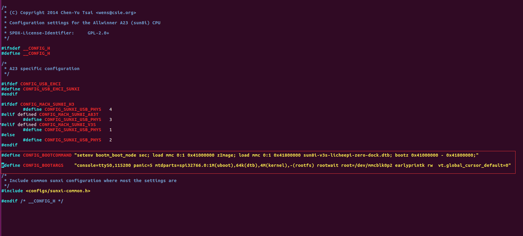

#2 2017-12-16 09:42:13
已发帖子: 9,505
Re: 请问各路大神直接烧录荔枝派zero提供的预编译u-boot和固件,出现这个错误, 应该如何解决?
执行这三条指令,药到病除:
setenv bootcmd "setenv bootm_boot_mode sec; load mmc 0:1 0x41000000 zImage; load mmc 0:1 0x41800000 sun8i-v3s-licheepi-zero-dock.dtb; bootz 0x41000000 - 0x41800000;"
setenv bootargs "console=ttyS0,115200 panic=5 mtdparts=spi32766.0:1M(uboot),64k(dtb),4M(kernel),-(rootfs) rootwait root=/dev/mmcblk0p2 earlyprintk rw vt.global_cursor_default=0"
boot
#3 2017-12-16 10:29:34
zhuacai
注册时间: 2017-12-16
已发帖子: 234
积分: 233.5
[ 0.000000] Linux version 4.13.0-licheepi-zero+ (root@ubuntu) (gcc version 6.3.1 20170109 (Linaro GCC 6.3-2017.02)) #1 SMP Tue Dec 12 17:49:00 PST 2017
[ 0.000000] CPU: ARMv7 Processor [410fc075] revision 5 (ARMv7), cr=10c5387d
[ 0.000000] CPU: div instructions available: patching division code
[ 0.000000] CPU: PIPT / VIPT nonaliasing data cache, VIPT aliasing instruction cache
[ 0.000000] OF: fdt: Machine model: Lichee Pi Zero with Dock
[ 0.000000] Memory policy: Data cache writealloc
[ 0.000000] percpu: Embedded 16 pages/cpu @c3de6000 s33868 r8192 d23476 u65536
[ 0.000000] Built 1 zonelists in Zone order, mobility grouping on. Total pages: 15883
[ 0.000000] Kernel command line: console=ttyS0,115200 panic=5 mtdparts=spi32766.0:1M(uboot),64k(dtb),4M(kernel),-(rootfs) rootwait root=/dev/mmcblk0p2 earlyprintk rw vt.global_cursor_default=0

其实最主要的问题是应该配置下u-boot里的sun8i.h(完整路径u-boot/include/configs/sun8i.h)
添加内容如下:
#define CONFIG_BOOTCOMMAND "setenv bootm_boot_mode sec; load mmc 0:1 0x41000000 zImage; load mmc 0:1 0x41800000 sun8i-v3s-licheepi-zero-dock.dtb; bootz 0x41000000 - 0x41800000;"
#define CONFIG_BOOTARGS    "console=ttyS0,115200 panic=5 mtdparts=spi32766.0:1M(uboot),64k(dtb),4M(kernel),-(rootfs) rootwait root=/dev/mmcblk0p2 earlyprintk rw  vt.global_cursor_default=0"
sun8i.h
今天刚入手荔枝派zero,搞完了spi启动,现在又搞TF启动,因此我也碰见了这问题。之前楼上在讨论是busybox的编译问题,但是既然用2楼的三条命令可以启动,那说明整个文件系统编译没有问题,否则再怎么着也启动不了。
感觉晕歌给的命令很像SPI启动的配置方式,因此就狸猫换太子,把命令修改了一下,结果还真好了。
最近编辑记录 单刀 (2019-11-07 17:50:49)
