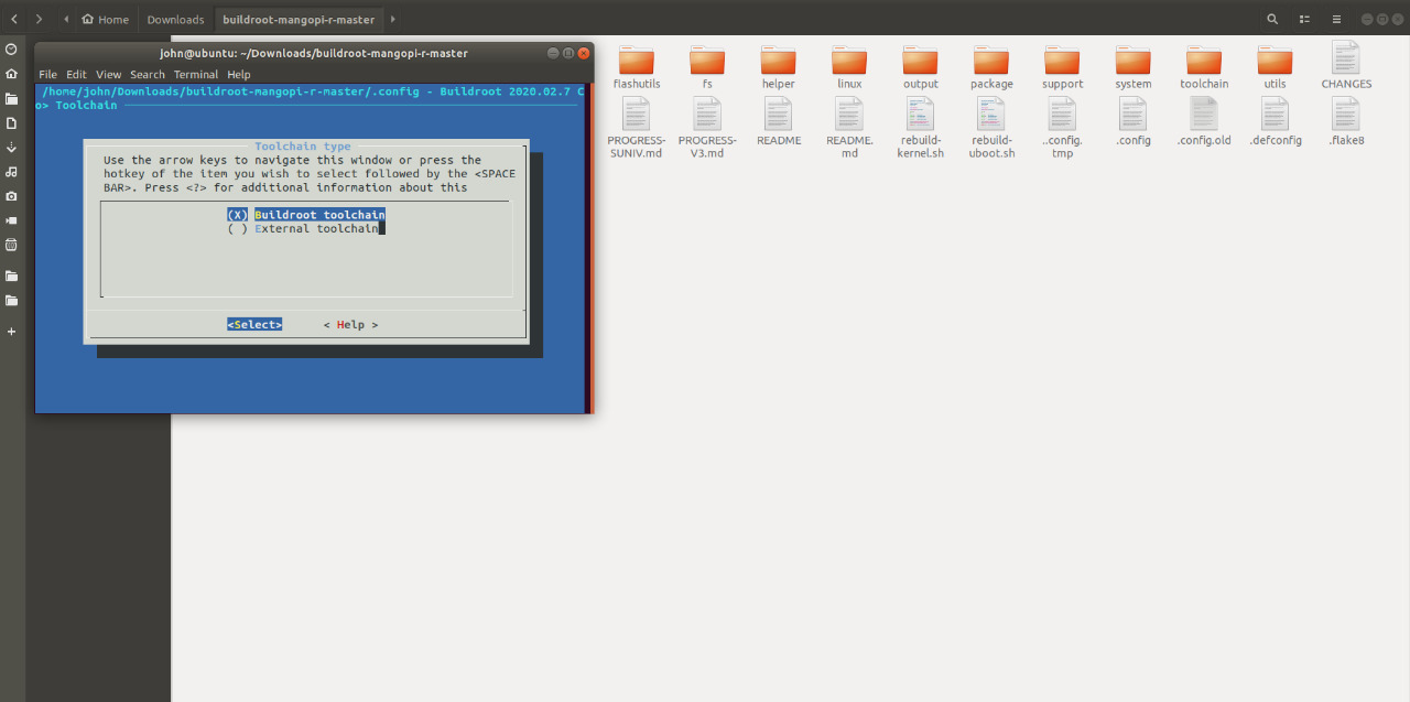

楼主 #4 2022-05-19 00:43:50
johnatia
注册时间: 2022-05-15
积分: 20
Re: problem with spidev
I build the image here
https://github.com/mangopi-sbc/buildroot-mangopi-r
the build system I used the default buildroot toolchain
buildroot.jpeg bbcode buildroot
I compiled the spidev_test.c with cross compiler: arm-linux-gnueabi-gcc
I tried another program using this cross compiler and it worked for me

#6 2022-06-20 11:33:19
Seas0
注册时间: 2021-06-25
Use the compiler which your image builder generated (in $BUILDROOT/output/host/opt/ext-toolchain/bin/$TUPLE-gcc) should just work, as u were using the system provided cross-compiler which provided a higher version of glibc (2.33) not forward-compatible with the version configured in image builder.
Also, compiling with the '-static' flag should attach all the library used to your program, preventing any possible missing / version miss matched / etc. library problem at all, consider it when you are not familiar with target system environment.
最近编辑记录 Seas0 (2022-06-20 11:42:23)
