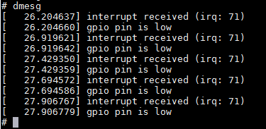

# dmesg
[   26.204637] interrupt received (irq: 71)
[   26.204660] gpio pin is low
[   26.919621] interrupt received (irq: 71)
[   26.919642] gpio pin is low
[   27.429350] interrupt received (irq: 71)
[   27.429359] gpio pin is low
[   27.694572] interrupt received (irq: 71)
[   27.694586] gpio pin is low
[   27.906767] interrupt received (irq: 71)
[   27.906779] gpio pin is low
把PG0 IO脚下拉就会进入中断, 输出上面的信息.

把楼主的 hello.c 和 Makefile 复制后,编译:
ARCH=arm64 CROSS_COMPILE=/opt/a100/longan/out/gcc-linaro-5.3.1-2016.05-x86_64_aarch64-linux-gnu/bin/aarch64-linux-gnu- make -C /opt/a100/longan/kernel/linux-4.9/ M=${PWD} modules
A133 的板子, 一块能中断, 一块不能中断,一头雾水。
