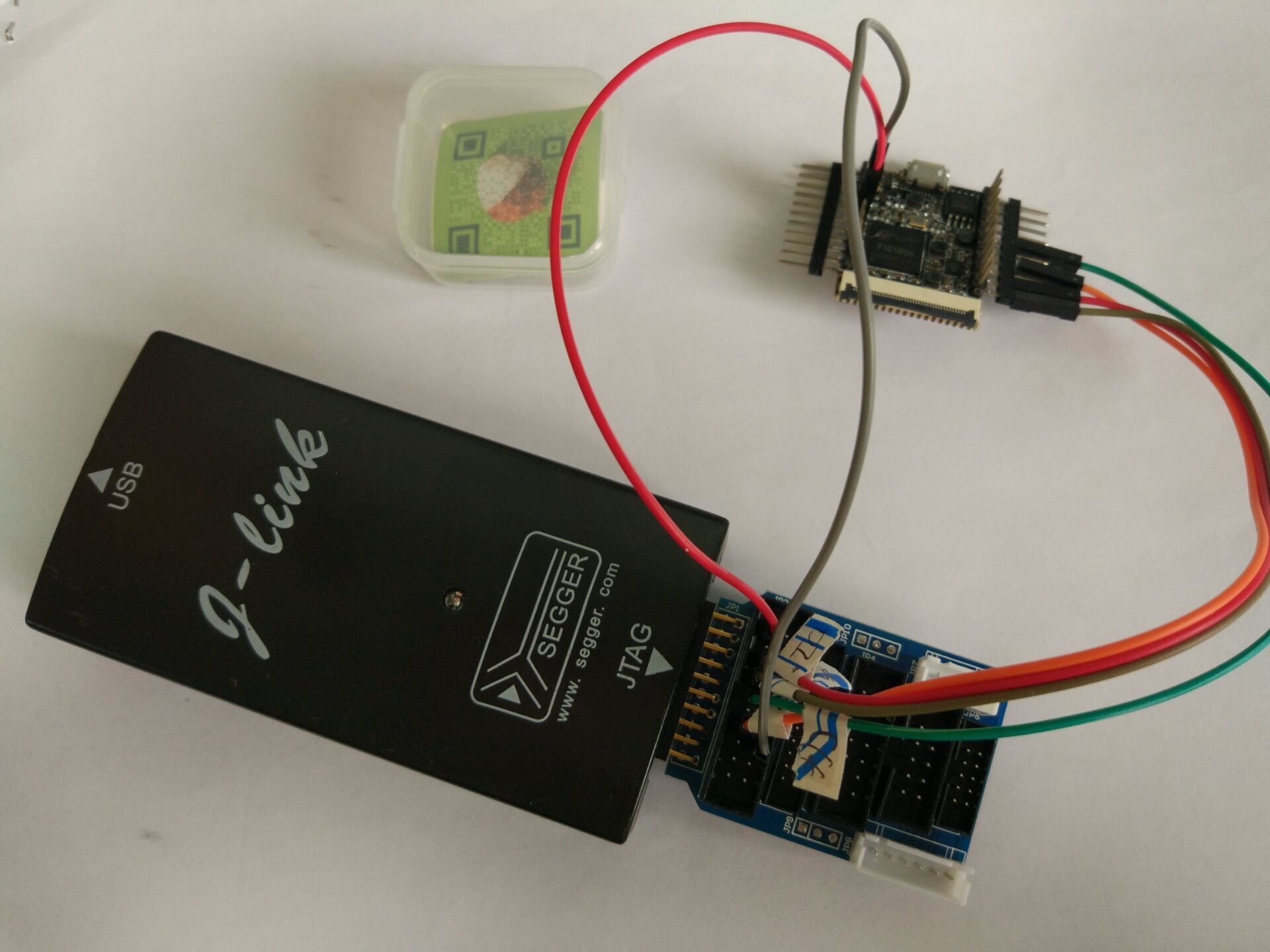

参考链接8: 荔枝派nano f1c100s开发板连接JLink调试器分享

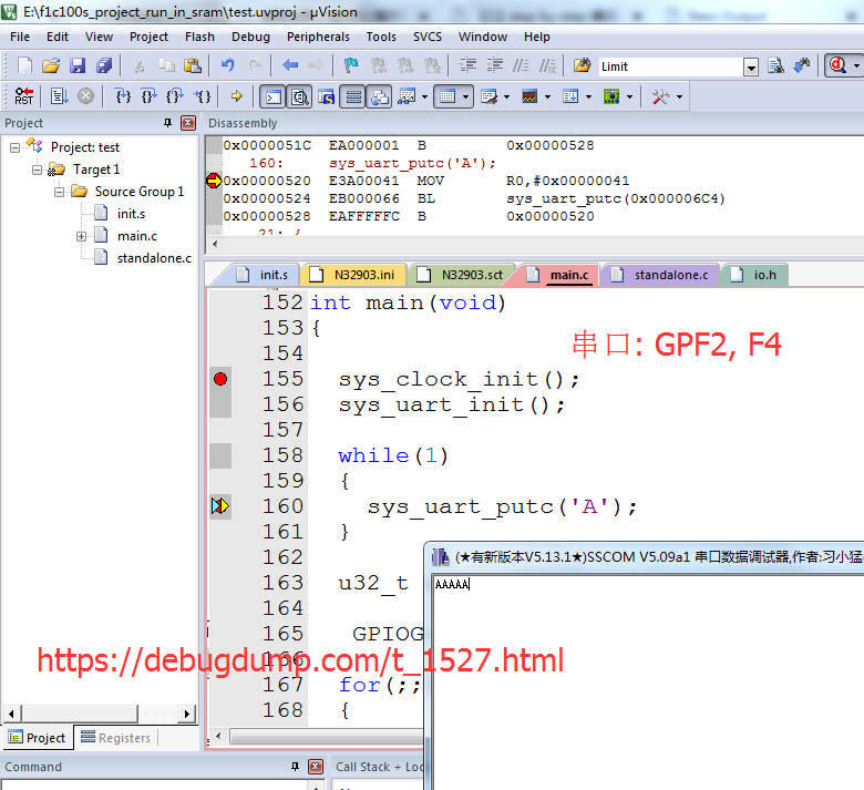

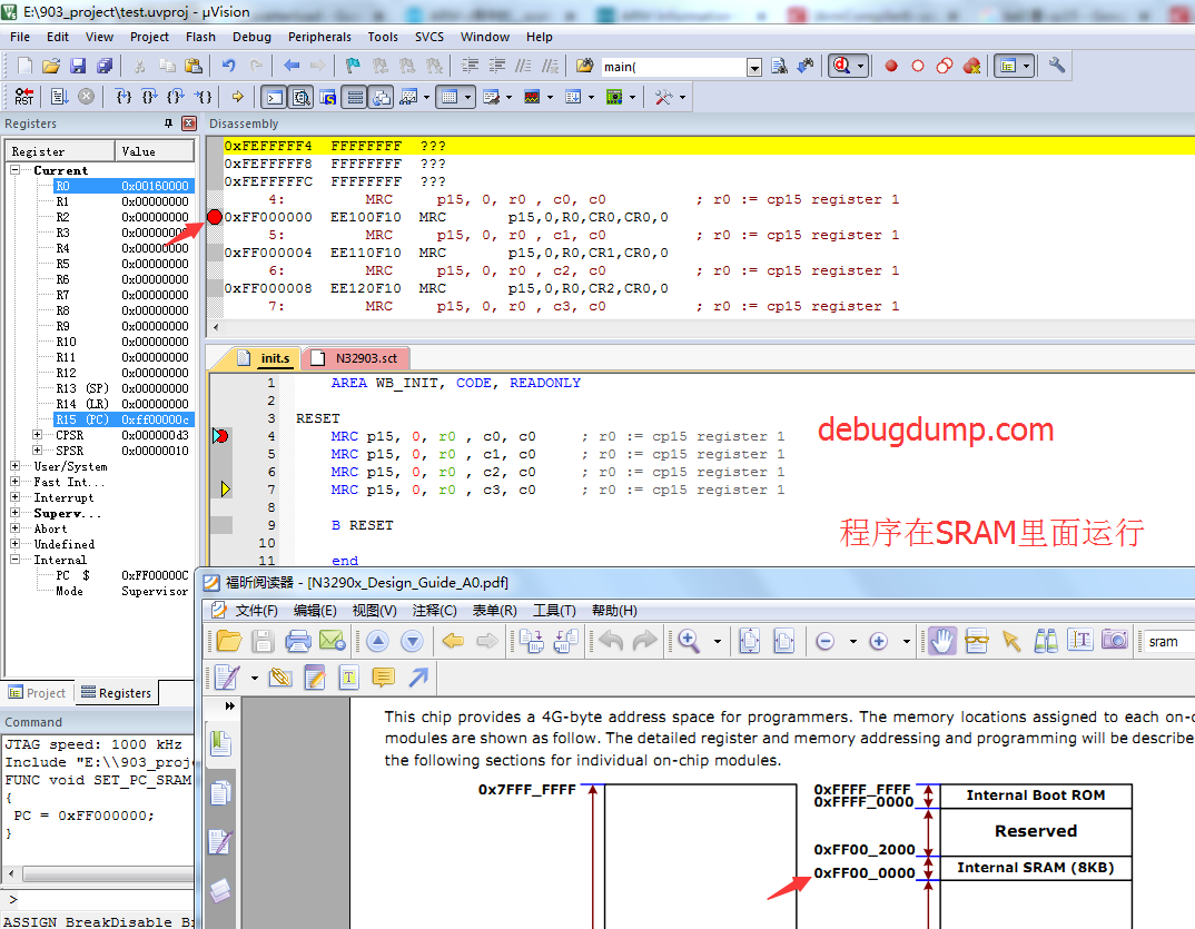

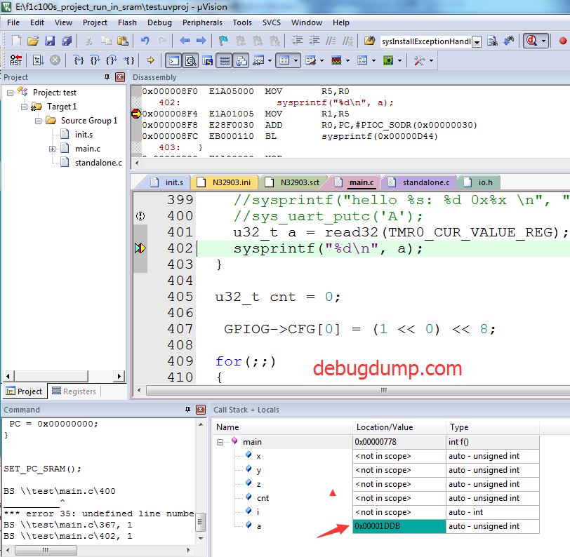

非常简单, 就是把协处理器的寄存器读到 R0, 没别的功能.
MDK工程,读芯片Id, 代码不到10行,没有中断向量.

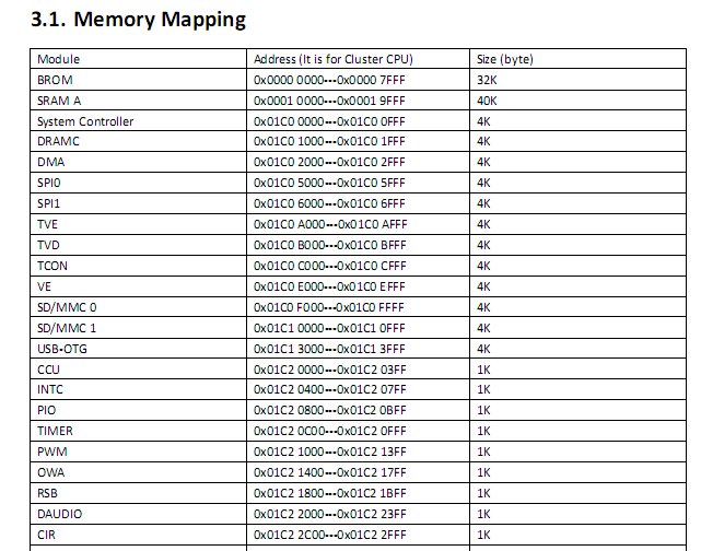

: 这个代码只能在 N3290x 上面跑, 因为N3290x 的SRAM地址在 0xFF00 0000,
全志f1c100s的sram地址在 0x0 位置。

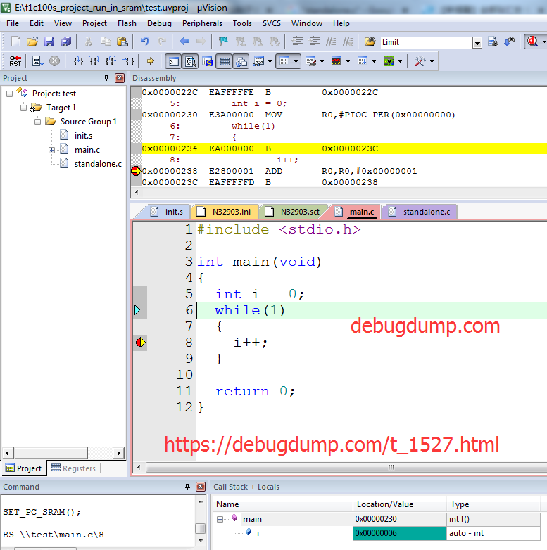

代码下载: f1c100s_project_run_in_sram_2.7z
不容易啊,
第一次玩汇编,
现在终于可以跑C代码了,
(中间省略1万字 ... ...)
参考自新唐 N329xx 工程.

licheepi nano 核心板原理图: Lichee_nano.pdf
仍然是在 SRAM 里面跑,驱动串口 UART0(PF2, PF4)
源码下载: f1c100s_project_run_in_sram_3.7z
从原来的IAR项目移过来的: https://whycan.cn/t_1003.html
参考: https://github.com/xboot/xboot/tree/master/src/arch/arm32/mach-f1c100s

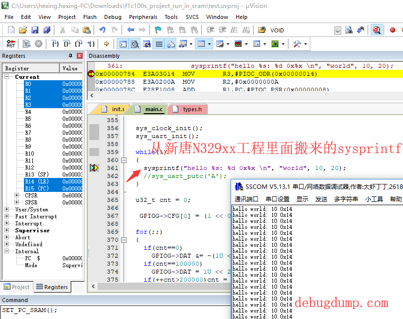

void sysPutString(char *string)
	while (*string != '\0')
		sys_uart_putc(*string);
		string++;
void sysPutStringReverse(char *s, u32_t index)
	while ((index--) > 0)
	sys_uart_putc(s[index]);
static void sysPutRepChar(char c, u32_t count)
	while (count--)
	sys_uart_putc(c);
static void sysPutNumber(s32_t value, s32_t radix, s32_t width, s8_t fill)

实现了格式化输出的demo:
f1c100s_project_run_in_sram_4.7z

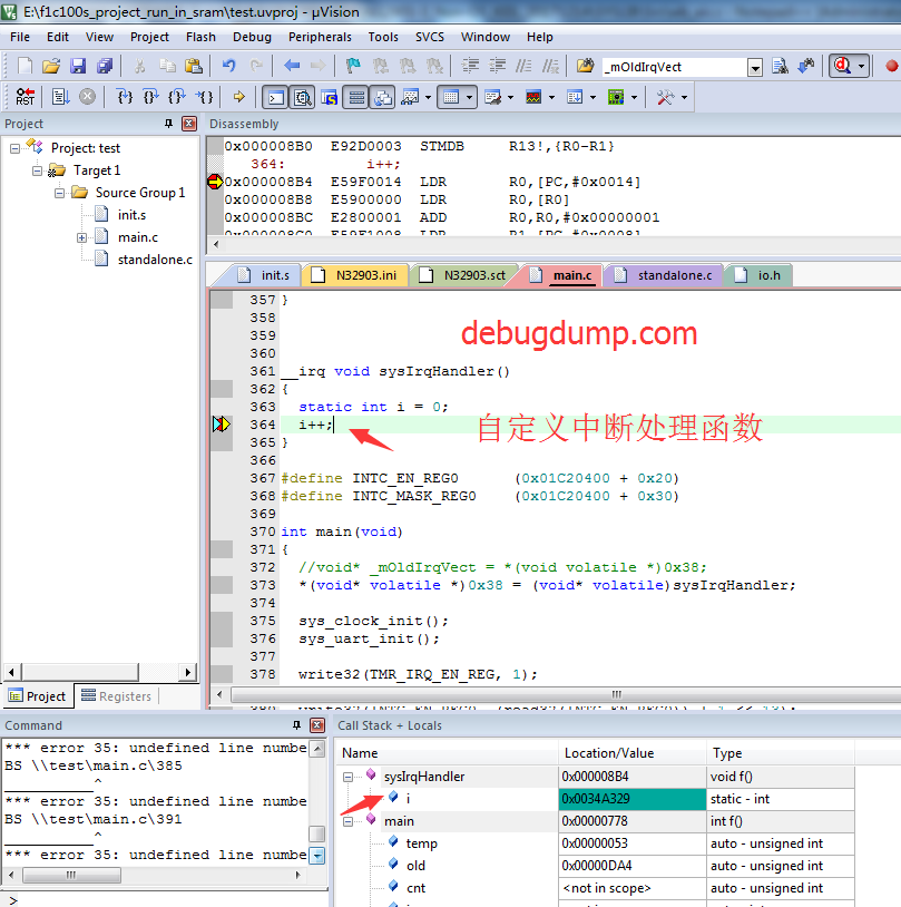

__irq void sysIrqHandler()
	static int i = 0;
	i++;
#define INTC_EN_REG0			(0x01C20400 + 0x20)
#define INTC_MASK_REG0		(0x01C20400 + 0x30)
int main(void)
	//void* _mOldIrqVect = *(void volatile *)0x38;
	*(void* volatile *)0x38 = (void* volatile)sysIrqHandler;
  sys_clock_init();
  sys_uart_init();
	write32(TMR_IRQ_EN_REG, 1);
	write32(INTC_EN_REG0, (read32(INTC_EN_REG0)) | 1 << 13);
	write32(TMR_IRQ_EN_REG, (read32(TMR_IRQ_EN_REG)) | 1 << 13);
	write32(TMR0_INTV_VALUE_REG, 0x2EE0);   //Set interval value
	write32(TMR0_CTRL_REG, 0x10);   //Select Single mode,24MHz clock source,2 pre-scale
	write32(TMR0_CTRL_REG, read32(TMR0_CTRL_REG)|(1<<1)); //Set Reload bit
	while((read32(TMR0_CTRL_REG)>>1)&1);  //Waiting Reload bit turns to 0
	write32(TMR0_CTRL_REG, read32(TMR0_CTRL_REG)|(1<<0));  //Enable Timer0
	u32_t temp;
	__asm
		 MRS    temp, CPSR
		 AND    temp, temp, 0x7F
		 MSR    CPSR_c, temp
	u32_t old = 0;
  while(1)
		//sysprintf("hello %s: %d 0x%x \n", "world", 10, 20);
    //sys_uart_putc('A');
		volatile u32_t a = read32(TMR0_CUR_VALUE_REG);
		if(old == a)
		else
			old = a;
			if(a % 256 == 0)
				sysprintf("%d\n", a);
  u32_t cnt = 0;
   GPIOG->CFG[0] = (1 << 0) << 8;
  for(;;)
    if(cnt==0)
      GPIOG->DAT &= ~(1U << 2);
    if(cnt==100000)
      GPIOG->DAT = 1U << 2;
    if(++cnt>200000)cnt = 0;
	int i = 0;
	while(1)
		i++;
实现了定时器中断的简单demo: f1c100s_project_run_in_sram_6.7z
仍然感谢新唐提供的裸奔程序。

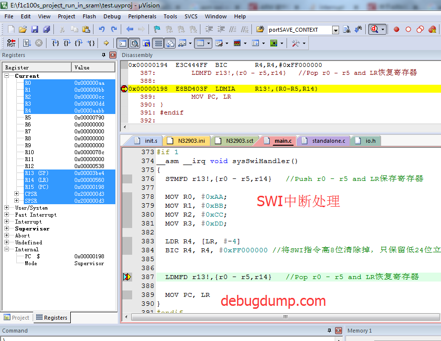

Re: step by step 全志 f1c100s MDK 裸奔各种外设(参考N3290x)
__asm __irq void sysSwiHandler()
	STMFD r13!,{r0 - r5,r14}   //Push r0 - r5 and LR保存寄存器
	MOV R0, #0xAA;
	MOV R1, #0xBB;
	MOV R2, #0xCC;
	MOV R3, #0xDD;
	LDR R4, [LR, #-4]
	BIC R4, R4, #0xFF000000 //将SWI指令高8位清除掉,只保留低24位立即数,取得SWI指令编码
	LDMFD r13!,{r0 - r5,r14}   //Pop r0 - r5 and LR恢复寄存器
	MOV PC, LR
int main(void)
	*(void* volatile *)0x28 = (void* volatile)sysSwiHandler;
实现一个简单的swi中断处理,并取出用户自定义中断号到R4寄存器: f1c100s_project_run_in_sram_7.7z

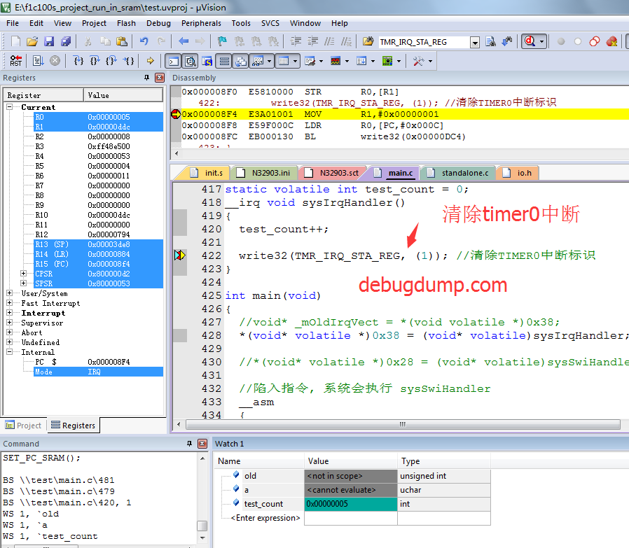

#define TMR_IRQ_EN_REG 			(0x01C20C00 + 0x00)
#define TMR_IRQ_STA_REG 		(0x01C20C00 + 0x04)
#define TMR0_CTRL_REG 			(0x01C20C00 + 0x10)
#define TMR0_INTV_VALUE_REG	(0x01C20C00 + 0x14)
#define TMR0_CUR_VALUE_REG	(0x01C20C00 + 0x18)
#define INTC_PEND_REG0		(0x01C20400 + 0x10)
#define INTC_PEND_REG1		(0x01C20400 + 0x14)
#define INTC_EN_REG1			(0x01C20400 + 0x24)
#define INTC_MASK_REG1		(0x01C20400 + 0x34)
#define INTC_RESP_REG0 		(0x01C20400 + 0x40)
#define INTC_RESP_REG1 		(0x01C20400 + 0x44)
#define INTC_FF_REG0			(0x01C20400 + 0x50)
#define INTC_FF_REG1			(0x01C20400 + 0x54)
#define INTC_PRIO_REG0 		(0x01C20400 + 0x60)
#define INTC_PRIO_REG1 		(0x01C20400 + 0x60)

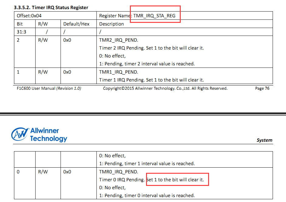

static volatile int test_count = 0;
	test_count++;
	write32(TMR_IRQ_STA_REG, (1)); //清除TIMER0中断标识
int main(void)
	*(void* volatile *)0x38 = (void* volatile)sysIrqHandler;//设置IRQ中断处理程序
	sys_clock_init();
	sys_uart_init();
	write32(TMR0_CTRL_REG, 0x10);   //此行注释有误,具体看手册 Select Single mode,24MHz clock source,2 pre-scale
#if 1
	//开启中断使能
	u32_t temp;
	__asm
		 MRS    temp, CPSR
		 MSR    CPSR_c, temp
	u32_t old = 0;
	while(1)
		if(old == test_count)
		else
			old = test_count;
			if(test_count % 256 == 0)
				sysprintf("%d\n", test_count);
跳出七七四十九道坑写的TIMER0 中断处理程序:
f1c100s_project_run_in_sram_8.7z

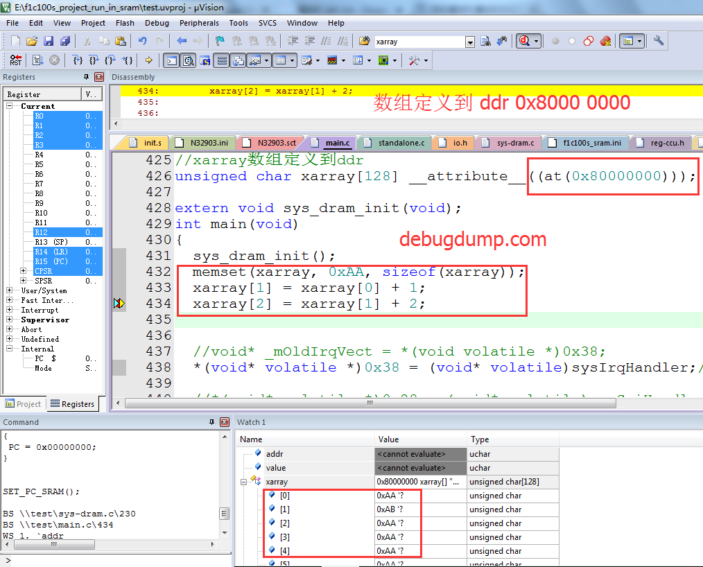

//xarray数组定义到ddr
unsigned char xarray[128] __attribute__((at(0x80000000)));
extern void sys_dram_init(void);
int main(void)
	sys_dram_init();
	memset(xarray, 0xAA, sizeof(xarray));
	xarray[1] = xarray[0] + 1;
	xarray[2] = xarray[1] + 2;
代码参考: https://github.com/xboot/xboot/blob/master/src/arch/arm32/mach-f1c100s/sys-dram.c

上面的视频演示 timer0 控制寄存器 TMR0_CTRL_REG 设置为单次触发,
中断程序只进入一次.
TMR0_MODE.
Timer 0 mode.
0: Continuous mode. When interval value reached, the timer will not disable
automatically.
1: Single mode. When interval value reached, the timer will disable
automatically.

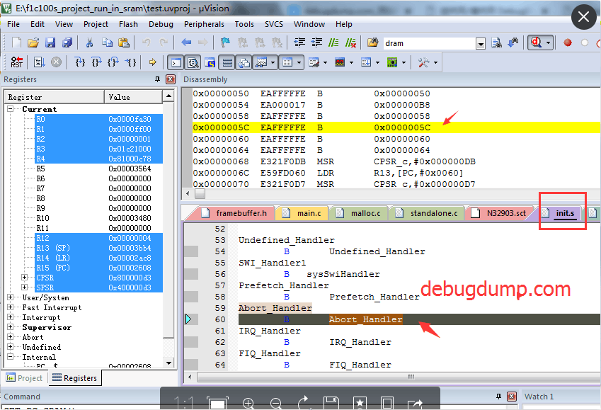

arm32_interrupt_disable();这个可能是能通过的原因,因为xboot调dram初始化前是关中断的
sys_dram_init();会改0x5c作为重入标志,其它按理不会改SRAM了。你看看0x5c是不是重要位置
楼主 #21 2018-08-29 09:02:50
所在地: 微信 whycan_cn
已发帖子: 9,245
积分: 9197
0x5C只是一个 Abort_Handler 地址而已, 估计是借几个位用于标识是否初始化过DDR.
SRAM那个问题确实有点神奇, 不知道是不是MDK JLink调试工具引起的。

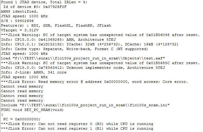

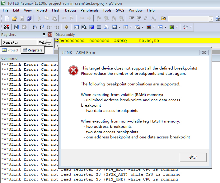

我用JLink.exe可以连接上。我下的 f1c100s_project_run_in_sram_2.7z这个工程,用keil调试失败。是不是keil工程要设置一些东西?(我装的Keil uVision4)

kq851211 说:
下载一楼推荐的版本试一试。
#52 2020-05-15 12:03:40
kq851211
注册时间: 2020-05-01
已发帖子: 47
积分: 31.5
还是不行。我卸载了Keil uVision4,装了Keil uVision5,并装了楼上推荐的版本。还是一样。提示错误

jlink连接我试参考这样做的,没问题吧?

https://whycan.cn/t_2025.html
建议用tf卡接口的板子接jtag,板厚不要超过 0.8mm

我这样搭线不行,必须用转接板?

我J-Link Commander 可以连接成功呀。但就是keil调试不了。keil调试要插sd卡吗?我nano板上没焊spi flash。
jlink.exe 可以检测到core应该就可以了。

jlink可以检测到,用命令也可以往sram里写数据读数据。但就是keil调试不了,提示那错误。我下的那工程( f1c100s_project_run_in_sram_2.7z)直接就可以调试吗?要不要配置其他什么什么东西?jlink要不要配置什么?
#61 2020-05-15 16:50:20
wechat微信:whycan_cn
所在地: 你猜
已发帖子: 3,378
kq851211 说:
这个demo不需要另外配置啥,因为sram无需初始化。
截图看下是什么错误?

把JLINK的复位脚和F1C的连起来试一试。
#64 2020-05-15 17:10:05
kq851211
注册时间: 2020-05-01
已发帖子: 47
积分: 31.5
恩,可以了,谢谢

弱弱的问一下,F1C100S的sram地址怎么是0?我在文档上没找到呀
#66 2020-05-15 17:14:11
kq851211
注册时间: 2020-05-01
已发帖子: 47
积分: 31.5
我只在文档上发现这个。不过是  Allwinner_F1C200s处理器用户手册   里的。应该和F1C100s是一样的吧

MDK widora r3 裸奔 工程, UART1 (PA2, PA3)输出A:
widora_r3_uart1_pa2_pa3_20210529.zip

timer0中断问题
这个何解?是作为中断矢量0x38吗?
我程序在SDRAM中运行,不能进中断,一运行PC就停在0x00000004处

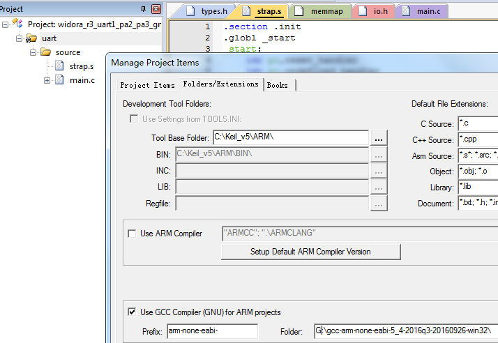

提示:*** Error: Failed to execute 'arm-none-eabi-gcc'
arm-none-eabi-gcc已经安装配置到环境变量里了,是什么原因呢?
#121 2023-04-28 13:53:56
家猫戏很足
注册时间: 2018-09-16
家猫戏很足 说:
查到原因了,右击项目--Manage Project Items--Floders/Externsion--Folder 工程是gcc-arm绝对地址,工程里带了Toolchain
但是还有一个问题,用新版的gcc-arm会报 multiple definition 错误,对gcc-arm不太熟悉,怎么解决呢

我调试到某个地方就会提示“Cannot read memory”是什么原因
