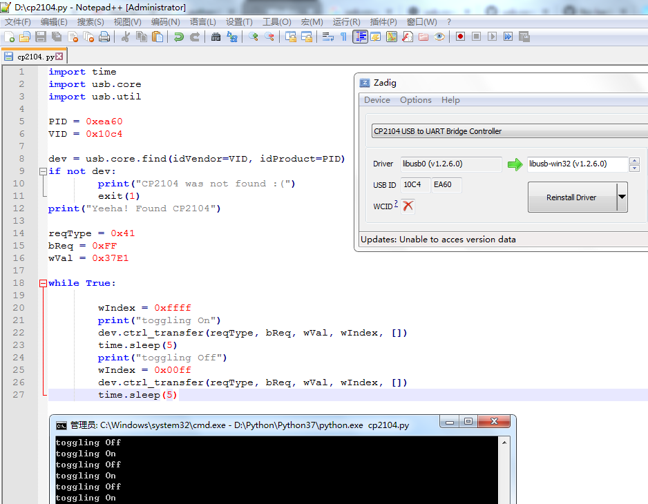

Re: Windows上用 Python 脚本控制 CP2104 GPIO 输出
import time
import usb.core
import usb.util
PID = 0xea60
VID = 0x10c4
dev = usb.core.find(idVendor=VID, idProduct=PID)
if not dev:
        print("CP2104 was not found :(")
        exit(1)
print("Yeeha! Found CP2104")
reqType = 0x41
bReq = 0xFF
wVal = 0x37E1
while True:
        wIndex = 0xffff
        print("toggling On")
        dev.ctrl_transfer(reqType, bReq, wVal, wIndex, [])
        time.sleep(5)
        print("toggling Off")
        wIndex = 0x00ff
        time.sleep(5)
  1. 用 zadig 给cp2104 强制装上 libusb-win32 驱动程序
  2. 运行D:\Python\Python37\python.exe cp2104.py
楼主 #3 2019-03-02 10:54:05
所在地: 微信 whycan_cn
已发帖子: 9,250
积分: 9197
debugdump@ubuntu:~$ sudo python3 /mnt/hgfs/D/cp2104.py
Yeeha! Found CP2104
toggling On
  File "/mnt/hgfs/D/cp2104.py", line 22, in <module>
  File "/usr/local/lib/python3.4/dist-packages/usb/core.py", line 1043, in ctrl_transfer
    self.__get_timeout(timeout))
  File "/usr/local/lib/python3.4/dist-packages/usb/backend/libusb1.py", line 883, in ctrl_transfer
    timeout))
  File "/usr/local/lib/python3.4/dist-packages/usb/backend/libusb1.py", line 595, in _check
    raise USBError(_strerror(ret), ret, _libusb_errno[ret])
usb.core.USBError: [Errno 110] Operation timed out
在Ubuntu Linux 下跑会出现一个超时错误: [Errno 110] Operation timed out
https://stackoverflow.com/questions/38658907/trouble-using-pyusb-to-read-write-from-usb-device-timeouts
解决方案: 在 find() 后加 reset()
import time
import usb.core
import usb.util
PID = 0xea60
VID = 0x10c4
dev.reset()
if not dev:
        print("CP2104 was not found sad")
        exit(1)
reqType = 0x41
bReq = 0xFF
wVal = 0x37E1
while True:
        wIndex = 0xffff
        time.sleep(5)
        wIndex = 0x00ff
        time.sleep(5)
感谢楼主, 测试py+cp2104测试成功.
