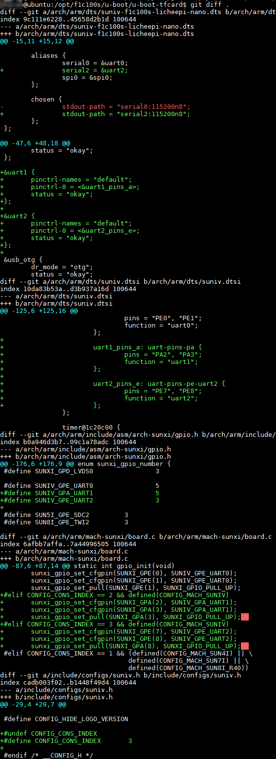

#5 2020-04-03 15:22:13
ubuntu
注册时间: 2020-03-30
已发帖子: 312
积分: 290
Re: F1C100S使用主线uboot如何更改默认终端串口
#define CONFIG_CONS_INDEX       1  //UART0
#define CONFIG_CONS_INDEX       2  //UART1
#define CONFIG_CONS_INDEX       3  //UART2
改这个只能影响u-boot 的 spl 串口输出, 如果u-boot输出还得改 dts 文件:
diff --git a/arch/arm/dts/suniv-f1c100s-licheepi-nano.dts b/arch/arm/dts/suniv-f1c100s-licheepi-nano.dts
index 9c111e6228..45658d2b1d 100644
--- a/arch/arm/dts/suniv-f1c100s-licheepi-nano.dts
+++ b/arch/arm/dts/suniv-f1c100s-licheepi-nano.dts
@@ -15,11 +15,12 @@
        aliases {
                serial0 = &uart0;
+               serial2 = &uart2;
                spi0 = &spi0;
        chosen {
-               stdout-path = "serial0:115200n8";
+               stdout-path = "serial2:115200n8";
@@ -47,6 +48,18 @@
+&uart1 {
+       pinctrl-names = "default";
+       pinctrl-0 = <&uart1_pins_a>;
+       status = "okay";
+&uart2 {
+       pinctrl-0 = <&uart2_pins_e>;
+       status = "okay";
 &usb_otg {
        dr_mode = "otg";
diff --git a/arch/arm/dts/suniv.dtsi b/arch/arm/dts/suniv.dtsi
index 10da83b53a..d3b937a16d 100644
--- a/arch/arm/dts/suniv.dtsi
+++ b/arch/arm/dts/suniv.dtsi
@@ -125,6 +125,16 @@
                                pins = "PE0", "PE1";
                                function = "uart0";
+                       uart1_pins_a: uart-pins-pa {
+                               pins = "PA2", "PA3";
+                               function = "uart1";
+                       uart2_pins_e: uart-pins-pe-uart2 {
+                               pins = "PE7", "PE8";
+                               function = "uart2";
                timer@1c20c00 {
diff --git a/arch/arm/include/asm/arch-sunxi/gpio.h b/arch/arm/include/asm/arch-sunxi/gpio.h
index b0a946d3b7..09c1a78adc 100644
--- a/arch/arm/include/asm/arch-sunxi/gpio.h
+++ b/arch/arm/include/asm/arch-sunxi/gpio.h
@@ -176,6 +176,9 @@ enum sunxi_gpio_number {
 #define SUNXI_GPD_LVDS0                3
 #define SUNIV_GPE_UART0                5
+#define SUNIV_GPA_UART1                5
+#define SUNIV_GPE_UART2                3
 #define SUN5I_GPE_SDC2         3
 #define SUN8I_GPE_TWI2         3
diff --git a/arch/arm/mach-sunxi/board.c b/arch/arm/mach-sunxi/board.c
index 6afbb7affa..7a44996505 100644
--- a/arch/arm/mach-sunxi/board.c
+++ b/arch/arm/mach-sunxi/board.c
@@ -87,6 +87,14 @@ static int gpio_init(void)
        sunxi_gpio_set_cfgpin(SUNXI_GPE(0), SUNIV_GPE_UART0);
        sunxi_gpio_set_cfgpin(SUNXI_GPE(1), SUNIV_GPE_UART0);
        sunxi_gpio_set_pull(SUNXI_GPE(1), SUNXI_GPIO_PULL_UP);
+#elif CONFIG_CONS_INDEX == 2 && defined(CONFIG_MACH_SUNIV)
+       sunxi_gpio_set_cfgpin(SUNXI_GPA(2), SUNIV_GPA_UART1);
+       sunxi_gpio_set_cfgpin(SUNXI_GPA(3), SUNIV_GPA_UART1);
+       sunxi_gpio_set_pull(SUNXI_GPA(3), SUNXI_GPIO_PULL_UP);
+#elif CONFIG_CONS_INDEX == 3 && defined(CONFIG_MACH_SUNIV)
+       sunxi_gpio_set_cfgpin(SUNXI_GPE(7), SUNIV_GPE_UART2);
+       sunxi_gpio_set_cfgpin(SUNXI_GPE(8), SUNIV_GPE_UART2);
+       sunxi_gpio_set_pull(SUNXI_GPA(8), SUNXI_GPIO_PULL_UP);
 #elif CONFIG_CONS_INDEX == 1 && (defined(CONFIG_MACH_SUN4I) || \
                                 defined(CONFIG_MACH_SUN7I) || \
                                 defined(CONFIG_MACH_SUN8I_R40))
diff --git a/include/configs/suniv.h b/include/configs/suniv.h
index cadb003f02..b1448f49d4 100644
--- a/include/configs/suniv.h
+++ b/include/configs/suniv.h
@@ -29,4 +29,7 @@
 #define CONFIG_HIDE_LOGO_VERSION
+#undef CONFIG_CONS_INDEX
+#define CONFIG_CONS_INDEX       3
从 UART2(PE7/PE8)输出搞定!

U-BOOT改好了,参数好像会直接传递到内核,所以内核那边是不需要去改的。只停在start kernel可能是原来传递的是ttyS0,你没改到ttyS1.
应该是正解
