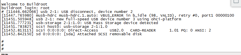

各位大神,全志Zero开发板可以识别出u盘,但是没有示是盘符,挂载不了u盘,请大神支招.....

晕哥,ubuntu上可以,mount /dev/sda /tmp/udisk挂载不行,你看我上面的图片打印是usd2.0 是不是v3s 不支持2.0的usd,还是内核没有配置好?

没有提示什么如下图,我另一个u盘可以挂载,这个u盘提示usb 2.0 就是挂载不了,是不是v3s不支持usb2.0的设备呀

[15641.625929] usb 2-1: new full-speed USB device number 7 using ohci-platform
[15641.897211] usb-storage 2-1:1.0: USB Mass Storage device detected
[15641.903804] scsi host0: usb-storage 2-1:1.0
[15642.973101] scsi 0:0:0:0: Direct-Access     USB2.0   CARD-READER      1.01 PQ: 0 ANSI: 2
[15643.002130] sd 0:0:0:0: [sda] Attached SCSI removable disk
# mount /dev/sda /tmp/udisk
mount: mounting /dev/sda on /tmp/udisk failed: No such file or directory

你创建 /tmp/udisk 了吗?

晕哥,和你发的图片不一样呢?我的要能挂载# mount /dev/sdc /tmp/udisk 还要挂载# mount /dev/sdc1 /tmp/udisk才可以读u盘呢,
[  613.625919] usb 2-1: new full-speed USB device number 5 using ohci-platform
[  613.897193] usb-storage 2-1:1.0: USB Mass Storage device detected
[  613.903757] scsi host2: usb-storage 2-1:1.0
[  614.973077] scsi 2:0:0:0: Direct-Access     USB2.0   CARD-READER      1.01 PQ: 0 ANSI: 2
[  615.002116] sd 2:0:0:0: [sdc] Attached SCSI removable disk
# mkdir /tmp/udisk -p
mount: mounting /dev/sdc1 on /tmp/udisk failed: No such file or directory
[  675.335046] sd 2:0:0:0: [sdc] 7744512 512-byte logical blocks: (3.97 GB/3.69 GiB)
[  675.409183]  sdc: sdc1
mount: mounting /dev/sdc on /tmp/udisk failed: Invalid argument
[  697.048371] FAT-fs (sdc1): Volume was not properly unmounted. Some data may be corrupt. Please run fsck.
# cd /tmp/udisk
# ls
9999888.gcode              budda.gcode
AAA.gco                    cardbox.gcode
Android                    fox.gcode

搞定了?
这个涉及到分区问题,如果U盘分了三个区还会有 /dev/sdc2, /dev/sdc3 等

搞定了,谢谢晕哥
