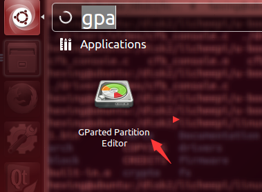

1. 先编译出u-boot, Linux, dtb 文件, 用buildroot编译出根文件系统.

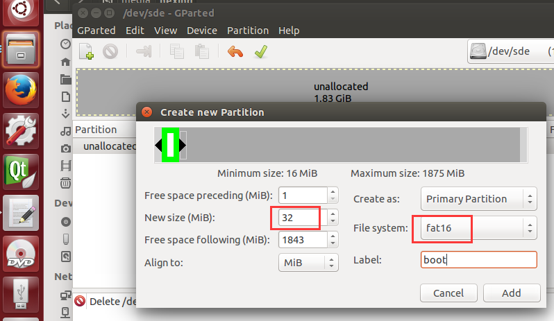

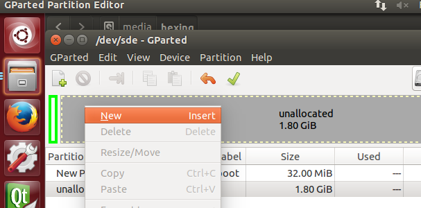

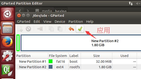

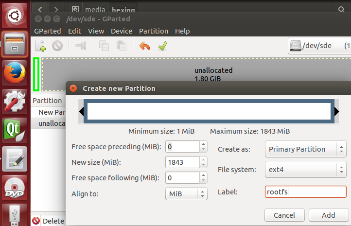

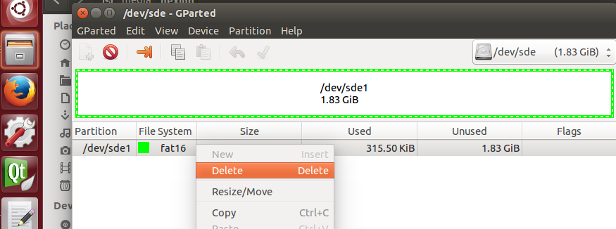

2. 烧录TF卡,打开gparted
1) 删除TF卡所有分区
2) 将uboot写入到sd卡8k偏移处。
    sudo dd if=u-boot-sunxi-with-spl_480800.bin of=/dev/sdb bs=1024 seek=8
3) 建立第一个分区,大小32M(可以随意填写), 格式FAT16, 把zImage, sun8i-v3s-licheepi-zero-dock.dtb拷贝到 这个分区
3. TF卡插入荔枝派Zero开发板, 插入串口, 启动。

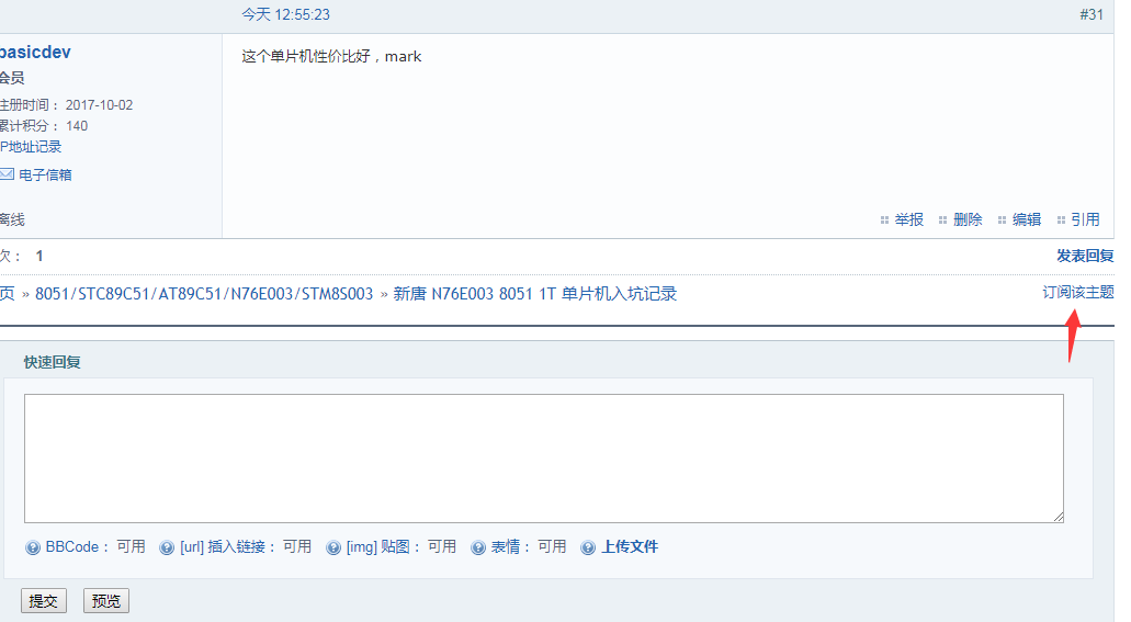

楼主 #17 2019-01-05 11:26:45
已发帖子: 9,416
Re: 【视频分享】制作荔枝派Zero开发板(全志V3s) TF/SD卡启动盘
@Jmhh247 是的, 抱歉现在还没有通知功能, 计划后续加上邮件和手机短信功能, 目前我个人精力和能力都有限, 等以后人气好了希望可以全职经营网站。

楼主 #19 2019-01-05 13:40:43
已发帖子: 9,416
Jmhh247 说:
慢慢来,加油,加油!
感谢支持, 刚刚研究了一下, 搞定了 EMAIL 订阅的问题, 初步验证是可以用的.
按上面的链接, 可以订阅主题的所有回复, 如果该主题有新帖子,会通过EMAIL推送.

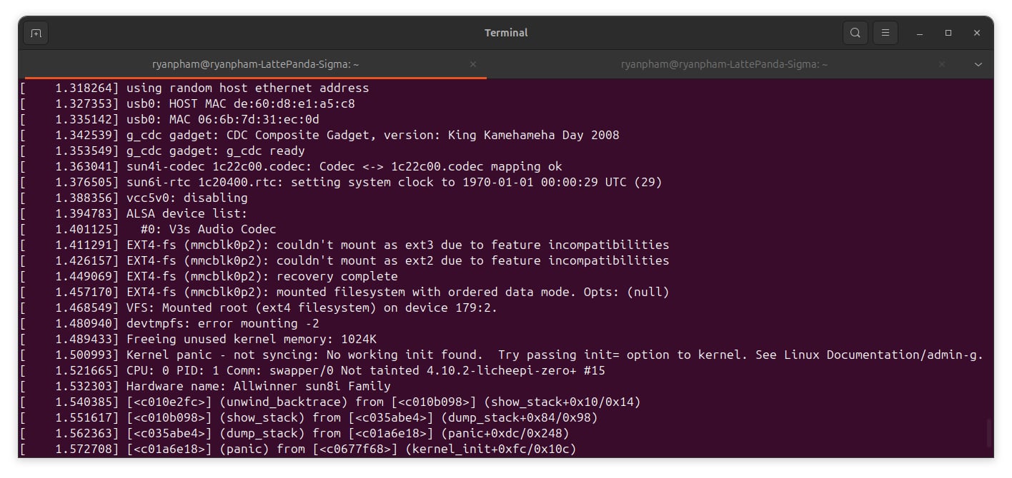

晕哥,我之前配置好的内核和根文件系统,之前烧进tft卡能够跑起来,但是现在我重新烧了之后,一直出现如下问题,解决不了,请晕哥帮忙分析下原因:
egulator
[    1.284498] musb-hdrc musb-hdrc.1.auto: MUSB HDRC host driver
[    1.290342] musb-hdrc musb-hdrc.1.auto: new USB bus registered, assigned bus number 3
[    1.299464] hub 3-0:1.0: USB hub found
[    1.303332] hub 3-0:1.0: 1 port detected
[    1.309655] using random self ethernet address
[    1.314111] using random host ethernet address
[    1.319705] usb0: HOST MAC 6a:d5:57:40:e4:d4
[    1.324025] usb0: MAC 0e:cd:1a:52:8f:7c
[    1.328015] g_cdc gadget: CDC Composite Gadget, version: King Kamehameha Day 2008
[    1.335495] g_cdc gadget: g_cdc ready
[    1.341732] sun4i-codec 1c22c00.codec: Codec <-> 1c22c00.codec mapping ok
[    1.350212] sun6i-rtc 1c20400.rtc: setting system clock to 1970-01-01 00:00:15 UTC (15)
[    1.358525] vcc5v0: disabling
[    1.361499] ALSA device list:
[    1.364463]   #0: V3s Audio Codec
[    1.369788] EXT4-fs (mmcblk0p2): couldn't mount as ext3 due to feature incompatibilities
[    1.379157] EXT4-fs (mmcblk0p2): couldn't mount as ext2 due to feature incompatibilities
[    1.406827] EXT4-fs (mmcblk0p2): recovery complete
[    1.411647] EXT4-fs (mmcblk0p2): mounted filesystem with ordered data mode. Opts: (null)
[    1.419913] VFS: Mounted root (ext4 filesystem) on device 179:2.
[    1.439708] devtmpfs: mounted
[    1.443910] Freeing unused kernel memory: 1024K
[    1.468423] Starting init: /sbin/init exists but couldn't execute it (error -5)
[    1.477461] Starting init: /bin/sh exists but couldn't execute it (error -5)
[    1.484519] Kernel panic - not syncing: No working init found.  Try passing init= option to kernel. See Linux Documentation/admin-guide/init.rst for guidance.
[    1.498672] CPU: 0 PID: 1 Comm: swapper/0 Not tainted 4.13.16-licheepi-zero+ #14
[    1.506055] Hardware name: Allwinner sun8i Family
[    1.510793] [<c010e4c4>] (unwind_backtrace) from [<c010b21c>] (show_stack+0x10/0x14)
[    1.518537] [<c010b21c>] (show_stack) from [<c066afdc>] (dump_stack+0x84/0x98)
[    1.525764] [<c066afdc>] (dump_stack) from [<c011b568>] (panic+0xdc/0x248)
[    1.532643] [<c011b568>] (panic) from [<c067d9f0>] (kernel_init+0x100/0x110)
[    1.539688] [<c067d9f0>] (kernel_init) from [<c0107578>] (ret_from_fork+0x14/0x3c)
[    1.547262] Rebooting in 5 seconds..
楼主 #28 2019-01-07 16:56:52
已发帖子: 9,416
文件系统挂载成功, 但是你的文件系统出了问题, 测试了几个文件都没有执行成功.
建议换卡重烧试一试。

#64 2020-03-29 15:51:01
carl
注册时间: 2020-03-27
关于分区建立的问题,为什么要创建2个分区,一个是放linux img + dtb,一个是放文件系统。难道是代码中分别找2个分区。
#65 2020-03-31 00:43:21
carl
注册时间: 2020-03-27
按照晕哥的步骤做了,我的主机是Ubuntu16.04,用的是USB 的读卡器,TF卡是sandisk,16G
1.将TF卡分全部删除
2.sudo dd if=u-boot-sunxi-with-spl.bin of=/dev/sdb bs=1024 seek=8
3.出现问题,GParted分区工具提示GPT 崩溃,继续流程
4.创建2个分区,一个32M,一个是剩下的全部,这个时候还是会提醒GPT崩溃,点击确定之后可以进行分区
5.将zimage和dtb文件拷贝到文件32M,另一个是将root.tar解压到15G的另一个分区。
以上步骤完成后,插入TF卡,没有任何的反应,怀疑是uboot没有烧进去。重复第2个步骤,然后出现找不到mmcblk2的log,VFS无法挂载
log如下:从下面的log看,
[    1.405767] VFS: Cannot open root device "mmcblk0p2" or unknown-block(179,2): error -6
[    1.413788] Please append a correct "root=" boot option; here are the available partitions:
[    1.422164] b300        15159296 mmcblk0
这个分区是mmcblk0,而启动命令参数是root=/dev/mmcblk0p2,难道需要改启动参数。但是我使用的晕哥的这个固件(uboot,zimage,dtb,rootfs)
U-Boot 2017.01-rc2-00075-gec3f3ba-dirty (Dec 15 2017 - 14:00:51 +0800) Allwinner Technology
Model: Lichee Pi Zero
DRAM:  64 MiB
MMC:   SUNXI SD/MMC: 0
In:    serial@01c28000
Out:   serial@01c28000
Err:   serial@01c28000
Net:   phy interface0
eth0: ethernet@1c30000
starting USB...
No controllers found
GUID Partition Table Entry Array CRC is wrong: 0x9e95e65e != 0xb897ee45
part_get_info_efi: *** ERROR: Invalid GPT ***
part_get_info_efi: ***        Using Backup GPT ***
reading zImage
4016104 bytes read in 642 ms (6 MiB/s)
11803 bytes read in 28 ms (411.1 KiB/s)
   Loading Device Tree to 42dfa000, end 42dffe1a ... OK
[    1.422170]  driver: mmcblk
[    1.428971] Kernel panic - not syncing: VFS: Unable to mount root fs on unknown-block(179,2)
[    1.437402] CPU: 0 PID: 1 Comm: swapper/0 Not tainted 4.13.0-licheepi-zero+ #46
[    1.444698] Hardware name: Allwinner sun8i Family
[    1.449434] [<c010e22c>] (unwind_backtrace) from [<c010af9c>] (show_stack+0x10/0x14)
[    1.457180] [<c010af9c>] (show_stack) from [<c0674fd0>] (dump_stack+0x90/0xa4)
[    1.464404] [<c0674fd0>] (dump_stack) from [<c011b05c>] (panic+0xf0/0x268)
[    1.471281] [<c011b05c>] (panic) from [<c090110c>] (mount_block_root+0x19c/0x26c)
[    1.478759] [<c090110c>] (mount_block_root) from [<c09012f8>] (mount_root+0x11c/0x124)
[    1.486669] [<c09012f8>] (mount_root) from [<c090144c>] (prepare_namespace+0x14c/0x194)
[    1.494667] [<c090144c>] (prepare_namespace) from [<c0900dcc>] (kernel_init_freeable+0x1d0/0x1e0)
[    1.503529] [<c0900dcc>] (kernel_init_freeable) from [<c0686fdc>] (kernel_init+0x8/0x110)
[    1.511700] [<c0686fdc>] (kernel_init) from [<c0107358>] (ret_from_fork+0x14/0x3c)
[    1.519273] Rebooting in 5 seconds..
#66 2020-03-31 00:45:47
ubuntu
注册时间: 2020-03-30
已发帖子: 328
积分: 306
第二个分区有问题, 或者卡坏, 或者文件系统代码没有编译进来.

Untitled.jpegHello I create the image as guideline from but I met a problem as image bellow:
Could you please help me
