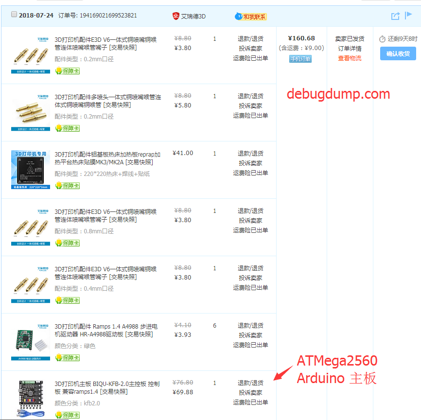

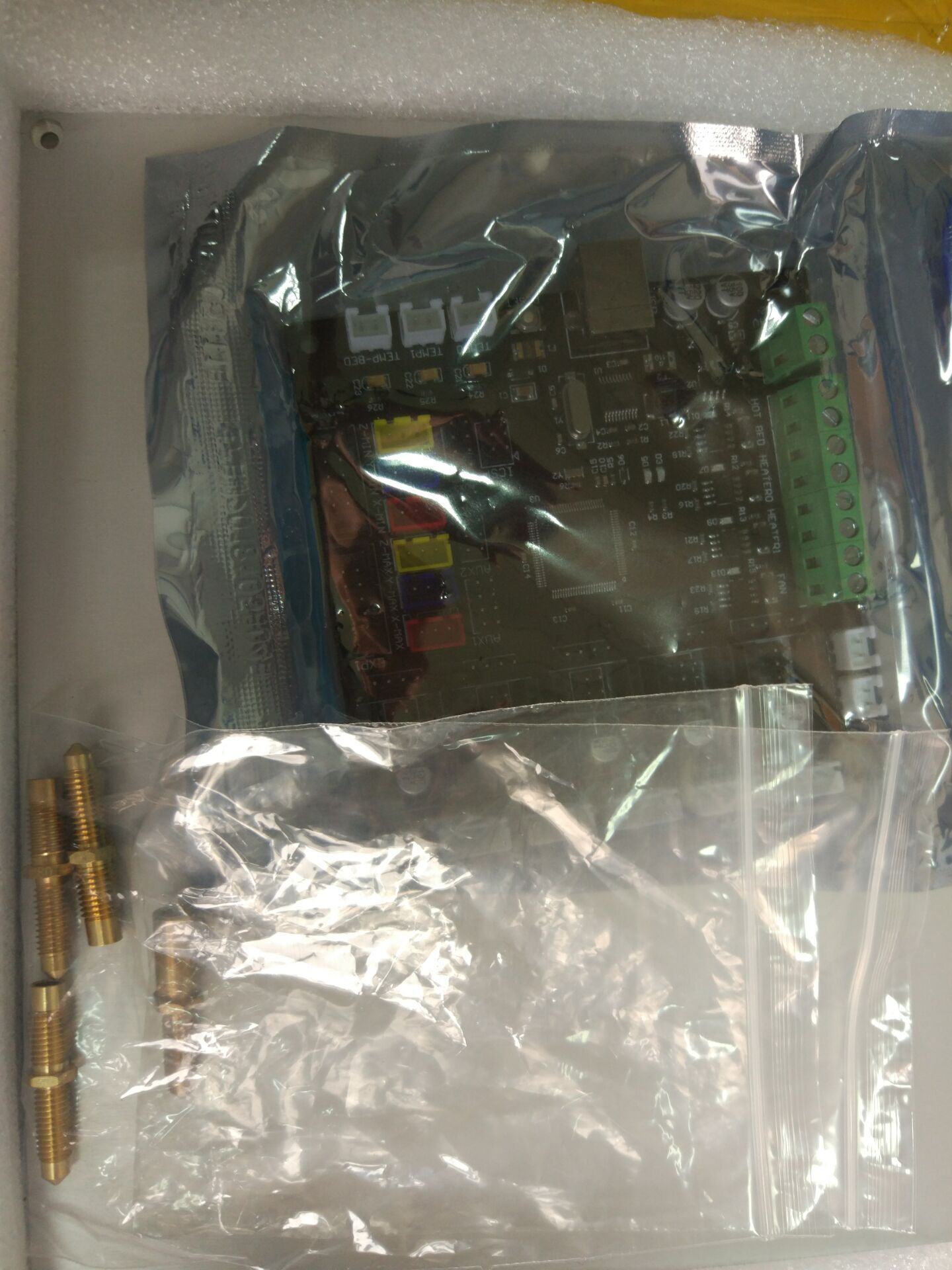

买一块3D打印机主板(ATMega2560)玩一下 Arduino 开发(从入门到放弃).

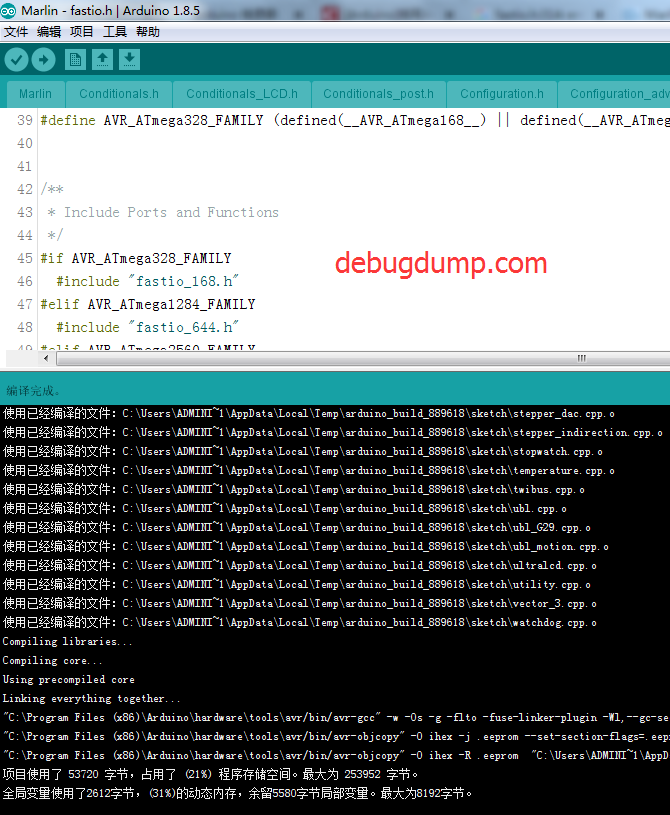

基于arduino 的 marlin 固件编译成功.
arduino-1.8.5-windows.exe 下载地址: https://www.arduino.cc/en/Main/Software
marlin 固件下载地址: https://github.com/MarlinFirmware/Marlin

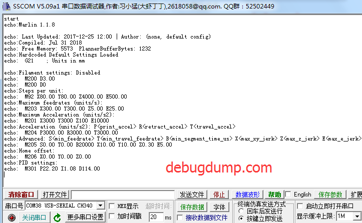

串口输出:
start
echo:Marlin 1.1.8
echo: Last Updated: 2017-12-25 12:00 | Author: BIQU
echo:Compiled: May 11 2018
echo: Free Memory: 3662  PlannerBufferBytes: 1232
echo:Hardcoded Default Settings Loaded
echo:  G21    ; Units in mm
echo:  M149 C ; Units in Celsius
echo:Filament settings: Disabled
echo:  M200 D1.75
echo:  M200 T1 D1.75
echo:  M200 D0
echo:Steps per unit:
echo:  M92 X100.00 Y100.00 Z100.00 E100.00
echo:Maximum feedrates (units/s):
echo:  M203 X300.00 Y300.00 Z300.00 E200.00
echo:Maximum Acceleration (units/s2):
echo:  M201 X1500 Y1500 Z1500 E1000
echo:Acceleration (units/s2): P<print_accel> R<retract_accel> T<travel_accel>
echo:  M204 P2500.00 R3000.00 T3000.00
echo:Advanced: S<min_feedrate> T<min_travel_feedrate> B<min_segment_time_us> X<max_xy_jerk> Z<max_z_jerk> E<max_e_jerk>
echo:  M205 S0.00 T0.00 B20000 X10.00 Y10.00 Z10.00 E5.00
echo:Hotend offsets:
echo:  M218 T1 X0.00 Y0.00
echo:Auto Bed Leveling:
echo:  M420 S0
echo:Endstop adjustment:
echo:  M666 X0.00 Y0.00 Z0.00
echo:Delta settings: L<diagonal_rod> R<radius> H<height> S<segments_per_s> B<calibration radius> XYZ<tower angle corrections>
echo:  M665 L337.59 R166.86 H310.00 S120.00 B115.00 X0.00 Y0.00 Z0.00
echo:Material heatup parameters:
echo:  M145 S0 H200 B50 F0
echo:  M145 S1 H230 B70 F0
echo:PID settings:
echo:  M301 P24.77 I1.84 D83.61
echo:Z-Probe Offset (mm):
echo:  M851 Z0.00
echo:SD init fail

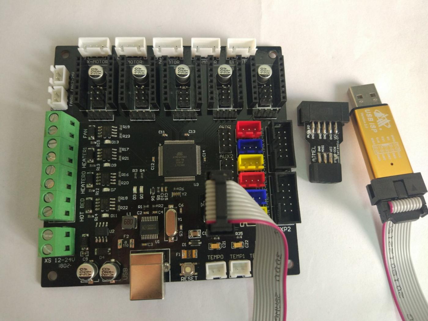

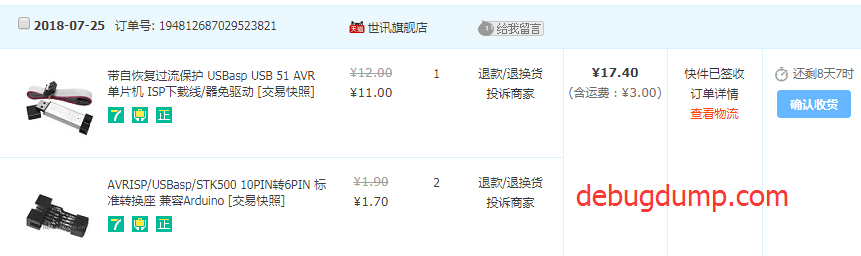

https://item.taobao.com/item.htm?id=544494880989
https://item.taobao.com/item.htm?id=530325320025

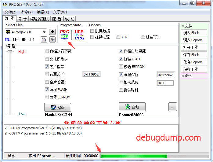

后来发现没有烧录器,不能继续愉快玩耍,所以赶紧淘宝买了一个 USBASP烧录器.
楼主 #7 2018-07-27 08:35:19
已发帖子: 9,442
Re: 买一块3D打印机主板(ATMega2560)玩一下 Arduino 开发(从入门到放弃).
使用 智峰1.72编程软件 一切正常, 免驱,使用hid驱动.

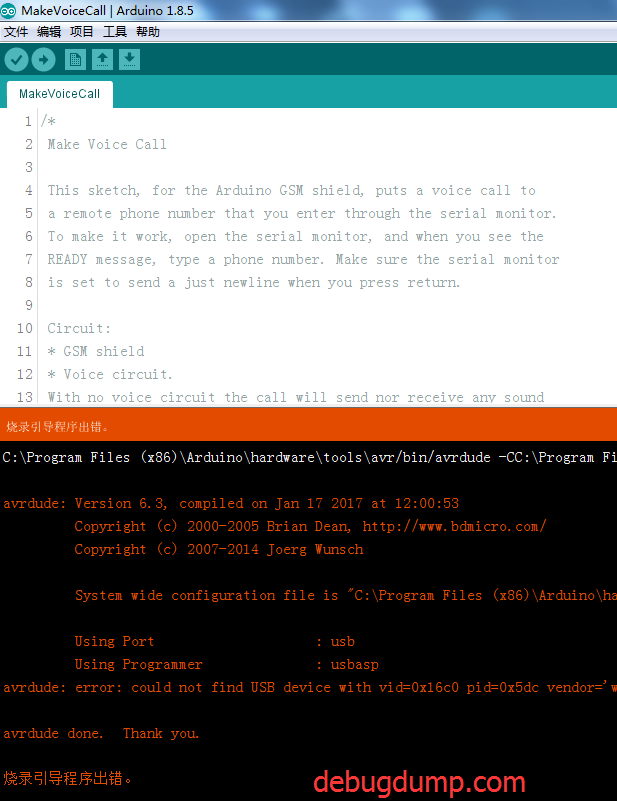

已发帖子: 9,442
Arduino:1.8.5 (Windows 7), 开发板:"Arduino/Genuino Mega or Mega 2560, ATmega2560 (Mega 2560)"
C:\Program Files (x86)\Arduino\hardware\tools\avr/bin/avrdude -CC:\Program Files (x86)\Arduino\hardware\tools\avr/etc/avrdude.conf -v -patmega2560 -cusbasp -Pusb -e -Ulock:w:0x3F:m -Uefuse:w:0xFD:m -Uhfuse:w:0xD8:m -Ulfuse:w:0xFF:m
avrdude: Version 6.3, compiled on Jan 17 2017 at 12:00:53
         Copyright (c) 2000-2005 Brian Dean, http://www.bdmicro.com/
         Copyright (c) 2007-2014 Joerg Wunsch
         System wide configuration file is "C:\Program Files (x86)\Arduino\hardware\tools\avr/etc/avrdude.conf"
         Using Port                    : usb
         Using Programmer              : usbasp
avrdude: error: could not find USB device with vid=0x16c0 pid=0x5dc vendor='www.fischl.de' product='USBasp'
avrdude done.  Thank you.
烧录引导程序出错。
使用 arduino ide 直接烧录出错.

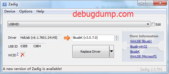

楼主 #9 2018-07-27 08:51:14
已发帖子: 9,442
https://rlogiacco.wordpress.com/2016/09/01/usbasp-windows-10/
按上面的url,把设备驱动改成了 libusbK, 然而并没有什么X用.

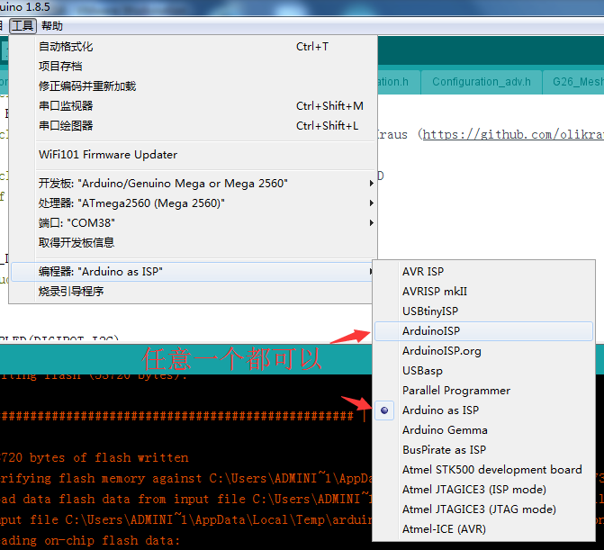

楼主 #10 2018-07-27 08:53:36
已发帖子: 9,442
http://irq5.io/2017/07/25/making-usbasp-chinese-clones-usable/
终于找到有用的了,
这哥们也是买了中国版的 usbasp,
结果此 usbasp并非彼 usbasp,
并不是标准的usbasp.
至于怎么能在 arduino ide 下用,还得仔细研究才行。

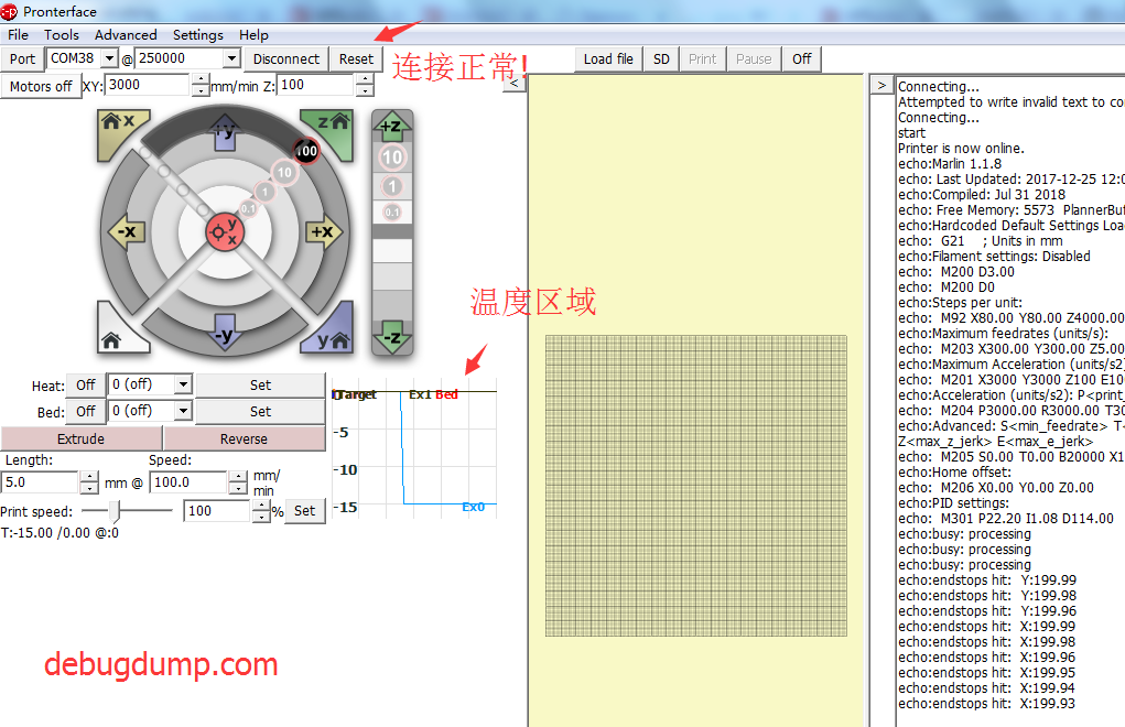

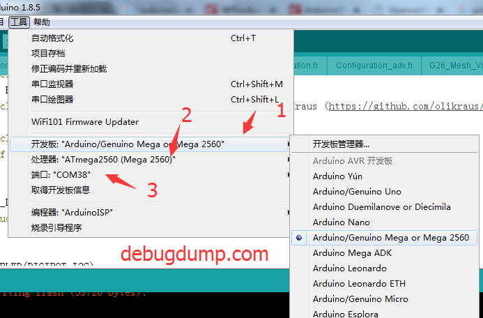

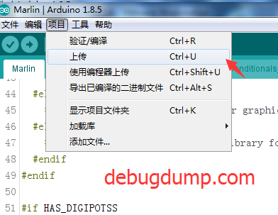

终于搞定 marlin 固件下载:
1. 下载 Arduino 集成开发环境
2. 克隆 https://github.com/MarlinFirmware/Marlin
3. Arduino IDE 打开 Marlin\Marlin.ino 项目, 按上图设置好环境, 点击 [项目] -> [上传] 即可烧录.
4. 接上串口, 默认波特率 250000, 我的串口软件没有这个波特率,所以用接近的 256000.
    波特率设置在 Configuration.h:
#define BAUDRATE 250000
5. 使用第三方3D打印机软件连接主板,
    参考 https://whycan.cn/t_786.html
串口输出:
start
echo:Marlin 1.1.8
echo: Last Updated: 2017-12-25 12:00 | Author: (none, default config)
echo:Compiled: Jul 31 2018
echo: Free Memory: 5573  PlannerBufferBytes: 1232
echo:  M200 D3.00
echo:  M200 D0
echo:  M92 X80.00 Y80.00 Z4000.00 E500.00
echo:  M203 X300.00 Y300.00 Z5.00 E25.00
echo:  M201 X3000 Y3000 Z100 E10000
echo:  M204 P3000.00 R3000.00 T3000.00
echo:  M205 S0.00 T0.00 B20000 X10.00 Y10.00 Z0.30 E5.00
echo:Home offset:
echo:  M206 X0.00 Y0.00 Z0.00
echo:PID settings:
echo:  M301 P22.20 I1.08 D114.00
总算入坑了, 咨询了几个朋友才搞定的, 差点就放弃治疗了。
