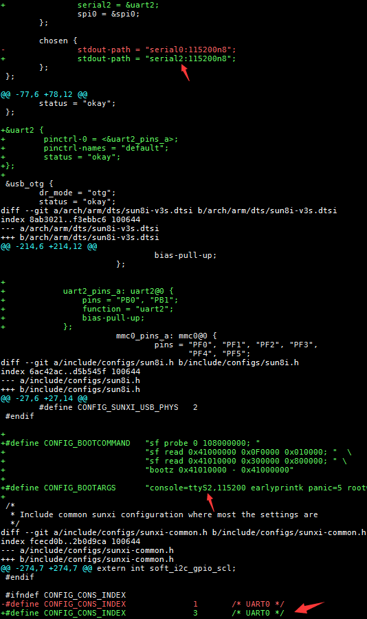

请问 荔枝派zero V3s主线u-boot 如何修改默认的串口为uart2(PB0/PB1) ?
git clone https://github.com/Lichee-Pi/u-boot.git -b v3s-spi-experimental
代码是上面这里下载到的.
默认是从 PB8,PB9 这组 UART0 输出的,
我现在想改到 PB0, PB1 这组 UART2 输出,
应该如何做到呢?

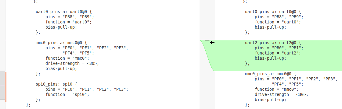

楼主 #2 2018-07-20 17:47:45
awfans
注册时间: 2018-04-03
已发帖子: 264
积分: 264
Re: 请问 荔枝派zero V3s主线u-boot 如何修改默认的串口为uart2(PB0/PB1) ?

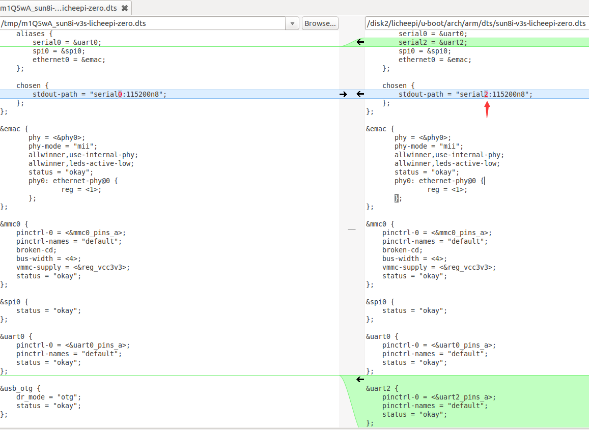

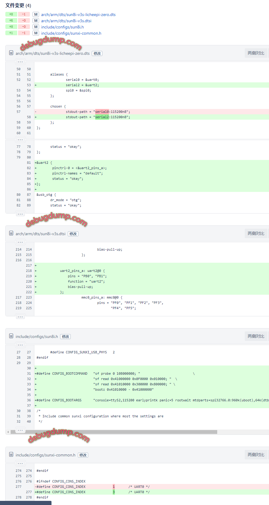

修改了这两个文件:
    modified:   arch/arm/dts/sun8i-v3s-licheepi-zero.dts

/dts-v1/;
#include "sun8i-v3s.dtsi"
#include "sunxi-common-regulators.dtsi"
	model = "Lichee Pi Zero";
	compatible = "licheepi,licheepi-zero", "allwinner,sun8i-v3s";

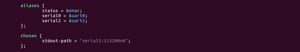

	aliases {
		serial0 = &uart0;
		serial2 = &uart2;
		spi0 = &spi0;
		ethernet0 = &emac;
	chosen {
		stdout-path = "serial2:115200n8";
&emac {
       phy = <&phy0>;
       phy-mode = "mii";
       allwinner,use-internal-phy;
       allwinner,leds-active-low;
       phy0: ethernet-phy@0 {
               reg = <1>;
&mmc0 {
	pinctrl-0 = <&mmc0_pins_a>;
	pinctrl-names = "default";
	broken-cd;
	bus-width = <4>;
	vmmc-supply = <&reg_vcc3v3>;
&spi0 {

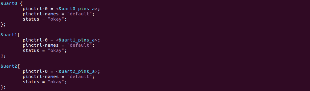

&uart0 {
	pinctrl-0 = <&uart0_pins_a>;
&uart2 {
	pinctrl-0 = <&uart2_pins_a>;
&usb_otg {
	dr_mode = "otg";
&usbphy {
	usb0_id_det-gpio = <&pio 5 6 GPIO_ACTIVE_HIGH>;
    modified:   arch/arm/dts/sun8i-v3s.dtsi

			uart0_pins_a: uart0@0 {
				pins = "PB8", "PB9";
				function = "uart0";
				bias-pull-up;
			uart2_pins_a: uart2@0 {
				pins = "PB0", "PB1";
				function = "uart2";
				bias-pull-up;

修改 arch/arm/dts/sun8i-v3s.dtsi:
                function = "uart0";
                bias-pull-up;
                function = "uart2";
                bias-pull-up;
修改 include/configs/sunxi-common.h
diff --git a/arch/arm/dts/sun8i-v3s-licheepi-zero.dts b/arch/arm/dts/sun8i-v3s-licheepi-zero.dts
index 3aec3eb..14376f1 100644
--- a/arch/arm/dts/sun8i-v3s-licheepi-zero.dts
+++ b/arch/arm/dts/sun8i-v3s-licheepi-zero.dts
@@ -50,11 +50,12 @@
        aliases {
                serial0 = &uart0;
+               serial2 = &uart2;
                spi0 = &spi0;
        chosen {
-               stdout-path = "serial0:115200n8";
+               stdout-path = "serial2:115200n8";
@@ -77,6 +78,12 @@
+&uart2 {
+        pinctrl-0 = <&uart2_pins_a>;
+        pinctrl-names = "default";
+        status = "okay";
 &usb_otg {
        dr_mode = "otg";
diff --git a/arch/arm/dts/sun8i-v3s.dtsi b/arch/arm/dts/sun8i-v3s.dtsi
index 8ab3021..f3ebbc6 100644
--- a/arch/arm/dts/sun8i-v3s.dtsi
+++ b/arch/arm/dts/sun8i-v3s.dtsi
@@ -214,6 +214,12 @@
                                bias-pull-up;
+            uart2_pins_a: uart2@0 {
+                pins = "PB0", "PB1";
+                function = "uart2";
+                bias-pull-up;
                        mmc0_pins_a: mmc0@0 {
                                pins = "PF0", "PF1", "PF2", "PF3",
                                       "PF4", "PF5";

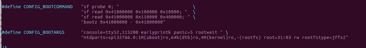

diff --git a/include/configs/sun8i.h b/include/configs/sun8i.h
index 6ac42ac..d5b545f 100644
--- a/include/configs/sun8i.h
+++ b/include/configs/sun8i.h
@@ -27,6 +27,14 @@
        #define CONFIG_SUNXI_USB_PHYS   2
+#define CONFIG_BOOTCOMMAND   "sf probe 0 108000000; "                           \
+                             "sf read 0x41000000 0x0F0000 0x010000; "  \
+                             "sf read 0x41010000 0x300000 0x800000; " \
+                             "bootz 0x41010000 - 0x41000000"
+#define CONFIG_BOOTARGS      "console=ttyS2,115200 earlyprintk panic=5 rootwait mtdparts=spi32766.0:960k(uboot),64k(dtb),1M(background),1M(animation),8M(kernel),-(appendfs) root=/dev/ram0 rdinit=/init vt.global_cursor_default=0"
  * Include common sunxi configuration where most the settings are
diff --git a/include/configs/sunxi-common.h b/include/configs/sunxi-common.h
index fcecd0b..2b0d9ca 100644
--- a/include/configs/sunxi-common.h
+++ b/include/configs/sunxi-common.h
@@ -274,7 +274,7 @@ extern int soft_i2c_gpio_scl;
 #ifndef CONFIG_CONS_INDEX
-#define CONFIG_CONS_INDEX              1       /* UART0 */
+#define CONFIG_CONS_INDEX              3       /* UART0 */
 #ifdef CONFIG_REQUIRE_SERIAL_CONSOLE

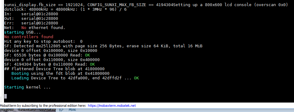

U-Boot 2017.01-rc2-00073-gdd6e874-dirty (Jul 21 2018 - 09:56:51 +0800) Allwinner Technology
Model: Lichee Pi Zero
DRAM:  64 MiB
MMC:   SUNXI SD/MMC: 0
In:    serial@01c28800
Out:   serial@01c28800
Err:   serial@01c28800
Net:   No ethernet found.
starting USB...
No controllers found
device 0 offset 0x110000, size 0x600000
SF: 6291456 bytes @ 0x110000 Read: OK
uboot 终于启动了.

看5楼图片

我对比了下 确实是一样的了 除下面
#define CONFIG_BOOTCOMMAND   "sf probe 0; "                           \
                             "sf read 0x41800000 0x100000 0x10000; "  \
#define CONFIG_BOOTARGS      "console=ttyS2,115200 earlyprintk panic=5 rootwait " \
                             "mtdparts=spi32766.0:1M(uboot)ro,64k(dtb)ro,4M(kernel)ro,-(rootfs) root=31:03 rw rootfstype=jffs2"
我这里就是将ttyS0改为ttyS2 因为以前串口0的时候是没有问题的  所以就是改为ttyS2
其他的都是一样的了

u-boot的bootargs参数 ttyS0 改为 ttyS2,
同时要在设备树开启 uart2.

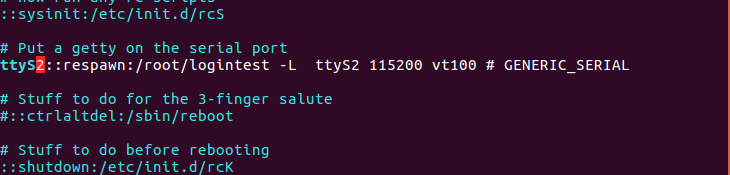

设置文件系统串口主要是在下面的截图在根文本系统/etc/inittab/
https://whycan.cn/files/members/1116/22222222.png
能进入命令行吗?能在命令行输入命令行吗?输入 ls cat 这些命令行有反应吗?
有反应的  就是设置下上面截图的地方 在文件系统中

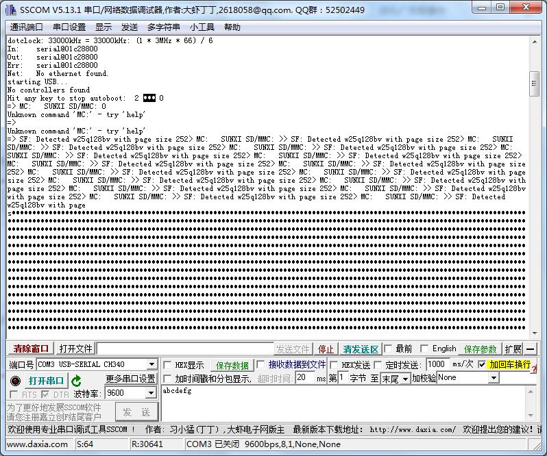

#27 2019-01-15 14:03:56
DavidV3s
注册时间: 2019-01-15
已发帖子: 36
积分: 36

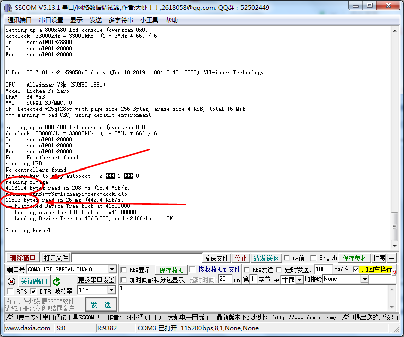

[13:56:14.987]ÊÕ¡û¡ô\0
[13:56:15.425]ÊÕ¡û¡ô¡U\0½¼À\0SPL 2017.01-rc2 (Jan 14 2019 - 21:52:58)
DRAM:\0\0MiB
Trying to boot from MMC1
[13:56:15.630]ÊÕ¡û¡ô¡\0U-Boot 2017.01-rc2 (Jan 14 2019 - 21:52:58 -0800) Allwinner Technologù
CPUz   Aüüÿéþþåò ^w÷ (WU^xI q~xq)
]ÿäåüz \éçèåå Pé zåòÿ
DRA]z  lp\0À\0\0W\0\0  WU^xI WD?]]Gz p
\0\0Detected w25q128bv with page size 256 Bùôå÷< åòá÷å ÷éúå t OéB< ôÿôáü q~ ]éB
\0%%º…À¸€¸œ\0- bad CRC, using default environment
y_Ïã\0õð á xppøtp`\0ØÆÀ\0ÆÞÜæÞØÀ\0\0ÞìÀàæÆÀÜ\0`x0)
[13:56:15.740]ÊÕ¡û¡ô`Œ°¼ŒŒà 33000kHz = 33000kHz: (1 * 3MHú * ~~) ? ~
[13:56:15.786]ÊÕ¡û¡ô\0\0   ÷åòéáü@pqærxp``\0ààp\0\0\0æÀàÀÀØ\0``Æ`p800
U-Boot 2017.01-rc2 (Jan 14 2019 - 21:52:58 -0800) Allwinner Technology
DRA]z  ~d À\0\0p\0\0\0\00\0\0\0C: 0
*** Warning - bad CRC, õ÷éþï äåîáõüô åþþéòÿþýåþô
Wåôôéþï õð á xppøtxp üçä çÿþ÷ÿüå (þìÀâæÆÀÜ\0`ð`\0\0ÀÞàÆØÞÆÆp\0f3000kHz =
[13:56:15.853]ÊÕ¡û¡ô 33000kHz: (1 * 3MHz * 66) / 6
In:    serial@01c28800
Err:   serial@01c2xx0p
Y—\0  No ethernet found.
starting USB>>>
^ÿ çÿþôòÿüüåò÷ îÿõþä
\00\0¸à\0ÆÀð\0ào stop autoboot:  2  0
=> ÀÀB  à€€`\0B <INTERRUPT~
}~ àB<pàüÀ€€À€Àظ€À€€€œ€˜€àðÀ€`\0ÀÞ`p€€À€Àظ€À€€€œ€˜€àðÀ\0€`\0ÀÞ`p€€À€Àظ€À€€€œ€˜€àðÀ<R\0UIIUAQù
=> ã8¼`\0€€Àظ€À€€€œ€˜€àðÀ<àÀÀð0¼`<R\0UIIUAQù
=> 8vÜ€À€€€œ€˜€àðÀ<ÀÀà\0<àÀÀðpƒ\0À€€€œ€˜€àðÀ\0ÀÀÀ<R\0UIIUAQù`
}~ |ððÀ€À\0€€€œ€˜€àðÀ\0ÀÀÀ<àÀÀðÀ€ÀÀ€À€€€œ€˜€àðÀ<R\0UIIUAQù

@晕哥,波特率改成9600,显示没有乱码了,但是有报错。
#38 2019-01-18 22:04:55
已发帖子: 9,440
DavidV3s 说:
可以输入吗?
#39 2019-01-18 22:27:38
DavidV3s
注册时间: 2019-01-15
已发帖子: 36
积分: 36
#40 2019-01-18 22:28:42
DavidV3s
注册时间: 2019-01-15
已发帖子: 36
积分: 36
不可以输入,一直循环打印这个。。。。。。。
#41 2019-01-18 22:29:55
DavidV3s
注册时间: 2019-01-15
已发帖子: 36
积分: 36
@晕哥,这个卡在什么地方了?
#42 2019-01-18 22:35:13
已发帖子: 9,440
只能换块板,或者换条usb线试一试了,usb线可能性大很多,可以逻辑分析仪先抓数据,如果逻辑分析仪抓到的数据没有问题,毫不犹豫换usb线

已发帖子: 9,440
DavidV3s 说:
自己做的
那你先去 u-boot  .config 里面把ddr和cpu频率都降下来再看,可能是你的板子跑不了那么高速度。
#51 2019-01-19 16:58:39
已发帖子: 9,440
DavidV3s 说:
自己做的
https://whycan.cn/t_699.html
感觉你的问题和这个一毛一样
#52 2019-01-19 17:40:06
DavidV3s
注册时间: 2019-01-15
已发帖子: 36
积分: 36
找了半天,没找到:)
#53 2019-01-19 18:28:05

[13:38:32.024]ÊÕ¡û¡ô 1
[13:38:33.025]ÊÕ¡û¡ô 0
[13:38:33.097]ÊÕ¡û¡ôreading zImage
3987592 bytes read in 206 ms (18.5 MiB/s)
11986 bytes read in 26 ms (450.2 KiB/s)
   Loading Device Tree to 42dfa000, end 42dffed1 ... OK

晕哥,内核打印改成串口2,还有什么地方需要修改的吗?我现在,串口0和串口2都接上电脑了,串口2还是卡在Starting kernel ...,串口0也没有输出
#66 2019-01-21 14:05:59
已发帖子: 9,440
DavidV3s 说:
你是如何修改成 串口2输出的? bootargs ?

更新下,直接写输出串口2 的地址没有问题,zImage解压正常

那现在正常了吗? 还是一样?
还是一样,Uncompressing Linux... done, booting the kernel. 出现这个后,下面就没有输出了。
#76 2019-01-21 15:53:26
已发帖子: 9,440
DavidV3s 说:
你恢复到 ttyS0 控制台, 然后操作 /dev/ttyS2, 看能否输入输出,
如果可以,说明硬件接口和设备树都没有问题,
如果不行可以, 说明上面的都可能有问题。
