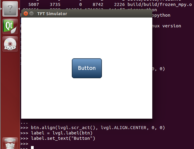

littlevgl 绑定 python (micropython) 脚本项目 ---- lv_mpy
https://github.com/kisvegabor/lv_mpy
  1. sudo apt-get install build-essential libreadline-dev libffi-dev git pkg-config libsdl2-2.0-0 libsdl2-dev
  2. git clone --recurse-submodules https://github.com/kisvegabor/lv_mpy.git
  3. cd ./micropython/ports/unix
  4. make axtls
  5. make
  6. ./micropython
Test code to craete a button and a label:
>>> import lvgl
>>> btn = lvgl.btn(lvgl.scr_act())
>>> btn.align(lvgl.scr_act(), lvgl.ALIGN.
>>> btn.align(lvgl.scr_act(), lvgl.ALIGN.CENTER, 0, 0)
>>> label = lvgl.label(btn)
>>> label.set_text("Button")

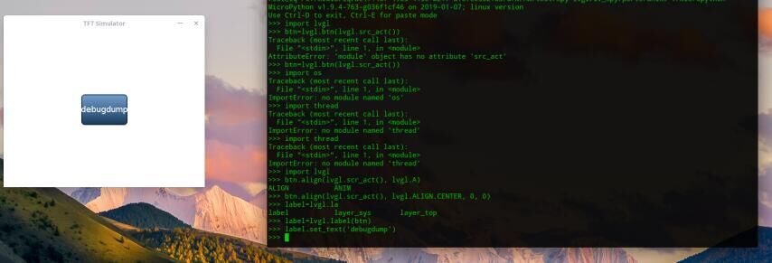

@assert 抢先试玩

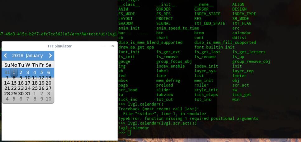

@assert 的 littlevgl micro python 按键按下回调函数 demo
