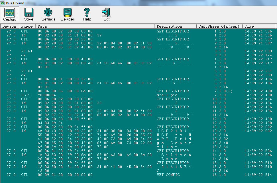

Bus Hound 6.01 capture on Windows Vista Service Pack 1 (x64). Complements of www.perisoft.net
Device - Device ID (followed by the endpoint for USB devices)
(20) VMware USB Device
(27) VMware USB Device
Phase - Phase Type
CTL USB control transfer
IN Data in transfer
RESET bus reset
USTS USB status
ok command complete
Data - Hex dump of the data transferred
Descr - Description of the phase
Cmd... - Position in the captured data
Time - Time the phase occurred in hour:minute:second.millisec form
Device Phase Data Description Cmd.Phase.Ofs(rep) Time
27.0 CTL 80 06 00 02 00 00 09 00 GET DESCRIPTOR 1.1.0 14:59:21.506
27.0 IN 09 02 20 00 01 01 00 80 32 .. .....2 1.2.0 14:59:21.506
27.0 CTL 80 06 00 02 00 00 20 00 GET DESCRIPTOR 2.1.0 14:59:21.507
27.0 IN 09 02 20 00 01 01 00 80 32 09 04 00 00 02 ff 00 .. .....2....... 2.2.0 14:59:21.507
00 02 07 05 01 02 40 00 00 07 05 82 02 40 00 00 ......@......@.. 2.2.16
27 RESET 3.1.0 14:59:22.033
27 ok 3.2.0 14:59:22.174
27.0 CTL 80 06 00 01 00 00 40 00 GET DESCRIPTOR 4.1.0 14:59:22.247
27.0 IN 12 01 00 02 00 00 00 40 c4 10 60 ea 00 01 01 02 .......@..`..... 4.2.0 14:59:22.247
03 01 .. 4.2.16
27 RESET 5.1.0 14:59:22.251
27 ok 5.2.0 14:59:22.393
27.0 CTL 80 06 00 01 00 00 12 00 GET DESCRIPTOR 6.1.0 14:59:22.486
27.0 IN 12 01 00 02 00 00 00 40 c4 10 60 ea 00 01 01 02 .......@..`..... 6.2.0 14:59:22.486
03 01 .. 6.2.16
27.0 CTL 80 06 00 06 00 00 0a 00 GET DESCRIPTOR 7.1.0(3) 14:59:22.488
27.0 USTS c0000004 stall pid 7.2.0 14:59:22.488
27.0 CTL 80 06 00 02 00 00 09 00 GET DESCRIPTOR 10.1.0 14:59:22.494
27.0 IN 09 02 20 00 01 01 00 80 32 .. .....2 10.2.0 14:59:22.494
27.0 CTL 80 06 00 02 00 00 20 00 GET DESCRIPTOR 11.1.0 14:59:22.496
27.0 IN 09 02 20 00 01 01 00 80 32 09 04 00 00 02 ff 00 .. .....2....... 11.2.0 14:59:22.496
00 02 07 05 01 02 40 00 00 07 05 82 02 40 00 00 ......@......@.. 11.2.16
27.0 CTL 80 06 00 03 00 00 ff 00 GET DESCRIPTOR 12.1.0 14:59:22.498
27.0 IN 04 03 09 04 .... 12.2.0 14:59:22.498
27.0 CTL 80 06 02 03 09 04 ff 00 GET DESCRIPTOR 13.1.0 14:59:22.502
27.0 IN 4a 03 43 00 50 00 32 00 31 00 30 00 34 00 20 00 J.C.P.2.1.0.4. . 13.2.0 14:59:22.502
55 00 53 00 42 00 20 00 74 00 6f 00 20 00 55 00 U.S.B. .t.o. .U. 13.2.16
41 00 52 00 54 00 20 00 42 00 72 00 69 00 64 00 A.R.T. .B.r.i.d. 13.2.32
67 00 65 00 20 00 43 00 6f 00 6e 00 74 00 72 00 g.e. .C.o.n.t.r. 13.2.48
6f 00 6c 00 6c 00 65 00 72 00 o.l.l.e.r. 13.2.64
27.0 CTL 80 06 01 03 09 04 ff 00 GET DESCRIPTOR 14.1.0 14:59:22.506
27.0 IN 1a 03 53 00 69 00 6c 00 69 00 63 00 6f 00 6e 00 ..S.i.l.i.c.o.n. 14.2.0 14:59:22.506
20 00 4c 00 61 00 62 00 73 00 .L.a.b.s. 14.2.16
27.0 CTL 80 06 03 03 09 04 ff 00 GET DESCRIPTOR 15.1.0 14:59:22.510
27.0 IN 12 03 30 00 31 00 36 00 31 00 41 00 45 00 34 00 ..0.1.6.1.A.E.4. 15.2.0 14:59:22.510
43 00 C. 15.2.16
27.0 CTL 00 09 01 00 00 00 00 00 SET CONFIG 16.1.0 14:59:22.514
CP2104

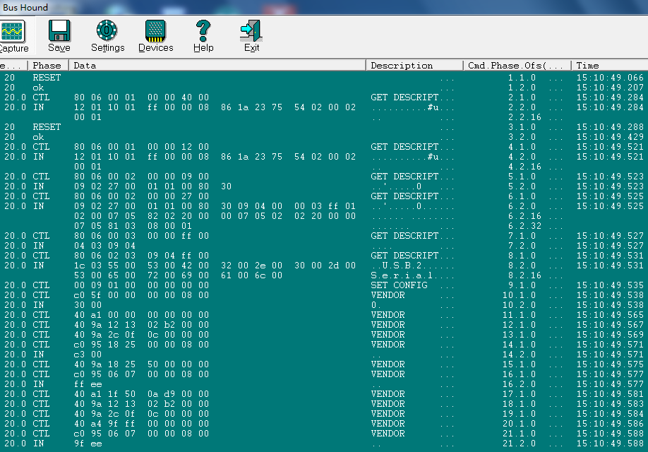

Phase - Phase Type
IN Data in transfer
RESET bus reset
ok command complete
20 RESET 1.1.0 15:10:49.066
20 ok 1.2.0 15:10:49.207
20.0 CTL 80 06 00 01 00 00 40 00 GET DESCRIPTOR 2.1.0 15:10:49.284
20.0 IN 12 01 10 01 ff 00 00 08 86 1a 23 75 54 02 00 02 ..........#uT... 2.2.0 15:10:49.284
00 01 .. 2.2.16
20 RESET 3.1.0 15:10:49.288
20 ok 3.2.0 15:10:49.429
20.0 CTL 80 06 00 01 00 00 12 00 GET DESCRIPTOR 4.1.0 15:10:49.521
20.0 IN 12 01 10 01 ff 00 00 08 86 1a 23 75 54 02 00 02 ..........#uT... 4.2.0 15:10:49.521
00 01 .. 4.2.16
20.0 CTL 80 06 00 02 00 00 09 00 GET DESCRIPTOR 5.1.0 15:10:49.523
20.0 IN 09 02 27 00 01 01 00 80 30 ..'.....0 5.2.0 15:10:49.523
20.0 CTL 80 06 00 02 00 00 27 00 GET DESCRIPTOR 6.1.0 15:10:49.525
20.0 IN 09 02 27 00 01 01 00 80 30 09 04 00 00 03 ff 01 ..'.....0....... 6.2.0 15:10:49.525
02 00 07 05 82 02 20 00 00 07 05 02 02 20 00 00 ...... ...... .. 6.2.16
07 05 81 03 08 00 01 ....... 6.2.32
20.0 CTL 80 06 00 03 00 00 ff 00 GET DESCRIPTOR 7.1.0 15:10:49.527
20.0 IN 04 03 09 04 .... 7.2.0 15:10:49.527
20.0 CTL 80 06 02 03 09 04 ff 00 GET DESCRIPTOR 8.1.0 15:10:49.531
20.0 IN 1c 03 55 00 53 00 42 00 32 00 2e 00 30 00 2d 00 ..U.S.B.2...0.-. 8.2.0 15:10:49.531
53 00 65 00 72 00 69 00 61 00 6c 00 S.e.r.i.a.l. 8.2.16
20.0 CTL 00 09 01 00 00 00 00 00 SET CONFIG 9.1.0 15:10:49.535
20.0 CTL c0 5f 00 00 00 00 08 00 VENDOR 10.1.0 15:10:49.538
20.0 IN 30 00 0. 10.2.0 15:10:49.538
20.0 CTL 40 a1 00 00 00 00 00 00 VENDOR 11.1.0 15:10:49.565
20.0 CTL 40 9a 12 13 02 b2 00 00 VENDOR 12.1.0 15:10:49.567
20.0 CTL 40 9a 2c 0f 0c 00 00 00 VENDOR 13.1.0 15:10:49.569
20.0 CTL c0 95 18 25 00 00 08 00 VENDOR 14.1.0 15:10:49.571
20.0 IN c3 00 .. 14.2.0 15:10:49.571
20.0 CTL 40 9a 18 25 50 00 00 00 VENDOR 15.1.0 15:10:49.575
20.0 CTL c0 95 06 07 00 00 08 00 VENDOR 16.1.0 15:10:49.577
20.0 IN ff ee .. 16.2.0 15:10:49.577
20.0 CTL 40 a1 1f 50 0a d9 00 00 VENDOR 17.1.0 15:10:49.581
20.0 CTL 40 9a 12 13 02 b2 00 00 VENDOR 18.1.0 15:10:49.583
20.0 CTL 40 9a 2c 0f 0c 00 00 00 VENDOR 19.1.0 15:10:49.584
20.0 CTL 40 a4 9f ff 00 00 00 00 VENDOR 20.1.0 15:10:49.586
20.0 CTL c0 95 06 07 00 00 08 00 VENDOR 21.1.0 15:10:49.588
20.0 IN 9f ee .. 21.2.0 15:10:49.588
CH340
