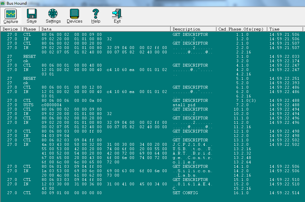

各种USB设备协议抓包
Bus Hound 6.01 capture on Windows Vista Service Pack 1 (x64). Complements of www.perisoft.net
  Device - Device ID (followed by the endpoint for USB devices)
            (20) VMware USB Device
            (27) VMware USB Device
  Phase  - Phase Type
            CTL   USB control transfer
            IN    Data in transfer
            RESET bus reset
            USTS  USB status
            ok    command complete
  Data   - Hex dump of the data transferred
  Descr  - Description of the phase
  Cmd... - Position in the captured data
  Time   - Time the phase occurred in hour:minute:second.millisec form
Device  Phase  Data                                                Description       Cmd.Phase.Ofs(rep)  Time
  27.0  CTL    80 06 00 02  00 00 09 00                            GET DESCRIPTOR           1.1.0        14:59:21.506
  27.0  IN     09 02 20 00  01 01 00 80  32                        .. .....2                1.2.0        14:59:21.506
  27.0  CTL    80 06 00 02  00 00 20 00                            GET DESCRIPTOR           2.1.0        14:59:21.507
  27.0  IN     09 02 20 00  01 01 00 80  32 09 04 00  00 02 ff 00  .. .....2.......         2.2.0        14:59:21.507
               00 02 07 05  01 02 40 00  00 07 05 82  02 40 00 00  ......@......@..         2.2.16
  27    RESET                                                                               3.1.0        14:59:22.033
  27    ok                                                                                  3.2.0        14:59:22.174
  27.0  CTL    80 06 00 01  00 00 40 00                            GET DESCRIPTOR           4.1.0        14:59:22.247
  27.0  IN     12 01 00 02  00 00 00 40  c4 10 60 ea  00 01 01 02  .......@..`.....         4.2.0        14:59:22.247
               03 01                                               ..                       4.2.16
  27    RESET                                                                               5.1.0        14:59:22.251
  27    ok                                                                                  5.2.0        14:59:22.393
  27.0  CTL    80 06 00 01  00 00 12 00                            GET DESCRIPTOR           6.1.0        14:59:22.486
  27.0  IN     12 01 00 02  00 00 00 40  c4 10 60 ea  00 01 01 02  .......@..`.....         6.2.0        14:59:22.486
               03 01                                               ..                       6.2.16
  27.0  CTL    80 06 00 06  00 00 0a 00                            GET DESCRIPTOR           7.1.0(3)     14:59:22.488
  27.0  USTS   c0000004                                            stall pid                7.2.0        14:59:22.488
  27.0  CTL    80 06 00 02  00 00 09 00                            GET DESCRIPTOR          10.1.0        14:59:22.494
  27.0  IN     09 02 20 00  01 01 00 80  32                        .. .....2               10.2.0        14:59:22.494
  27.0  CTL    80 06 00 02  00 00 20 00                            GET DESCRIPTOR          11.1.0        14:59:22.496
  27.0  IN     09 02 20 00  01 01 00 80  32 09 04 00  00 02 ff 00  .. .....2.......        11.2.0        14:59:22.496
               00 02 07 05  01 02 40 00  00 07 05 82  02 40 00 00  ......@......@..        11.2.16
  27.0  CTL    80 06 00 03  00 00 ff 00                            GET DESCRIPTOR          12.1.0        14:59:22.498
  27.0  IN     04 03 09 04                                         ....                    12.2.0        14:59:22.498
  27.0  CTL    80 06 02 03  09 04 ff 00                            GET DESCRIPTOR          13.1.0        14:59:22.502
  27.0  IN     4a 03 43 00  50 00 32 00  31 00 30 00  34 00 20 00  J.C.P.2.1.0.4. .        13.2.0        14:59:22.502
               55 00 53 00  42 00 20 00  74 00 6f 00  20 00 55 00  U.S.B. .t.o. .U.        13.2.16
               41 00 52 00  54 00 20 00  42 00 72 00  69 00 64 00  A.R.T. .B.r.i.d.        13.2.32
               67 00 65 00  20 00 43 00  6f 00 6e 00  74 00 72 00  g.e. .C.o.n.t.r.        13.2.48
               6f 00 6c 00  6c 00 65 00  72 00                     o.l.l.e.r.              13.2.64
  27.0  CTL    80 06 01 03  09 04 ff 00                            GET DESCRIPTOR          14.1.0        14:59:22.506
  27.0  IN     1a 03 53 00  69 00 6c 00  69 00 63 00  6f 00 6e 00  ..S.i.l.i.c.o.n.        14.2.0        14:59:22.506
               20 00 4c 00  61 00 62 00  73 00                      .L.a.b.s.              14.2.16
  27.0  CTL    80 06 03 03  09 04 ff 00                            GET DESCRIPTOR          15.1.0        14:59:22.510
  27.0  IN     12 03 30 00  31 00 36 00  31 00 41 00  45 00 34 00  ..0.1.6.1.A.E.4.        15.2.0        14:59:22.510
               43 00                                               C.                      15.2.16
  27.0  CTL    00 09 01 00  00 00 00 00                            SET CONFIG              16.1.0        14:59:22.514
CP2104

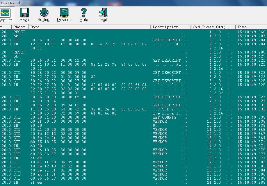

Re: 各种USB设备协议抓包
  Phase  - Phase Type
            IN    Data in transfer
            RESET bus reset
            ok    command complete
  20    RESET                                                                               1.1.0        15:10:49.066
  20    ok                                                                                  1.2.0        15:10:49.207
  20.0  CTL    80 06 00 01  00 00 40 00                            GET DESCRIPTOR           2.1.0        15:10:49.284
  20.0  IN     12 01 10 01  ff 00 00 08  86 1a 23 75  54 02 00 02  ..........#uT...         2.2.0        15:10:49.284
               00 01                                               ..                       2.2.16
  20    RESET                                                                               3.1.0        15:10:49.288
  20    ok                                                                                  3.2.0        15:10:49.429
  20.0  CTL    80 06 00 01  00 00 12 00                            GET DESCRIPTOR           4.1.0        15:10:49.521
  20.0  IN     12 01 10 01  ff 00 00 08  86 1a 23 75  54 02 00 02  ..........#uT...         4.2.0        15:10:49.521
               00 01                                               ..                       4.2.16
  20.0  CTL    80 06 00 02  00 00 09 00                            GET DESCRIPTOR           5.1.0        15:10:49.523
  20.0  IN     09 02 27 00  01 01 00 80  30                        ..'.....0                5.2.0        15:10:49.523
  20.0  CTL    80 06 00 02  00 00 27 00                            GET DESCRIPTOR           6.1.0        15:10:49.525
  20.0  IN     09 02 27 00  01 01 00 80  30 09 04 00  00 03 ff 01  ..'.....0.......         6.2.0        15:10:49.525
               02 00 07 05  82 02 20 00  00 07 05 02  02 20 00 00  ...... ...... ..         6.2.16
               07 05 81 03  08 00 01                               .......                  6.2.32
  20.0  CTL    80 06 00 03  00 00 ff 00                            GET DESCRIPTOR           7.1.0        15:10:49.527
  20.0  IN     04 03 09 04                                         ....                     7.2.0        15:10:49.527
  20.0  CTL    80 06 02 03  09 04 ff 00                            GET DESCRIPTOR           8.1.0        15:10:49.531
  20.0  IN     1c 03 55 00  53 00 42 00  32 00 2e 00  30 00 2d 00  ..U.S.B.2...0.-.         8.2.0        15:10:49.531
               53 00 65 00  72 00 69 00  61 00 6c 00               S.e.r.i.a.l.             8.2.16
  20.0  CTL    00 09 01 00  00 00 00 00                            SET CONFIG               9.1.0        15:10:49.535
  20.0  CTL    c0 5f 00 00  00 00 08 00                            VENDOR                  10.1.0        15:10:49.538
  20.0  IN     30 00                                               0.                      10.2.0        15:10:49.538
  20.0  CTL    40 a1 00 00  00 00 00 00                            VENDOR                  11.1.0        15:10:49.565
  20.0  CTL    40 9a 12 13  02 b2 00 00                            VENDOR                  12.1.0        15:10:49.567
  20.0  CTL    40 9a 2c 0f  0c 00 00 00                            VENDOR                  13.1.0        15:10:49.569
  20.0  CTL    c0 95 18 25  00 00 08 00                            VENDOR                  14.1.0        15:10:49.571
  20.0  IN     c3 00                                               ..                      14.2.0        15:10:49.571
  20.0  CTL    40 9a 18 25  50 00 00 00                            VENDOR                  15.1.0        15:10:49.575
  20.0  CTL    c0 95 06 07  00 00 08 00                            VENDOR                  16.1.0        15:10:49.577
  20.0  IN     ff ee                                               ..                      16.2.0        15:10:49.577
  20.0  CTL    40 a1 1f 50  0a d9 00 00                            VENDOR                  17.1.0        15:10:49.581
  20.0  CTL    40 9a 12 13  02 b2 00 00                            VENDOR                  18.1.0        15:10:49.583
  20.0  CTL    40 9a 2c 0f  0c 00 00 00                            VENDOR                  19.1.0        15:10:49.584
  20.0  CTL    40 a4 9f ff  00 00 00 00                            VENDOR                  20.1.0        15:10:49.586
  20.0  CTL    c0 95 06 07  00 00 08 00                            VENDOR                  21.1.0        15:10:49.588
  20.0  IN     9f ee                                               ..                      21.2.0        15:10:49.588
CH340
