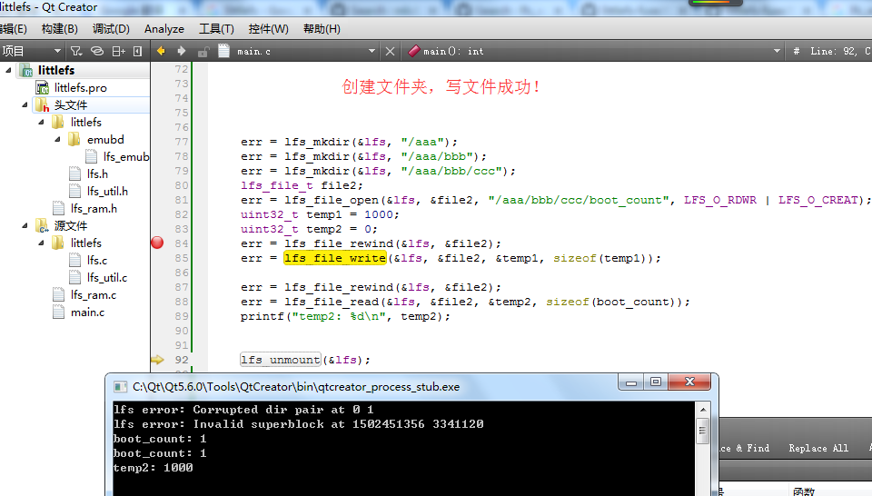

楼主 #6 2017-12-28 11:19:43
Re: LittleFS (lfs) -------- 一个高度完整的嵌入式文件系统
电脑上用一块缓冲区创建模拟flash,使用littlefs创建文件夹, 读写文件成功!

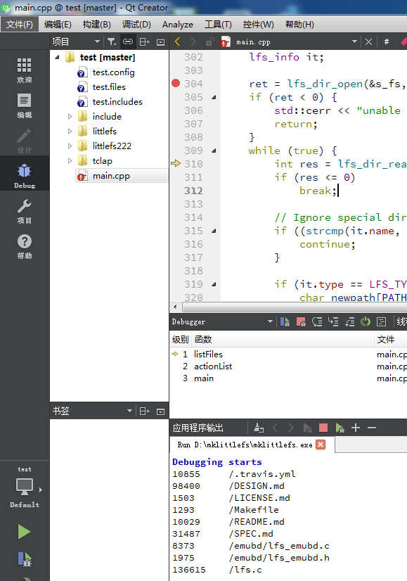

这个工具能生成文件系统镜像文件:
https://github.com/whitecatboard/Lua-RTOS-ESP32/blob/master/components/mklfs/src/mklfs.c
./mklfs -c target -b 1024 -r 1024 -p 1024 -s 1048576 -i out.img
楼主 #31 2019-05-05 16:30:07
发现这个不错: https://github.com/earlephilhower/mklittlefs
https://github.com/qq516333132/mklittlefs/blob/master/main.cpp

int littlefsTryMount() {
  setLfsConfig();
  int ret = lfs_mount(&s_fs, &s_cfg);
  if (ret) {
    s_mounted = false;
    return -1;
  s_mounted = true;
bool littlefsMount(){
  if (s_mounted)
    return true;
  int res = littlefsTryMount();
  return (res == 0);
void littlefsUnmount() {
  if (s_mounted) {
    lfs_unmount(&s_fs);
    s_mounted = false;
bool littlefsFormat(){
  littlefsUnmount();
  setLfsConfig();
  int formated = lfs_format(&s_fs, &s_cfg);

        s_action = ACTION_UNPACK;
    } else if (listArg.isSet()) {
        s_action = ACTION_LIST;
    s_imageName = outNameArg.getValue();
    s_imageSize = imageSizeArg.getValue();
    s_pageSize  = pageSizeArg.getValue();
    s_blockSize = blockSizeArg.getValue();
    s_addAllFiles = addAllFilesArg.isSet();
int main(int argc, const char * argv[]) {
    try {
        processArgs(argc, argv);
    } catch(...) {
        std::cerr << "Invalid arguments" << std::endl;
        return 1;
    switch (s_action) {
    case ACTION_PACK:
        return actionPack();
        break;
    case ACTION_UNPACK:
    	return actionUnpack();
        break;
    case ACTION_LIST:
        return actionList();
        break;
    default:
        break;
    return 1;
可以打包/解包 littlefs文件系统镜像,
mingw 编译在 main.cpp 要加一行:
extern "C" void __assert_func(
    const char *file, int line, const char *, const char *e) {
打包 target 目录 到 out.img 文件:
./mklittlefs.exe -c ./target/ -d 0 -b 1024 -p 1024 -s 1048576 out.img
解包 out.img 到 target_out 目录:
./mklittlefs.exe -u ./target_out/ -d 0 -b 1024 -p 1024 -s 1048576 out.img
列目录:
./mklittlefs.exe -l -d 0 -b 1024 -p 1024 -s 1048576 out.img
