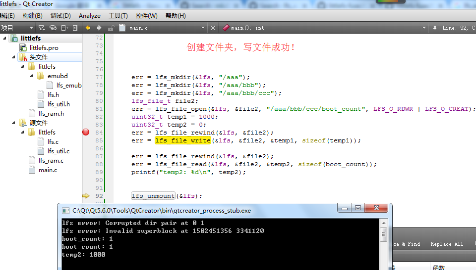

楼主 #6 2017-12-28 11:19:43
已发帖子: 9,445
Re: LittleFS (lfs) -------- 一个高度完整的嵌入式文件系统
电脑上用一块缓冲区创建模拟flash,使用littlefs创建文件夹, 读写文件成功!

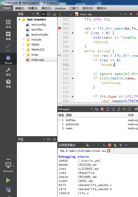

楼主 #9 2018-06-17 21:40:56
已发帖子: 9,445
达克罗德 说:
是针对nor还是nand?
代码没有oob,应该真对nor.

楼主 #31 2019-05-05 16:30:07
已发帖子: 9,445
发现这个不错: https://github.com/earlephilhower/mklittlefs
https://github.com/qq516333132/mklittlefs/blob/master/main.cpp

static uint32_t s_blockSize;
enum Action { ACTION_NONE, ACTION_PACK, ACTION_UNPACK, ACTION_LIST };
static Action s_action = ACTION_NONE;
static int s_debugLevel = 0;
static bool s_addAllFiles;
// Unless -a flag is given, these files/directories will not be included into the image
static const char* ignored_file_names[] = {
    ".DS_Store",
    ".git",
    ".gitignore",
    ".gitmodules"
int lfs_flash_read(const struct lfs_config *c, lfs_block_t block, lfs_off_t off, void *buffer, lfs_size_t size)
  memcpy(buffer, &s_flashmem[0] + c->block_size * block + off, size);
int lfs_flash_prog(const struct lfs_config *c, lfs_block_t block, lfs_off_t off, const void *buffer, lfs_size_t size)
  memcpy(&s_flashmem[0] + block * c->block_size + off, buffer, size);
int lfs_flash_erase(const struct lfs_config *c, lfs_block_t block)
  memset(&s_flashmem[0] + block * c->block_size, 0, c->block_size);
int lfs_flash_sync(const struct lfs_config *c) {
  (void) c;
// Implementation
static lfs_t s_fs;
static lfs_config s_cfg;
bool s_mounted = false;
void setLfsConfig()
  memset(&s_fs, 0, sizeof(s_fs));
  memset(&s_cfg, 0, sizeof(s_cfg));
  s_cfg.read  = lfs_flash_read;
  s_cfg.prog  = lfs_flash_prog;
  s_cfg.erase = lfs_flash_erase;
  s_cfg.sync  = lfs_flash_sync;
  s_cfg.read_size = s_blockSize;
  s_cfg.prog_size = s_blockSize;
  s_cfg.block_size = s_blockSize;
  s_cfg.block_count = s_flashmem.size() / s_blockSize;

void listFiles(const char *path) {
    int ret;
    lfs_dir_t dir;
    lfs_info it;
    ret = lfs_dir_open(&s_fs, &dir, path);
    if (ret < 0) {
        std::cerr << "unable to open directory '" << path << "'" << std::endl;
        return;
    while (true) {
        int res = lfs_dir_read(&s_fs, &dir, &it);
        if (res <= 0)
            break;
        // Ignore special dir entries
        if ((strcmp(it.name, ".") == 0) || (strcmp(it.name, "..") == 0)) {
            continue;
        if (it.type == LFS_TYPE_DIR) {
            char newpath[PATH_MAX];
            sprintf(newpath, "%s/%s", path, it.name);
            listFiles(newpath);
        } else {
            std::cout << it.size << '\t' << path << "/" << it.name << std::endl;
    lfs_dir_close(&s_fs, &dir);

int actionPack() {
    s_flashmem.resize(s_imageSize, 0xff);
    FILE* fdres = fopen(s_imageName.c_str(), "wb");
    if (!fdres) {
        std::cerr << "error: failed to open image file" << std::endl;
        return 1;
    littlefsFormat();
    int result = addFiles(s_dirName.c_str(), "/");
    littlefsUnmount();
    fwrite(&s_flashmem[0], 4, s_flashmem.size()/4, fdres);
    fclose(fdres);
    return result;

可以打包/解包 littlefs文件系统镜像,
mingw 编译在 main.cpp 要加一行:
extern "C" void __assert_func(
    const char *file, int line, const char *, const char *e) {
打包 target 目录 到 out.img 文件:
./mklittlefs.exe -c ./target/ -d 0 -b 1024 -p 1024 -s 1048576 out.img
解包 out.img 到 target_out 目录:
./mklittlefs.exe -u ./target_out/ -d 0 -b 1024 -p 1024 -s 1048576 out.img
列目录:
./mklittlefs.exe -l -d 0 -b 1024 -p 1024 -s 1048576 out.img
