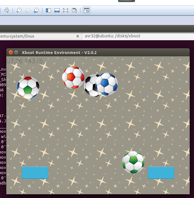

Ubuntu 下载编译运行xboot四部曲
1. 安装git, sdl等工具
sudo apt-get install git
sudo apt-get install libsdl2-dev
2. 下载源码
3.  编译
ARCH=x64 MACH=mach-sandbox make -j4
4. 运行
output/xboot

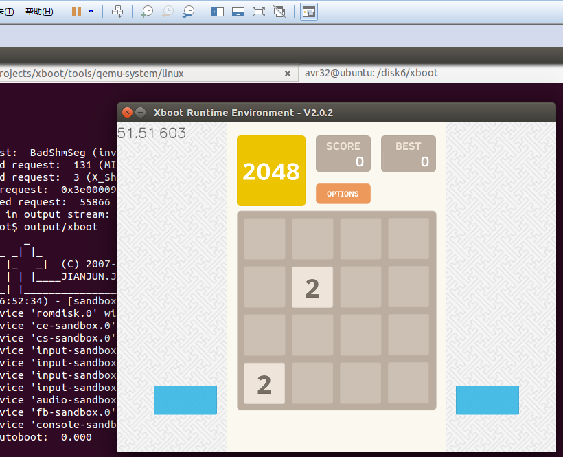

2048目录据此修改:
XBOOT(8192542) 18:19:24
jjj@jjj-desktop:~/xboot/xboot$ git diff   src/romdisk/application/examples/main.lua
diff --git a/src/romdisk/application/examples/main.lua b/src/romdisk/application/examples/main.lua
index bdcf5af..9148461 100644
--- a/src/romdisk/application/examples/main.lua
+++ b/src/romdisk/application/examples/main.lua
@@ -19,7 +19,7 @@ local prevbtn = Widget.Button.new({x = 50, y = sh - 100, width = 100, height = 5
stage:addChild(prevbtn)
local nextbtn = Widget.Button.new({x = sw - 150, y = sh - 100, width = 100, height = 50})
-       :addEventListener("Click", function(d, e) testcases:next() end)
+       :addEventListener("Click", function(d, e) stage:animate({scalex = 0.5, scaley = 0.5, rotation = stage:getRotation() + 360}, 5, "outBounce") end)
stage:addChild(nextbtn)
stage:addEventListener(Event.KEY_DOWN, function(d, e)
@@ -34,5 +34,8 @@ stage:addEventListener(Event.KEY_DOWN, function(d, e)
        e.stop = true
end)
+stage:setPosition(320,240)
+stage:setAnchor(0.5, 0.5)
+stage:animate({rotation = stage:getRotation() + 360}, 5, "outBounce")
stage:showfps(true)
实现旋转效果
