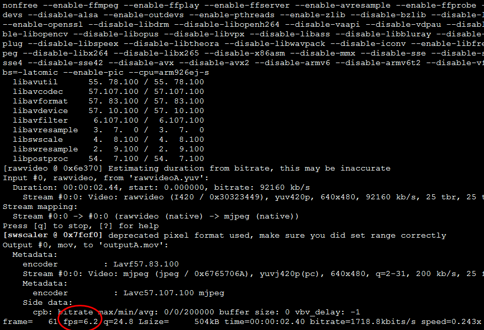

主频提升到 816Mhz, f1c100s 主线软件编码640x480 YUV文件为JPEG 格式, 帧率也只有6fps
# ffmpeg -s 640x480 -pix_fmt yuv420p -i rawvideoA.yuv -vcodec mjpeg outputA.mov
ffmpeg version 3.4.5 Copyright (c) 2000-2018 the FFmpeg developers
  built with gcc 7.4.0 (Buildroot 2019.02.2)
  configuration: --enable-cross-compile --cross-prefix=/opt/f1c100s/buildroot-2019.02.2/output/host/bin/arm-buildroot-linux-gnueabi- --sysroot=/opt/f1c100s/buildroot-2019.02.2/output/host/arm-buildroot-linux-gnueabi/sysroot --host-cc=/usr/bin/gcc --arch=arm --target-os=linux --disable-stripping --pkg-config=/opt/f1c100s/buildroot-2019.02.2/output/host/bin/pkg-config --disable-static --enable-shared --prefix=/usr --enable-avfilter --disable-version3 --enable-logging --enable-optimizations --disable-extra-warnings --enable-avdevice --enable-avcodec --enable-avformat --enable-network --disable-gray --enable-swscale-alpha --disable-small --enable-dct --enable-fft --enable-mdct --enable-rdft --disable-crystalhd --disable-dxva2 --enable-runtime-cpudetect --disable-hardcoded-tables --disable-mipsdsp --disable-mipsdspr2 --disable-msa --enable-hwaccels --disable-cuda --disable-cuvid --disable-nvenc --disable-avisynth --disable-frei0r --disable-libopencore-amrnb --disable-libopencore-amrwb --disable-libdc1394 --disable-libgsm --disable-libilbc --disable-libvo-amrwbenc --disable-symver --disable-doc --enable-gpl --enable-nonfree --enable-ffmpeg --enable-ffplay --enable-ffserver --enable-avresample --enable-ffprobe --enable-postproc --enable-swscale --enable-indevs --disable-alsa --enable-outdevs --enable-pthreads --enable-zlib --disable-bzlib --disable-libfdk-aac --disable-libcdio --disable-gnutls --enable-openssl --disable-libdrm --disable-libopenh264 --disable-vaapi --disable-vdpau --disable-mmal --disable-omx --disable-omx-rpi --disable-libopencv --disable-libopus --disable-libvpx --disable-libass --disable-libbluray --disable-librtmp --disable-libmp3lame --disable-libmodplug --disable-libspeex --disable-libtheora --disable-libwavpack --disable-iconv --enable-libfreetype --disable-fontconfig --disable-libopenjpeg --disable-libx264 --disable-libx265 --disable-x86asm --disable-mmx --disable-sse --disable-sse2 --disable-sse3 --disable-ssse3 --disable-sse4 --disable-sse42 --disable-avx --disable-avx2 --disable-armv6 --disable-armv6t2 --disable-vfp --disable-neon --disable-altivec --extra-libs=-latomic --enable-pic --cpu=arm926ej-s
  libavutil      55. 78.100 / 55. 78.100
  libavcodec     57.107.100 / 57.107.100
  libavformat    57. 83.100 / 57. 83.100
  libavdevice    57. 10.100 / 57. 10.100
  libavfilter     6.107.100 /  6.107.100
  libavresample   3.  7.  0 /  3.  7.  0
  libswscale      4.  8.100 /  4.  8.100
  libswresample   2.  9.100 /  2.  9.100
  libpostproc    54.  7.100 / 54.  7.100
[rawvideo @ 0x6e370] Estimating duration from bitrate, this may be inaccurate
Input #0, rawvideo, from 'rawvideoA.yuv':
  Duration: 00:00:02.44, start: 0.000000, bitrate: 92160 kb/s
    Stream #0:0: Video: rawvideo (I420 / 0x30323449), yuv420p, 640x480, 92160 kb/s, 25 tbr, 25 tbn, 25 tbc
Stream mapping:
  Stream #0:0 -> #0:0 (rawvideo (native) -> mjpeg (native))
Press [q] to stop, [?] for help
[swscaler @ 0x7fcf0] deprecated pixel format used, make sure you did set range correctly
Output #0, mov, to 'outputA.mov':
  Metadata:
    encoder         : Lavf57.83.100
    Stream #0:0: Video: mjpeg (jpeg / 0x6765706A), yuvj420p(pc), 640x480, q=2-31, 200 kb/s, 25 fps, 12800 tbn, 25 tbc
    Metadata:
      encoder         : Lavc57.107.100 mjpeg
    Side data:
      cpb: bitrate max/min/avg: 0/0/200000 buffer size: 0 vbv_delay: -1
frame=   61 fps=6.2 q=24.8 Lsize=     504kB time=00:00:02.40 bitrate=1718.8kbits/s speed=0.243x
video:503kB audio:0kB subtitle:0kB other streams:0kB global headers:0kB muxing overhead: 0.188468%

1、效果就是看转换的帧数?
2、为什么不用硬件的编码?
楼主 #11 2019-08-31 16:46:46
ffplay
注册时间: 2019-08-31
已发帖子: 92
积分: 92
Re: 主频提升到 816Mhz, f1c100s 主线软件编码640x480 YUV文件为JPEG 格式, 帧率也只有6fps
晕哥小弟 wrote:
1、效果就是看转换的帧数?
2、为什么不用硬件的编码?
  1. 一楼红色圈圈那一行可以看帧率,总帧数等
  2. 因为还不会,只能先软件搞搞
