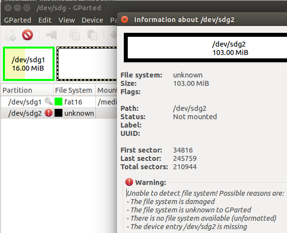

S3 ext4 根文件系统, 用着用着就挂了, 请问应该如何修复?

Re: S3 ext4 根文件系统, 用着用着就挂了, 请问应该如何修复?
Unable to detect file system! Possible reasons are:
- The file system is damaged
- The file system is unknown to GParted
- There is no file system available (unformatted)
- The device entry /dev/sdg2 is missing
gparted 提示的错误信息。

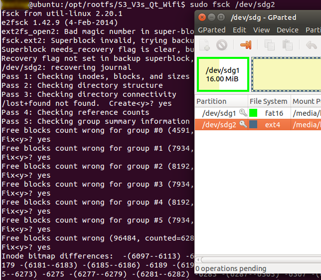

用 sudo fsck /dev/sdg2 修复了一堆错误, 用gparted看是正常了,插入S3重启试一试。
重启成功进入,怎么用才能像 Windows 一样开机自动修复文件系统错误呢?
