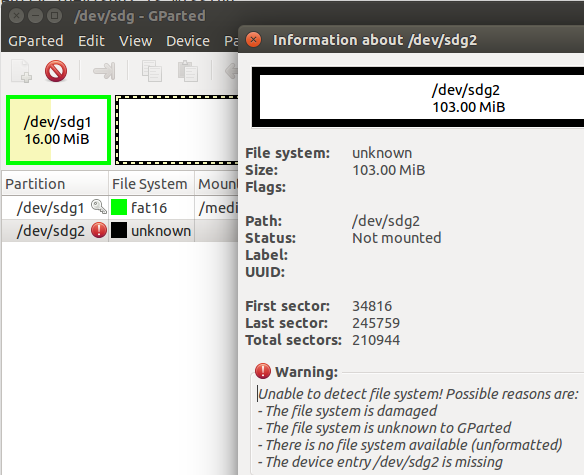

Unable to detect file system! Possible reasons are:
- The file system is damaged
- The file system is unknown to GParted
- There is no file system available (unformatted)
- The device entry /dev/sdg2 is missing
gparted 提示的错误信息。

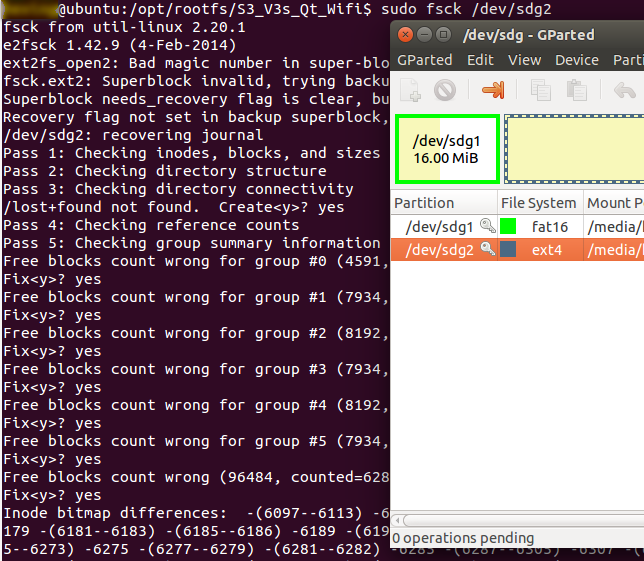

sudo fsck /dev/sdg2 修复了一堆错误, 用gparted看是正常了,插入S3重启试一试。
