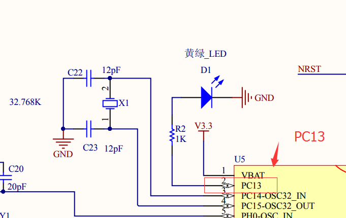

工程路径: STM32Cube_FW_L4_V1.11.0\Projects\NUCLEO-L432KC\Examples\GPIO\GPIO_IOToggle\MDK-ARM\Project.uvprojx
修改 stm32l4xx_nucleo_32.h:
#define LED3_PIN                           GPIO_PIN_13
#define LED3_GPIO_PORT                     GPIOC
#define LED3_GPIO_CLK_ENABLE()             __HAL_RCC_GPIOC_CLK_ENABLE()
#define LED3_GPIO_CLK_DISABLE()            __HAL_RCC_GPIOC_CLK_DISABLE()
可以点亮板子上的LED PC13

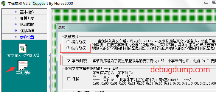

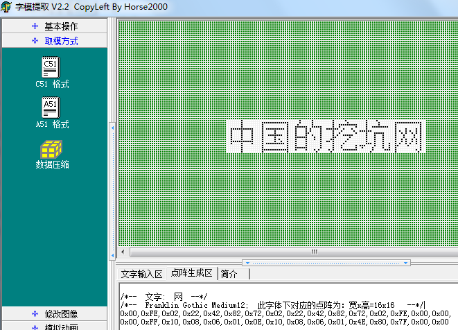

char Hzk[][32]={
/*--  文字:  中  --*/
/*--  Franklin Gothic Medium12;  此字体下对应的点阵为:宽x高=16x16   --*/
{0x00,0x00,0xF0,0x10,0x10,0x10,0x10,0xFF,0x10,0x10,0x10,0x10,0xF0,0x00,0x00,0x00,},
{0x00,0x00,0x0F,0x04,0x04,0x04,0x04,0xFF,0x04,0x04,0x04,0x04,0x0F,0x00,0x00,0x00},
/*--  文字:  国  --*/
{0x00,0xFE,0x02,0x12,0x92,0x92,0x92,0xF2,0x92,0x92,0x92,0x12,0x02,0xFE,0x00,0x00,},
{0x00,0xFF,0x40,0x48,0x48,0x48,0x48,0x4F,0x48,0x4A,0x4C,0x48,0x40,0xFF,0x00,0x00},
/*--  文字:  的  --*/
{0x00,0xF8,0x0C,0x0B,0x08,0x08,0xF8,0x40,0x30,0x8F,0x08,0x08,0x08,0xF8,0x00,0x00,},
{0x00,0x7F,0x21,0x21,0x21,0x21,0x7F,0x00,0x00,0x00,0x43,0x80,0x40,0x3F,0x00,0x00},
/*--  文字:  挖  --*/
{0x10,0x10,0x10,0xFF,0x10,0x90,0x4C,0x24,0x94,0x85,0x86,0x84,0x94,0x24,0x4C,0x00,},
{0x04,0x44,0x82,0x7F,0x01,0x00,0x00,0x30,0x48,0x44,0x42,0x41,0x40,0x40,0x70,0x00},
/*--  文字:  坑  --*/
{0x20,0x20,0x20,0xFF,0x20,0x20,0x08,0xC8,0x49,0x4E,0x48,0xC8,0x08,0x08,0x00,0x00,},
{0x10,0x30,0x10,0x0F,0x08,0x88,0x60,0x1F,0x00,0x00,0x00,0x3F,0x40,0x40,0x78,0x00},
/*--  文字:  网  --*/
{0x00,0xFE,0x02,0x22,0x42,0x82,0x72,0x02,0x22,0x42,0x82,0x72,0x02,0xFE,0x00,0x00,},
{0x00,0xFF,0x10,0x08,0x06,0x01,0x0E,0x10,0x08,0x06,0x01,0x4E,0x80,0x7F,0x00,0x00},
参考网址: https://whycan.cn/t_982.html
字模软件: zimoV2_2.rar

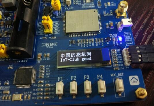

直接使用HAL库驱动 物联网俱乐部开发板 OLED液晶屏
下载地址: OLED.7z
解压位置: STM32Cube_FW_L4_V1.11.0\Projects\NUCLEO-L432KC\Examples
使用MDK5.xx 打开工程文件: STM32Cube_FW_L4_V1.11.0\Projects\NUCLEO-L432KC\Examples\OLED\GPIO_IOToggle\MDK-ARM\Project.uvprojx

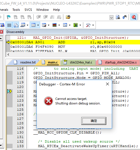

    /* Configure all GPIO port pins in Analog Input mode (floating input trigger OFF) */
    /* Note: Debug using ST-Link is not possible during the execution of this   */
    /*       example because communication between ST-link and the device       */
    /*       under test is done through UART. All GPIO pins are disabled (set   */

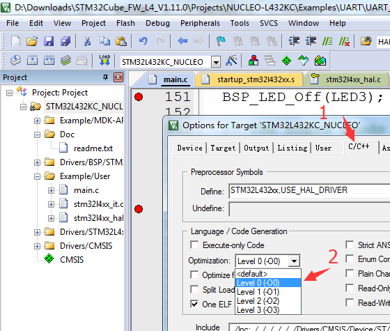

按上图可以解决 STM32Cube_FW_L4_V1.11.0 工程文件无法断点,或者断点异常问题。

发现一个问题, STM32L431进入休眠模式之后就没有办法调试了,Keil出现了错误。
现在正在搜索有没有办法解决这个问题。
Cannot access target. Shutting down debug session.
楼主 #11 2018-05-29 20:31:35
已发帖子: 9,439
Re: 测试 物联网俱乐部 STM32L431RCT6开发板外设
按照 tickless-mode.c 这个链接修改, 加入
HAL_DBGMCU_EnableDBGStopMode();
然而,并没有什么用处。
暂时不研究这个问题了, 现在研究 AT 指令与 BC95  模块通讯.

OLED_ShowCHinese(0,0,0);    //中
  OLED_ShowCHinese(18,0,1);    //国
  OLED_ShowCHinese(36,0,2);    //的
  OLED_ShowCHinese(54,0,3);    //挖
  OLED_ShowCHinese(72,0,4);    //坑
  OLED_ShowCHinese(90,0,5);    //网
{0x00,0x00,0x00,0x00,0x00,0x00,0x00,0x00,0x0F,0xF0,0x08,0x20,0x08,0x20,0x08,0x20},
{0x08,0x20,0xFF,0xFF,0x08,0x20,0x08,0x20,0x08,0x20,0x08,0x20,0x0F,0xF0,0x00,0x00},/*"中",0*/
{0x00,0x00,0x00,0x00,0x00,0x00,0x7F,0xFF,0x40,0x02,0x48,0x12,0x49,0x12,0x49,0x12},
{0x49,0x12,0x4F,0xF2,0x49,0x12,0x49,0x52,0x49,0x32,0x48,0x12,0x40,0x02,0x7F,0xFF},/*"国",1*/
{0x00,0x00,0x00,0x00,0x00,0x00,0x1F,0xFE,0x30,0x84,0xD0,0x84,0x10,0x84,0x10,0x84},
{0x1F,0xFE,0x02,0x00,0x0C,0x00,0xF1,0x00,0x10,0xC2,0x10,0x01,0x10,0x02,0x1F,0xFC},/*"的",2*/
{0x00,0x00,0x00,0x00,0x08,0x20,0x08,0x22,0x08,0x41,0xFF,0xFE,0x08,0x80,0x09,0x00},
{0x32,0x00,0x24,0x0C,0x29,0x12,0xA1,0x22,0x61,0x42,0x21,0x82,0x29,0x02,0x24,0x02},/*"挖",3*/
{0x00,0x00,0x00,0x00,0x04,0x08,0x04,0x0C,0x04,0x08,0xFF,0xF0,0x04,0x10,0x04,0x11},
{0x10,0x06,0x13,0xF8,0x92,0x00,0x72,0x00,0x12,0x00,0x13,0xFC,0x10,0x02,0x10,0x02},/*"坑",4*/
{0x00,0x00,0x00,0x00,0x00,0x00,0x7F,0xFF,0x40,0x08,0x44,0x10,0x42,0x60,0x41,0x80},
{0x4E,0x70,0x40,0x08,0x44,0x10,0x42,0x60,0x41,0x80,0x4E,0x72,0x40,0x01,0x7F,0xFE},/*"网",5*/
怎么关联的?有空指点不
