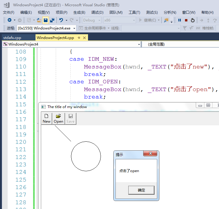

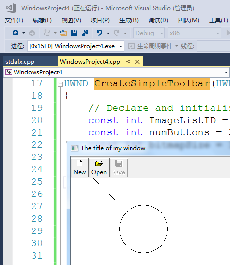

楼主 #3 2019-11-28 17:51:43
win32prog
注册时间: 2019-11-28
已发帖子: 138
积分: 138
Re: 发现一个不错的 win32 api 入门教程
#include <stdio.h>
#include <windows.h>
const wchar_t g_szClassName[] = L"myWindowClass";
void OnPaint(HWND hWnd)
    PAINTSTRUCT ps;
    HDC hdc = BeginPaint(hWnd,&ps);
    MoveToEx(hdc,0,0,0);
    LineTo(hdc,100,100);
    Ellipse(hdc, 100, 100, 200, 200);
    EndPaint(hWnd,&ps);
    return;
void OnPaint2(HWND hWnd)
    PAINTSTRUCT ps;
    HDC hdc = BeginPaint(hWnd, &ps);
    HPEN hPen = CreatePen(PS_DASHDOTDOT, 2, NULL);
    SelectObject(hdc, hPen);
    Ellipse(hdc, 100, 200, 400, 400);
    Ellipse(hdc, 300, 300, 500, 510);
    DeleteObject(hPen);
    EndPaint(hWnd, &ps);
// Step 4: the Window Procedure
LRESULT CALLBACK WndProc(HWND hwnd, UINT msg, WPARAM wParam, LPARAM lParam)
    switch(msg)
		case WM_ERASEBKGND:
            printf("erase back\n");
            fflush(stdout);
			return DefWindowProc(hwnd, msg, wParam, lParam);
        case WM_MOVE:
            printf("move\n");
            fflush(stdout);
        case WM_PAINT:
			OnPaint(hwnd);
            //MessageBoxW(hwnd, L"painting ...", L"p", MB_OK);
            printf("painting...\n");
            fflush(stdout);
            //return DefWindowProc(hwnd, msg, wParam, lParam);
        break;
        case WM_LBUTTONDOWN:
            //wchar_t szFileName[MAX_PATH];
            //HINSTANCE hInstance = GetModuleHandle(NULL);
            //GetModuleFileNameW(hInstance, szFileName, MAX_PATH);
            //MessageBoxW(hwnd, szFileName, L"This program is:", MB_OK | MB_ICONINFORMATION);
			break;
        case WM_CLOSE:
            DestroyWindow(hwnd);
        break;
        case WM_DESTROY:
            PostQuitMessage(0);
        break;
        default:
int WINAPI WinMain(HINSTANCE hInstance, HINSTANCE hPrevInstance,
    LPSTR lpCmdLine, int nCmdShow)
    WNDCLASSEXW wc;
    HWND hwnd;
    MSG Msg;
    //Step 1: Registering the Window Class
    wc.cbSize        = sizeof(WNDCLASSEX);
    wc.style         = 0;
    wc.lpfnWndProc   = WndProc;
    wc.cbClsExtra    = 0;
    wc.cbWndExtra    = 0;
    wc.hInstance     = hInstance;
    wc.hIcon         = LoadIcon(NULL, IDI_APPLICATION);
    wc.hCursor       = LoadCursor(NULL, IDC_ARROW);
    wc.hbrBackground = (HBRUSH)(COLOR_WINDOW+1);
    wc.lpszMenuName  = NULL;
    wc.lpszClassName = g_szClassName;
    wc.hIconSm       = LoadIcon(NULL, IDI_APPLICATION);
    if(!RegisterClassExW(&wc))
        MessageBoxW(NULL, L"Window Registration Failed!", L"Error!",
            MB_ICONEXCLAMATION | MB_OK);
    // Step 2: Creating the Window
    hwnd = CreateWindowExW(
        WS_EX_CLIENTEDGE,
        g_szClassName,
        L"The title of my window",
        WS_OVERLAPPEDWINDOW,
        CW_USEDEFAULT, CW_USEDEFAULT, 640, 480,
        NULL, NULL, hInstance, NULL);
    if(hwnd == NULL)
        MessageBoxW(NULL, L"Window Creation Failed!", L"Error!",
    ShowWindow(hwnd, nCmdShow);
    UpdateWindow(hwnd);
    // Step 3: The Message Loop
    while(GetMessage(&Msg, NULL, 0, 0) > 0)
        TranslateMessage(&Msg);
        DispatchMessage(&Msg);
    return (int)Msg.wParam;
mingw 编译:  gcc -o test1 test1.c -luser32 -lgdi32
msvc 编译: cl  test1.c gdi32.lib user32.lib

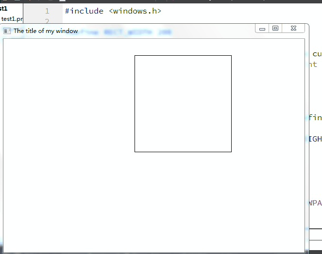

楼主 #5 2019-11-29 17:07:44
win32prog
注册时间: 2019-11-28
已发帖子: 138
积分: 138
手动撸的一个定时器更新 gdi 的demo:
#define RECT_WIDTH 200
#define RECT_HEIGHT 200
// x and y are the x- and y-locations of the mouse cursor upon release
void drawRectangle(HWND hwnd, const int x, const int y)
    // obtain a handle to the device context
    HDC hdc = GetDC(hwnd);
    // RECT_WIDTH and RECT_HEIGHT are elsewhere defined
    // draw rectangle
    Rectangle(hdc, x - RECT_WIDTH / 2, y - RECT_HEIGHT / 2, x + RECT_WIDTH / 2, y + RECT_HEIGHT / 2);
    // release the DC
    ReleaseDC(hwnd, hdc);
LRESULT APIENTRY WndProc(HWND hwnd, UINT message, WPARAM wParam, LPARAM lParam)
    static int x, y;
    PAINTSTRUCT ps;
    switch (message)
		case WM_CREATE:
			SetTimer(hwnd, 0, 200, NULL);
			break;
		case WM_TIMER:
			RECT rect;
			do
                x = rand();
			while(x < 0 || x > 500);
			do
                y = rand();
			while(y < 0 || y > 500);
			GetClientRect(hwnd, &rect);
			InvalidateRect(hwnd, &rect, 1);
			break;
		case WM_PAINT:
            BeginPaint(hwnd, &ps);
			// draw the rectangle
			drawRectangle(hwnd, x, y);
			EndPaint(hwnd, &ps);
		case WM_CLOSE:
			break;
		case WM_DESTROY:
			PostQuitMessage(0);
			break;
		default:
			return DefWindowProc(hwnd, message, wParam, lParam);
    WNDCLASSEXW wc;
    HWND hwnd;
    MSG Msg;
    srand(0);
    wc.style         = 0;
    wc.cbClsExtra    = 0;
    wc.cbWndExtra    = 0;
        WS_EX_CLIENTEDGE,
        g_szClassName,
    if(hwnd == NULL)
    UpdateWindow(hwnd);
参考: https://stackoverflow.com/questions/28925178/drawing-rectangle-in-c-using-functions

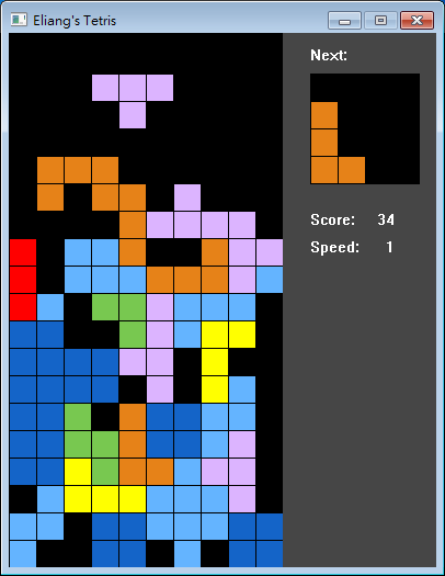

楼主 #6 2019-11-29 17:13:52
win32prog
注册时间: 2019-11-28
已发帖子: 138
积分: 138
#include "Piece.h"
#include "Game.h"
#include <iostream>
using namespace std;
const int PX_PER_BLOCK = 25;    // Cell size in pixels
const int SCREEN_WIDTH = 10;    // Level width in cells
const int SCREEN_HEIGHT = 20;   // Level height in cells
const int GAME_SPEED = 33;      // Update the game every GAME_SPEED millisecs (= 1/fps)
const int TIMER_ID = 1;
LRESULT CALLBACK WndProc(HWND, UINT, WPARAM, LPARAM);
                   PSTR szCmdLine, int iCmdShow)
    static TCHAR szAppName[] = TEXT("tetris");
    HWND hwnd;
    MSG msg;
    WNDCLASSEX wc;
    // We need to repaint a lot, using CS_OWNDC is more efficient
    wc.style = CS_HREDRAW | CS_VREDRAW | CS_OWNDC;
    wc.cbClsExtra = 0;
    wc.cbWndExtra = 0;
    wc.hbrBackground = (HBRUSH)GetStockObject(BLACK_BRUSH);
    wc.lpszClassName = szAppName;
    wc.hIconSm = NULL;
    if (!RegisterClassEx(&wc))
        MessageBox(NULL, TEXT("Program requires Windows NT!"),
                   szAppName, MB_ICONERROR);
    hwnd = CreateWindow(szAppName,
                        TEXT("Eliang's Tetris"),
                        WS_MINIMIZEBOX | WS_SYSMENU,  // No window resizing
                        CW_USEDEFAULT,
                        CW_USEDEFAULT,
                        SCREEN_WIDTH * PX_PER_BLOCK + 156,
                        SCREEN_HEIGHT * PX_PER_BLOCK + 25,
                        NULL,
                        NULL,
                        hInstance,
                        NULL);
    ShowWindow(hwnd, iCmdShow);
    UpdateWindow(hwnd);
    while (GetMessage(&msg, NULL, 0, 0))
        TranslateMessage(&msg);
        DispatchMessage(&msg);
    return msg.wParam;
LRESULT CALLBACK WndProc(HWND hwnd, UINT message, WPARAM wParam, LPARAM lParam)
    HDC hdc;
    PAINTSTRUCT ps;
    static Game *game;
    static DrawEngine *de;
    switch (message)
        case WM_CREATE:
            hdc = GetDC(hwnd);
            de = new DrawEngine(hdc, hwnd, PX_PER_BLOCK);
            game = new Game(*de);
            SetTimer(hwnd, TIMER_ID, GAME_SPEED, NULL);
        case WM_KEYDOWN:
            game->keyPress(wParam);
        case WM_TIMER:
            game->timerUpdate();
        case WM_KILLFOCUS:
            KillTimer(hwnd, TIMER_ID);
            game->pause(true);
        case WM_SETFOCUS:
        case WM_PAINT:
            hdc = BeginPaint(hwnd, &ps);
            game->repaint();
        case WM_DESTROY:
            delete de;
            delete game;
            PostQuitMessage(0);
https://github.com/eliangcs/tetris-win32
https://github.com/eliangcs/tetris-win32/blob/master/src/main.cpp
仅用 win32 api 做的俄罗斯方块。

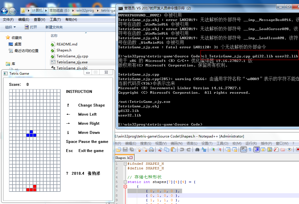

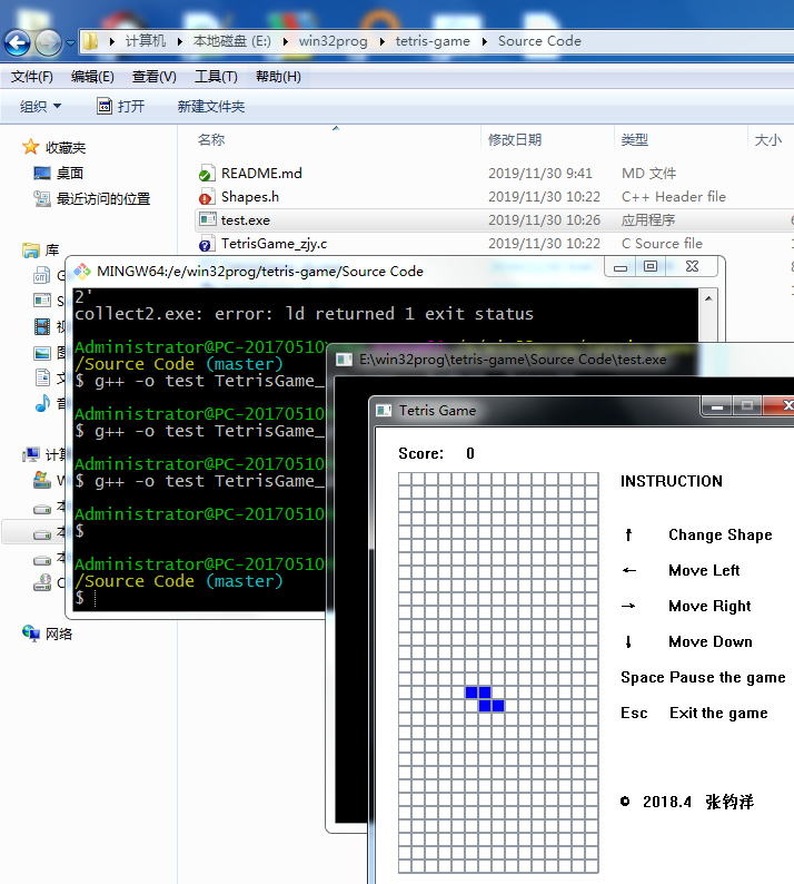

楼主 #7 2019-11-30 09:49:32
win32prog
注册时间: 2019-11-28
已发帖子: 138
积分: 138
找到一个更精简的 俄罗斯方块: https://github.com/VincentJYZhang/tetris-game/tree/master/Source%20Code
TetrisGame_zjy.cpp
// TetrisGame_zjy.cpp
// by 张钧洋
// 2018.4.10
#include <stdio.h>
#include <time.h>
#include "Shapes.h"
#define ID_TIMER  1
#define TIME_INTERVAL 1000   // 下落时间间隔1秒
VOID    CALLBACK TimerProc(HWND, UINT, UINT, DWORD);
/*---------------宏-------------------*/
#define BOARD_WIDTH 180
#define BOARD_HEIGHT 400
#define LONG_SLEEP 300
#define COLS 15  // 列数
#define ROWS 30  // 行数
#define EXTENDED_COLS 23  // 包括不显示区域的列数
#define EXTENDED_ROWS 34  // 包括不显示区域的行数
// 游戏界面实际的方格位置
#define BOARD_LEFT 4
#define BOARD_RIGHT 18
#define BOARD_TOP 0
#define BOARD_BOTTOM 29
/*-------------参数声明---------------*/
// static int shapes[7][4][4];
static int shape[4][4];
static int score = 0;
static int shape_row = 0;  // 当前形状所在行
static int shape_col = EXTENDED_COLS / 2 - 2; // 当前形状所在列
static int **gBoard;
static int lattices_top = 40;   // 上面留白
static int lattices_left = 20;  // 左侧留白
static int width = BOARD_WIDTH / COLS;                    //每个格子的宽度
static int height = (BOARD_HEIGHT - lattices_top) / ROWS; //每个格子的高度
static HBRUSH grey_brush = CreateSolidBrush(RGB(210, 210, 210));
static HBRUSH white_brush = CreateSolidBrush(RGB(255, 255, 255));
static HBRUSH red_brush = CreateSolidBrush(RGB(255, 0, 0));
static HBRUSH blue_brush = CreateSolidBrush(RGB(0, 0, 255));
static HPEN hPen = CreatePen(PS_SOLID, 1, RGB(147, 155, 166));

楼主 #8 2019-11-30 11:04:03
win32prog
注册时间: 2019-11-28
已发帖子: 138
积分: 138

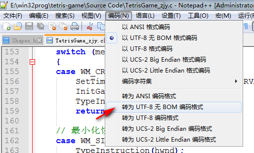

上面代码用 mingw 编译还有点坑, 要 notepad++ 转码一下
g++ -o test TetrisGame_zjy.c  -lgdi32 -luser32 -DUNICODE
咦, 为什么背后还要启动一个黑窗口呢?
#9 2019-11-30 11:16:46
夏雨夜寐
注册时间: 2019-08-23
已发帖子: 85
积分: 74.5
启动了控制台调试吧?
楼主 #10 2019-11-30 11:26:46
win32prog
注册时间: 2019-11-28
已发帖子: 138
积分: 138
夏雨夜寐 说:
启动了控制台调试吧?
这个编译指令要加点什么吗?

楼主 #13 2019-11-30 15:57:08
win32prog
注册时间: 2019-11-28
已发帖子: 138
积分: 138
win32prog 说:
这个编译指令要加点什么吗?
终于搞定,
g++ -o test TetrisGame_zjy.c  -lgdi32 -luser32 -DUNICODE -mwindows
这样就没有黑窗口了。
https://stackoverflow.com/questions/13100785/mingw-build-gui-application-with-console

    ShowWindow(hWndToolbar,  TRUE);
    return hWndToolbar;
借鉴微软这段代码, 自己写了一个:

楼主 #18 2019-12-09 14:53:58
win32prog
注册时间: 2019-11-28
已发帖子: 138
积分: 138

添加了工具栏 toolbar wm_command 消息响应代码.
