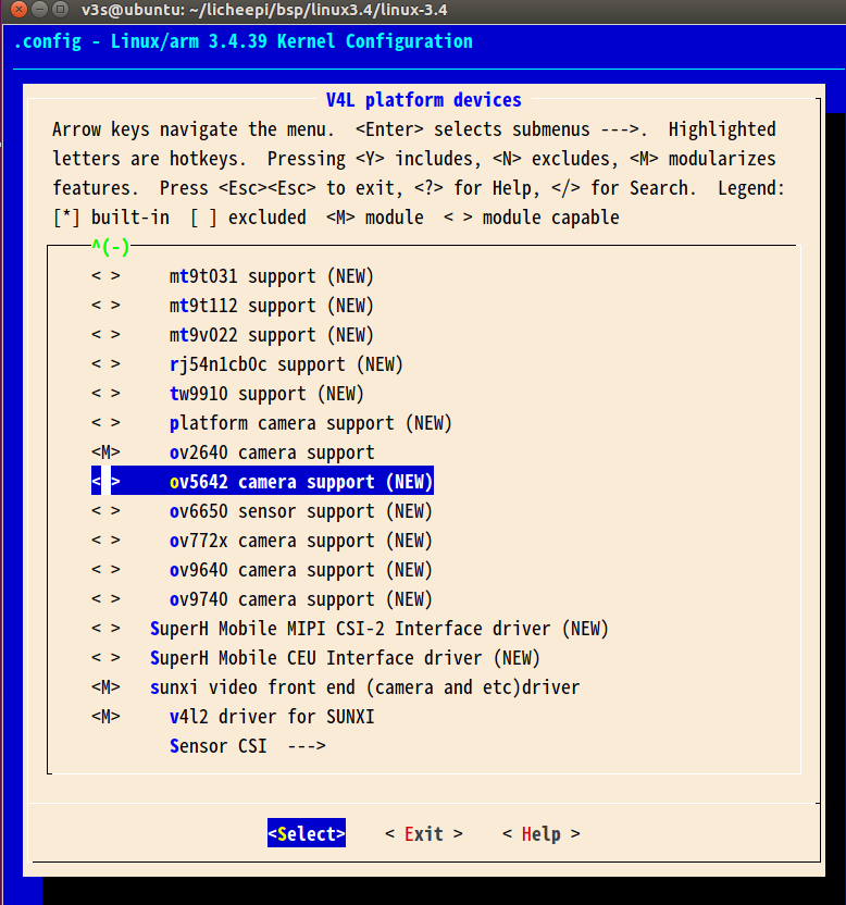

v3s bsp(linux3.4)下摄像头问题
参考licheepi zero BSP 内核(linux3.4) 编译教程  https://whycan.cn/t_682.html
直接使用晕哥的V3s_uboot_bsp_linux_qt_ethernet_tf(whycan.cn).7z用dd 命令直接写到卡上;
参考荔枝派指南http://zero.lichee.pro/  bsp编译部分
在linux3.4里 使能USB摄像头驱动 和 使能MIPI摄像头
重新编译linux3.4 并替换掉TF卡里的uImage;

改用 https://linuxtv.org/downloads/v4l-dvb-apis/uapi/v4l/capture.c.html 代码测试
# ./capture -d /dev/video0 -f
[ 2013.939408] [VFE]vfe_open
[ 2013.942933] [VFE]..........................vfe clk open!.......................
[ 2013.952171] [VFE]vfe_open ok
[ 2013.955682] [VFE_ERR]try yuv422 bus error when pix fmt is yuv422 interleaved at try_fmt_internal!
[ 2013.965781] [VFE_ERR]pixel format (0x56595559) width 640 height 480 invalid at vidioc_s_fmt_vid_cap.
VIDIOC_S_FMT error 22, Invalid a[ 2013.976891] [VFE]vfe_close
rgument\n[ 2013.982526] [VFE]vfe select input flag = 0, s_input have not be used .
[ 2013.990747] [VFE]..........................vfe clk close!.......................
[ 2013.999776] [VFE]vfe_close end
# ./capture -d /dev/video0 -r
[ 4037.443521] [VFE]vfe_open
[ 4037.446675] [VFE]..........................vfe clk open!.......................
[ 4037.455780] [VFE]vfe_open ok
[ 4037.459568] [VFE_ERR]csi is not generating!
[ 4037.465046] [VFE_ERR]csi is not generating!
read error 22, Invalid argument\[ 4037.470528] [VFE]vfe_close
n[ 4037.475881] [VFE]vfe select input flag = 0, s_input have not be used .
[ 4037.483454] [VFE]..........................vfe clk close!.......................
[ 4037.492184] [VFE]vfe_close end
请问,这表示什么呢,是哪里不正常,如何修改,谢谢!

BSP ov5647 我之前玩过,后来摄像头供应商说停产了...所以我们也换了....慎重

drivers/media/video/sunxi-vfe/device$ ls -l *mipi*.c
-rwxrwxr-x 1 whycan whycan  32311 Dec 19 15:33 ar0330_mipi.c
-rwxrwxr-x 1 whycan whycan  31843 Dec 19 15:33 gc1004_mipi.c
-rwxrwxr-x 1 whycan whycan  29016 Dec 19 15:33 gc2355_mipi.c
-rwxrwxr-x 1 whycan whycan  33161 Dec 19 15:33 gc5004_mipi.c
-rwxrwxr-x 1 whycan whycan  25482 Dec 19 15:33 h22_mipi.c
-rwxrwxr-x 1 whycan whycan  25563 Dec 19 15:33 h42_mipi.c
-rwxrwxr-x 1 whycan whycan  28323 Dec 19 15:33 nt99231_mipi.c
-rwxrwxr-x 1 whycan whycan  28122 Dec 19 15:33 ov2710_mipi.c
-rwxrwxr-x 1 whycan whycan 153397 Dec 19 15:33 ov5640_mipi.c
-rwxrwxr-x 1 whycan whycan  40517 Dec 19 15:33 ov5647_mipi.c
-rwxrwxr-x 1 whycan whycan  44179 Dec 19 15:33 s5k4e1_mipi.c
-rwxrwxr-x 1 whycan whycan 235436 Dec 19 15:33 s5k4ec_mipi.c
直接支持 ar0330, gc1004, gc2355,gc5004,h22,h42,nt99231,ov2710,ov5640,ov5647,s5k4e1,s5k4ec 等mipi摄像头。
