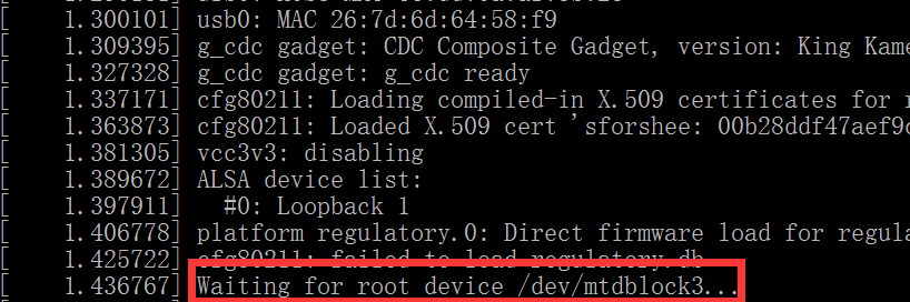

荔枝派Nano 自己编译内核 启动时 卡到Waiting for root device /dev/mtdblock3...
荔枝派Nano
内核版本: Linux version 4.15.0-rc8-licheepi-nano+
自己编译
启动时卡到了
跪求好心人帮我。

#7 2020-01-02 10:18:56
已发帖子: 9,401
Re: 荔枝派Nano 自己编译内核 启动时 卡到Waiting for root device /dev/mtdblock3...
没有生成 mtd 分区吧

没看到 mtd, 倒是有这句:
console=ttyS0,115200 panic=5 rootwait root=/dev/mtdblock3 rw rootfstype=jffs2,
#9 2020-01-02 10:27:06
nufing
注册时间: 2020-01-02
已发帖子: 95
积分: 79.5
没有生成 mtd 分区吧
另外:  #define CONFIG_BOOTCOMMAND   "sf probe 0:50000000; "
这个我改为  #define CONFIG_BOOTCOMMAND   "sf probe 0; "
要不然启动内核时,卡住
#10 2020-01-02 10:34:00
已发帖子: 9,401
又一个掉坑里面的,那个冒号要去掉,本来是个空格的

#define CONFIG_BOOTCOMMAND   "sf probe 0:50000000; "                           \
这个改为,#define CONFIG_BOOTCOMMAND   "sf probe 0 50000000; "                           \
吗?

[    0.923270] 0x000000000000-0x000000070000 : "u-boot"
[    0.930955] 0x000000070000-0x000000080000 : "dtb"
[    0.938202] 0x000000080000-0x000000480000 : "kernel"
[    0.945814] 0x000000480000-0x000000c00000 : "rootfs"
[    0.953431] 0x000000c00000-0x000001000000 : "overlayfs"
[    0.961801] ehci_hcd: USB 2.0 'Enhanced' Host Controller (EHCI) Driver
[    0.968533] ehci-platform: EHCI generic platform driver
[    0.974142] ohci_hcd: USB 1.1 'Open' Host Controller (OHCI) Driver
[    0.980516] ohci-platform: OHCI generic platform driver
[    0.986201] usbcore: registered new interface driver usb-storage
[    0.993304] udc-core: couldn't find an available UDC - added [g_cdc] to list of pending drivers
[    1.002445] i2c /dev entries driver
[    1.068475] sunxi-mmc 1c0f000.mmc: base:0x(ptrval) irq:19
[    1.075973] usbcore: registered new interface driver usbhid
[    1.081738] usbhid: USB HID core driver
[    1.103411] NET: Registered protocol family 17
[    1.108165] Key type dns_resolver registered
[    1.114772] Loading compiled-in X.509 certificates
[    1.130104] sun4i-drm display-engine: bound 1e60000.display-backend (ops 0xc0739cb8)
[    1.139110] sun4i-drm display-engine: bound 1c0c000.lcd-controller (ops 0xc0738f9c)
[    1.146867] [drm] Supports vblank timestamp caching Rev 2 (21.10.2013).
[    1.153611] [drm] No driver support for vblank timestamp query.
[    1.207614] Console: switching to colour frame buffer device 60x34
[    1.231292] sun4i-drm display-engine: fb0:  frame buffer device
[    1.238842] [drm] Initialized sun4i-drm 1.0.0 20150629 for display-engine on minor 0
[    1.259667] usb_phy_generic usb_phy_generic.0.auto: usb_phy_generic.0.auto supply vcc not found, using dummy regulator
[    1.289135] musb-hdrc musb-hdrc.1.auto: MUSB HDRC host driver
[    1.307200] musb-hdrc musb-hdrc.1.auto: new USB bus registered, assigned bus number 1
[    1.330226] hub 1-0:1.0: USB hub found
[    1.340830] hub 1-0:1.0: 1 port detected
[    1.352912] using random self ethernet address
[    1.363921] using random host ethernet address
[    1.376556] usb0: HOST MAC 7e:7b:3d:f3:4e:82
[    1.387339] usb0: MAC 92:2a:53:ab:08:31
[    1.397489] g_cdc gadget: CDC Composite Gadget, version: King Kamehameha Day 2008
[    1.417198] g_cdc gadget: g_cdc ready
[    1.428086] cfg80211: Loading compiled-in X.509 certificates for regulatory database
[    1.457997] cfg80211: Loaded X.509 cert 'sforshee: 00b28ddf47aef9cea7'
[    1.477266] vcc3v3: disabling
[    1.486541] ALSA device list:
[    1.495707]   #0: Loopback 1
[    1.505478] platform regulatory.0: Direct firmware load for regulatory.db failed with error -2
[    1.526180] cfg80211: failed to load regulatory.db
[    1.539015] VFS: Cannot open root device "mtdblock3" or unknown-block(31,3): error -19
[    1.559040] Please append a correct "root=" boot option; here are the available partitions:
[    1.579475] 1f00             448 mtdblock0
[    1.579488]  (driver?)
[    1.597887] 1f01              64 mtdblock1
[    1.597899]  (driver?)
[    1.615901] 1f02            4096 mtdblock2
[    1.615914]  (driver?)
[    1.633498] 1f03            7680 mtdblock3
[    1.633510]  (driver?)
[    1.650737] 1f04            4096 mtdblock4
[    1.650749]  (driver?)
[    1.667502] Kernel panic - not syncing: VFS: Unable to mount root fs on unknown-block(31,3)
[    1.686010] CPU: 0 PID: 1 Comm: swapper Not tainted 4.15.0-rc8-licheepi-nano #2
[    1.703834] Hardware name: Allwinner suniv Family
[    1.714091] [<c010e584>] (unwind_backtrace) from [<c010b6cc>] (show_stack+0x10/0x14)
[    1.732874] [<c010b6cc>] (show_stack) from [<c0116880>] (panic+0xb8/0x230)
[    1.750844] [<c0116880>] (panic) from [<c0901190>] (mount_block_root+0x170/0x250)
[    1.769568] [<c0901190>] (mount_block_root) from [<c0901364>] (mount_root+0xf4/0x120)
[    1.788642] [<c0901364>] (mount_root) from [<c09014b8>] (prepare_namespace+0x128/0x188)
[    1.808181] [<c09014b8>] (prepare_namespace) from [<c0900dc0>] (kernel_init_freeable+0x174/0x1b8)
[    1.828995] [<c0900dc0>] (kernel_init_freeable) from [<c0666410>] (kernel_init+0x8/0x10c)
[    1.849179] [<c0666410>] (kernel_init) from [<c0107de0>] (ret_from_fork+0x14/0x34)
[    1.868781] Rebooting in 5 seconds..
[    7.853959] Reboot failed -- System halted
MTD不错OK了就是还有问题

[    1.542665] VFS: Mounted root (squashfs filesystem) readonly on device 31:3.
[    1.566491] devtmpfs: mounted
[    1.580350] Freeing unused kernel memory: 1024K
[    1.827494] random: crng init done
Starting syslogd: OK
Starting klogd: OK
Running sysctl: OK
Saving random seed: SKIP (read-only file system detected)
Starting network: OK
#29 2020-01-04 16:05:07
