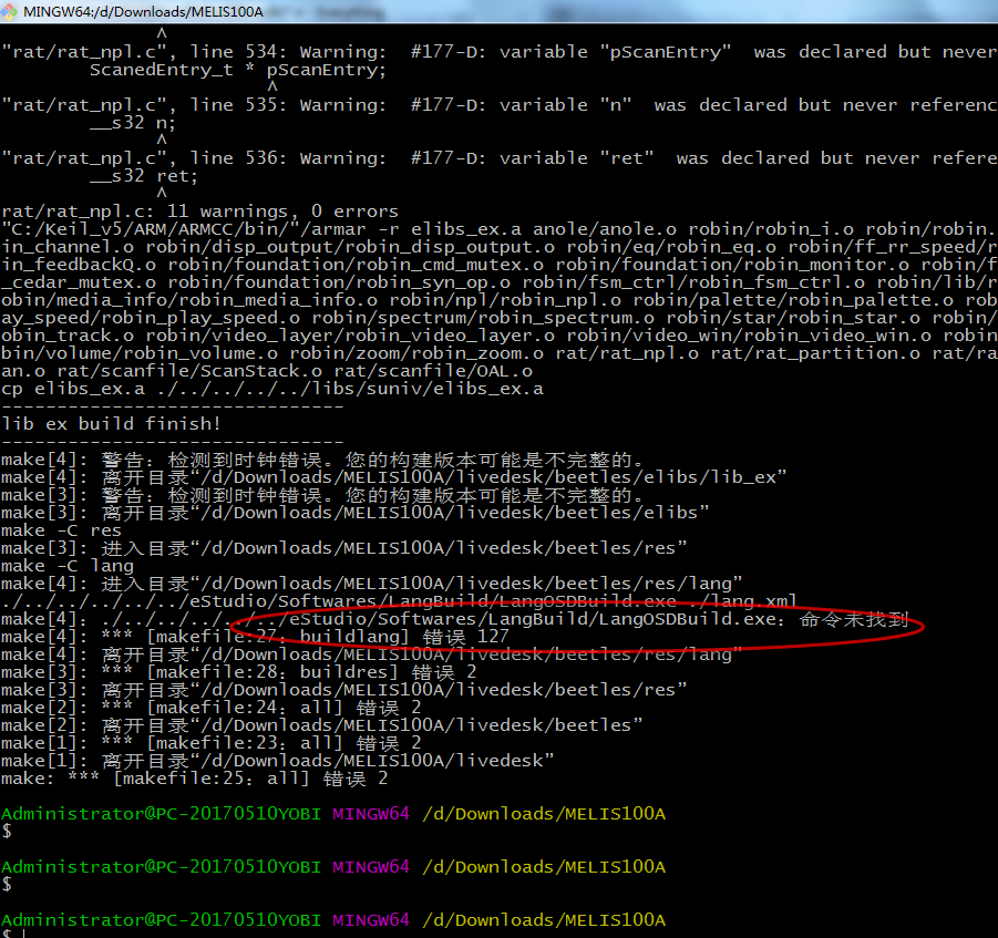

@assert QQ发消息给我说用 MDK 成功编译了 melis, 于是按他教我的方法试一试.
楼主 #3 2018-11-03 14:53:58
已发帖子: 9,420
Re: 试一试用MDK ARMCC 编译全志官方f1c100s sdk --- melis
1. 解压 MELIS100A.7z
2. 打开 MELIS100A\includes\cfgs\CROSSTOOL.CFG, RVDSPATH 修改成你的 MDK 路径:
这是我的配置:
RVDSPATH   = "C:/Keil_v5/ARM/ARMCC/bin/"
3. 在 MELIS100A 目录执行 make

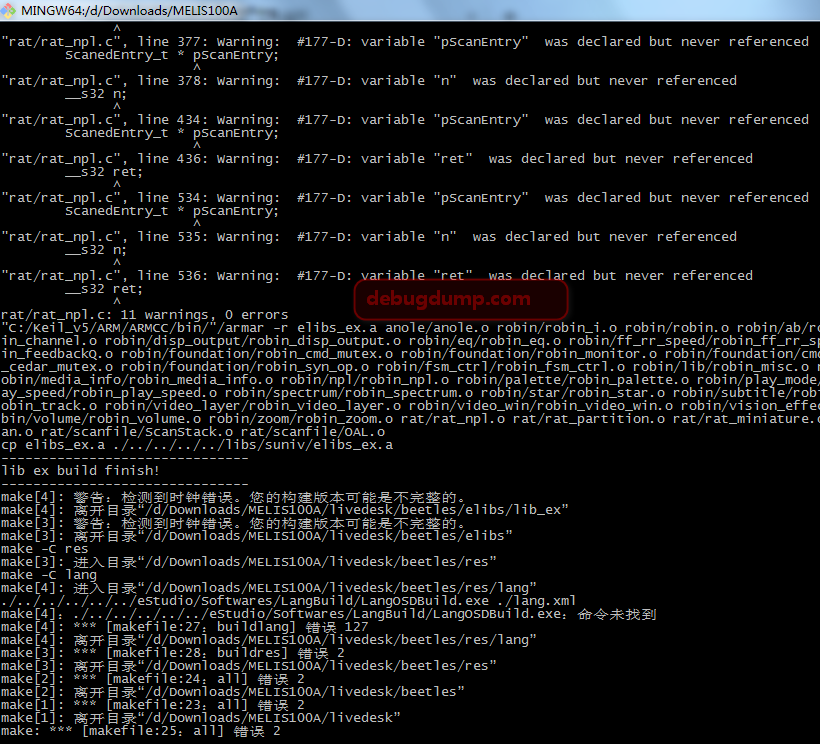

楼主 #5 2018-11-03 15:00:50
已发帖子: 9,420
"rat/rat_npl.c", line 436: Warning:  #177-D: variable "ret"  was declared but never referenced
        __s32 ret;
"rat/rat_npl.c", line 534: Warning:  #177-D: variable "pScanEntry"  was declared but never referenced
        ScanedEntry_t * pScanEntry;
"rat/rat_npl.c", line 535: Warning:  #177-D: variable "n"  was declared but never referenced
        __s32 n;
"rat/rat_npl.c", line 536: Warning:  #177-D: variable "ret"  was declared but never referenced
        __s32 ret;
rat/rat_npl.c: 11 warnings, 0 errors
"C:/Keil_v5/ARM/ARMCC/bin/"/armar -r elibs_ex.a anole/anole.o robin/robin_i.o robin/robin.o robin/ab/robin_ab.o robin/channel/rob                                                in_channel.o robin/disp_output/robin_disp_output.o robin/eq/robin_eq.o robin/ff_rr_speed/robin_ff_rr_speed.o robin/foundation/rob                                                in_feedbackQ.o robin/foundation/robin_cmd_mutex.o robin/foundation/robin_monitor.o robin/foundation/cmdQ.o robin/foundation/robin                                                _cedar_mutex.o robin/foundation/robin_syn_op.o robin/fsm_ctrl/robin_fsm_ctrl.o robin/lib/robin_misc.o robin/lyric/robin_lyric.o r                                                obin/media_info/robin_media_info.o robin/npl/robin_npl.o robin/palette/robin_palette.o robin/play_mode/robin_play_mode.o robin/pl                                                ay_speed/robin_play_speed.o robin/spectrum/robin_spectrum.o robin/star/robin_star.o robin/subtitle/robin_subtitle.o robin/track/r                                                obin_track.o robin/video_layer/robin_video_layer.o robin/video_win/robin_video_win.o robin/vision_effect/robin_vision_effect.o ro                                                bin/volume/robin_volume.o robin/zoom/robin_zoom.o rat/rat_npl.o rat/rat_partition.o rat/rat_miniature.o rat/rat.o rat/scanfile/Sc                                                an.o rat/scanfile/ScanStack.o rat/scanfile/OAL.o
cp elibs_ex.a ./../../../../libs/suniv/elibs_ex.a
lib ex build finish!
make[4]: 警告:检测到时钟错误。您的构建版本可能是不完整的。
make[4]: 离开目录“/d/Downloads/MELIS100A/livedesk/beetles/elibs/lib_ex”
make[3]: 警告:检测到时钟错误。您的构建版本可能是不完整的。
make[3]: 离开目录“/d/Downloads/MELIS100A/livedesk/beetles/elibs”
make -C res
make[3]: 进入目录“/d/Downloads/MELIS100A/livedesk/beetles/res”
make -C lang
make[4]: 进入目录“/d/Downloads/MELIS100A/livedesk/beetles/res/lang”
./../../../../../eStudio/Softwares/LangBuild/LangOSDBuild.exe ./lang.xml
make[4]:./../../../../../eStudio/Softwares/LangBuild/LangOSDBuild.exe:命令未找到
make[4]: *** [makefile:27:buildlang] 错误 127
make[4]: 离开目录“/d/Downloads/MELIS100A/livedesk/beetles/res/lang”
make[3]: *** [makefile:28:buildres] 错误 2
make[3]: 离开目录“/d/Downloads/MELIS100A/livedesk/beetles/res”
make[2]: *** [makefile:24:all] 错误 2
make[2]: 离开目录“/d/Downloads/MELIS100A/livedesk/beetles”
make[1]: *** [makefile:23:all] 错误 2
make[1]: 离开目录“/d/Downloads/MELIS100A/livedesk”
make: *** [makefile:25:all] 错误 2
编译完成

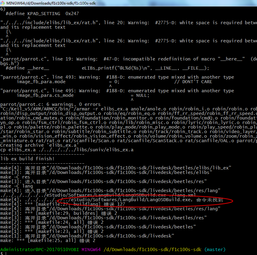

但是缺少可执行文件,导致打包不能进行。

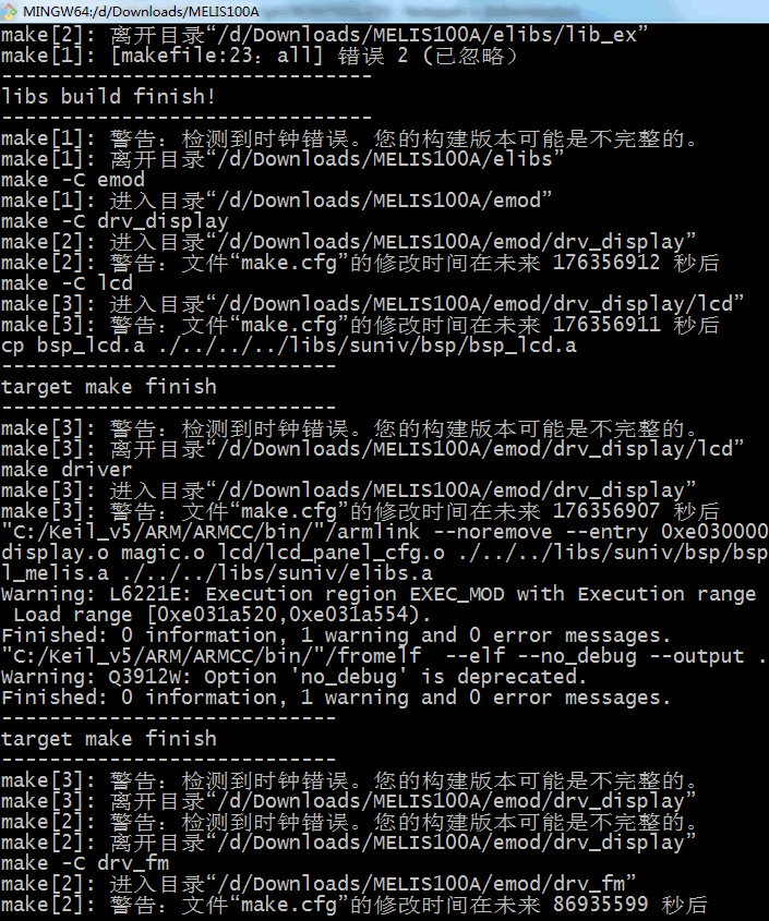

楼主 #6 2018-11-03 16:08:23
已发帖子: 9,420
弄来的两个SDK都有这个问题。
楼主 #7 2018-11-03 16:08:51
已发帖子: 9,420

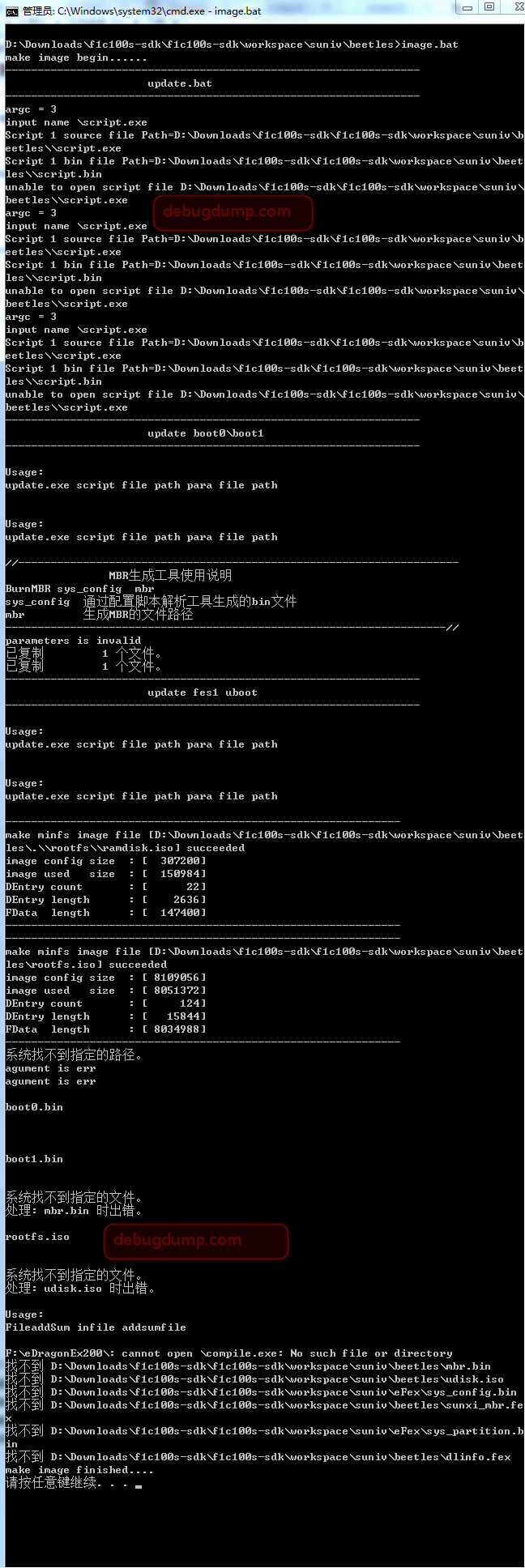

然后用 make image 命令, 会出现打包错误.
楼主 #8 2018-11-03 16:09:08
已发帖子: 9,420

用 MDK 编译 melis SDK倒是没有问题, 打包的时候挂了, 可能缺少 eDragonEx220, 我电脑上只发现 eDragonEx200。
晕哥,是不是可以直接将eDragonEx200 rename成eDragonEx220 ?
楼主 #15 2018-11-05 14:25:42
已发帖子: 9,420
dgtg 说:
我就是这么测试的,到最后仍然打包失败。

但是缺少可执行文件,导致打包不能进行。
晕哥,这个编译错误的问题,刚好我前几天在编译一个Melis的例子工程时也碰到" LangOSBuilder.exe:命令未找到"的编译错误,后来发现是 includes/cfgs/CROSSTOOL.CFG文件中的一个定义不对, 将这个文件打开后,把其中的ESUDIOROOT = $(SDKROOT)/../eStudio修改为ESUDIOROOT = $(SDKROOT)/eStudio即可,这个编译错误就没了。
再一个,请问下,本帖子中你编译的这个 MELIS100A.7z从哪里下载呢?

我几乎完成了此操作,但我陷入了这个错误。
有人知道吗?
I have almost done it, but i am stuck on this error.
is there anybody know?
make image begin...
argc = 2
input name ..\eFex\sys_config.fex
Script 1 source file Path=F:\melis\melis2\workspace\suniv\phoenix\..\eFex\sys_config.fex
Script 1 bin file Path=F:\melis\melis2\workspace\suniv\phoenix\..\eFex\sys_config.bin
parser 1 file ok
        1 file(s) copied.
        1 file(s) copied.
argc = 2
input name part_config.fex
Script 1 source file Path=F:\melis\melis2\workspace\suniv\phoenix\part_config.fex
Script 1 bin file Path=F:\melis\melis2\workspace\suniv\phoenix\part_config.bin
parser 1 file ok
..\..\..\..\eStudio\Softwares\eDragonEx200\compile: image.cfg:1: unexpected symbol near ';'
make image finished...
Press any key to continue . . .

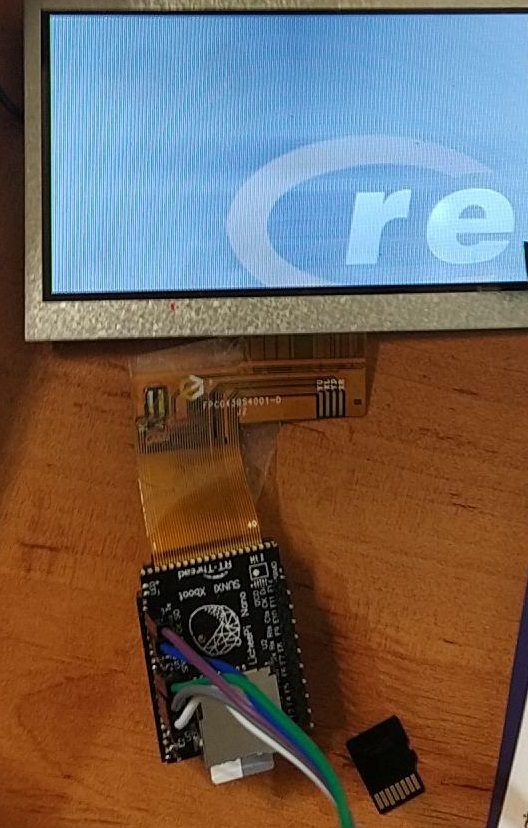

I tried other sdcards but the result was same.
I made new build and now the log is :
BOOT0 is starting
init dram , base        is 0x80000000
init dram , clk         is 120
init dram , access_mode is 1
init dram , cs_num      is 1
init dram , ddr8_remap  is 0
init dram , sdr_ddr     is 1
init dram , bwidth      is 16
init dram , col_width   is 10
init dram , row_width   is 13
init dram , bank_size   is 4
init dram , cas         is 3
init dram , size        is 0
dram init successed,size is 32
succeed in loading BOOT1
jump to BOOT1
begin to init file system
card_no = 0,line_sel = 4, bootcard_offset =40960
0
jump to kernal
port=4,port_num=1,mul_sel=6 eint_num=1 trigger=2
Mount Parts Thread running.....
SDC 0 init...
SD card found
SDC 0 identified successfully
partition [D] plug in..
Mount Parts Thread work now.....
partition [E] plug in..
Mount Parts Thread work end....
.Start Shell from partion 'c'...................................................
&&&addr=0x6969637765....
*****0x6969637765 data fail....
&&&&&&&&&&&&0x6972 addr error&&&&&&&&&&

@Biftor, that's it. Although there is the error of "unexpected symbol near ';'", the image file (ePDKv100.img) should has already been created under the folder of "Melis100A\workspace\suniv\beetles".
我的产没有生成ePDKv100.img,提示如下
make image begin......
.\..\eFex\sys_version.fex
.\..\eFex\sys_config.fex
已复制         1 个文件。
已复制         1 个文件。
                      update.bat
argc = 2
input name .\..\eFex\sys_config.fex
Script 1 source file Path=J:\wsl\f1c100s\melis\MELIS100A\workspace\suniv\beetles\.\..\eFex\sys_config.fex
Script 1 bin file Path=J:\wsl\f1c100s\melis\MELIS100A\workspace\suniv\beetles\.\..\eFex\sys_config.bin
parser 1 file ok
argc = 2
input name .\..\eFex\sys_partition.fex
Script 1 source file Path=J:\wsl\f1c100s\melis\MELIS100A\workspace\suniv\beetles\.\..\eFex\sys_partition.fex
Script 1 bin file Path=J:\wsl\f1c100s\melis\MELIS100A\workspace\suniv\beetles\.\..\eFex\sys_partition.bin
parser 1 file ok
argc = 2
input name .\rootfs\app_config.fex
Script 1 source file Path=J:\wsl\f1c100s\melis\MELIS100A\workspace\suniv\beetles\.\rootfs\app_config.fex
Script 1 bin file Path=J:\wsl\f1c100s\melis\MELIS100A\workspace\suniv\beetles\.\rootfs\app_config.bin
parser 1 file ok
                      update boot0\boot1
已复制         1 个文件。
已复制         1 个文件。
                      update fes1 uboot
make minfs image file [J:\wsl\f1c100s\melis\MELIS100A\workspace\suniv\beetles\.\\rootfs\\ramdisk.iso] succeeded
image config size  : [  131072]
image used   size  : [  109888]
DEntry count       : [      17]
DEntry length      : [    2176]
FData  length      : [  106816]
make minfs image file [J:\wsl\f1c100s\melis\MELIS100A\workspace\suniv\beetles\rootfs.iso] succeeded
image config size  : [15360000]
image used   size  : [ 3832316]
DEntry count       : [     106]
DEntry length      : [   13720]
FData  length      : [ 3817980]
boot0.bin
boot1.bin
mbr.bin
rootfs.iso
udisk.iso
FileLengthx=15639552
..\..\..\..\eStudio\Softwares\eDragonEx220\compile: image.cfg:1: unexpected symbol near ';'
make image finished....
楼主 #98 2019-12-27 15:26:31
已发帖子: 9,420
奇怪, @Biftor 怎么生成了 ePDKv100.img 呢 ? 是不是你打开的文件夹不对, 用 everything 搜一下。
#99 2019-12-27 16:30:26
staunchheart
注册时间: 2019-12-17
已发帖子: 232
积分: 190
感谢Wind Rises,搞好了。
没有装MFC库放到windows/system下,一定要放到system下,不是system32
另外,也可以直接拷到eDragonEx220目录下。
MFC库在本站有
https://whycan.cn/files/members/1377/none_20190225-1007.rar
#100 2019-12-27 17:43:01

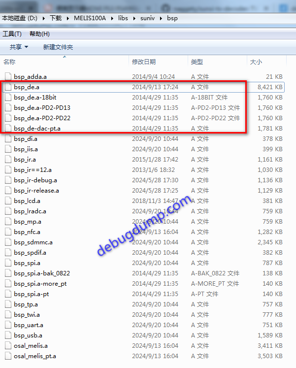

看有没有生成img文件,如果有一般就没问题。那个提示是文件时间不对的问题,可能那些lib显示成2024年什么的

请原谅我是小白,原来不是这么操作的,需要打开SDK->workspace->suniv->beetles,点击image.bat,我按照99楼的做了但是出现下面的问题
'wmic' 不是内部或外部命令,也不是可运行的程序
或批处理文件。
'findstr' 不是内部或外部命令,也不是可运行的程序
或批处理文件。
或批处理文件。
或批处理文件。
已复制         1 个文件。
已复制         1 个文件。
                      update.bat
'xcopy' 不是内部或外部命令,也不是可运行的程序
或批处理文件。
或批处理文件。
argc = 2
Script 1 source file Path=I:\meils\SDK\workspace\suniv\beetles\.\..\eFex\sys_config.fex
Script 1 bin file Path=I:\meils\SDK\workspace\suniv\beetles\.\..\eFex\sys_config.bin
parser 1 file ok
argc = 2
Script 1 source file Path=I:\meils\SDK\workspace\suniv\beetles\.\..\eFex\sys_partition.fex
Script 1 bin file Path=I:\meils\SDK\workspace\suniv\beetles\.\..\eFex\sys_partition.bin
parser 1 file ok
argc = 2
Script 1 source file Path=I:\meils\SDK\workspace\suniv\beetles\.\rootfs\app_config.fex
Script 1 bin file Path=I:\meils\SDK\workspace\suniv\beetles\.\rootfs\app_config.bin
parser 1 file ok
                      update boot0\boot1
已复制         1 个文件。
已复制         1 个文件。
                      update fes1 uboot
image file have no free space
load module file [I:\meils\SDK\workspace\suniv\beetles\ramfs\mod\slib.mod] failed
make image failed when file [I:\meils\SDK\workspace\suniv\beetles\ramfs\mod\slib.mod]
process diretory [I:\meils\SDK\workspace\suniv\beetles\ramfs\mod] failed
make image failed when directory [I:\meils\SDK\workspace\suniv\beetles\ramfs\mod]
make minfs image failed
make minfs image [I:\meils\SDK\workspace\suniv\beetles\.\\rootfs\\ramdisk.iso] failed
make minfs image file [I:\meils\SDK\workspace\suniv\beetles\rootfs.iso] succeeded
image config size  : [ 8109056]
image used   size  : [ 3801136]
FData  length      : [ 3786800]
系统找不到指定的路径。
boot0.bin
boot1.bin
mbr.bin
rootfs.iso
系统找不到指定的文件。
处理: udisk.iso 时出错。
系统找不到指定的路径。
系统找不到指定的路径。
系统找不到指定的路径。
找不到 I:\meils\SDK\workspace\suniv\beetles\udisk.iso
请按任意键继续. . .

提示很明显了啊,wmic,findstr,xcopy这些命令都找不到,I:\meils\SDK\workspace\suniv\beetles\udisk.iso 这个文件也找不到

wmic.exe | findstr.exe | xcopy.exe
这些是 Windows 内置命令

设置下系统path变量  增加C:\Windows\System32 试试

你用 cygwin shell ? 有可能你的 shell有问题,建议用晕哥一楼用的 git 自带的shell

按照文中的教程做了一遍发现编译出现如下错误:

试试 在livedesk\beetles目录下编译

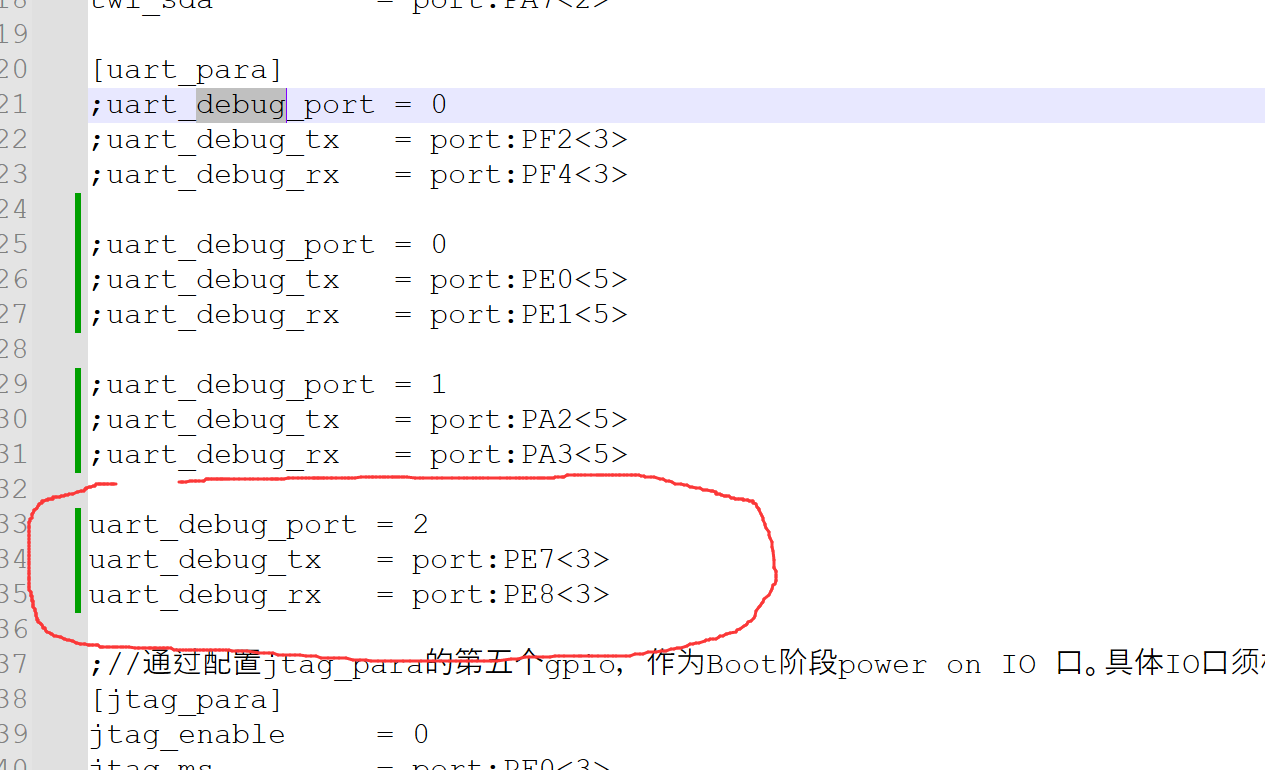

这样修改调试串口改到 UART2 (PE7,PE8)
F1C200S_Melis_V1.7_mdk\melis2.0-sdk-release\workspace\suniv\eFex\sys_config.fex
[uart_para]
uart_debug_port = 2
uart_debug_tx   = port:PE7<3>
uart_debug_rx   = port:PE8<3>
