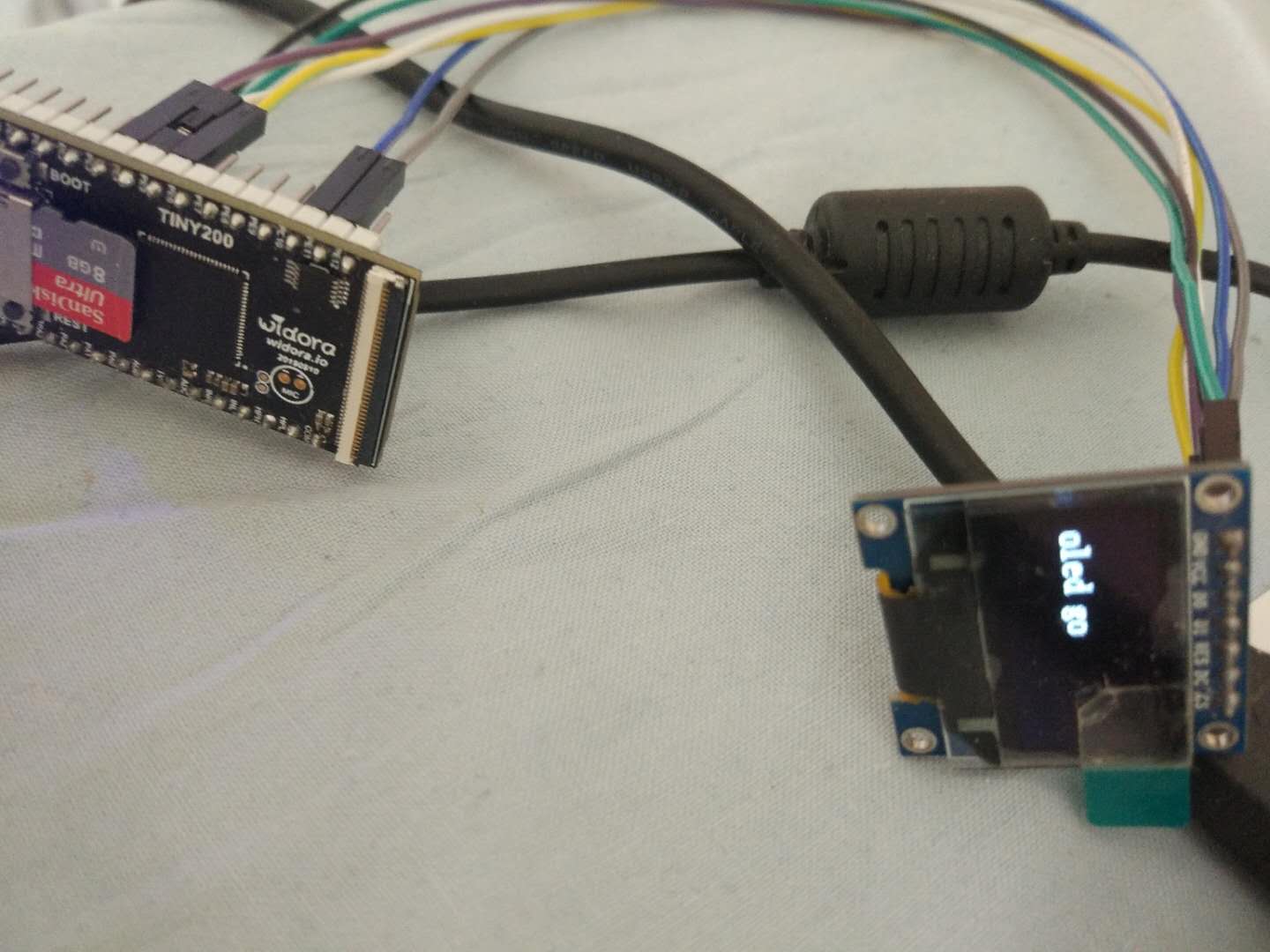

go语言开发f1c100s之oled驱动
尝试用go语言操作gpio驱动oled,驱动方式是spi,io操作方式是文件方式。由于这种方式需要不断写文件,oled刷新有点慢。后期会改成mmap方式。
https://github.com/kekemuyu/f1c100s/tree/master/oled_spi
oled 部分代码:
package oled
import (
	"oled_spi/gpio"
	"time"
const (
	OLED_CLK = "gpio131"
	OLED_DI  = "gpio132"
	OLED_RST = "gpio133"
	OLED_DC  = "gpio138"
	OLED_CS  = "gpio139"
	OLED_CMD  = 0 //写命令
	OLED_DATA = 1 //写数据
	SIZE       = 16
	Max_Column = 128
	Max_Row    = 64
func Init() {
	gpio.OpenGpioFile(OLED_CLK)
	gpio.OpenGpioFile(OLED_DI)
	gpio.OpenGpioFile(OLED_RST)
	gpio.OpenGpioFile(OLED_DC)
	gpio.OpenGpioFile(OLED_CS)
	SetRst()
	time.Sleep(time.Millisecond * 100)
	ClrRst()
	SetRst()
	WriteByte(0xAE, OLED_CMD) //--turn off oled panel
	WriteByte(0x00, OLED_CMD) //---set low column address
	WriteByte(0x10, OLED_CMD) //---set high column address
	WriteByte(0x40, OLED_CMD) //--set start line address  Set Mapping RAM Display Start Line (0x00~0x3F)
	WriteByte(0x81, OLED_CMD) //--set contrast control register
	WriteByte(0x66, OLED_CMD) // Set SEG Output Current Brightness
	WriteByte(0xA1, OLED_CMD) //--Set SEG/Column Mapping     0xa0左右反置 0xa1正常
	WriteByte(0xC8, OLED_CMD) //Set COM/Row Scan Direction   0xc0上下反置 0xc8正常
	WriteByte(0xA6, OLED_CMD) //--set normal display
	WriteByte(0xA8, OLED_CMD) //--set multiplex ratio(1 to 64)
	WriteByte(0x3f, OLED_CMD) //--1/64 duty
	WriteByte(0xD3, OLED_CMD) //-set display offset    Shift Mapping RAM Counter (0x00~0x3F)
	WriteByte(0x00, OLED_CMD) //-not offset
	WriteByte(0xd5, OLED_CMD) //--set display clock divide ratio/oscillator frequency
	WriteByte(0x80, OLED_CMD) //--set divide ratio, Set Clock as 100 Frames/Sec
	WriteByte(0xD9, OLED_CMD) //--set pre-charge period
	WriteByte(0xF1, OLED_CMD) //Set Pre-Charge as 15 Clocks & Discharge as 1 Clock
	WriteByte(0xDA, OLED_CMD) //--set com pins hardware configuration
	WriteByte(0x12, OLED_CMD)
	WriteByte(0xDB, OLED_CMD) //--set vcomh
	WriteByte(0x40, OLED_CMD) //Set VCOM Deselect Level
	WriteByte(0x20, OLED_CMD) //-Set Page Addressing Mode (0x00/0x01/0x02)
	WriteByte(0x02, OLED_CMD) //
	WriteByte(0x8D, OLED_CMD) //--set Charge Pump enable/disable
	WriteByte(0x14, OLED_CMD) //--set(0x10) disable
	WriteByte(0xA4, OLED_CMD) // Disable Entire Display On (0xa4/0xa5)
	WriteByte(0xA6, OLED_CMD) // Disable Inverse Display On (0xa6/a7)
	WriteByte(0xAF, OLED_CMD) //--turn on oled panel
	WriteByte(0xAF, OLED_CMD) /*display ON*/
	Clear()
	SetPos(0, 0)
func SetClk() {
	gpio.GpioNSetValue(OLED_CLK, "1")
func ClrClk() {
	gpio.GpioNSetValue(OLED_CLK, "0")
func SetDi() {
	gpio.GpioNSetValue(OLED_DI, "1")
func ClrDi() {
	gpio.GpioNSetValue(OLED_DI, "0")
func SetRst() {
	gpio.GpioNSetValue(OLED_RST, "1")
func ClrRst() {
	gpio.GpioNSetValue(OLED_RST, "0")
func SetDc() {
	gpio.GpioNSetValue(OLED_DC, "1")
func ClrDc() {
	gpio.GpioNSetValue(OLED_DC, "0")
func SetCs() {
	gpio.GpioNSetValue(OLED_CS, "1")
func ClrCs() {
	gpio.GpioNSetValue(OLED_CS, "0")
func WriteByte(dat, cmd byte) {
	if cmd != 0 {
		SetDc()
	} else {
		ClrDc()
	ClrCs()
	for i := 0; i < 8; i++ {
		ClrClk()
		if dat&0x80 != 0 {
			SetDi()
		} else {
			ClrDi()
		SetClk()
		dat <<= 1
	SetCs()
	SetDc()
func SetPos(x, y byte) {
	WriteByte(0xb0+y, OLED_CMD)
	WriteByte(((x&0xf0)>>4)|0x10, OLED_CMD)
	WriteByte((x&0x0f)|0x01, OLED_CMD)
func Clear() {
	for i := byte(0); i < 8; i++ {
		WriteByte(0xb0+i, OLED_CMD) //设置页地址(0~7)
		WriteByte(0x00, OLED_CMD)   //设置显示位置—列低地址
		WriteByte(0x10, OLED_CMD)   //设置显示位置—列高地址
		for n := 0; n < 128; n++ {
			WriteByte(0, OLED_DATA) //更新显示
func ShowChar(x, y, chr byte) {
	c := chr - ' ' //得到偏移后的值
	if x > Max_Column-1 {
		x = 0
		y = y + 2
	if SIZE == 16 {
		SetPos(x, y)
			WriteByte(F8X16[int(c)*16+i], OLED_DATA)
		SetPos(x, y+1)
			WriteByte(F8X16[int(c)*16+i+8], OLED_DATA)
	} else {
		SetPos(x, y+1)
func ShowString(x, y byte, chrs string) {
	for _, v := range []byte(chrs) {
		ShowChar(x, y, v)
		x += 8
		if x > 120 {
			x = 0
			y += 2
