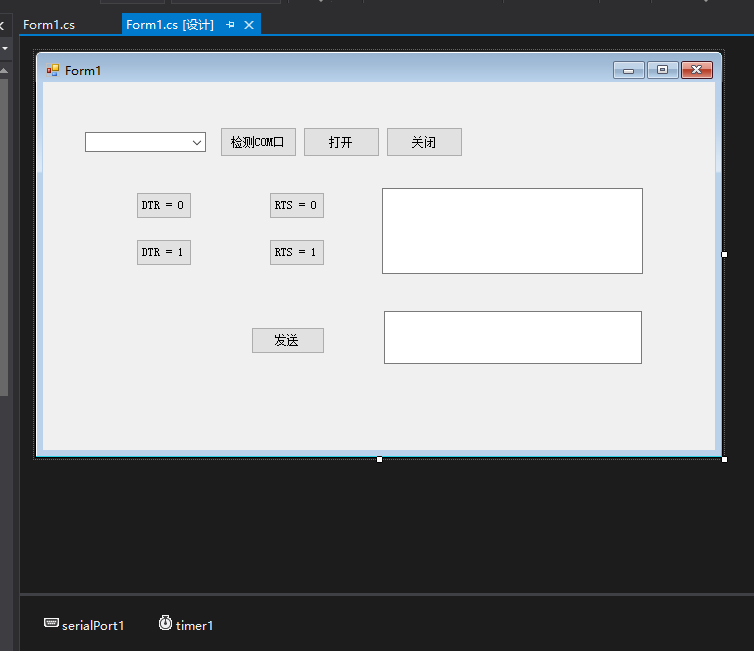

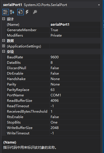

private void button6_Click(object sender, EventArgs e)
serialPort1.DtrEnable = true;
private void button7_Click(object sender, EventArgs e)
serialPort1.RtsEnable = true;
private void button4_Click(object sender, EventArgs e)
serialPort1.DtrEnable = false;
private void button5_Click(object sender, EventArgs e)
serialPort1.RtsEnable = false;
