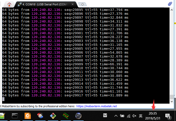

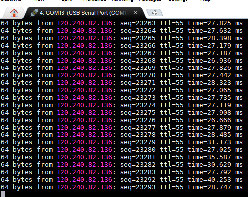

楼主 #1 2019-05-31 09:50:18

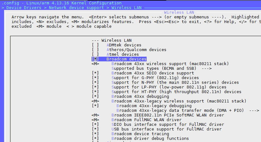

使用华嵌HQEmbed S3 开发板, 驱动经典的无线芯片 BCM43438(AP6212) 的 WIFI
购买链接: https://item.taobao.com/item.htm?id=591896289694
店铺链接: https://shop512436263.taobao.com
参考链接: 感谢华嵌HQEmbed赠送的 漂亮高颜值S3 开发板 (底板 + 核心板)
核心板原理图: core_s3_v01.pdf
底板原理图: hq_050ips_v01.pdf
2019-06-01 更新:
能跑BCM43438 WIFI 的固件下载: read_hq_s3_128m.7z

drivers/pinctrl/sunxi/pinctrl-sun8i-v3s.c 添加:
SUNXI_PIN(SUNXI_PINCTRL_PIN(B, 10),
SUNXI_FUNCTION(0x0, "gpio_in"),
SUNXI_FUNCTION(0x1, "gpio_out"),
SUNXI_FUNCTION(0x2, "jtag"), / JTAG /
SUNXI_FUNCTION_IRQ_BANK(0x6, 0, 10)), / PB_EINT10 /
arch/arm/boot/dts/sun8i-v3s.dtsi
			wifi_en_pin: wifi {
				pins = "PB2";
				function = "gpio_out";
arch/arm/boot/dts/sun8i-v3s-licheepi-zero.dts
model = "Lichee Pi Zero with Dock";
compatible = "licheepi,licheepi-zero-dock", "licheepi,licheepi-zero",
"allwinner,sun8i-v3s";
aliases {
ethernet0 = &emac;
leds {
/ The LEDs use PG0~2 pins, which conflict with MMC1 /
status = "disbaled";
**wifi_reg_en: wifi_reg_en {
compatible = "mmc-pwrseq-simple";
pinctrl-names = "default";
pinctrl-0 = <&wifi_en_pin>;
reset-gpios = <&pio 1 2 GPIO_ACTIVE_LOW>; / PB2 /
&mmc1 {
pinctrl-0 = <&mmc1_pins>;
vmmc-supply = <&reg_vcc3v3>;
vqmmc-supply = <&reg_vcc3v3>;
mmc-pwrseq = <&wifi_reg_en>;
bus-width = <4>;
non-removable;
brcmf: wifi@1 {
reg = <1>;
compatible = "brcm,bcm4329-fmac";
interrupt-parent = <&pio>;
interrupt-names = "host-wake";
interrupts = <1 10 IRQ_TYPE_LEVEL_LOW>; / PB10 / EINT10 /

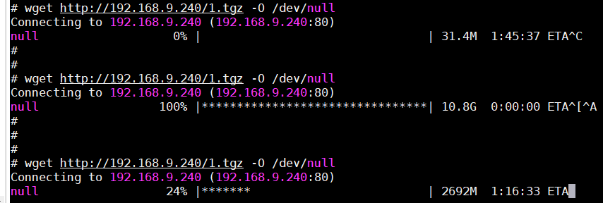

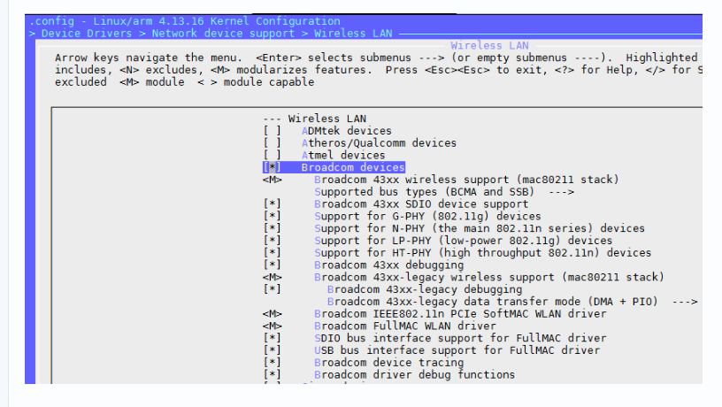

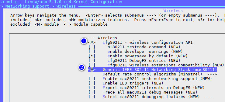

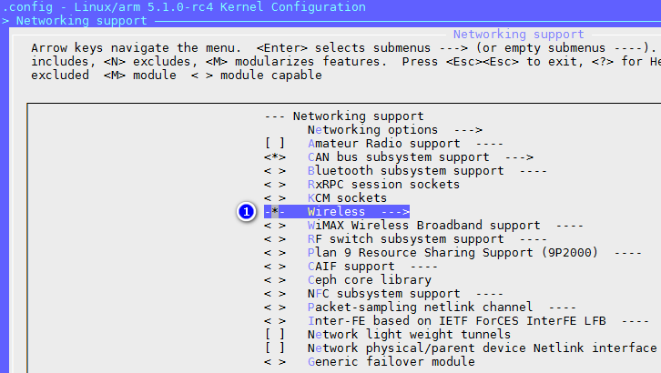

楼主 #3 2019-05-31 10:26:02
Re: 使用华嵌HQEmbed S3 开发板, 驱动经典的无线芯片 BCM43438(AP6212) 的 WIFI
hq_s3_v1_defconfig 配置文件:

勾上 wireless 相关的协议和驱动

楼主 #8 2019-05-31 18:47:54
测试了将近6小时, BCM43438 仍然坚挺.
楼主 #9 2019-05-31 20:36:55
测试了将近9小时, BCM43438 仍然坚挺.

测试了从电脑一次性下载 11.6 G的文件, 耗时 1小时46分左右
11616.504723 / (13600+4560 + 37) = 1.833 MB/s = 14.664Mbps
测试环境 Windows10 + VMware + Ubuntu16.04 + Apache2 + 同一个路由器(电脑5G频段, AP6212 2.4G频段)

CONFIG_WLAN=y
# CONFIG_WLAN_VENDOR_ADMTEK is not set
# CONFIG_WLAN_VENDOR_ATH is not set
# CONFIG_WLAN_VENDOR_ATMEL is not set
CONFIG_WLAN_VENDOR_BROADCOM=y
CONFIG_B43=m
CONFIG_B43_BCMA=y
CONFIG_B43_SSB=y
CONFIG_B43_BUSES_BCMA_AND_SSB=y
# CONFIG_B43_BUSES_BCMA is not set
# CONFIG_B43_BUSES_SSB is not set
CONFIG_B43_SDIO=y
CONFIG_B43_BCMA_PIO=y
CONFIG_B43_PIO=y
CONFIG_B43_PHY_G=y
CONFIG_B43_PHY_N=y
CONFIG_B43_PHY_LP=y
CONFIG_B43_PHY_HT=y
CONFIG_B43_LEDS=y
CONFIG_B43_DEBUG=y
CONFIG_B43LEGACY=m
CONFIG_B43LEGACY_LEDS=y
CONFIG_B43LEGACY_DEBUG=y
CONFIG_B43LEGACY_DMA=y
CONFIG_B43LEGACY_PIO=y
CONFIG_B43LEGACY_DMA_AND_PIO_MODE=y
# CONFIG_B43LEGACY_DMA_MODE is not set
# CONFIG_B43LEGACY_PIO_MODE is not set
CONFIG_BRCMUTIL=m
CONFIG_BRCMSMAC=m
CONFIG_BRCMFMAC=m
CONFIG_BRCMFMAC_PROTO_BCDC=y
CONFIG_BRCMFMAC_SDIO=y
CONFIG_BRCMFMAC_USB=y
CONFIG_BRCM_TRACING=y
CONFIG_BRCMDBG=y
