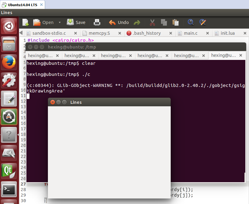

编译 cairo/basicdrawing/演示代码,出现错误,不能正常运行, 搜了一圈,发现有人出现一模一样问题
编译 cairo/basicdrawing/ 演示代码,出现错误,不能正常运行,
搜了一圈,发现有人出现一模一样问题
https://lists.cairographics.org/archives/cairo/2015-October/026509.html
On Tue, 2015-10-13 at 15:54 +0300, Roman Goldov wrote:
> Hello, i installed CentOS 7 and gtk-devel libaries. I learn GTK+ and
> Cairo. I downloaded (copied) from Internet an exmple of cairo file
> (file9.c that is attached) where i tried to draw lines (graphics) on
> the window. However, the window is opened and it is empty, and also
> theer is warning message in the terminal:
> [... at localhost ~]$ gcc -Wall -g file9.c -o file9.exe `pkg-config -
> -cflags gtk+-2.0` `pkg-config --libs gtk+-2.0`
> [... at localhost ~]$ ./file9.exe
> (file9.exe:9678): GLib-GObject-WARNING **: gsignal.c:2462: signal
> 'draw' is invalid for instance '0x968440' of type 'GtkDrawingArea'
> I would appreciate help in solving the problem. A detailed answer
> would be appreciated because i am a new user of Linux.
> Thank you.
> Roman Goldov
You took that example from zcode.com -- so why do you not tell us?
That example is for GTK3 now. It will not work in its current state with
GTK2. You may asks the author if he still has the very old GTK2 version.
Or you may use other examples which have not been ported to GTK3 jet, I
guess there will exists some in internet. Or, you you may port that
example back to GTK2, I think there is not very much to modify, but I do
not know exactly what, because I am using GTK3 for years now.
Is there no GTK3 available for your OS, or have you a good reason for
using old GTK2?
If you really need a GTK2 example and can not find one, let us know, I
may provide one in the next few days...

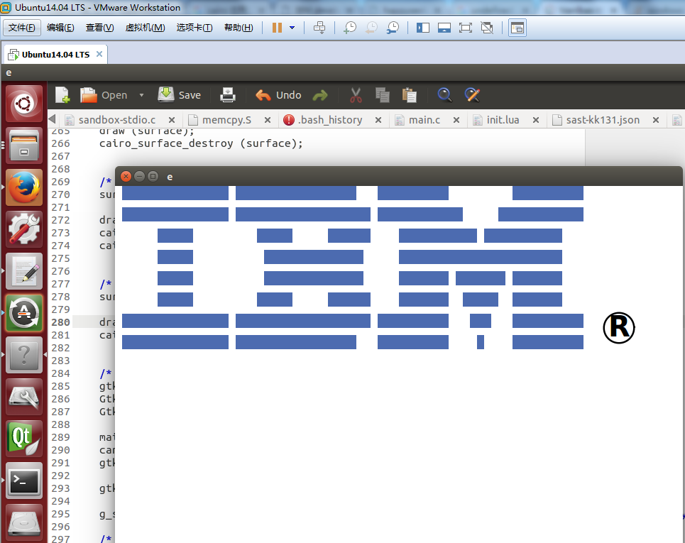

编译指令:
gcc -o c c.c -I/usr/include/gtk-3.0/ -I/usr/include/glib-2.0/ -I/usr/lib/x86_64-linux-gnu/glib-2.0/include/ -I/usr/include/cairo -I/usr/include/pango-1.0 -I/usr/lib/x86_64-linux-gnu/gtk-2.0/include/ -I/usr/include/gdk-pixbuf-2.0/ -I/usr/include/atk-1.0 -lgtk-x11-2.0  -lgobject-2.0 -lrt -lglib-2.0 -pthread -lcairo
楼主 #2 2018-04-18 17:47:20
已发帖子: 9,445
Re: 编译 cairo/basicdrawing/演示代码,出现错误,不能正常运行, 搜了一圈,发现有人出现一模一样问题
gcc -o c c.c -I/usr/include/gtk-3.0/ -I/usr/include/glib-2.0/ -I/usr/lib/x86_64-linux-gnu/glib-2.0/include/ -I/usr/include/cairo -I/usr/include/pango-1.0 -I/usr/lib/x86_64-linux-gnu/gtk-2.0/include/ -I/usr/include/gdk-pixbuf-2.0/ -I/usr/include/atk-1.0 -lgtk-3  -lgobject-2.0 -lrt -lglib-2.0 -pthread -lcairo
换成gtk-3.0 了,没有警告了,终于能正常跑起来了。
可以开始 cairo 2d图形引擎入门了。

编译指令:
gcc -o e e.c -I/usr/include/gtk-2.0/ -I/usr/include/glib-2.0/ -I/usr/lib/x86_64-linux-gnu/glib-2.0/include/ -I/usr/include/cairo -I/usr/include/pango-1.0 -I/usr/lib/x86_64-linux-gnu/gtk-2.0/include/ -I/usr/include/gdk-pixbuf-2.0/ -I/usr/include/atk-1.0 -lgtk-x11-2.0 -lgdk-x11-2.0 -lgobject-2.0 -lrt -lglib-2.0 -pthread -lcairo
https://whycan.cn/files/members/3/QQ20180419110143.png
这段代码我没编译成功,然后我就把其中的cairo部分直接cut至xboot的analogclock里面,然后就可以看到和你一样的效果了
