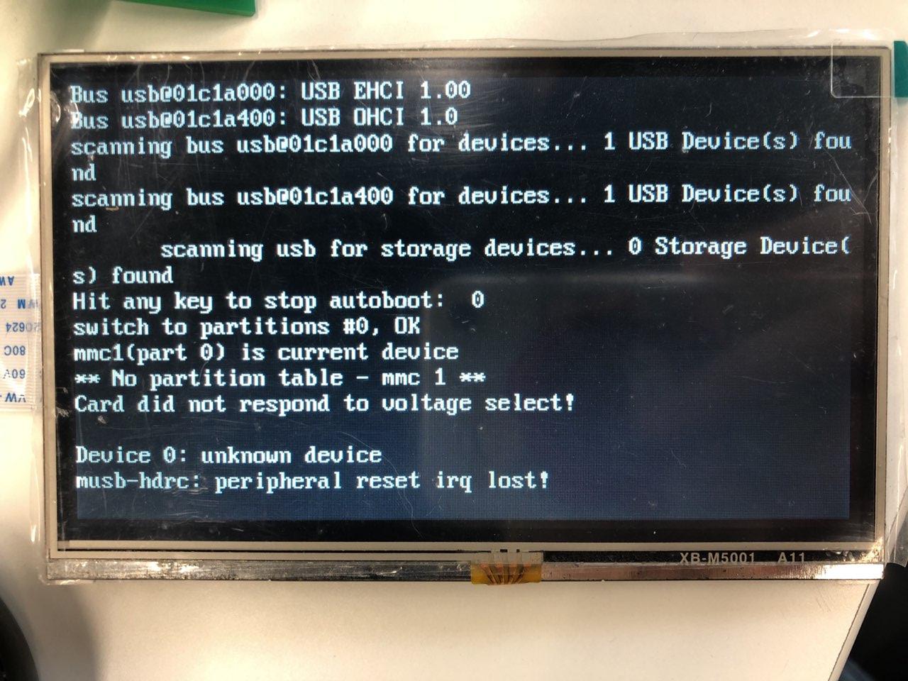

Allwinner S3 u-boot 2020.04 (DisplayEngine2 + Fastboot线刷)
白嫖: https://github.com/aodzip/u-boot/tree/Allwinner-S3
可能是S3目前最好用的u-boot了
支持LCD,支持以太网,支持USB Gadget
LCD演示:
Fastboot演示:
./fel-flash.sh
sunxi-fel -p uboot output/images/u-boot-sunxi-with-spl.bin
fastboot oem format
fastboot flash loader output/images/u-boot-sunxi-with-spl.bin
fastboot flash esp output/images/boot.vfat
fastboot flash system output/images/rootfs.ext4
fastboot reboot

#2 2020-04-21 12:15:10
已发帖子: 1,139
积分: 1091.5
Re: Allwinner S3 u-boot 2020.04 (DisplayEngine2 + Fastboot线刷)
是安卓那个fastboot工具吗?这个工具好用

生产力级别的u-boot

给SDC2加了时钟降速功能,为了兼容某些品牌SD NAND自己上报能跑50M结果真跑了50M存储控制器直接死机的问题。

感觉uboot加上LCD显示没有太大用,最多显示一下开机logo就行了
楼主 #13 2020-04-24 10:42:58
aodzip
注册时间: 2019-10-15
已发帖子: 130
积分: 100
龙折翼 说:
就是显示logo用的,不然你在kernel完全加载之前会白屏很长一段时间,用户体验差(除非你Kernel在几百毫秒内就能启动完成
Net:   phy interface0
eth0: ethernet@1c30000
Warning: usb_ether MAC addresses don't match:
Address in ROM is               de:ad:be:ef:00:01
Address in environment is       12:81:3e:a8:58:d8
, eth1: usb_ether
starting USB...
Bus usb@1c1a000: USB EHCI 1.00
Bus usb@1c1a400: USB OHCI 1.0
Bus usb@1c1b000: USB EHCI 1.00
Bus usb@1c1b400: USB OHCI 1.0
Bus usb@1c1c000: USB EHCI 1.00
Bus usb@1c1c400: USB OHCI 1.0
Bus usb@1c1d000: USB EHCI 1.00
Bus usb@1c1d400: USB OHCI 1.0
scanning bus usb@1c1a000 for devices... 1 USB Device(s) found
scanning bus usb@1c1a400 for devices... 1 USB Device(s) found
scanning bus usb@1c1b000 for devices... 1 USB Device(s) found
scanning bus usb@1c1b400 for devices... 1 USB Device(s) found
scanning bus usb@1c1c000 for devices... 1 USB Device(s) found
scanning bus usb@1c1c400 for devices... 1 USB Device(s) found
scanning bus usb@1c1d000 for devices... 1 USB Device(s) found
scanning bus usb@1c1d400 for devices... 1 USB Device(s) found
       scanning usb for storage devices... 0 Storage Device(s) found
switch to partitions #0, OK
mmc1(part 0) is current device
** Unrecognized filesystem type **
MMC: no card present
Device 0: unknown device
musb-hdrc: peripheral reset irq lost!
我在 H3 上试下了,串口这个提示信息和你截图的一样
但是我在 Ubuntu PC 中使用 sudo fastboot devices 检测不到设备,一直提示
$ sudo fastboot oem
< waiting for device >
现在是不是Ubuntu Pc 的 fastboot 的配置有问题
如果板子log停在 musb-hdrc: peripheral reset irq lost! 这里,是不是说明板子那边配置应该已经正常了,谢谢!
最近编辑记录 Daniel (2020-04-27 15:44:17)
楼主 #22 2020-04-27 15:48:55
aodzip
注册时间: 2019-10-15
已发帖子: 130
积分: 100
Daniel 说:
Net:   phy interface0
H3我不了解具体情况,我这个代码里存在部分专门为S3做的适配,H3用很可能出BUG。可能具体的一些调整操作要你自己来做了。
fastboot不认看看dmesg中有没有枚举设备,如果没有的话可能就有点麻烦
#23 2020-04-27 15:53:18
Daniel
注册时间: 2020-04-27
谢谢,看来是我 fastboot 配置的问题,用全志的 fastboot 可以识别并操作

奇怪,我的背光也亮不起来。
#50 2021-09-01 22:01:23
tigger
注册时间: 2021-06-18
已发帖子: 172
积分: 111
ubuntu 说:
奇怪,我的背光也亮不起来。
以前玩过,pwm感觉是有bug,用uboot命令行
gpio set pb4
就可以点亮屏幕。
