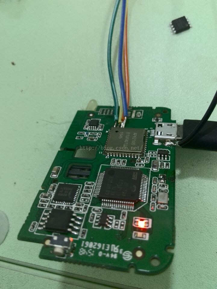

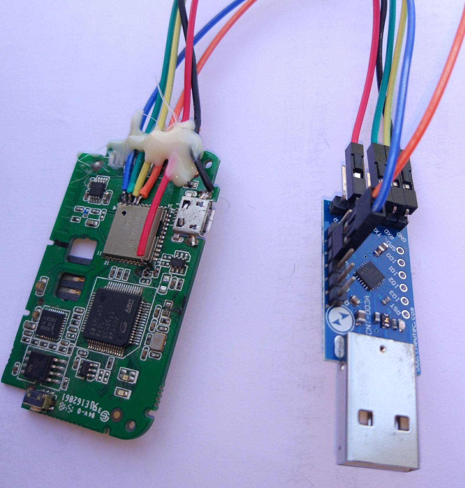

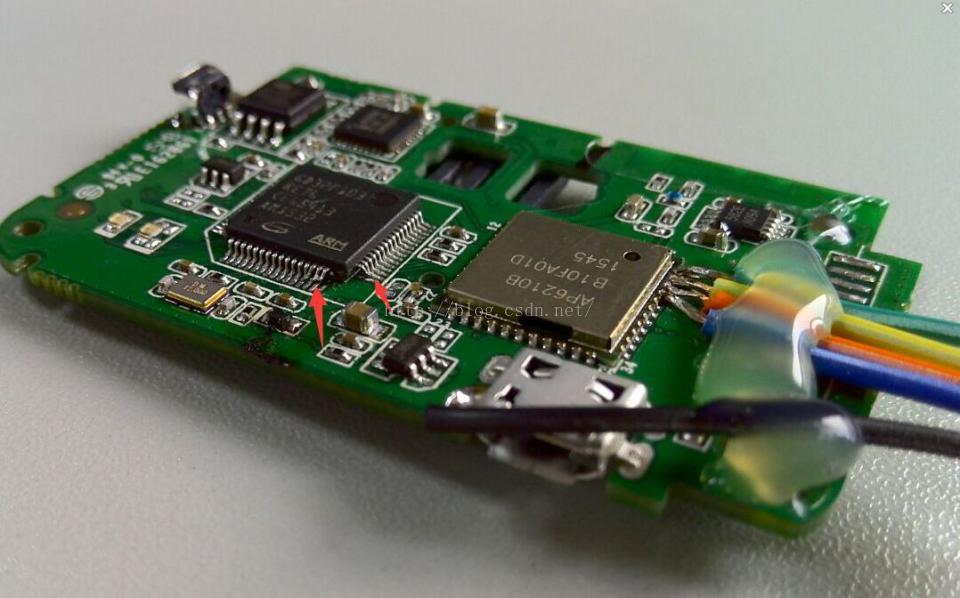

很早以前的Win7 VMWare Ubuntu12.04LTS/15.10 使用AP6210B蓝牙模块记录(2016-02-18)

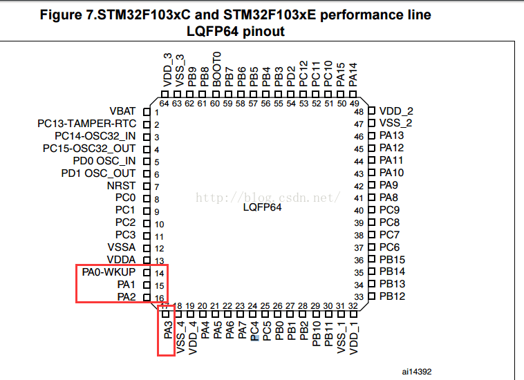

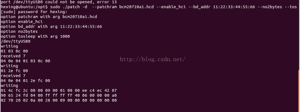

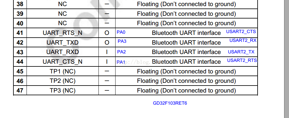

硬件上要把GD32的四个串口引脚断开, 从AP6210B的串口飞线, 接USB的FT232R, 挂载到VMWARE+UBUNTU上

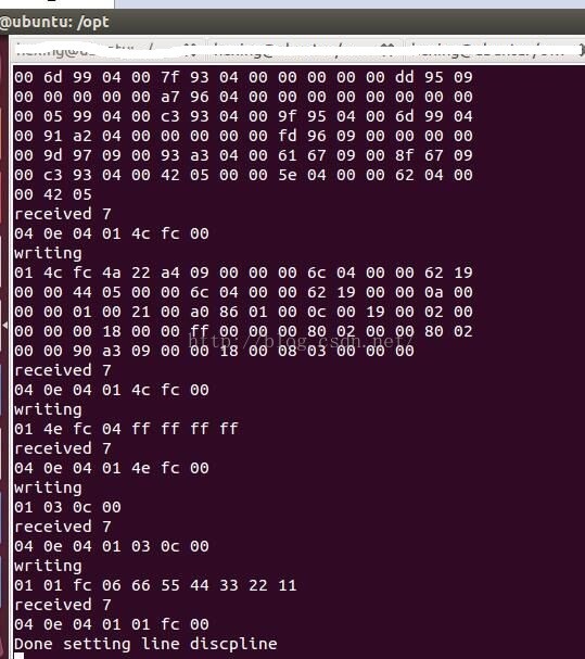

执行Broadcom 蓝牙初始化程序:
http://linux-sunxi.org/Cubietruck/Bluetooth
./brcm_patchram_plus -d --patchram /lib/firmware/ap6210/bcm20710a1.hcd --enable_hci --bd_addr 11:22:33:44:55:66 --no2bytes --tosleep 1000 /dev/ttyS1
brcm_patchram_plus源码:
http://distro.ibiblio.org/fatdog/source/700/patches/brcm_patchram_plus.c
AP6210B/bcm2076b1.hcd 补丁:
https://github.com/thesawolf/android_device_rockchip_rk3188/tree/master/libs/bluetooth/firmware

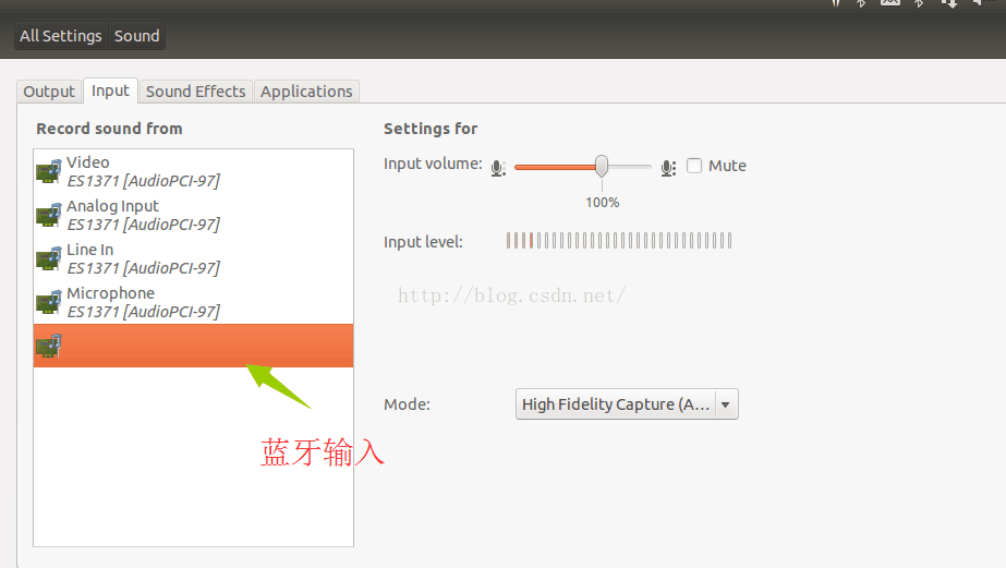

无论做A2DP source还是sink, 声音都卡出翔了, 估计应该是串口的速率没设置好, 博通的蓝牙模组上3Mbps问题不大。

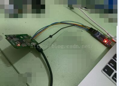

时隔几年从箱底里面拿出来, 接上新买的 cp2104 转换板晒一晒:

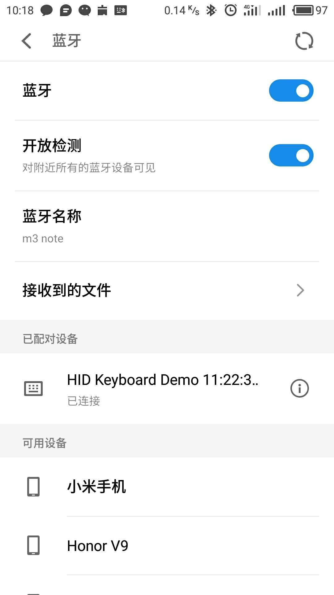

运行扫码,仍然很正常:
xxx@ubuntu:/opt/rtl8723bs_bt$ sudo hcitool scan
Scanning ...
B0:E5:ED:80:XX:F9 Honor V9
74:23:44:D1:XX:56 小米手机
xxx@ubuntu:/opt/rtl8723bs_bt$ sudo hcitool lescan
LE Scan ...
CE:36:5F:C0:XX:9B (unknown)
B0:E5:ED:4F:XX:0B (unknown)
CE:36:5F:C0:XX:9B MI Band 2

试一试执行初始化程序:
sudo ./brcm_patchram_plus -d --patchram bcm20710a1.hcd --bd_addr 11:22:33:44:55:66 --no2bytes --tosleep 1000 /dev/ttyUSB1
xxx@ubuntu:/opt/rtl8723bs_bt$ sudo ./brcm_patchram_plus -d  --patchram bcm20710a1.hcd --bd_addr 11:22:33:44:55:66 --no2bytes --tosleep 1000 /dev/ttyUSB1
writing
01 03 0c 00
received 7
04 0e 04 01 03 0c 00
writing
01 2e fc 00
received 7
04 0e 04 01 2e fc 00
writing
01 4c fc 2c 00 00 09 00 01 08 00 ee c4 ec 42 07
90 65 24 fd 04 00 ff ff ff ff 40 06 00 00 00 a0
02 70 20 02 0a 00 28 00 09 00 00 00 00 00 00 00
received 7
04 0e 04 01 4c fc 00
writing
01 4c fc ff 28 00 09 00 41 29 00 42 43 4d 32 30
37 30 32 41 31 20 47 65 6e 65 72 69 63 20 55 41
52 54 20 43 6c 61 73 73 20 31 20 40 20 32 36 20
4d 48 7a 00 69 02 00 00 00 5d 0c 00 0a 64 e6 b0
00 00 88 98 42 5a 33 43 5f 09 00 3c 28 01 00 04
00 04 f7 0c 0a 6f 00 98 16 08 00 c6 00 f3 02 5d
00 66 03 30 00 c9 00 e1 02 68 00 5c 03 36 00 c3
00 e2 02 6a 00 53 03 3c 00 c2 00 e1 02 6c 00 4e
03 41 00 c5 00 d6 02 72 00 4a 03 43 00 c3 00 ce
02 79 00 42 03 48 00 c5 00 c0 02 83 00 3a 03 4e
00 c8 00 bf 02 82 00 3b 03 4e 00 c9 00 bc 02 84
00 37 03 52 00 08 08 07 07 07 07 07 07 06 06 06
06 05 05 05 05 02 c0 68 01 94 fc 0e 00 ff ff 00
00 66 02 00 00 30 fc 0e 00 ff ff 0f 00 63 04 00
00 00 fd 0e 00 ff ff 0f 00 68 02 00 00 88 fc 0e
00 ff ff 00 00 00 04 00 00 2c fc 0e 00 ff ff 00
00 49 04
received 7
writing
01 4c fc ff 23 01 09 00 00 00 70 fc 0e 00 ff ff
00 00 0b 09 00 00 74 fc 0e 00 ff ff 00 00 2e 01
00 00 d8 ff 0e 00 ff ff 00 00 62 19 00 00 d0 fc
0e 00 ff ff 00 00 20 c9 00 00 c8 fc 0e 00 ff ff
00 00 38 85 00 00 dc fc 0e 00 ff ff 00 00 1c c8
00 00 cc fd 0e 00 ff ff 00 00 04 80 00 00 5c fc
0e 00 ff ff 00 00 02 00 00 00 20 fc 0e 00 ff ff
00 00 19 21 00 00 e0 fc 0e 00 00 80 00 00 00 00
00 00 c0 fc 0e 00 ff ff 00 00 22 00 00 00 94 8f
08 00 ff ff ff ff 00 12 00 12 98 8f 08 00 ff ff
00 00 00 12 00 00 9c 8f 08 00 00 ff ff ff 00 09
09 09 cc fc 0e 00 ff ff 00 00 2b 45 00 00 78 00
0f 00 ff ff ff ff 0d 08 09 09 68 00 0f 00 ff 00
ff ff 0d 00 0d 0d 6c 00 0f 00 ff 00 ff ff 0d 00
0d 0d 90 00 0f 00 00 00 00 ff 00 00 00 80 0c 01
0f 00 00 00 ff ff 00 00 08 08 88 00 0f 00 f0 00
00 00 80
received 7
writing
01 4c fc ff 1e 02 09 00 00 00 00 2c 01 0f 00 ff
00 00 00 07 00 00 00 24 01 0f 00 00 00 00 ff 00
00 00 05 30 01 0f 00 00 ff 00 00 00 08 00 00 20
01 0f 00 00 00 00 ff 00 00 00 06 d0 7b 00 01 04
0a 08 fc 0e 00 ff ff 00 00 2e 36 00 00 0c fc 0e
00 ff ff 00 00 2c ae 00 00 10 fc 0e 00 ff ff 00
00 2a ac 00 00 14 fc 0e 00 ff ff 00 00 a2 22 00
00 18 fc 0e 00 ff ff 00 00 1d 20 00 00 1c fc 0e
00 ff ff 00 00 0d 15 00 00 20 fc 0e 00 ff ff 00
00 85 8d 00 00 24 fc 0e 00 ff ff 00 00 83 11 00
00 28 fc 0e 00 ff ff 00 00 00 01 00 00 98 ff 0e
00 ff ff 00 00 3e 41 00 00 c3 16 00 12 69 14 19
31 08 70 04 78 36 04 24 30 60 71 80 76 4a 31 08
29 0a 6f 21 00 02 30 19 05 cb 00 00 00 ba 14 7f
71 00 a7 00 00 00 92 00 00 00 00 14 00 00 00 00
00 00 00 00 00 00 0a 08 00 f4 0a 08 00 00 01 00
00 58 01
received 7
writing
01 4c fc ff 19 03 09 00 00 1f cf 09 00 10 0f 0c
6e f0 b0 09 f0 60 d1 09 00 01 04 03 03 6b 14 20
20 6b 1a 24 00 ff 01 08 08 0a 13 06 11 02 0f fe
0d fa 0b f6 09 f2 07 ee 05 0a 13 06 11 02 0f fe
0d fa 0b f6 09 f2 07 ee 05 03 01 00 01 82 d6 00
04 06 02 02 0a 23 3c 5a 6e 7d 80 00 80 00 80 00
80 00 80 00 80 00 80 02 80 02 80 02 80 02 80 02
80 02 14 ff 20 88 0a ff 61 00 00 00 00 00 00 00
00 00 00 00 00 00 14 ff 20 82 0a ff 61 00 00 00
00 00 00 00 00 00 00 00 00 00 14 ff 20 00 0a ff
61 00 00 00 00 00 00 00 00 00 00 00 00 00 14 ff
20 08 0a ff 61 00 00 00 00 00 00 00 00 00 00 00
00 00 14 ff 20 0b 0a ff 61 00 00 00 00 00 00 00
00 00 00 00 00 00 14 ff 20 10 0a ff 61 00 00 00
00 00 00 00 00 00 00 00 00 00 40 ff ff 68 02 7b
00 00 00 00 40 ff ff 68 02 7b 00 00 00 00 40 ff
ff 68 02
received 7
writing
01 4c fc ff 14 04 09 00 7b 00 00 00 00 40 ff ff
68 02 7b 00 00 00 00 40 ff ff 69 02 7b 00 00 00
00 40 ff ff 69 02 7b 00 00 00 00 82 d6 00 ff 06
02 02 0a 23 3c 5a 6e 7d 80 00 80 00 80 00 80 00
80 00 80 00 80 02 80 02 80 02 80 02 80 02 80 02
14 ff 19 88 0a ff 20 00 00 00 00 00 00 00 00 00
00 00 00 00 14 ff 19 82 0a ff 43 00 00 00 00 00
00 00 00 00 00 00 00 00 14 ff 19 00 0a ff 66 00
00 00 00 00 00 00 00 00 00 00 00 00 14 ff 19 08
0a ff 66 00 00 00 00 00 00 00 00 00 00 00 00 00
14 ff 19 0b 0a ff 43 00 00 00 00 00 00 00 00 00
00 00 00 00 14 ff 19 10 0a ff 20 00 00 00 00 00
00 00 00 00 00 00 00 00 41 00 00 00 00 7b 00 00
00 00 41 00 00 00 00 7b 00 00 00 00 41 00 00 00
00 7b 00 00 00 00 41 00 00 00 00 7b 00 00 00 00
41 00 00 00 00 7b 00 00 00 00 41 00 00 00 00 7b
00 00 00
received 7
writing
01 4c fc ff 0f 05 09 00 00 86 12 00 04 13 00 40
08 00 00 40 13 00 01 00 01 80 ff 00 01 13 c1 5e
00 7c cb 1e 85 b4 7c cb 1e 85 b4 26 04 b1 04 b2
04 b3 04 b4 04 b5 04 b6 04 b7 04 b8 04 b9 04 ba
04 bb 04 bc 04 bd 04 be 04 bf 04 c0 04 c1 04 c2
04 c3 04 c4 04 c5 04 c6 04 c7 04 c8 04 c9 04 ca
04 cb 04 cc 04 cd 04 ce 04 cf 04 d0 04 d1 04 d2
04 d3 04 d4 04 d5 04 d6 04 d7 04 d8 28 0c 00 0b
04 00 0e 4c 09 00 0b 04 00 e4 4c 09 00 0b 04 00
52 4e 09 00 08 25 00 00 b0 db 01 00 78 f0 1e fc
16 00 f0 63 09 00 28 1c fe f7 33 ff 28 1c 5f 30
00 21 01 70 39 1c 32 1d 87 f7 d7 fb 08 0f 00 01
84 e0 00 00 30 bd 00 b5 00 00 00 00 00 00 08 17
00 02 88 e0 00 00 87 f0 48 f9 08 00 1c 53 09 00
00 f0 02 f8 00 bd 00 00 08 1d 00 03 c4 62 00 00
8f f0 59 fb 0e 00 7a 59 09 00 01 b4 ff f7 69 ff
01 bc 70
received 7
writing
01 4c fc ff 0a 06 09 00 f7 a9 fc 00 00 08 15 00
04 58 66 00 00 8f f0 8c f9 06 00 74 59 09 00 ff
f7 96 ff 30 bd 0b 04 00 1a 5b 09 00 0b 04 00 44
5b 09 00 08 15 00 05 c0 84 00 00 8d f0 00 fe 06
00 c4 60 09 00 ff f7 a6 ff 30 bd 08 2d 00 06 b4
77 02 00 6e f0 89 fc 1e 00 ca 60 09 00 02 b4 61
68 49 07 c9 0f 30 1c 91 f7 f5 fc 02 bc 00 29 02
d0 f0 69 91 f7 6a fb 91 f7 6c fb 08 0f 00 07 24
b5 00 00 0f e0 c0 46 00 00 00 00 00 00 08 0f 00
08 c4 4f 00 00 10 e0 c0 46 00 00 00 00 00 00 08
67 00 09 1c f0 03 00 57 f0 64 f8 58 00 e8 60 09
00 70 b5 06 1c 0c 1c 15 1c 00 2b 21 d1 04 a8 00
88 40 28 1d d1 05 a8 00 88 20 28 19 d1 5a 29 17
d8 08 1c 15 d0 04 f0 be f8 00 28 11 d1 03 2d 0f
d0 22 04 12 14 08 21 07 48 00 23 04 f0 bb f8 00
28 06 d1 22 1c 29 1c 30 1c a9 f7 33 f8 01 20 00
e0 00 20
received 7
writing
01 4c fc ff 05 07 09 00 70 bd 18 65 08 00 08 0f
00 0a 98 80 00 00 58 08 04 2b 00 00 00 00 00 00
08 17 00 0b 68 0c 04 00 55 f0 6a fa 08 00 40 61
09 00 00 f0 02 f8 70 bd 00 00 08 19 00 0c 64 d4
00 00 88 f0 ee fe 0a 00 44 62 09 00 28 1c fe f7
e3 ff 77 f7 20 f9 08 13 00 0d 08 d6 00 00 88 f0
21 fe 04 00 4e 62 09 00 77 f7 de f9 08 0f 00 0e
80 da 00 00 c0 46 c0 46 00 00 00 00 00 00 08 15
00 0f 24 52 00 00 91 f0 15 f8 06 00 52 62 09 00
00 f0 01 f8 f0 bd 0b 04 00 b4 63 09 00 08 19 00
10 84 5c 02 00 70 f0 bf fb 0a 00 06 64 09 00 9b
00 58 59 ef 18 8f f7 3c fc 08 17 00 11 64 f8 00
00 86 f0 d4 fd 08 00 10 64 09 00 00 f0 02 f8 f0
bd 00 00 08 17 00 12 3c f5 00 00 86 f0 d4 ff 08
00 e8 64 09 00 00 f0 02 f8 30 bd 00 00 08 2f 00
13 c4 f6 01 00 76 f0 4e ff 20 00 64 65 09 00 05
4b 30 b4
received 7
writing
01 4c fc ff 00 08 09 00 05 4c e5 79 49 19 0c 06
21 16 30 bc 19 54 89 f7 a7 f8 c0 46 90 34 08 00
8c 03 08 00 08 17 00 14 48 7c 02 00 6e f0 9c fc
08 00 84 65 09 00 00 f0 02 f8 70 bd 00 00 08 2b
00 15 d4 ba 00 00 8a f0 92 fd 1c 00 fc 65 09 00
0a b4 20 1c 31 1c 00 f0 09 f8 0a bc 01 28 03 d0
04 2b 01 d1 75 f7 62 fa 75 f7 63 fa 08 1f 00 16
2c f0 00 00 87 f0 01 fb 10 00 32 66 09 00 01 b4
83 f7 3f fc 01 bc 00 f0 24 f8 78 f7 f7 fc 08 25
00 17 e4 a2 03 00 5c f0 ad f9 16 00 42 66 09 00
00 28 06 d1 00 f0 07 f8 00 28 02 d1 01 20 a3 f7
74 fe a3 f7 4a fe 08 17 00 18 c0 6a 02 00 6f f0
ea fd 08 00 98 66 09 00 00 f0 02 f8 30 bd 00 00
08 23 00 19 c4 72 02 00 6f f0 88 fa 14 00 d8 67
09 00 08 b4 30 1c 01 22 01 23 00 f0 04 f8 08 bc
90 f7 71 fd 00 00 92 06 00 a3 00 80 00 14 19 08
17 00 1a
received 7
writing
01 4c fc ff fb 08 09 00 28 48 02 00 72 f0 9a f8
08 00 60 69 09 00 00 f0 69 fa 8d f7 bd ff 08 17
00 1b b4 73 02 00 70 f0 fa fc 08 00 ac 7d 09 00
ff f7 5d fe 8f f7 91 fb 08 0f 00 1c 34 c4 01 00
c0 46 20 1c 00 00 00 00 00 00 08 17 00 1d 24 47
02 00 72 f0 20 f9 08 00 68 69 09 00 00 f0 f7 f9
8d f7 ef fe 08 17 00 1e 68 47 02 00 72 f0 02 f9
08 00 70 69 09 00 00 f0 09 fa 8d f7 07 ff 08 17
00 1f 0c 4d 02 00 71 f0 34 fe 08 00 78 69 09 00
00 f0 99 fa 8e f7 de f9 08 17 00 20 40 4d 02 00
71 f0 1e fe 08 00 80 69 09 00 00 f0 af fa 8e f7
f8 f9 08 17 00 21 7c 4d 02 00 71 f0 04 fe 08 00
88 69 09 00 00 f0 07 fc 8e f7 0c fa 08 17 00 22
78 54 02 00 72 f0 88 fc 08 00 8c 7d 09 00 ff f7
58 fd 8d f7 83 fb 08 17 00 23 0c 57 02 00 72 f0
42 fb 08 00 94 7d 09 00 ff f7 b4 fd 8d f7 06 fd
08 19 00
received 7
writing
01 4c fc ff f6 09 09 00 24 44 72 01 00 80 f0 a3
ff 0a 00 8e 81 09 00 ff f7 f5 ff 7f f7 5a f8 00
00 08 17 00 25 4c 58 02 00 72 f0 a6 fa 08 00 9c
7d 09 00 ff f7 24 ff 8d f7 6d fe 08 17 00 26 5c
46 02 00 73 f0 aa fb 08 00 b4 7d 09 00 fe f7 74
fe 8c f7 5f fc 08 17 00 27 08 65 01 00 80 f0 42
fa 08 00 90 69 09 00 00 f0 fd fd 7f f7 d2 fd 08
17 00 28 34 ae 01 00 7d f0 76 fa 08 00 24 83 09
00 02 b0 ff f7 57 ff 70 bd 08 17 00 29 08 6e 00
00 90 f0 cc ff 08 00 a4 7d 09 00 ff f7 f9 fd 6f
f7 6a f8 08 7f 01 2a a4 44 00 00 94 f0 4a f8 70
01 3c 85 09 00 00 b5 28 49 0b 68 26 49 0b 60 24
49 0b 68 22 49 0b 60 1e 49 0b 68 2d 49 0b 60 43
4b 43 49 0b 60 34 49 0b 68 01 20 c0 03 03 43 0b
60 40 49 0b 78 00 2b 04 d0 2f 49 0b 68 40 03 03
43 0b 60 2d 4a 13 68 5b 08 5b 00 13 60 3a 4b 3b
4a 13 60
received 7
writing
01 4c fc ff f1 0a 09 00 b0 f7 e6 fe b1 f7 0f fb
b1 f7 5e fe b2 f7 04 f8 0d 21 36 48 01 f0 a5 fe
36 4a 90 68 00 28 03 d0 99 f7 0f f8 b0 f7 ab fd
24 48 24 4a 11 68 41 60 24 4a 60 e0 c0 46 c0 b0
08 00 ff f2 01 1a 48 a5 09 00 84 8f b0 02 d0 8b
0e 00 a0 80 0e 00 4c a5 09 00 14 8b 0e 00 50 a5
09 00 6c e5 05 00 54 a5 09 00 8c 15 08 00 23 84
09 00 53 84 09 00 2d 85 09 00 a9 84 09 00 15 85
09 00 5c 00 0f 00 94 83 0e 00 ff 00 ff ff 60 8b
0e 00 40 23 00 01 e0 8a 0e 00 e0 2c 08 00 a4 86
0e 00 88 b2 08 00 05 00 00 80 85 00 00 80 1c 80
0e 00 14 80 0e 00 84 8f 08 00 04 83 0e 00 10 8b
0e 00 c8 fc 0e 00 c4 2c 08 00 cc 2c 08 00 d0 2c
08 00 c8 2c 08 00 d4 2c 08 00 d4 ff 0e 00 bc 8b
0e 00 ad 02 00 00 cc 8b 0e 00 1c cd 08 00 10 32
54 76 d4 8b 0e 00 00 9d 08 00 ec cc 08 00 11 68
41 61 05
received 7
writing
01 4c fc ff ec 0b 09 00 4a 11 68 81 60 05 4a 13
68 03 60 04 4a 13 68 04 4a 13 60 00 bd c0 46 d0
2c 08 00 c8 2c 08 00 d4 2c 08 00 d4 ff 0e 00 08
61 00 2b 00 44 00 00 93 f0 94 ff 52 00 2c 83 09
00 10 b5 a4 48 00 23 83 70 04 23 43 70 01 23 03
70 a1 4b a2 48 03 60 a2 4b a2 4c 23 60 a2 4c 23
68 a2 4c 23 60 a2 4c 23 68 a2 4c 23 60 2c 22 a2
49 a2 48 bc f7 11 fb a1 48 a1 4c 20 60 a1 49 c1
60 a1 49 41 62 a1 49 01 61 a1 4b 83 61 a1 4b c3
61 10 bd 08 0f 00 2c d0 b8 04 00 a5 f8 09 e0 00
00 00 00 00 00 08 17 00 2d 20 ba 04 00 4d f0 9c
f8 08 00 5c 8b 09 00 ff f7 d4 ff 30 bd 00 00 08
17 00 2e 30 69 04 00 52 f0 20 fa 08 00 74 8d 09
00 ff f7 c4 ff ad f7 f8 fd 08 19 00 2f 54 5d 04
00 53 f0 12 f8 0a 00 7c 8d 09 00 b4 f7 70 f8 ff
f7 b2 ff 30 bd 08 19 00 30 e0 a5 04 00 4e f0 d1
fb 0a 00
received 7
writing
01 4c fc ff e7 0c 09 00 86 8d 09 00 00 f0 03 f8
03 b0 f0 bd 00 00 08 17 00 31 e8 82 04 00 50 f0
a0 fd 08 00 2c 8e 09 00 00 f0 02 f8 30 bd 00 00
08 17 00 32 b0 b1 04 00 4d f0 ba fe 08 00 28 8f
09 00 00 f0 02 f8 30 bd 00 00 08 2b 00 33 dc c0
04 00 4c f0 86 ff 1c 00 ec 8f 09 00 ff 23 3d 33
43 43 04 48 c0 18 9f 30 00 78 00 28 00 d1 01 20
70 47 c0 46 34 9d 08 00 08 1b 00 34 94 ac 04 00
4e f0 c2 f9 0c 00 1c 90 09 00 20 1c 00 f0 03 f8
b1 f7 3a fe 00 00 08 1b 00 35 ac ac 04 00 4e f0
02 fa 0c 00 b4 90 09 00 20 1c 00 f0 03 f8 b1 f7
fa fd 00 00 08 23 00 36 3c c1 04 00 4c f0 64 ff
14 00 08 90 09 00 29 18 7f 23 1b 02 ff 33 9d 42
00 d3 5d 1e ff 23 b3 f7 92 f8 08 17 00 37 98 1b
03 00 67 f0 04 fb 08 00 a4 91 09 00 ff f7 d2 ff
30 bd 00 00 08 2b 00 38 1c 7b 04 00 51 f0 5e fb
1c 00 dc
received 7
writing
01 4c fc ff e2 0d 09 00 91 09 00 04 91 0f b4 30
1c ff f7 e3 ff 01 28 02 d1 0f bc 05 b0 f0 bd 0f
bc 06 2d ae f7 94 fc 08 1f 00 39 18 ac 04 00 4e
f0 2a fb 10 00 70 92 09 00 03 d1 ff f7 c1 ff b1
f7 d2 fc b1 f7 d1 fc 00 00 08 0f 00 3a 1c 73 04
00 c0 46 c0 46 00 00 00 00 00 00 08 17 00 3b 80
7a 04 00 51 f0 ac fc 08 00 dc 93 09 00 04 20 ae
f7 5a ff 10 bd 08 17 00 3c 98 82 04 00 51 f0 a4
f8 08 00 e4 93 09 00 ff f7 ca ff 30 bd 00 00 08
17 00 3d 6c a8 04 00 4e f0 72 fe 08 00 54 95 09
00 ff f7 4a ff f0 bd 00 00 08 15 00 3e 94 a3 04
00 4f f0 7e fa 06 00 94 98 09 00 ff f7 e8 ff 10
bd 08 0f 00 3f 0c a3 04 00 00 f0 1d f8 00 00 00
00 00 00 08 23 00 40 48 94 00 00 90 f0 27 fa 14
00 9a 98 09 00 01 2b 02 d1 00 20 28 70 01 e0 6f
f7 dc fd 62 68 6f f7 18 fe 08 1d 00 41 a4 cc 04
00 4c f0
received 7
writing
01 4c fc ff dd 0e 09 00 03 fe 0e 00 ae 98 09 00
28 78 b2 f7 79 f9 20 1c 00 f0 01 f8 30 bd 08 0f
00 42 c4 a9 04 00 5e 4a 20 68 00 00 00 00 00 00
08 0f 00 43 a4 63 04 00 fe 23 f5 33 00 00 00 00
00 00 08 1f 00 44 d4 72 00 00 92 f0 fc fa 10 00
d0 98 09 00 30 1c 04 99 00 f0 04 f8 00 99 88 42
6d f7 fc fc 08 17 00 45 98 97 04 00 50 f0 c8 f8
08 00 2c 99 09 00 ff f7 9f fe f0 bd 00 00 08 17
00 46 e4 9d 04 00 4f f0 94 ff 08 00 10 9d 09 00
00 f0 02 f8 f0 bd 00 00 08 15 00 47 d0 99 01 00
80 f0 e8 fa 06 00 a4 9f 09 00 ff f7 b2 ff 00 bd
08 15 00 48 68 e9 01 00 7b f0 1f fb 06 00 aa 9f
09 00 ff f7 c2 ff 00 bd 08 21 00 49 a4 e9 01 00
7b f0 04 fb 12 00 b0 9f 09 00 0f b4 30 1c ff f7
c6 ff 0f bc 0a 22 31 1c 84 f7 f3 fc 08 0f 00 4a
c8 89 03 00 40 23 03 60 00 00 00 00 00 00 08 19
00 4b 88
received 7
writing
01 4c fc fe d8 0f 09 00 85 03 00 61 f0 1b fd 0a
00 c2 9f 09 00 00 f0 03 f8 9e f7 43 fb 00 00 08
bf 00 4c 54 64 02 00 73 f0 1e fe b0 00 94 a0 09
00 00 b5 1e 4b 1a 68 0d 2a 2e d0 09 2a 04 d1 08
43 04 d0 9e f7 60 fb 01 e0 0c 2a 04 d1 1f 49 0b
68 00 20 18 60 28 e0 07 2a 26 d0 9b f7 12 ff 13
49 0b 68 01 2b 12 d1 12 49 0b 68 1b 01 0e d4 1a
49 0b 68 00 2b 0a d0 0e 48 03 68 db 01 02 d5 12
49 08 68 06 e0 10 49 0b 68 58 00 02 e0 00 28 0b
d0 02 e0 0e 49 0b 68 18 60 01 20 9e f7 31 fe 0f
49 0b 68 20 20 03 43 0b 60 00 bd c0 46 b0 c8 08
00 40 1b 08 00 b4 5f 08 00 40 0b 08 00 23 c3 08
00 d4 ca 08 00 f4 0a 08 00 0c 0b 08 00 e4 0a 08
00 e4 ca 08 00 53 86 03 00 e4 c7 08 00 20 04 0e
00 08 1b 00 4d d0 6c 02 00 73 f0 a6 fa 0c 00 20
a2 09 00 01 98 00 f0 03 f8 02 b0 f0 bd 00 00 fe
00 00
received 7
writing
01 4c fc ff 00 4b 09 00 f0 b5 48 4c 48 4b 49 48
03 60 49 4b 49 48 03 60 01 f0 f4 fe 00 f0 98 fb
00 f0 ae f9 00 f0 58 fb 00 f0 b6 fa 00 f0 c8 fa
03 f0 6f fe 42 4a 15 1c e4 35 42 4b 2b 60 42 4e
33 68 02 26 33 43 40 4e 33 60 40 48 03 68 80 21
8b 43 03 60 00 23 3e 4e 33 70 3e 49 0b 1c 23 33
3d 4e 33 60 3d 4b 3e 4e 33 60 3e 4b 3e 4e 33 60
0b 1c 12 33 3d 4e 33 60 3d 4b 3e 4e 33 60 3e 48
3e 4b 3f 4e 33 60 03 1c 0e 33 3e 4e 33 60 12 23
3d 4e 33 70 0b 1c 11 33 3c 4e 33 60 3c 4b 3d 4e
33 60 3d 4b 3d 4e 33 60 3d 4e 31 60 3d 4b 3e 4e
33 60 3e 4e 33 68 3e 4e 33 60 3e 4b 3e 4e 33 60
3e 4b 6b 67 3e 4b 06 1c 07 1d c8 c4 0e 36 3d 4f
c8 c4 99 1c 0e 30 06 1c c2 c4 3b 4b d3 62 00 23
3a 4e 33 60 04 f0 34 fe 39 4b 6b 65 e4 20 9e f7
3d fb 00 07 00 0f 04 28 05 d1 3f 20 c0 43 35 4a
50 73 00
received 7
writing
01 4c fc ff fb 4b 09 00 0a 90 73 00 23 33 49 0b
70 33 48 e8 62 f0 bc 08 bc 18 47 00 b5 31 48 32
49 08 60 32 48 07 49 c8 64 00 f0 24 f9 00 bd c0
46 14 a4 09 00 91 52 09 00 bc c8 08 00 95 52 09
00 f0 c4 08 00 a0 19 08 00 45 53 09 00 6c 01 0f
00 40 15 08 00 fd 07 08 00 1e 45 00 00 6c a4 09
00 20 c9 00 00 70 a4 09 00 1c c8 00 00 74 a4 09
00 78 a4 09 00 38 85 00 00 7c a4 09 00 5e 04 00
00 44 05 00 00 88 13 08 00 8c 13 08 00 90 13 08
00 78 13 08 00 0e c9 00 00 80 13 08 00 0a c8 00
00 7c 13 08 00 84 13 08 00 26 85 00 00 74 13 08
00 d8 ff 0e 00 80 a4 09 00 62 16 00 00 84 a4 09
00 f9 58 09 00 42 05 00 00 62 19 00 00 81 92 09
00 68 a4 09 00 4d 65 09 00 b8 13 08 00 ba a5 09
00 59 9e 09 00 01 4b 09 00 90 00 08 00 79 63 09
00 70 b5 00 20 0f 49 10 4b 4b 61 14 e0 6b 09 9c
00 eb 06
received 7
writing
01 4c fc ff f6 4c 09 00 db 0e 01 25 9d 40 0b 59
2b 43 0b 51 43 00 4c 69 c5 00 52 19 52 68 01 26
32 43 27 25 ad 03 aa 1a 1a 53 01 30 05 4a c3 00
9d 58 92 2d e5 d3 70 bd c0 46 4c 1b 08 00 ac a5
09 00 0c a3 09 00 00 20 70 47 00 20 70 47 00 28
01 d0 00 20 00 e0 01 20 70 47 00 20 70 47 10 b5
03 78 14 49 0b 70 06 20 a9 f7 5f fd 04 1e 10 d0
0e 23 03 70 04 23 43 70 00 23 43 71 01 23 83 70

23 60 b3 68 1c 60 b4 60 11 e0 b4 60 24 60 0e e0
f0 68 00 28 05 d0 03 68 23 60 f3 68 1c 60 f4 60
01 e0 f4 60 24 60 21 1c 28 1c 90 f7 8c f8 01 23
bb 40 16 49 08 68 18 43 08 60 01 98 02 f0 9b fb
e8 69 00 06 c0 0e 0a 28 03 d1 38 1c 73 f7 a5 ff
09 e0 08 28 07 d1 38 1c 6c f7 58 fe 03 e0 20 1c
99 f7 c3 fc 5a e7 00 20 02 b0 f0 bd c0 46 bc c8
08 00 64 1b 08 00 bf c1 08 00 88 50 08 00 7c 29
08 00 44 a3 09 00 4c a3 09 00 6c cf 05 00 74 29
08 00 70 b5 82 b0 00 23 01 93 5f 49 08 68 20 28
00 d1 b6 e0 10 28 5a d1 5d 49 08 68 77 f7 5f fa
05 1c 5b 4e 30 1c 76 f7 82 ff 00 28 11 d0 04 1c
f8 22 13 58 01 22 13 43 f8 22 13 50 eb 69 c0 69
07 21 0b 40 88 43 18 43 e0 61 28 68 77 f7 98 f9
0c e0 2c
received 7
writing
01 4c fc ff 39 7c 09 00 1c 31 1c 28 1c 28 30 06
22 bc f7 9f fe f8 20 43 59 02 20 83 43 f8 20 43
51 31 1c 20 1c 8c f7 e5 fd 00 28 05 d0 f8 20 03
59 01 20 03 43 f8 20 03 51 20 1c ff f7 56 fc 02
f0 24 fb 01 23 21 68 8b 40 40 4a 11 68 19 43 11
60 02 f0 23 fb 20 68 6c f7 f9 fc e3 69 f8 20 83
43 10 20 03 43 e3 61 20 68 01 21 6c f7 5d fe 20
1c 8f f7 99 fe 20 1c fe f7 c6 fe ff 23 31 48 03
60 59 e0 ff 23 01 33 98 42 4a d1 2e 48 76 f7 29
ff 04 1e 50 d0 77 f7 95 fb e3 69 01 20 00 06 83
43 f8 20 83 43 10 20 03 43 e3 61 e3 6c 5b 00 5b
08 e3 64 ec 21 0b 59 00 06 83 43 0b 51 20 1c 00
21 7b f7 0d fc 20 1c 00 21 7b f7 64 fc 6b 46 01
aa 21 1c 4c 31 20 1c 28 30 96 f7 64 fa 00 28 06
d0 01 9b 00 2b 03 d0 20 1c 7b f7 5c f8 03 e0 21
1c 00 20 78 f7 3e f8 ff 23 12 48 03 60 14 48 03
68 01 2b
received 7
writing
01 4c fc 5c 34 7d 09 00 18 d1 e3 69 1b 04 15 d4
11 48 03 68 00 2b 03 d1 10 48 03 68 0e 48 03 60
8c f7 00 fd 0a e0 40 28 02 d1 8d f7 d8 fc 05 e0
01 23 5b 02 98 42 01 d1 8d f7 69 fc 01 20 02 b0
70 bd c0 46 d4 50 08 00 8c 06 08 00 e8 50 08 00
b4 c4 08 00 88 c8 08 00 88 50 08 00 48 a4 09 00
received 7
writing
01 4c fc ff bc 7d 09 00 9f 48 00 23 03 60 83 60
70 47 70 b5 9d 49 0b 68 18 0a 9d 4a 40 28 03 d1
9c 49 d1 60 9c 49 06 e0 9c 49 01 43 d1 60 03 02
19 18 9b 4b c9 18 9b 4d 29 60 9b 4c 9b 49 63 68
5b 0e 24 68 e4 07 e4 0f 63 40 09 d0 40 28 07 d1
7f 24 64 02 0b 68 96 4d 2b 40 01 25 ed 04 06 e0
fd 24 24 02 0b 68 92 4d 2b 40 03 25 ad 04 0b 60
0b 68 2b 43 0b 60 00 23 8e 4e 33 60 03 04 0b 21
09 04 59 18 21 43 03 26 31 43 8b 4e 31 60 0f 30
10 60 70 bd 10 b5 7c 4a 13 68 00 2b 05 d0 61 21
01 22 0a 54 6e f7 5b ff 05 e0 04 1c 6e f7 b5 fd
20 1c 00 f0 b0 f8 10 bc 08 bc 18 47 10 b5 04 1c
7e 48 41 6a 00 29 02 d1 83 6a 02 2b 09 d9 03 29
04 d1 83 6a ff 20 36 30 83 42 02 d2 20 1c 6e f7
f7 ff 60 23 76 48 19 5d 40 5c 80 21 01 43 75 4a
11 60 6d 48 03 68 74 4a 13 60 43 68 17 20 80 06
03 43 53
received 7
writing
01 4c fc ff b7 7e 09 00 60 ff f7 85 ff a3 7b 70
4a 13 60 00 23 6f 4a 13 60 08 21 13 20 6d f7 67
fe 10 bd 30 b5 04 1c 00 29 27 d1 ff f7 c9 ff 6a
4d 61 34 21 78 69 4a 00 23 d0 56 01 29 07 d1 7d
f7 b5 ff 00 06 01 0c 28 68 65 4a 10 40 06 e0 7d
f7 ad ff 00 06 00 0e 29 68 09 0a 09 02 08 43 28
60 4a 4a 11 68 5f 48 41 43 49 4a 10 68 00 0a 04
30 bd f7 6c f9 5c 4a 10 60 14 e0 02 29 07 d1 01
23 5a 49 0b 60 40 34 60 7f 76 f7 a5 f8 0a e0 05
29 08 d1 00 23 55 49 0b 60 ff f7 6e fc 00 28 01
d1 8c f7 40 ff 30 bc 08 bc 18 47 00 b5 37 4a 01
1c 13 68 00 2b 0d d0 93 68 00 2b 0a d1 93 89 93
60 60 31 0a 78 00 23 02 2a 00 d2 53 1c 0b 70 6e
f7 c8 fe 08 bc 18 47 00 00 2c 49 03 7d 02 2b 07
d1 08 68 43 1e 00 d3 0b 60 88 68 43 1e 00 d3 8b
60 70 47 10 b5 03 7d 09 2b 0c d1 3d 4c 3d 4a 10
68 77 f7
received 7
writing
01 4c fc 70 b2 7f 09 00 00 f9 20 60 60 68 80 21
88 43 60 60 3a 4a d0 78 20 62 10 bc 08 bc 18 47
70 b5 83 b0 00 24 36 4e 4e 25 65 43 ab 19 99 1c
35 48 06 22 02 f0 7d f9 00 28 03 d0 01 34 04 2c
f1 d3 05 e0 a9 19 48 78 00 02 09 78 08 43 00 e0
00 20 01 a9 c8 70 08 21 00 0a 02 aa 10 70 01 23
01 a8 83 70 68 46 83 1d 28 48 03 22 93 f7 0d f8
03 b0 70 bd
received 7
writing
01 4c fc ff 1e 80 09 00 f0 b5 06 1c 0f 1c 05 4c
63 68 ff 2b 45 d1 01 20 76 f7 03 fe 60 60 ff 28
3f d1 00 20 7f e0 4c a4 09 00 94 06 08 00 c8 89
0e 00 40 c0 7d c0 44 7e 00 00 00 d0 7d c0 04 3e
00 00 8c 80 0e 00 40 a5 09 00 b8 8a 0e 00 ff ff
c3 ff 94 83 0e 00 98 83 0e 00 6c 21 08 00 a8 06
08 00 a4 86 0e 00 40 82 0e 00 00 83 0e 00 f8 80
0e 00 04 83 0e 00 92 03 08 00 ff 00 ff ff 71 02
00 00 9c 83 0e 00 f0 fc 0e 00 00 82 0e 00 50 a4
09 00 0b a7 09 00 d3 a5 09 00 b7 c1 08 00 b6 fc
00 00 2a 4d 01 23 eb 74 21 69 28 1c 6e f7 06 fc
27 60 a3 89 a3 60 26 49 79 43 26 48 00 68 00 0a
04 30 bd f7 90 f8 24 49 08 60 24 23 2b 74 02 23
6b 74 31 23 ab 74 28 1c 60 30 00 23 03 70 01 23
43 70 00 23 83 70 c3 70 2b 62 5d 20 02 23 43 55
60 68 77 f7 54 f8 a8 73 01 23 eb 73 18 4f 39 1c
30 1c 8c
received 7
writing
01 4c fc 79 19 81 09 00 f7 a7 fe 60 68 77 f7 49
f8 39 1c 6e f7 4a fa 31 1c 13 48 06 22 bc f7 29
fc 21 69 28 1c 6e f7 db fb 01 20 f0 bd 09 48 03
68 00 2b 00 d0 01 23 00 2b 09 d0 00 7d 00 28 06
d0 07 28 01 d0 00 20 00 e0 01 20 00 28 00 d0 01
20 70 47 64 51 08 00 71 02 00 00 94 06 08 00 9c
83 0e 00 40 a5 09 00 0b a7 09 00 00 b5 f8 21 0b
58 5b 07 02 d4 04 21 80 f7 20 fb 00 bd
received 7
writing
01 4c fc ff 98 81 09 00 30 b5 05 1c 04 1c 08 79
00 02 c9 78 08 43 01 21 76 f7 15 fd 00 28 02 d1
12 23 2b 70 0e e0 08 34 f4 21 09 58 49 07 49 0f
00 d0 01 21 a1 71 5c 30 00 88 e0 71 00 0a 20 72
03 23 eb 70 30 bd 00 00 70 b5 82 b0 05 1c 00 24
20 01 23 18 1b 01 45 48 1e 18 f8 21 88 59 40 07
1a d4 30 68 76 f7 de ff 69 68 88 42 14 d1 30 1c
77 f7 04 f9 00 28 0f d0 3d 4b 69 46 0b 80 02 23
8b 70 5c 23 98 5b c8 70 00 0a 01 a9 08 70 39 4a
69 46 30 1c 81 f7 8a f8 01 34 0b 2c d8 d3 01 23
35 4a 13 76 68 68 72 f7 32 fe 68 68 73 f7 46 fb
68 68 b2 f7 73 f9 69 68 30 48 6e f7 28 fe 69 68
2f 48 6e f7 24 fe 69 68 2e 48 6e f7 20 fe 69 68
2d 48 6e f7 1c fe 6c 68 00 2c 45 d1 0c 23 63 43
2a 48 1d 18 a8 7a 02 28 31 d3 04 28 0e d3 2e d1
28 1c 82 f7 04 ff 06 1c 28 80 00 23 6b 72 e8 79
76 f7 18
received 7
writing
01 4c fc 95 93 82 09 00 ff a0 30 06 81 0c 30 28
e0 28 1c 82 f7 f6 fe 28 80 00 23 6b 72 eb 79 99
00 5b 18 9b 01 1b 49 5e 18 31 1c b8 31 48 71 00
23 0b 71 c4 36 b3 79 00 2b 15 d0 73 79 2b 80 b3
79 6b 80 33 79 6b 72 28 1c 82 f7 db fe 70 71 30
1d 07 e0 00 28 07 d0 28 1c 82 f7 d3 fe 28 80 28
1c 09 30 00 23 03 70 01 34 0e 2c b9 d3 02 b0 70
bd 88 38 08 00 53 0c 00 00 43 72 01 00 cc 2f 08
00 b4 2e 08 00 68 2e 08 00 1c 2e 08 00 d0 37 08
00 40 49 08 00 14 0b 08 00
received 7
writing
01 4c fc ff 7e 83 09 00 f0 b5 05 1c 13 23 5b 04
9f 4f 3b 60 08 21 05 20 6d f7 06 fc 9d 4f 3b 68
9d 48 03 40 3b 60 3b 68 c0 07 03 43 3b 60 8b 4f
3b 68 02 27 3b 43 89 4f 3b 60 97 4c 98 48 20 62
01 23 97 4f 3b 60 97 4f b8 68 60 62 78 68 60 65
a8 69 24 30 c1 78 80 22 0a 43 93 4f 3a 60 93 4e
83 78 b0 7b 00 2b 0e d1 92 4d 00 21 b0 f7 2f f9
b1 69 08 1c 24 30 42 78 13 02 00 7b 18 43 00 22
b0 f7 3c fb 09 e0 01 21 b0 f7 21 f9 8a 4d 8a 4a
13 68 01 20 40 06 03 43 13 60 88 48 05 60 88 48
83 8a 88 48 03 60 00 23 23 60 f0 bd 05 23 83 81
83 69 26 33 18 78 01 28 0f d1 00 21 cb 43 82 49
0b 60 00 23 4b 60 7d 49 0b 68 80 20 03 43 0b 60
7a 49 0b 68 80 04 03 43 0b 60 70 47 00 b5 c3 69
00 2b 23 d0 13 23 5b 04 69 4a 13 60 5f 4a 13 68
5d 4a 13 60 5b 4a 13 68 59 4a 13 60 55 4a 13 68
64 4a 13
received 7
writing
01 4c fc c7 79 84 09 00 60 72 48 72 4a 11 68 41
60 72 4a 11 68 41 61 71 4a 11 68 81 60 71 4a 13
68 03 60 70 4a 13 68 70 4a 13 60 61 48 6e f7 0f
fb 08 bc 18 47 00 00 30 b5 05 23 83 81 6c 4a 11
68 06 22 0a 40 06 2a 02 d1 81 69 2a 31 08 e0 8b
07 02 d4 81 69 2c 31 03 e0 4b 07 04 d4 81 69 2e
31 0b 88 01 33 0b 80 13 23 5b 04 49 49 0b 60 50
49 cb 69 00 2b 12 d1 52 4c 25 68 c3 7b 01 2b 0c
d1 23 68 80 20 83 43 23 60 02 20 99 f7 47 fc 80
23 1d 43 a0 68 99 04 08 43 a0 60 25 60 30 bc 08
bc 18 47 13 23 5b 04 3a 48 03 60 41 48 c3 69 00
2b 02 d1 43 48 03 68 03 60 70 47 00 b5 00 29 01
d1 ff f7 24 ff 08 bc 18 47 00 00
received 7
writing
01 4c fc ff ac 86 09 00 f0 b5 81 b0 05 1c 0c 1c
08 79 00 02 c9 78 08 43 52 d0 00 20 ad f7 98 fb
ff 28 01 d1 09 23 4c e0 07 1c ad f7 52 fb 00 23
03 81 21 79 09 02 e2 78 11 43 81 86 c1 86 05 1c
83 f7 9b f8 2e 1c b0 36 73 88 58 08 e8 80 63 79
25 2b 0e d2 39 48 00 90 05 21 bc f7 63 fc 61 79
c8 08 49 07 49 0f 01 22 8a 40 00 9b 19 5c 11 43
19 54 b0 7b ff 23 3d 33 43 43 31 48 19 18 00 91
28 1c af f7 4e fd 2f 48 85 66 25 21 28 1c fd f7
db ff 30 7b 00 21 af f7 83 ff 05 23 ab 80 38 1c
af f7 ce fd 00 99 9e 31 01 20 08 70 38 1c 00 21
00 f0 35 f8 a2 79 e1 79 38 1c 00 f0 05 f8 01 e0
12 23 2b 70 01 b0 f0 bd f0 b5 0c 1c 17 1c ad f7
00 fb 06 1c 20 1d b4 f7 df fb 05 1e 1e d0 b1 8d
0b 05 1b 0d 01 20 40 03 18 43 21 04 08 43 2b 1c
a9 07 89 0f 01 d1 18 60 06 e0 18 70 00 0a 58 70
00 0a 98
received 7
writing
01 4c fc ff a7 87 09 00 70 00 0a d8 70 3a 06 12
0e 21 04 09 0c 28 1d 91 f7 5b f9 28 1c b2 f7 4a
ff f0 bd 30 b5 0c 1c ff 23 3d 33 43 43 05 48 c5
18 01 f0 74 fd a2 35 2c 80 01 f0 78 fd 30 bd c0
46 f4 4e 08 00 34 9d 08 00 38 b0 08 00 00 b5 c3
7b 01 2b 05 d1 ac 49 0b 78 00 2b 01 d1 01 23 0b
70 b2 f7 59 fa 08 bc 18 47 00 00 00 b5 2c 22 a7
49 a7 48 bc f7 b7 f8 a6 48 a6 4b 18 60 a6 49 41
60 a6 49 81 61 a6 49 c1 61 00 bd 00 b5 01 7d 03
29 01 d0 04 29 02 d1 b2 f7 a2 fa 09 e0 03 7d 06
2b 02 d1 00 f0 08 f8 03 e0 09 2b 01 d1 b2 f7 c8
fa 08 bc 18 47 00 00 70 b5 82 b0 05 1c 04 1c 80
34 e3 7a 00 2b 08 d0 03 6d be 33 19 78 08 20 ae
f7 07 fd 00 23 a3 76 e3 72 63 78 03 2b 28 d0 a8
7b 99 f7 2b f8 40 08 21 8c 43 1a 1e 04 36 0c 61
8c 00 29 1d d0 8e 42 1b d3 60 78 01 28 06 d1 68
8c bc f7
received 7
writing
01 4c fc ff a2 88 09 00 d4 fc 06 28 03 d1 3e 20
02 e0 04 28 03 d0 08 20 2b 6d af 33 18 70 03 23
63 70 28 1c 6e f7 86 f8 2b 6d be 33 19 78 05 20
ae f7 d9 fc 31 e0 60 68 00 28 08 d0 00 90 00 23
01 93 69 46 a8 7b 99 f7 4d f9 00 23 63 60 63 78
03 2b 11 d0 ff 20 19 30 28 5a 86 42 09 d8 a8 7b
85 f7 6d fb 00 28 04 d1 28 1c b2 f7 a7 fd 00 28
02 d0 6d 49 c8 78 0c e0 63 78 00 2b 07 d1 6b 4b
a8 7b 18 5c 03 28 02 d2 68 49 88 78 01 e0 66 49
48 78 a8 74 28 1c b2 f7 83 fc 02 b0 70 bd 70 b5
04 1c 0e 1c 5a 4d 28 78 00 28 02 d0 01 38 28 70
28 78 01 28 04 d8 5e 4a 13 68 5e 49 0b 40 13 60
00 28 16 d0 20 1c 98 30 c3 78 00 2b 02 d1 81 88
ca 06 0e d5 83 79 00 2b 11 d0 31 1c 20 1c b0 f7
d1 f9 2b 78 01 2b 0a d9 31 1c 20 1c b0 f7 9d f9
05 e0 20 1c af f7 62 fe 20 1c b2 f7 0b fc 70 bd
f0 b5 81
received 7
writing
01 4c fc ff 9d 89 09 00 b0 04 1c 05 1c 80 35 00
27 af 81 ef 76 ff 23 05 33 c6 18 f3 7d 01 33 f3
75 c3 7b 01 2b 13 d1 73 78 00 2b 19 d1 44 48 03
68 9b 07 15 d5 a0 7b 98 f7 85 ff 80 08 41 00 a0
69 81 42 0d d0 98 f7 19 ff 40 00 68 60 08 e0 01
23 73 70 36 48 03 78 a3 74 01 23 db 07 b3 61 b7
70 37 48 00 68 00 90 83 07 22 d5 35 49 0b 68 5b
06 02 d4 00 98 43 07 10 d5 a0 7b 98 f7 63 ff 40
08 28 84 6b 78 01 2b 08 d1 02 23 6b 70 23 6d 58
89 00 01 68 84 20 1c b2 f7 aa fa f3 7d 01 2b 07
d1 7d f7 09 fa 01 1c 20 1c ae f7 a0 fc 01 f0 e5
f9 7d f7 01 fa b0 74 00 99 06 22 0a 40 06 2a 1e
d1 23 6d be 33 18 78 85 f7 ed fa 20 1c 00 f0 bf
f8 f0 78 01 28 04 d8 1b 49 80 00 0b 5c 01 33 0b
54 e3 7b 00 99 20 1c 00 2b 02 d1 ff f7 5a ff 01
e0 00 f0 6d f8 20 1c af f7 e3 fd af 72 34 e0 b7
75 8b 07
received 7
writing
01 4c fc c8 98 8a 09 00 2a d5 a8 7a 10 49 0b 78
98 42 25 d2 1e e0 c0 46 fd cc 08 00 78 e4 05 00
80 a5 09 00 78 15 08 00 2b 88 09 00 9b 89 09 00
ed 87 09 00 74 15 08 00 e3 c0 08 00 1c 80 0e 00
ff bf ff ff bc 8b 0e 00 40 15 08 00 ec b0 08 00
1c cd 08 00 e3 7b 00 2b 02 d0 01 30 a8 72 06 e0
2b 7e 00 2b 00 d0 2f 76 20 1c b2 f7 58 fb 01 b0
f0 bc 08 bc 18 47 00 00 f0 b5 06 1e 20 d0 07 68
00 2f 1d d0 40 7c ad f7 2e f9 05 1c 70 7c 18 21
41 43 0c 48 44 18 78 68 90 f7 cd fd 98 f7 4e fd
38 1c 98 f7 05 fd 00 23 33 60 21 7a 01 31 21 72
21 7a 05 48 02 78 a8 8d 90 f7 02 fd 00 23 23 72
f0 bd c0 46 f4 b0 08 00 7c 15 08 00
received 7
writing
01 4c fc ff 64 8b 09 00 70 b5 05 1c 0e 1c 04 1c
80 34 a3 7f 00 2b 1e d0 b0 f7 d3 f8 18 4a 53 7c
01 2b 09 d9 e3 7e 00 2b 02 d1 a0 8b c1 06 03 d5
31 1c 28 1c b0 f7 98 f8 cd 23 58 5d 00 28 0a d0
ff 23 05 33 e8 18 83 7d 00 2b 04 d0 43 78 00 2b
01 d1 01 23 83 70 0b 49 0b 68 1b 07 0f d5 63 78
02 2b 0c d1 ff 20 16 30 28 5c 00 28 07 d0 a0 89
80 04 80 0e 00 23 00 28 00 d1 01 23 23 76 70 bd
ec cc 08 00 e0 2c 08 00 f0 b5 04 1c 05 1c 3a 48
06 68 98 35 a8 88 07 12 f3 06 d9 0f e9 70 73 07
d9 0f 03 07 da 0f 00 2f 04 d0 34 48 03 68 5b 03
00 d5 11 1c ff 23 15 33 e0 18 43 78 00 2b 03 d1
00 29 01 d0 01 23 43 70 8a 42 16 d0 ab 79 00 2b
15 d1 00 2f 08 d0 d0 23 18 59 c1 68 c9 1b c1 60

received 7
writing
01 4c fc ff 5f 8c 09 00 88 43 07 d9 0f 8a 42 34
d1 1c 4f 39 7c 0a 07 02 d5 b3 04 99 0e 2d d1 18
4a 13 68 9b 03 03 d5 b3 07 9b 0f 03 2b 25 d0 04
21 48 40 a8 80 25 1c 50 35 ae 87 b3 04 98 0e 1c
d0 20 22 11 49 bb 68 18 1d 01 f0 04 fb cc 34 20
78 80 07 12 d5 0d 49 0b 68 01 20 80 03 03 40 58
0b 0b d0 2b 68 be 33 18 78 ad f7 59 f8 af 30 3d
21 01 70 01 20 28 87 00 23 ab 87 f0 bd a8 8b 0e
00 e0 2c 08 00 ec cc 08 00 80 98 0e 00 bc 8b 0e
00 10 b5 1f 4c 20 68 00 28 05 d0 80 08 80 00 98
f7 23 fc 00 23 23 60 10 bd f0 b5 05 1c c6 68 b4
69 00 2c 16 d0 b0 f7 97 f9 00 28 12 d1 15 4f 3a
1c 21 1c 13 31 e0 1c b0 f7 6f f8 38 1c 00 f0 0a
f8 00 23 ab 60 eb 60 a0 08 80 00 98 f7 05 fc 00
23 b3 61 f0 bd 00 b5 82 b0 26 23 69 46 0b 80 01
90 08 1c 76 f7 89 ff 02 b0 00 bd 00 b5 43 68 00
2b 04 d0
received 7
writing
01 4c fc 1e 5a 8d 09 00 10 22 04 48 00 21 92 f7
68 f9 00 bd c0 46 e4 9c 08 00 1c a7 09 00 17 20
00 00
received 7
writing
01 4c fc a0 90 8d 09 00 f0 b5 83 b0 02 91 ff 23
3d 33 43 43 22 48 c6 18 35 6d 01 f0 8b fa 37 1c
90 37 2c 1c b0 34 8e 23 9a 5b 02 99 8a 1a 12 04
12 0c 63 88 53 43 3a 6f d2 18 51 01 49 09 01 91
01 f0 80 fa f3 7b 01 2b 0e d1 6b 8b 5b 00 00 93
28 8b 40 00 01 9a 10 18 41 01 49 09 18 1c bc f7
25 fa a0 80 00 98 e0 80 28 1c 82 f7 14 fd f3 7b
00 2b 0e d1 e6 88 70 08 68 83 a1 88 01 98 98 f7
03 fd e2 88 01 1c 10 1c bc f7 10 fa 30 1a 40 08
28 83 02 98 43 1e 3b 80 01 23 bb 72 03 b0 f0 bd
34 9d 08 00
received 7
writing
01 4c fc f8 34 8e 09 00 f0 b5 81 b0 00 90 ac f7
9c ff 04 1c 00 27 36 4e 33 6b db 07 1f d5 b4 42
1d d0 25 1c 2c 35 42 23 a9 7d 9a 5d 91 42 16 d1
29 1c 10 31 30 1c 3c 30 06 22 01 f0 39 fa 00 28
0d d1 01 f0 25 fa 05 1c be 36 30 78 00 f0 36 f8
28 1c 01 f0 25 fa 30 78 af f7 52 fa 03 e0 c0 36
01 37 0f 2f d8 db 00 98 b2 f7 a3 fb 25 1c 01 23
eb 85 2c 35 20 1c 80 f7 8b fe 00 98 00 21 ae f7
8b f8 1c 4a 13 68 10 21 db 06 03 d5 a9 71 20 1c
b3 f7 17 fa 20 1c b1 f7 d5 fb be 34 21 78 ff 22
3d 32 51 43 14 4b c9 18 7f 23 ff 20 23 30 0b 54
a6 23 ff 20 17 30 0b 54 01 b0 f0 bd 10 b5 ff 23
3d 33 43 43 0c 48 c4 18 20 1c 80 30 41 78 01 29
07 d1 41 8c 60 8c bc f7 a3 f9 06 28 03 d1 3e 20
02 e0 04 29 03 d0 08 20 23 6d af 33 18 70 10 bd
28 90 08 00 40 15 08 00 34 9d 08 00
received 7
writing
01 4c fc c0 30 8f 09 00 f0 b5 06 1c 04 6d 2b 48
03 68 9e 42 01 d1 b0 f7 eb f8 30 1c af f7 27 ff
35 1c 80 35 28 89 01 38 0e d3 28 81 28 89 04 23
6b 70 00 28 08 d1 30 1c 6d f7 35 fd be 34 21 78
05 20 ae f7 89 f9 38 e0 68 78 00 28 1f d1 b0 7b
98 f7 af fc 40 08 b0 34 a1 68 98 f7 45 fc 01 23
9b 06 98 42 0c d2 67 88 3b 18 59 01 49 09 38 1c
bc f7 30 f9 78 43 a1 68 08 18 40 01 40 09 a0 60
a0 68 00 23 6b 70 02 23 f3 74 b0 61 12 e0 02 28
10 d1 ab 7e 00 2b 0d d0 e8 89 29 8a 43 1a 18 04
00 0c 07 4b 98 42 05 d2 eb 7a 00 2b 02 d1 30 1c
b2 f7 7f f8 30 1c 6d f7 98 fe f0 bd 6c 21 08 00
ff 7f 00 00
received 7
writing
01 4c fc 90 28 90 09 00 f0 b5 05 1c 1f 49 ff 23
05 33 c4 18 e3 78 98 00 00 23 0b 54 43 18 58 1c
00 23 03 70 af 69 2b 6d 18 89 42 1c 26 7c 68 8c
50 43 b0 40 63 68 1b 18 58 01 40 09 38 1a 01 23
9b 06 98 42 20 d2 b3 1d 20 78 98 40 a3 68 d9 01
eb 7b 00 2b 00 d1 51 43 e2 68 82 42 00 d3 10 1c
bc f7 bc f8 01 1c 80 28 00 d9 80 21 9f 35 29 70
07 48 03 78 9e 42 02 d2 70 1c 20 74 04 e0 00 23
04 34 19 1c 38 1c 0b c4 f0 bd c0 46 ec b0 08 00
6f 15 08 00
received 7
writing
01 4c fc e8 c0 90 09 00 f0 b5 06 1c 07 1c 9c 37
38 88 10 21 01 40 1d 49 0b d0 1d 4b f5 18 eb 78
98 00 0a 5c 93 01 aa 68 d2 18 aa 60 43 18 59 78
11 e0 17 4b f5 18 eb 78 98 00 41 18 48 78 00 28
0d d0 8c 78 09 78 61 43 89 01 bc f7 7b f8 a9 68
09 18 a9 60 21 1c 8b 01 e8 68 c0 18 e8 60 2b 7c
00 2b 11 d1 e8 68 00 28 0e d0 ab 68 d9 01 f3 7b
00 2b 03 d1 33 6d 1a 89 01 32 51 43 bc f7 62 f8
80 28 00 d9 80 20 f8 70 f0 bd c0 46 ec b0 08 00
04 01 00 00 f0 b5 0d 1c 11 4c 20 60 0b 68 db 07
01 d5 98 f7 58 fb 0f 4e 00 20 70 66 37 68 0e 48
38 40 30 60 98 f7 64 fe 98 f7 62 fe 28 68 e0 60
68 68 a0 60 02 20 70 66 98 f7 5a fe 98 f7 58 fe
98 f7 56 fe 37 60 00 20 e0 60 a0 60 f0 bd c0 46
00 82 0e 00 1c 80 0e 00 ff ff ff fd
received 7
writing
01 4c fc 34 ac 91 09 00 00 b5 40 68 08 4a 13 68
19 79 00 29 09 d1 07 4a 13 68 1b 06 05 d4 00 28
01 d0 98 f7 bb f9 01 20 00 e0 00 20 00 bd c0 46
c0 4f 08 00 e0 2c 08 00
received 7
writing
01 4c fc 7c f8 91 09 00 30 b5 04 1c 80 30 43 78
00 2b 1b d1 03 23 e3 74 25 21 01 23 0b 55 83 7e
00 2b 07 d0 23 6d d9 8b 09 01 41 84 a3 69 03 84
01 23 c3 72 61 8c a0 69 74 f7 72 fd 23 8c 98 42
04 d0 20 84 21 6d b0 31 88 80 08 80 ff 23 01 33
e1 58 e5 18 a0 69 98 f7 e3 fa 21 6d b2 31 0a 88
01 1c 10 1c bb f7 d2 ff 01 1c 20 1c b2 f7 26 f8
a3 69 2b 60 20 1c af f7 34 ff 00 23 6b 71 30 bd
received 7
writing
01 4c fc ff 80 92 09 00 f0 b5 81 b0 2f 48 06 68
2f 48 05 68 2f 48 03 78 00 2b 52 d1 2e 48 03 68
ab 42 03 d1 2d 48 03 68 b3 42 4a d0 2c 4c 2d 4f
fe 20 28 40 07 d1 00 2d 03 d0 2b 48 03 68 db 03
01 d5 00 2e 1c d0 63 68 1b 07 1b 0f 02 2b 02 d0
02 20 98 f7 39 fe 25 48 00 78 60 63 24 48 00 78
a0 63 66 f7 b7 ff 01 f0 0d f8 82 21 41 43 20 68
64 22 50 43 64 30 bb f7 85 ff 43 1c 3b 60 18 e0
63 68 1b 07 02 d0 00 20 98 f7 1e fe 00 20 60 63
a0 63 18 4a 13 68 00 93 17 4a 10 88 39 21 09 01
41 43 18 1c bb f7 6e ff 38 60 14 49 00 98 bb f7
69 ff 13 49 08 60 38 68 a0 61 07 49 0d 60 07 49
0e 60 01 b0 f0 bc 08 bc 18 47 c0 46 14 cd 08 00
b4 c4 08 00 08 c3 08 00 b8 ca 08 00 68 a4 09 00
0c 00 0f 00 dc 5e 08 00 fc 0a 08 00 09 c3 08 00
0a c3 08 00 c0 2d 08 00 e8 0a 08 00 20 cf 01 00
9c 00 0f
received 7
writing
01 4c fc 65 7b 93 09 00 00 30 b5 04 1c 13 49 0b
68 5d 78 b0 f7 5d ff 02 2c 01 d0 04 2c 16 d1 28
1c 20 30 81 f7 a9 fe 04 2c 07 d1 0d 48 00 23 1a
1c 19 1c 91 f7 45 fe 02 21 02 e0 02 2c 03 d1 08
21 28 1c ad f7 05 fe 28 1c ac f7 82 fd 05 49 0b
68 98 79 01 28 01 d1 ac f7 e4 fd 30 bd c4 9c 08
00 0e 20 00 00 c8 9c 08 00
received 7
writing
01 4c fc ff ec 93 09 00 f0 b5 04 1c 00 21 6e f7
4c f8 00 28 03 da 01 23 4e 48 43 71 6f e0 06 1c
25 1c 78 35 68 7a 00 28 0d d1 a0 7b 98 f7 63 fa
40 08 23 6d b8 33 19 68 98 f7 ff f9 00 28 04 dc
68 7a 00 28 05 d0 00 2e 03 dd 20 1c b1 f7 bd fe
55 e0 e3 7b 01 2b 03 d1 00 28 01 d1 01 23 6b 72
a8 78 80 21 01 43 3c 4a 11 60 08 21 05 20 6c f7
a4 fb 38 4a 53 79 00 2b 41 d1 af f7 5b fe 37 4f
38 1c 05 21 00 f0 40 ff 03 23 3b 74 20 1c 00 f0
37 f8 af f7 0c fe eb 8a 00 2b 0a d1 ff 20 16 30
20 5c 00 28 05 d1 af f7 45 fe 3b 7c 08 20 03 43
3b 74 00 23 ab 74 ff 23 05 33 e6 18 00 23 f3 75
20 1c b1 f7 88 ff 26 4a 13 78 00 21 00 2b 00 d1
01 21 11 70 f0 78 ff 28 06 d1 6b 7a 02 2b 03 d1
08 1c f0 70 a3 69 73 60 01 28 05 d8 f1 70 8b 00
1c 48 c0 18 7b 7c 83 70 20 1c ae f7 ad ff f0 bd
30 b5 84
received 7
writing
01 4c fc 71 e7 94 09 00 7c 18 49 0b 78 83 74 05
1c 01 22 00 21 6d f7 69 fe ac 74 2c 6d b2 23 19
5b 02 39 88 42 00 db 08 1c 11 49 41 43 e5 20 80
00 bb f7 74 fe ff 21 05 31 69 5c 88 42 00 d3 08
1c 32 34 21 78 49 07 01 d5 01 28 01 d8 00 28 00
d1 01 20 03 49 48 74 30 bd a4 2c 08 00 a4 86 0e
00 ec cc 08 00 6c 15 08 00 ec b0 08 00 74 15 08
00 71 02 00 00
received 7
writing
01 4c fc ff 5c 95 09 00 f0 b5 83 b0 01 21 00 91
00 27 c0 23 7b 43 1a 48 1c 18 20 6b c0 07 29 d5
25 1c bc 35 6b 78 00 2b 24 d1 26 1c e3 8d 2c 36
00 2b 1f d0 b3 79 00 2b 02 d0 00 21 00 91 19 e0
21 1c 0c 31 0f 48 05 22 00 f0 9e fe 00 28 11 d0
02 23 b3 71 20 1c b2 f7 2a fe 01 a9 20 1c b2 f7
12 fe 01 a9 a8 78 b1 f7 ac fe 08 22 01 a9 a8 78
b2 f7 2e ff 01 37 0f 2f cb d3 00 98 03 b0 f0 bd
28 90 08 00 00 4f 08 00 10 b5 00 29 12 d1 40 49
8b 79 00 2b 0b d0 3f 49 0b 69 83 42 07 d1 3e 4c
23 68 db 06 03 d5 46 31 01 20 08 70 0e e0 af f7
51 ff 0b e0 02 29 09 d1 01 1c 48 31 8a 88 0b 7e
9b 18 01 33 83 81 4b 88 9b 1a 4b 80 10 bc 08 bc
18 47 30 b5 31 4a 11 68 0b 06 d9 0f 88 42 18 d1
2f 4d 2c 68 ac f7 98 fc c1 78 0b 02 81 78 19 43
02 79 13 04 19 43 42 79 13 06 19 43 8c 42 08 d1
2a 1f 13
received 7
writing
01 4c fc ff 57 96 09 00 68 1a 0c 41 78 0b 02 00
78 18 43 82 42 01 d0 00 20 00 e0 01 20 30 bd f0
b5 83 b0 05 1c 00 91 00 26 04 1c 58 34 23 79 00
2b 2c d0 01 26 01 a8 b0 f7 23 fa 07 1c 63 79 00
2b 13 d0 e3 78 01 2b 07 d1 30 23 58 5d ff f7 c3
ff 00 28 01 d1 06 1c 19 e0 28 35 ab 79 01 2b 04
d1 01 a9 38 1c b0 f7 c1 f8 06 1c 0f 48 03 78 00
2b 0c d0 01 2f 0a d1 02 9b 03 20 80 03 03 40 01
20 80 03 83 42 02 d1 01 23 00 98 03 60 30 1c 03
b0 f0 bd c0 46 ac 21 08 00 64 2c 08 00 08 80 0e
00 a8 8b 0e 00 88 98 0e 00 6c 9c 08 00 f0 b5 0d
1c 04 1c 00 2d 14 d1 4b 48 83 79 00 2b 0c d0 4a
48 03 69 a3 42 08 d1 49 4a 13 68 db 06 04 d5 03
1c 46 33 01 20 18 70 36 e0 20 1c b0 f7 b5 fd 32
e0 ff f7 54 ff 02 2d 2e d1 41 4a 13 1c 54 21 08
5b 00 04 27 1c 52 37 39 88 08 43 18 64 44 33 25
1c 56 35
received 7
writing
01 4c fc ff 52 97 09 00 a8 07 80 0f 01 d1 2e 68
08 e0 2d 1a c0 00 29 68 c1 40 20 26 30 1a 6e 68
86 40 0e 43 1e 60 a3 6b 00 2b 0c d1 a0 6e c1 6b
91 60 3c 30 45 79 08 21 2d 02 00 79 28 43 d0 60
13 68 0b 43 13 60 a0 6e 80 6a 90 64 f0 bc 08 bc
18 47 f0 b5 82 b0 04 1c 05 1c b0 f7 5b f8 58 35
2b 79 00 2b 31 d0 eb 78 01 2b 10 d1 20 1c 28 30
83 79 01 2b 0b d1 6b 79 00 2b 08 d1 00 7a ff f7
2d ff 00 28 03 d1 20 1c 6c f7 96 fc 1d e0 eb 78
01 2b 1a d8 a6 6e 68 46 b0 f7 75 f9 6b 79 00 2b
0c d1 07 1c 69 46 30 1c 3c 30 06 22 bb f7 c5 f8
42 36 37 70 6c 34 01 20 20 70 12 e0 2e 23 1b 5d
01 2b 02 d1 69 46 b0 f7 13 f8 a3 7c 0b 49 88 78
83 42 02 d1 20 1c b0 f7 68 fe 20 1c 01 21 af f7
12 ff 02 b0 f0 bc 08 bc 18 47 ac 21 08 00 64 2c
08 00 08 80 0e 00 80 8b 0e 00 74 15 08 00 03 4b
04 48 03
received 7
writing
01 4c fc 4b 4d 98 09 00 60 04 4b 04 48 03 60 70
47 c0 46 bc a3 09 00 50 15 08 00 e8 a3 09 00 64
15 08 00 10 b5 04 1c 6c f7 49 fc 20 1c 6d f7 ac
f8 4a 23 00 20 18 53 65 23 19 5d 02 20 ad f7 fd
fc a3 6e bc 33 18 78 00 21 ae f7 d9 fe 10 bd
received 7
writing
01 4c fc 18 bc 98 09 00 00 b5 01 1c 32 31 0b 78
fb 22 13 40 0b 70 ae f7 e5 f8 00 bd
received 7
writing
01 4c fc 50 e0 98 09 00 f0 b5 06 1c 0f 1c 10 4d
2c 68 a0 7b 97 f7 f5 ff 80 08 43 00 99 1c 60 8c
a2 69 83 18 58 01 40 09 97 f7 86 ff 04 1c 00 2f
0b d0 b1 7b 2b 68 98 7b 6d f7 bb ff 00 28 04 d1
03 2c 01 d8 00 24 00 e0 03 3c 20 1c f0 bd c0 46
6c 21 08 00
received 7
writing
01 4c fc ff 34 99 09 00 f0 b5 86 b0 06 1c 45 68
03 95 81 78 0a 07 12 0f 00 92 c0 78 02 90 8f 09
43 19 1a 79 05 92 00 20 04 90 c0 4a 13 68 18 79
00 28 04 d1 be 49 0b 68 1b 06 00 d4 c9 e1 00 98
06 28 00 d9 ca e1 05 98 00 28 08 d0 12 28 06 d0
30 1c ae f7 83 fa 00 28 00 d1 ba e1 be e1 b5 4c
23 78 b5 49 08 79 83 42 02 d3 20 1c ad f7 72 fa
b1 48 41 88 00 29 23 d0 03 78 00 2b 10 d0 63 78
00 2b 04 d0 ad 48 98 f7 5d fb 00 28 18 d0 00 23
63 70 a3 70 a8 4a 50 88 50 21 41 43 a7 48 05 e0
23 78 a6 48 00 2b 04 d1 50 22 51 43 98 f7 ff fa
06 e0 98 f7 47 fb 00 28 02 d0 20 1c ad f7 4a fa
20 78 29 23 19 1c 41 43 01 91 e1 1c 88 07 80 0f
01 d1 0a 68 08 e0 09 1a c0 00 0b 68 c3 40 20 22
10 1a 4a 68 82 40 1a 43 01 98 95 4b 00 99 c9 5c
81 54 80 18 00 99 03 29 01 d0 05 29 57 d1 8c 4a
13 68 1b
received 7
writing
01 4c fc ff 2f 9a 09 00 06 00 d4 4e e1 47 70 02
99 8b 1f 03 72 29 1c 09 30 06 22 ba f7 9f ff 06
35 e1 1c 88 07 80 0f 01 d1 0a 68 08 e0 09 1a c0
00 0b 68 c3 40 20 22 10 1a 4a 68 82 40 1a 43 01
98 80 18 02 30 29 1c 06 22 ba f7 88 ff 00 98 05
28 17 d1 06 35 e1 1c 88 07 80 0f 01 d1 0b 68 08
e0 09 1a c0 00 0a 68 c2 40 20 23 18 1a 4b 68 83
40 13 43 01 99 c8 18 0f 30 02 9a 0c 3a 29 1c ba
f7 6d ff e1 1c 88 07 80 0f 01 d1 0b 68 08 e0 09
1a c0 00 0a 68 c2 40 20 23 18 1a 4b 68 83 40 13
43 01 99 c8 18 28 30 f1 78 72 68 89 18 c9 78 01
70 fe e0 ff 07 ff 0f 00 98 04 28 06 d0 5c 4a 13
68 f1 78 70 68 08 18 c0 78 58 72 59 49 08 68 c3
79 01 2b 18 d1 39 1c 28 1c ad f7 f0 fc 00 9a 04
2a 05 d1 ad f7 0d fd 00 28 00 d1 e4 e0 4c e0 ff
28 03 d1 39 1c 28 1c ad f7 36 fd ad f7 16 fd 00
28 00 d1
received 7
writing
01 4c fc ff 2a 9b 09 00 d8 e0 40 e0 50 49 0b 78
00 2b 3c d0 00 9a 04 2a 17 d1 4d 48 04 90 29 1c
10 30 06 22 00 f0 c9 fb 00 28 00 d0 c6 e0 04 99
88 7d 03 07 1b 0f bb 42 00 d0 bf e0 80 23 03 40
00 d1 bb e0 40 06 40 0e 1f e0 09 22 83 56 01 20
08 56 83 42 00 da b1 e0 3e 48 04 90 29 1c 10 30
06 22 00 f0 aa fb 00 28 06 d1 04 99 88 7d 03 07

option patchram with arg bcm20710a1.hcd
option bd_addr with arg 11:22:33:44:55:66
option no2bytes
option tosleep with arg 1000
/dev/ttyUSB1
和一楼不同了, 去掉了 --enable_hci 这个参数.

看log, 应该初始化成功了。

同事的魅族手机能搜到这个鼠标设备了,但是我的MI5搜不到:

我的蓝牙键盘demo也成功啦!!哈哈 跟我的三星C5手机连上了!
但是还是经常会出现多发几次reset命令的情况,我觉得还是跟流控的那两个引脚有关系。。。

WM_CH wrote:
晕哥,我按你的方法移植了btstack之后,第一次运行le_streamer的时候,有几次HCI命令的交互过程,但最后卡死不动了。
~ # ./btstack/le_streamer
Packet Log: /tmp/hci_dump.pklg
H4 device: /dev/ttyAMA1
[1970-01-01 00:00:41.936] LOG -- sm.c.3724: sm: generate new ec key
[1970-01-01 00:00:41.938] LOG -- hci.c.2800: hci_power_control: 1, current mode 0
[1970-01-01 00:00:41.944] LOG -- btstack_uart_block_posix.c.177: h4_set_baudrate 115200
[1970-01-01 00:00:42.052] LOG -- hci.c.3859: BTSTACK_EVENT_STATE 1
[1970-01-01 00:00:42.052] EVT <= 60 01 01
[1970-01-01 00:00:42.052] CMD => 03 0C 00
[1970-01-01 00:00:42.052] EVT <= 6E 00
[1970-01-01 00:00:42.262] LOG -- hci.c.1098: Resend HCI Reset
[1970-01-01 00:00:42.262] CMD => 03 0C 00
[1970-01-01 00:00:42.262] EVT <= 6E 00
[1970-01-01 00:00:46.252] LOG -- hci.c.1098: Resend HCI Reset
[1970-01-01 00:00:46.252] CMD => 03 0C 00
[1970-01-01 00:00:46.252] EVT <= 6E 00
[1970-01-01 00:00:46.255] EVT <= 0E 04 01 03 0C 00
[1970-01-01 00:00:46.255] CMD => 01 10 00
[1970-01-01 00:00:46.256] EVT <= 6E 00
[1970-01-01 00:00:46.258] EVT <= 0E 0C 01 01 10 00 07 00 00 07 0F 00 09 22
[1970-01-01 00:00:46.258] LOG -- hci.c.1902: Manufacturer: 0x000f
[1970-01-01 00:00:46.258] CMD => 14 0C 00
[1970-01-01 00:00:46.258] EVT <= 6E 00
[1970-01-01 00:00:46.282] EVT <= 0E FC 01 14 0C 00 42 43 4D 34 33 34 33 30 41 31 00 00 00 00 00 00 00 00 00 00 00 00 00 00 00 00 00 00 00 00 00 00 00 00 00 00 00 00 00 00 00 00 00 00 00 00 00 00 00 00 00 00 00 00 00 00 00 00 00 00 00 00 00 00 00 00 00 00 00 00 00 00 00 00 00 00 00 00 00 00 00 00 00 00 00 00 00 00 00 00 00 00 00 00 00 00 00 00 00 00 00 00 00 00 00 00 00 00 00 00 00 00 00 00 00 00 00 00 00 00 00 00 00 00 00 00 00 00 00 00 00 00 00 00 00 00 00 00 00 00 00 00 00 00 00 00 00 00 00 00 00 00 00 00 00 00 00 00 00 00 00 00 00 00 00 00 00 00 00 00 00 00 00 00 00 00 00 00 00 00 00 00 00 00 00 00 00 00 00 00 00 00 00 00 00 00 00 00 00 00 00 00 00 00 00 00 00 00 00 00 00 00 00 00 00 00 00 00 00 00 00 00 00 00 00 00 00 00 00 00 00 00 00 00 00 00 00 00 00 00 00 00 00 00 00 00 00 00
[1970-01-01 00:00:46.283] LOG -- hci.c.1816: local name: BCM43430A1
[1970-01-01 00:00:46.283] LOG -- hci.c.1605: Received local name, need baud change 0
Local name: BCM43430A1
[1970-01-01 00:00:46.284] CMD => 02 10 00
[1970-01-01 00:00:46.284] EVT <= 6E 00
[1970-01-01 00:00:46.292] EVT <= 0E 44 01 02 10 00 FF FF FF 03 CC FF EF FF FF FF EC 1F F2 0F E8 FE 3F F7 8F FF 1C 00 04 00 61 F7 FF FF 7F F8 FF FF FF 3F 00 00 00 00 00 00 00 00 00 00 00 00 00 00 00 00 00 00 00 00 00 00 00 00 00 00 00 00 00 00
[1970-01-01 00:00:46.293] LOG -- hci.c.1912: Local supported commands summary 0x0b
[1970-01-01 00:00:46.293] LOG -- btstack_crypto.c.810: controller supports ECDH operation: 0
[1970-01-01 00:00:46.293] CMD => 09 10 00
[1970-01-01 00:00:46.293] EVT <= 6E 00
[1970-01-01 00:00:46.295] EVT <= 0E 0A 01 09 10 00 AA AA AA AA AA AA
[1970-01-01 00:00:46.295] LOG -- hci.c.1864: Local Address, Status: 0x00: Addr: AA:AA:AA:AA:AA:AA
[1970-01-01 00:00:46.295] LOG -- le_device_db_fs.c.248: le_device_db_fs: path /tmp/btstack_at_AA-AA-AA-AA-AA-AA_le_device_db.txt
[1970-01-01 00:00:46.296] LOG -- le_device_db_fs.c.400: Central Device DB dump, devices: 0
[1970-01-01 00:00:46.296] CMD => 05 10 00
[1970-01-01 00:00:46.296] EVT <= 6E 00
[1970-01-01 00:00:46.298] EVT <= 0E 0B 01 05 10 00 FD 03 40 08 00 01 00
[1970-01-01 00:00:46.298] LOG -- hci.c.1833: hci_read_buffer_size: ACL size module 1021 -> used 1021, count 8 / SCO size 64, count 1
[1970-01-01 00:00:46.299] CMD => 03 10 00
[1970-01-01 00:00:46.299] EVT <= 6E 00
[1970-01-01 00:00:46.301] EVT <= 0E 0C 01 03 10 00 BF FE CF FE DB FF 7B 87
[1970-01-01 00:00:46.301] LOG -- hci.c.1891: Packet types cc18, eSCO 1
[1970-01-01 00:00:46.301] LOG -- hci.c.1894: BR/EDR support 1, LE support 1
[1970-01-01 00:00:46.301] CMD => 01 0C 08 FF FF FF FF FF FF FF 3F
[1970-01-01 00:00:46.302] EVT <= 6E 00
[1970-01-01 00:00:46.304] EVT <= 0E 04 01 01 0C 00
[1970-01-01 00:00:46.304] CMD => 56 0C 01 01
[1970-01-01 00:00:46.304] EVT <= 6E 00
[1970-01-01 00:00:46.403] EVT <= 0E 04 01 56 0C 00
[1970-01-01 00:00:46.403] CMD => 18 0C 02 00 60
[1970-01-01 00:00:46.404] EVT <= 6E 00
[1970-01-01 00:00:46.405] EVT <= 0E 04 01 18 0C 00
[1970-01-01 00:00:46.405] CMD => 24 0C 03 0C 02 7A
[1970-01-01 00:00:46.406] EVT <= 6E 00
[1970-01-01 00:00:46.408] EVT <= 0E 04 01 24 0C 00
[1970-01-01 00:00:46.408] CMD => 13 0C F8 42 54 73 74 61 63 6B 20 41 41 3A 41 41 3A 41 41 3A 41 41 3A 41 41 3A 41 41 00 00 00 00 00 00 00 00 00 00 00 00 00 00 00 00 00 00 00 00 00 00 00 00 00 00 00 00 00 00 00 00 00 00 00 00 00 00 00 00 00 00 00 00 00 00 00 00 00 00 00 00 00 00 00 00 00 00 00 00 00 00 00 00 00 00 00 00 00 00 00 00 00 00 00 00 00 00 00 00 00 00 00 00 00 00 00 00 00 00 00 00 00 00 00 00 00 00 00 00 00 00 00 00 00 00 00 00 00 00 00 00 00 00 00 00 00 00 00 00 00 00 00 00 00 00 00 00 00 00 00 00 00 00 00 00 00 00 00 00 00 00 00 00 00 00 00 00 00 00 00 00 00 00 00 00 00 00 00 00 00 00 00 00 00 00 00 00 00 00 00 00 00 00 00 00 00 00 00 00 00 00 00 00 00 00 00 00 00 00 00 00 00 00 00 00 00 00 00 00 00 00 00 00 00 00 00 00 00 00 00 00 00 00 00 00 00 00 00 00 00 00 00
[1970-01-01 00:00:46.409] EVT <= 6E 00
[1970-01-01 00:00:46.432] EVT <= 0E 04 01 13 0C 00
[1970-01-01 00:00:46.433] CMD => 52 0C F1 00 1A 09 42 54 73 74 61 63 6B 20 41 41 3A 41 41 3A 41 41 3A 41 41 3A 41 41 3A 41 41 00 00 00 00 00 00 00 00 00 00 00 00 00 00 00 00 00 00 00 00 00 00 00 00 00 00 00 00 00 00 00 00 00 00 00 00 00 00 00 00 00 00 00 00 00 00 00 00 00 00 00 00 00 00 00 00 00 00 00 00 00 00 00 00 00 00 00 00 00 00 00 00 00 00 00 00 00 00 00 00 00 00 00 00 00 00 00 00 00 00 00 00 00 00 00 00 00 00 00 00 00 00 00 00 00 00 00 00 00 00 00 00 00 00 00 00 00 00 00 00 00 00 00 00 00 00 00 00 00 00 00 00 00 00 00 00 00 00 00 00 00 00 00 00 00 00 00 00 00 00 00 00 00 00 00 00 00 00 00 00 00 00 00 00 00 00 00 00 00 00 00 00 00 00 00 00 00 00 00 00 00 00 00 00 00 00 00 00 00 00 00 00 00 00 00 00 00 00 00 00 00 00 00 00 00 00 00 00 00 00 00 00 00
[1970-01-01 00:00:46.434] EVT <= 6E 00
[1970-01-01 00:00:46.457] EVT <= 0E 04 01 52 0C 00
[1970-01-01 00:00:46.457] CMD => 45 0C 01 00
[1970-01-01 00:00:46.457] EVT <= 6E 00
[1970-01-01 00:00:46.459] EVT <= 0E 04 01 45 0C 00
[1970-01-01 00:00:46.459] CMD => 1A 0C 01 00
[1970-01-01 00:00:46.459] EVT <= 6E 00
[1970-01-01 00:00:46.461] EVT <= 0E 04 01 1A 0C 00
[1970-01-01 00:00:46.461] LOG -- hci.c.3971: BTSTACK_EVENT_DISCOVERABLE_ENABLED 0
[1970-01-01 00:00:46.461] EVT <= 66 01 00
[1970-01-01 00:00:46.461] CMD => 5B 0C 01 01
[1970-01-01 00:00:46.461] EVT <= 6E 00
[1970-01-01 00:00:46.463] EVT <= 0E 04 01 5B 0C 00
[1970-01-01 00:00:46.463] LOG -- hci.c.1418: BCM: Route SCO data via HCI transport
[1970-01-01 00:00:46.463] CMD => 1C FC 05 01 00 00 00 00
[1970-01-01 00:00:46.463] EVT <= 6E 00
[1970-01-01 00:00:46.465] EVT <= 0E 04 01 1C FC 00
[1970-01-01 00:00:46.466] CMD => 02 20 00
[1970-01-01 00:00:46.466] EVT <= 6E 00
[1970-01-01 00:00:46.467] EVT <= 0E 07 01 02 20 00 FB 00 08
[1970-01-01 00:00:46.468] LOG -- hci.c.1844: hci_le_read_buffer_size: size 251, count 8
[1970-01-01 00:00:46.468] CMD => 6D 0C 02 01 00
[1970-01-01 00:00:46.468] EVT <= 6E 00
[1970-01-01 00:00:46.470] EVT <= 0E 04 01 6D 0C 00
[1970-01-01 00:00:46.470] LOG -- hci.c.1713: Supported commands 0
[1970-01-01 00:00:46.803] CMD => 0F 20 00
[1970-01-01 00:00:46.803] EVT <= 6E 00
[1970-01-01 00:00:46.805] EVT <= 0E 05 01 0F 20 00 80
[1970-01-01 00:00:46.805] LOG -- hci.c.1857: hci_le_read_white_list_size: size 128
[1970-01-01 00:00:46.805] CMD => 0B 20 07 01 E0 01 30 00 00 00
[1970-01-01 00:00:46.806] EVT <= 6E 00
[1970-01-01 00:00:46.808] EVT <= 0E 04 01 0B 20 00
[1970-01-01 00:00:46.808] LOG -- hci.c.1469: hci_init_done -> HCI_STATE_WORKING
[1970-01-01 00:00:46.808] LOG -- hci.c.3859: BTSTACK_EVENT_STATE 2
[1970-01-01 00:00:46.808] EVT <= 60 01 02
BTstack up and running at AA:AA:AA:AA:AA:AA
[1970-01-01 00:00:46.808] LOG -- btstack_tlv_posix.c.166: open db /tmp/btstack_AA:AA:AA:AA:AA:AA.tlv
[1970-01-01 00:00:46.810] LOG -- btstack_tlv.c.48: TLV Instance 0x407e4
To start the streaming, please run the le_streamer_client example on other device, or use some GATT Explorer, e.g. LightBlue, BLExplr.
[1970-01-01 00:00:46.810] LOG -- sm.c.2878: HCI Working!
[1970-01-01 00:00:46.810] LOG -- sm.c.1789: DKG_CALC_IRK started
[1970-01-01 00:00:46.810] LOG -- btstack_crypto.c.636: start ecc random
[1970-01-01 00:00:46.810] CMD => 18 20 00
[1970-01-01 00:00:46.810] EVT <= 6E 00
[1970-01-01 00:00:46.813] EVT <= 0E 0C 01 18 20 00 22 4B DC 58 AA 65 7E C6
[1970-01-01 00:00:46.813] LOG -- btstack_crypto.c.649: more ecc random
[1970-01-01 00:00:46.813] CMD => 18 20 00
[1970-01-01 00:00:46.813] EVT <= 6E 00
[1970-01-01 00:00:46.815] EVT <= 0E 0C 01 18 20 00 F9 BB 93 27 4E 6A 63 7D
[1970-01-01 00:00:46.816] LOG -- btstack_crypto.c.649: more ecc random
[1970-01-01 00:00:46.816] CMD => 18 20 00
[1970-01-01 00:00:46.816] EVT <= 6E 00
[1970-01-01 00:00:46.818] EVT <= 0E 0C 01 18 20 00 40 54 DB 8A 79 11 B0 0A
[1970-01-01 00:00:46.819] LOG -- btstack_crypto.c.649: more ecc random
[1970-01-01 00:00:46.819] CMD => 18 20 00
[1970-01-01 00:00:46.819] EVT <= 6E 00
[1970-01-01 00:00:46.821] EVT <= 0E 0C 01 18 20 00 00 C7 5C 36 0E DC B8 58
[1970-01-01 00:00:46.821] LOG -- btstack_crypto.c.649: more ecc random
[1970-01-01 00:00:46.821] CMD => 18 20 00
[1970-01-01 00:00:46.822] EVT <= 6E 00
[1970-01-01 00:00:46.824] EVT <= 0E 0C 01 18 20 00 C6 D9 26 C9 0A 8F 50 1A
[1970-01-01 00:00:46.824] LOG -- btstack_crypto.c.649: more ecc random
[1970-01-01 00:00:46.825] CMD => 18 20 00
[1970-01-01 00:00:46.825] EVT <= 6E 00
[1970-01-01 00:00:46.827] EVT <= 0E 0C 01 18 20 00 29 39 31 4D A6 FA 91 2B
[1970-01-01 00:00:46.827] LOG -- btstack_crypto.c.649: more ecc random
[1970-01-01 00:00:46.827] CMD => 18 20 00
[1970-01-01 00:00:46.827] EVT <= 6E 00
[1970-01-01 00:00:46.830] EVT <= 0E 0C 01 18 20 00 13 28 F3 A3 7A FE 51 F7
[1970-01-01 00:00:46.830] LOG -- btstack_crypto.c.649: more ecc random
[1970-01-01 00:00:46.830] CMD => 18 20 00
[1970-01-01 00:00:46.830] EVT <= 6E 00
[1970-01-01 00:00:46.832] EVT <= 0E 0C 01 18 20 00 D9 DC EB 6D 8E 3B 3A B5
[1970-01-01 00:00:46.833] LOG -- btstack_crypto.c.405: set uECC RNG for initial key generation with 64 random bytes
[1970-01-01 00:00:46.833] LOG -- btstack_crypto.c.381: sm_generate_f_rng: size 32 - offset 0
[1970-01-01 00:00:47.070] LOG -- btstack_crypto.c.371: Elliptic curve: X
[1970-01-01 00:00:47.071] LOG -- btstack_util.c.219: 0x6B, 0x76, 0xB9, 0xD3, 0xCD, 0x55, 0x31, 0x16, 0x2C, 0x35, 0x62, 0x8A, 0xF0, 0xEE, 0x8A, 0xAA,
[1970-01-01 00:00:47.071] LOG -- btstack_util.c.219: 0xF4, 0xF9, 0x33, 0x87, 0xF0, 0x68, 0xEF, 0xCC, 0xE0, 0x9C, 0xE8, 0x19, 0x37, 0x24, 0x7C, 0x74,
[1970-01-01 00:00:47.071] LOG -- btstack_crypto.c.373: Elliptic curve: Y
[1970-01-01 00:00:47.071] LOG -- btstack_util.c.219: 0xEB, 0x6A, 0x41, 0x4D, 0x71, 0x33, 0x42, 0xF8, 0xDF, 0xE1, 0x8F, 0xC3, 0xB8, 0x65, 0x31, 0x63,
[1970-01-01 00:00:47.071] LOG -- btstack_util.c.219: 0xE1, 0x67, 0xE7, 0x7F, 0x26, 0xA3, 0x77, 0x01, 0x27, 0xBB, 0xC4, 0x5D, 0x50, 0x18, 0xEB, 0x7A,
[1970-01-01 00:00:47.071] CMD => 17 20 20 9F 9E 9D 9C 9B 9A 99 98 97 96 95 94 93 92 91 90 01 00 00 00 00 00 00 00 00 00 00 00 00 00 00 00
[1970-01-01 00:00:47.078] EVT <= 6E 00
[1970-01-01 00:00:47.104] EVT <= FF F4 1B 03 2C A0 01 00 00 00 5E 00 00 00 00 01 00 00 00 00 20 00 00 00 02 00 0A 00 00 00 00 00 00 00 07 00 00 07 0F 00 09 22 00 00 0D 00 00 80 00 00 00 00 00 00 00 00 00 00 00 00 00 00 00 00 00 00 00 00 00 00 00 00 00 00 00 00 00 00 00 00 00 00 00 00 00 00 00 00 00 00 00 00 00 00 00 00 00 00 00 00 00 00 00 00 00 00 00 00 00 00 00 00 00 00 00 00 00 00 00 00 00 00 00 00 00 00 00 00 00 00 00 00 00 00 00 00 00 00 00 00 00 00 00 00 00 00 00 00 00 00 00 00 00 00 00 00 00 00 00 00 00 00 00 00 00 00 00 00 00 00 00 00 00 00 00 00 00 00 00 00 00 00 00 00 00 00 00 00 00 00 00 00 00 00 00 00 00 00 00 00 00 00 00 00 00 00 00 00 00 00 00 00 00 00 00 00 00 00 00 00 00 00 00 00 00 00 00 00 00 00 00 00 00 00 00 00 00 00 00 00 00 00 00 00 00 00
[1970-01-01 00:00:47.191] EVT <= FF F4 1B 03 2C 5B 02 0A 00 00 60 F8 21 00 86 C3 05 00 3F 3F 04 00 F4 1B 00 00 3C 92 08 00 94 1B 21 00 60 00 00 00 0A 70 00 00 80 23 20 00 00 00 00 00 00 00 00 00 00 00 00 00 00 00 00 00 00 00 00 00 00 00 00 00 00 00 00 00 00 00 00 00 00 00 00 00 00 00 00 00 00 00 00 00 00 00 00 00 00 00 00 00 00 00 00 00 00 00 00 00 00 00 00 00 00 00 00 00 00 00 00 00 00 00 00 00 00 00 00 00 00 00 00 00 00 00 00 00 00 00 00 00 00 00 00 00 00 00 00 00 00 00 00 00 00 00 00 00 00 00 00 00 00 00 00 00 00 00 00 00 00 00 00 00 00 00 00 00 00 00 00 00 00 00 00 00 00 00 00 00 00 00 00 00 00 00 00 00 00 00 00 00 00 00 00 00 00 00 00 00 00 00 00 00 00 00 00 00 00 00 00 00 00 00 00 00 00 00 00 00 00 00 00 00 00 00 00 00 00 00 00 00 00 00 00 00 00 00 00 00
[1970-01-01 00:00:47.279] EVT <= FF F4 1B 03 F0 C1 03 E8 00 00 00 00 20 00 EF EF EF EF EF EF EF EF EF EF EF EF EF EF EF EF BD 89 CE 5E 6D EE 17 DD 34 65 78 5B BD 7E 61 8B E8 0D 20 3F 6C 51 B5 7F 82 73 46 7B BE 52 47 85 E6 FC 23 9D 00 13 67 85 CA 41 CA C2 A1 EF C5 DF C8 44 3A 0D 98 36 F3 29 21 00 89 99 9D 89 C5 70 E3 A8 58 91 DE 97 B1 7A E5 80 12 64 EB 13 89 BA E0 BF D7 D3 F7 8F 6E 77 20 23 66 56 D9 6A BE 55 77 A9 05 1D DD D2 E1 E7 8C DB 97 33 B4 FD FB EB FC D6 79 51 FB A4 15 82 1D A3 48 7A 3E 6F 8B 5B 9A 3F F9 6C 84 7C 2D 72 22 09 F4 A8 1E 9C F3 42 36 0E 13 E8 4B A1 23 4F F9 58 DA 8F A5 E8 17 38 AC BA C1 54 ED C6 0F E1 EE 9F CB 82 24 F8 D3 B9 97 DB F5 CB 0B C7 73 99 D3 3D C7 57 0D 2C 08 06 9A AB FB 33 09 A9 58 65 D0 09 AD 2E E7 9C EB 14 F7 CC B9 57 86 47 22 6F
[1970-01-01 00:00:47.366] EVT <= FF F4 1B 03 F0 49 03 E8 00 00 E8 00 20 00 3D AA B5 56 1A 49 F6 E9 BE B5 51 A5 97 94 1C 54 CC 15 5E 9E 15 FE 88 6C 28 C4 0E 35 C9 75 05 64 52 A8 01 49 8A 85 2D E4 D0 FF 9E F7 C2 66 18 31 35 78 FC 9C 72 A1 9E 5D D6 AF 25 B9 34 78 F8 D7 AC 0C 7D 11 74 9B A3 0F 64 63 EC 93 FB 5A 8B 0F F2 EF 7A DB 09 71 6F 84 F9 B3 2E 43 F9 DC FD CB 3B F2 5F 62 45 BC 52 F6 DD D6 F7 81 9B 6D FC 32 DF 69 89 36 54 E9 5E 6B 27 35 F9 49 BD 76 EA 3D 7F 04 8D 0D 10 97 7C F8 51 00 D4 F6 AA 17 4E CC B4 AC 95 A6 10 2F A7 A3 29 36 52 75 4F 88 61 42 AE AC 0E C2 67 B6 37 B5 E6 6D 4E 62 3C 05 EF AD C9 BA 8C 93 6D 42 9E C6 D8 A1 C3 BA 70 CD E6 5C B2 F4 12 16 82 C3 20 F0 D2 98 F6 D6 5C F4 15 ED 9A 34 C7 8D 19 88 32 93 3F B3 F7 EB 3A 3C B1 E4 6A BB 3E 70 9B 4A E5 57
[1970-01-01 00:00:47.454] EVT <= FF F4 1B 03 F0 37 03 E8 00 00 D0 01 20 00 7D D3 78 69 40 BF 67 8D F9 48 06 2F EF 6D 1C 2E CC 64 05 E9 41 FF 7C DD 47 15 BD B5 D3 A5 13 AE D2 4A A6 37 1A 12 DF 0E EC AE A1 7C B8 7D AC 35 9C 90 2C 79 85 F6 57 F6 59 FA C3 1E D2 DF 84 DB D0 30 90 EB B6 6C 9B DB B7 55 A9 6C 6B 41 A7 8E 19 33 BD B1 D5 73 7D 18 76 51 2E A2 6A 2E 3B 68 F6 69 B2 67 54 E4 D4 53 A2 DA 6A 87 87 D4 78 5E BE E6 97 79 5F 6D EB 53 2B 67 27 F3 B1 A9 AF ED B5 EB 5C 6B F3 4B BE 0D F7 9D A7 25 28 71 48 8B C1 57 8F D3 AF EC DE 1A 9F 24 1E 4F F3 A8 6D FC BC 00 00 00 02 02 00 00 BA 43 62 5D 0B 35 95 60 10 8C 6B B4 47 5F 5E 5A 32 73 A5 27 FF 58 26 6D 5A 4D F1 4A 34 8E 6B 3E CA 9F 7E D7 E7 7E 09 D8 B2 AD 47 7C 77 DD A4 1E EE BE A8 8B 8A FF 91 BD 0A 00 00 00 BC 1C 20 00
[1970-01-01 00:00:47.542] EVT <= FF F4 1B 03 F0 21 03 E8 00 00 B8 02 20 00 18 DA 20 00 5B 63 05 00 06 00 00 00 88 24 20 00 00 80 31 00 01 00 00 00 18 DA 20 00 0A 00 00 00 00 00 00 00 53 2C 06 00 01 00 00 00 03 00 00 00 FE 3F 29 00 88 00 00 00 18 DA 20 00 03 00 00 00 00 00 00 00 44 56 20 00 00 00 00 00 45 02 04 00 FE 3F 29 00 82 00 00 00 18 DA 20 00 00 3F 20 00 18 DA 20 00 44 56 20 00 E8 7E 20 00 94 7F 20 00 00 00 00 00 C0 22 20 00 5B 06 00 00 8B 07 00 00 00 00 00 00 30 19 20 00 94 7F 20 00 21 40 04 00 94 7F 20 00 14 16 21 00 F8 81 20 00 09 2E 05 00 9D 1B 21 00 F4 EF 20 00 C8 05 20 00 5B 57 04 00 9D 1B 21 00 F4 EF 20 00 00 00 00 00 43 D8 01 00 FC F3 20 00 C0 22 20 00 00 00 00 00 F1 BD 07 00 00 00 00 00 10 00 00 00 94 1B 21 00 60 00 00 00 04 00 00 00 D0 7F 20 00
[1970-01-01 00:00:47.629] EVT <= FF F4 1B 03 F0 E2 03 E8 00 00 A0 03 20 00 E8 00 00 00 27 13 00 00 60 FC 01 00 A0 03 20 00 B0 3E 20 00 3F 3F 04 00 00 00 00 00 C8 9E 20 00 C0 23 20 00 C9 47 04 00 0A 70 00 00 80 23 20 00 00 00 00 00 5D 01 00 00 00 E0 00 E0 01 00 00 00 00 00 00 00 00 00 00 00 00 00 00 00 A9 03 00 00 50 0D 00 00 00 00 00 61 00 00 00 00 4B 44 08 00 EF 3A 3E 11 68 1D 00 00 00 00 00 00 00 00 00 00 09 22 90 65 4A 75 6E 20 20 32 20 32 30 31 34 00 31 38 3A 35 39 3A 30 34 FA 02 3F 1F 6C 00 00 00 00 00 00 00 00 00 00 00 00 00 00 00 00 C2 01 00 00 00 00 00 72 1B B7 E0 9F 7B 00 8E 00 00 00 00 00 00 00 00 00 00 00 00 00 00 00 00 00 00 00 00 00 00 00 00 00 00 00 00 00 00 00 00 00 00 00 00 00 00 00 00 00 00 00 00 00 00 00 00 00 00 00 00 00 00 00 00 00 00 00 00
[1970-01-01 00:00:47.717] EVT <= FF F4 1B 03 F0 DB 03 E8 00 00 88 04 20 00 00 00 00 00 00 00 00 00 00 00 00 00 00 00 00 00 00 00 00 00 00 00 00 00 00 00 00 00 00 00 00 00 00 00 00 00 00 00 00 00 00 00 00 00 00 00 00 00 00 00 00 00 00 00 00 00 00 00 00 00 00 00 00 00 00 00 00 00 00 00 00 00 00 00 00 00 00 00 00 00 00 00 00 00 00 00 00 00 00 00 00 00 00 00 00 00 00 00 00 00 00 00 00 00 00 00 00 00 00 00 00 00 00 00 00 00 00 00 00 00 00 00 00 00 00 00 00 00 00 00 00 00 00 00 00 00 00 00 00 00 00 00 00 00 00 00 00 00 00 00 00 00 00 00 00 00 00 00 00 00 00 00 00 00 00 00 00 00 00 00 00 00 00 00 00 00 00 00 00 00 00 00 00 00 00 00 6F 7F 00 00 00 00 00 00 00 00 00 00 00 00 00 00 00 00 17 10 00 01 00 00 02 04 74 FF DF 01 03 00 00 00 8F 65 00 00 01 01 22 05 02 00 00 00
[1970-01-01 00:00:47.804] EVT <= FF F4 1B 03 F0 18 03 E8 00 00 70 05 20 00 00 00 00 00 01 FB A0 03 08 C1 21 00 78 D9 21 00 6C 2C 20 00 88 05 20 00 A8 05 20 00 08 00 30 00 14 16 21 00 14 16 21 00 30 03 A8 8B 00 00 00 00 00 00 00 00 2F 00 E3 5A C8 05 20 00 20 00 20 00 94 17 21 00 94 17 21 00 20 02 92 23 00 00 00 00 00 00 00 00 1E 00 F1 19 E8 05 20 00 60 00 20 00 94 1B 21 00 94 1B 21 00 21 02 CB 76 00 00 00 00 00 00 00 00 1F 00 9B D5 EC 9E 20 00 0C 01 06 00 94 27 21 00 94 27 21 00 05 01 3D 93 00 00 00 00 00 00 00 00 04 00 23 85 E7 BF 56 9A 27 DB 66 3E 26 2E D9 32 60 90 E1 7A 6A DA C2 1D 26 A1 BD 97 2C 4D C4 8C 43 73 8F 91 00 00 00 00 00 00 00 00 00 00 00 00 00 00 00 00 00 00 00 00 00 00 00 00 00 00 00 00 00 00 00 00 00 00 00 00 00 00 00 00 00 00 00 00 00 00 00 00
[1970-01-01 00:00:47.892] EVT <= FF F4 1B 03 F0 68 03 E8 00 00 58 06 20 00 00 00 00 00 00 00 00 00 00 00 00 00 00 00 00 00 00 00 00 00 00 00 00 00 90 65 00 00 5C 1D 20 00 01 00 16 00 74 4D 08 00 00 3D 0B 00 00 B3 A1 01 AA 00 00 00 00 00 00 00 00 8E 9A 47 00 00 00 00 00 00 00 00 00 00 00 00 00 00 00 00 01 00 00 00 00 00 00 00 00 00 00 00 00 00 00 00 A4 05 25 07 00 1E 00 00 33 A9 50 02 4F 68 74 00 E0 2E 00 00 60 08 9E 03 FC E2 B5 00 C8 32 00 00 BD 33 EB 03 3C 0B C5 00 40 38 00 00 40 3D 57 04 95 43 DA 00 00 3C 00 00 66 52 A1 04 9F D0 E8 00 48 3F 00 00 E8 24 E2 04 08 8C F5 00 A0 41 00 00 20 72 10 05 2E A4 FE 00 50 46 00 00 90 0C 6D 05 7B D4 10 01 00 4B 00 00 00 A7 C9 05 C7 04 23 01 F0 4B 00 00 49 2C DC 05 0A A8 26 01 E0 4C 00 00 93 B1 EE 05 4C 4B 2A 01 58 4D 00 00
[1970-01-01 00:00:47.979] EVT <= FF F4 1B 03 F0 6C 03 E8 00 00 40 07 20 00 38 F4 F7 05 ED 1C 2C 01 20 4E 00 00 4A 63 07 06 FA 24 2F 01 C0 5D 00 00 C0 10 3C 07 F9 C5 6B 01 90 65 00 00 7A 67 D6 07 79 16 8A 01 18 92 00 00 A2 22 46 0B 4F E1 36 02 00 96 00 00 00 4E 93 0B 8F 09 46 02 40 9C 00 00 95 C6 0E 0C F5 49 5E 02 20 CB 00 00 F5 CE AC 0F F2 2C 14 03 0E 0E 0E 0B 0B 0F 0C 00 01 11 00 00 00 00 00 00 00 00 00 00 80 44 08 00 A8 47 08 00 08 0A 20 00 C8 0A 20 00 28 0B 20 00 60 0B 20 00 70 09 20 00 C8 0C 20 00 D0 0C 20 00 F0 0C 20 00 F8 0C 20 00 00 00 00 00 00 00 00 00 00 00 00 00 00 00 00 00 00 08 00 00 80 00 00 00 F0 00 00 00 10 00 00 00 F0 00 00 00 F7 00 00 00 01 00 00 00 07 00 00 00 06 00 00 00 0C 00 00 00 0B 00 00 00 00 BF 0A 08 00 00 12 F8 0E F0 0A EC 08 E8 06 E0
[1970-01-01 00:00:48.067] EVT <= FF F4 1B 03 F0 59 03 E8 00 00 28 08 20 00 02 D8 01 C0 00 00 0C 0E 30 06 60 00 FF 04 88 02 60 00 FF 0D B4 02 60 00 FF 08 8C 02 60 00 FF 60 B8 02 60 00 FF 60 94 02 60 00 FF 07 C0 02 60 00 FF 07 7C 05 60 00 FF 01 50 05 60 00 FF 10 0C 01 60 00 FF 13 00 00 00 00 00 00 00 00 00 00 00 00 00 00 00 00 00 00 00 00 00 00 00 00 00 00 00 00 00 00 00 00 00 00 00 00 00 00 00 00 00 00 00 00 00 00 00 00 00 00 00 00 00 00 00 00 00 00 00 00 00 00 00 00 00 00 00 00 00 00 00 00 00 00 00 00 00 00 00 00 00 00 00 00 00 00 00 00 00 00 00 00 00 00 00 00 00 00 00 00 00 00 00 00 00 00 00 00 00 00 00 00 00 00 00 00 00 00 00 00 00 00 00 00 00 00 00 00 00 00 00 00 00 00 00 00 00 00 00 00 00 00 00 00 00 00 00 00 00 00 00 00 00 00 00 00 00 00 00 00 00 00 00 00
[1970-01-01 00:00:48.154] EVT <= FF F4 1B 03 F0 E3 03 E8 00 00 10 09 20 00 00 00 00 00 00 00 00 00 00 00 00 00 00 00 00 00 00 00 00 00 00 00 00 00 00 00 00 00 00 00 00 00 00 00 00 00 00 00 00 00 00 00 00 00 00 00 00 00 00 00 00 00 00 00 00 00 00 00 00 00 00 00 00 00 00 00 00 00 00 00 00 00 00 00 00 00 00 00 00 00 00 00 00 00 00 00 00 00 00 00 00 00 00 00 00 00 00 2E 1F 00 00 1C 01 00 19 02 00 16 12 00 14 03 00 12 13 00 10 13 00 0E 03 00 0D 14 00 0B 03 00 0A 13 00 09 23 00 08 23 00 07 03 00 07 16 00 06 05 00 05 13 00 05 16 00 04 13 00 04 26 00 04 19 00 03 05 00 03 08 00 03 2A 00 02 03 00 02 16 00 02 09 00 02 2B 00 02 3D 00 02 3F 00 01 02 00 01 15 00 01 18 00 01 3A 00 01 1D 00 01 1F 00 01 8F 00 01 EF 00 01 3F 01 01 8F 01 01 CF 01 01 0F 02 01 4F 02 01 7F 02 01 AF
[1970-01-01 00:00:48.242] EVT <= FF F4 1B 03 F0 12 03 E8 00 00 F8 09 20 00 02 01 CF 02 01 09 00 01 0C 00 01 0F 00 00 0F 00 08 08 00 00 04 04 00 00 10 10 00 00 08 08 00 00 18 18 00 00 28 28 00 00 20 20 00 00 2C 2C 00 00 28 28 00 00 30 30 00 00 41 41 00 00 34 34 00 00 49 49 00 00 20 20 01 01 50 50 00 00 24 24 01 01 58 58 00 00 40 40 01 01 8A 8A 00 00 60 60 01 01 8B 8B 00 00 64 64 01 01 8C 8C 00 00 60 60 02 02 8D 8D 00 00 64 64 02 02 8E 8E 00 00 68 68 02 02 8F 8F 00 00 6C 6C 02 02 96 96 00 00 70 70 02 02 A5 A5 00 00 50 50 03 03 A6 A6 00 00 54 54 03 03 DD DD 00 00 74 74 03 03 E5 E5 00 00 78 78 03 03 ED ED 00 00 98 98 03 03 EE EE 00 00 FC FC 03 03 EF EF 00 00 BC BC 03 03 EF EF 00 00 BC BC 03 03 40 00 00 01 40 00 00 01 40 00 00 01 40 00 00 01 40 00 00 01 41 00 04 01
[1970-01-01 00:00:48.330] EVT <= FF F4 1B 03 F0 C4 03 E8 00 00 E0 0A 20 00 49 00 24 01 50 00 40 01 58 00 60 01 52 00 48 01 53 00 4C 01 54 00 50 01 55 00 54 01 56 00 58 01 57 00 5C 01 66 00 98 01 6E 00 B8 01 76 00 D8 01 7E 00 F8 01 7F 00 FC 01 7F 00 FC 01 7F 00 FC 01 7F 00 FC 01 7F 00 FC 01 01 00 00 01 00 00 05 00 00 0D 00 00 1D 00 00 0E 00 00 1E 00 00 3E 00 00 0F 00 00 1F 00 00 3F 00 00 7F 00 00 FF 00 00 FF 00 00 FF 00 00 FF 00 00 FF 00 00 FF 00 00 00 00 2C 06 00 00 2C 0E 00 05 2D 0E 00 09 2E 0E 00 0D 2E 0E 02 11 2F 16 02 15 30 16 02 19 30 16 02 1C 31 16 02 20 32 1E 02 23 32 1E 02 27 33 1E 02 2A 34 26 02 2E 34 26 04 31 35 26 04 34 35 26 04 37 36 2E 04 3A 37 2E 04 3D 37 2E 04 40 38 36 04 42 39 36 04 45 39 36 04 47 3A 3E 06 4A 3B 3E 06 4C 3B 3E 06 4E 3C 3E 06 51
[1970-01-01 00:00:48.417] EVT <= FF F4 1B 03 F0 DA 03 E8 00 00 C8 0B 20 00 3D 46 06 53 3D 46 06 55 3E 46 06 57 3F 4E 06 58 3F 4E 06 5A 40 4E 08 5C 41 56 08 5D 41 56 08 5F 42 56 08 60 43 5E 08 62 43 5E 08 63 44 5E 08 64 45 66 08 65 45 66 08 66 46 66 0A 67 47 6E 0A 68 47 6E 0A 69 48 6E 0A 69 49 76 0A 6A 49 76 0A 6A 4A 7E 0A 6B 4B 7E 0A 6B 4B 7E 0A 6B 4C 86 0C 6B 4D 86 0C 6C 4D 86 0C 6B 4E 8E 0C 6B 4F 8E 0C 6B 4F 8E 0C 6B 50 96 0C 6B 51 96 0C 6A 51 9E 0C 6A 52 9E 0E 69 53 9E 0E 68 53 A6 0E 68 54 A6 0E 67 54 AE 0E 66 55 AE 0E 65 56 AE 0E 64 56 B6 0E 63 57 B6 0E 62 58 BE 10 60 58 BE 10 5F 59 BE 10 5D 5A C6 10 5C 5A C6 10 5A 5B CE 10 58 5C CE 10 57 5C CE 10 55 5D D6 10 53 5E D6 12 51 5E DE 12 4F 5F DE 12 4C 60 E6 12 4A 60 E6 12 48 61 E6 12 45 62 EE 12 43 62 EE 12 40
[1970-01-01 00:00:48.505] EVT <= FF F4 1B 03 F0 BE 03 E8 00 00 B0 0C 20 00 63 F6 12 3E 64 F6 14 3B 64 FE 14 38 65 FE 14 35 66 06 15 32 66 06 15 2F 00 00 00 00 00 00 00 00 F4 05 41 00 80 00 00 00 34 07 41 00 21 5F 00 00 84 07 41 00 85 00 00 00 00 00 00 00 00 00 00 00 00 00 00 00 00 00 00 00 F4 05 41 00 E6 00 00 00 34 07 41 00 1B 5F 00 00 84 07 41 00 85 06 00 00 00 00 00 00 00 00 00 00 00 00 00 00 00 00 00 00 00 14 0A 00 04 00 00 CC 00 00 00 0A 02 FE 0B E4 FE 1C 01 E4 FE 1C 01 0A 02 FE 0B F1 FF 0F 00 F1 FF 0F 00 00 70 01 65 00 01 00 00 00 01 00 00 00 00 00 00 00 60 01 65 00 01 00 00 00 01 00 00 00 00 00 00 00 C0 04 41 00 00 00 00 00 FF FF 00 00 00 00 00 00 99 B5 02 00 BC BC BC BC 43 43 43 43 00 00 00 00 BC 01 60 00 01 00 00 00 01 00 00 00 00 00 00 00 21 B6 02 00
[1970-01-01 00:00:48.592] EVT <= FF F4 1B 03 F0 91 03 E8 00 00 98 0D 20 00 BC BC BC BC 43 43 43 43 00 00 00 00 20 00 60 00 00 00 00 00 FF 00 00 00 00 00 00 00 1C 00 60 00 40 00 00 00 FF 00 00 00 00 00 00 00 18 00 60 00 00 00 00 00 FF 00 00 00 00 00 00 00 14 00 60 00 F0 00 00 00 FF 00 00 00 00 00 00 00 C0 04 41 00 01 00 00 00 FF FF 00 00 00 00 00 00 2C 00 60 00 30 00 00 00 FF 00 00 00 00 00 00 00 24 00 60 00 FF 00 00 00 FF 00 00 00 00 00 00 00 01 B8 02 00 BC BC BC BC 43 43 43 43 00 00 00 00 E8 02 60 00 40 00 00 00 F0 00 00 00 00 00 00 00 64 04 41 00 BA 40 00 00 FF FF 00 00 00 00 00 00 60 04 41 00 C0 50 00 00 FF FF 00 00 00 00 00 00 11 B7 02 00 BC BC BC BC 43 43 43 43 00 00 00 00 34 06 41 00 80 18 00 00 FF FF 00 00 00 00 00 00 60 01 60 00 55 00 00 00 FF 00 00 00
[1970-01-01 00:00:48.680] EVT <= FF F4 1B 03 F0 36 03 E8 00 00 80 0E 20 00 00 00 00 00 30 04 41 00 E9 02 00 00 FF FF 00 00 00 00 00 00 DC 06 41 00 F1 82 00 00 FF FF 00 00 00 00 00 00 C0 04 41 00 21 00 00 00 FF FF 00 00 00 00 00 00 88 04 41 00 00 00 00 00 FF FF 00 00 00 00 00 00 B5 B6 02 00 BC BC BC BC 43 43 43 43 00 00 00 00 E3 B6 02 00 BC BC BC BC 43 43 43 43 00 00 00 00 FF B5 02 00 BC BC BC BC 43 43 43 43 00 00 00 00 9C 02 60 00 00 00 00 00 FF 00 00 00 00 00 00 00 A0 02 60 00 00 00 00 00 FF 00 00 00 00 00 00 00 A4 02 60 00 00 00 00 00 FF 00 00 00 00 00 00 00 A8 02 60 00 00 00 00 00 FF 00 00 00 00 00 00 00 AC 02 60 00 00 00 00 00 FF 00 00 00 00 00 00 00 C8 02 60 00 00 00 00 00 FF 00 00 00 00 00 00 00 CC 02 60 00 00 00 00 00 FF 00 00 00 00 00 00 00 D0 02 60 00
[1970-01-01 00:00:48.767] EVT <= FF F4 1B 03 F0 23 03 E8 00 00 68 0F 20 00 00 00 00 00 FF 00 00 00 00 00 00 00 D4 02 60 00 00 00 00 00 FF 00 00 00 00 00 00 00 D8 02 60 00 00 00 00 00 FF 00 00 00 00 00 00 00 3D B7 02 00 BC BC BC BC 43 43 43 43 00 00 00 00 81 B7 02 00 BC BC BC BC 43 43 43 43 00 00 00 00 00 00 00 00 00 00 00 00 00 00 00 00 00 00 00 00 20 00 60 00 BE 00 00 00 FF 00 00 00 00 00 00 00 1C 00 60 00 FF 00 00 00 FF 00 00 00 00 00 00 00 18 00 60 00 0D 00 00 00 FF 00 00 00 00 00 00 00 14 00 60 00 FF 00 00 00 FF 00 00 00 00 00 00 00 C0 04 41 00 19 00 00 00 FF FF 00 00 00 00 00 00 00 00 00 00 00 00 00 00 00 00 00 00 00 00 00 00 00 00 00 00 00 00 00 00 00 00 00 00 00 00 00 00 00 00 00 00 00 00 00 00 00 00 00 00 00 00 00 00 00 00 00 00 00 00 00 00 00 00 00 00
[1970-01-01 00:00:48.855] EVT <= FF F4 1B 03 F0 D5 03 E8 00 00 50 10 20 00 E8 06 41 00 1E 14 BC 02 64 00 0E 39 44 0D 20 00 C4 0F 20 00 00 0A 0F 3D 90 04 41 00 8C 04 41 00 FF FF FF FF 1A 3A 00 00 98 04 41 00 98 04 41 00 00 7E F8 01 9C 02 60 00 C8 02 60 00 01 1A 19 3D 0C 05 41 00 08 05 41 00 FF FF FF FF 29 3A 00 00 28 05 41 00 28 05 41 00 C0 0F 3F 00 A0 02 60 00 CC 02 60 00 02 2A 24 3D 14 05 41 00 10 05 41 00 FF FF FF FF 39 3A 00 00 2C 05 41 00 2C 05 41 00 C0 0F 3F 00 A4 02 60 00 D0 02 60 00 03 3A 2F 3D 1C 05 41 00 18 05 41 00 FF FF FF FF 48 3A 00 00 30 05 41 00 30 05 41 00 C0 0F 3F 00 A8 02 60 00 D4 02 60 00 04 4A 3B 3D 24 05 41 00 20 05 41 00 FF FF FF FF 59 3A 00 00 34 05 41 00 34 05 41 00 C0 0F 3F 00 AC 02 60 00 D8 02 60 00 00 00 00 00 00 00 00 00 00 00 00 00
[1970-01-01 00:00:48.943] EVT <= FF F4 1B 03 F0 AF 03 E8 00 00 38 11 20 00 00 00 00 00 00 00 00 00 00 00 00 00 00 00 00 00 00 00 00 00 00 00 00 00 00 00 00 00 00 00 00 00 00 00 00 00 00 00 00 00 00 00 00 00 00 00 00 00 00 00 00 00 00 00 00 00 00 00 00 00 00 00 00 00 00 00 00 00 00 00 00 00 00 00 00 00 00 00 00 00 00 00 00 00 00 00 00 00 00 00 00 00 00 00 00 00 00 00 00 00 00 00 00 00 00 00 00 00 00 00 00 00 00 00 00 00 00 00 00 00 00 00 00 00 00 00 00 00 00 00 00 00 00 00 00 00 00 00 00 00 00 00 00 00 00 00 00 00 00 00 00 00 00 00 00 00 00 00 00 00 00 00 00 00 00 00 00 00 00 00 00 00 00 00 00 00 00 00 00 00 00 00 00 00 00 00 00 00 00 00 00 00 00 00 00 00 00 00 00 00 00 00 00 00 00 00 00 00 00 00 00 00 00 00 00 00 00 00 00 00 00 00 00 00 00 00 00 00 00 00 00 00
[1970-01-01 00:00:49.030] EVT <= FF F4 1B 03 F0 C6 03 E8 00 00 20 12 20 00 00 00 00 00 00 00 00 00 00 00 00 00 00 00 00 00 00 00 00 00 00 00 00 00 00 00 00 00 00 00 00 00 00 00 00 00 00 00 00 00 00 00 00 00 00 00 00 00 00 00 00 00 00 00 00 00 00 00 00 00 00 00 00 00 00 00 00 00 00 00 00 00 00 00 00 00 00 00 00 00 00 00 00 00 00 00 00 00 00 00 00 00 00 00 00 00 00 00 00 00 00 00 00 00 00 00 00 00 00 00 00 00 00 00 00 00 00 00 00 00 00 00 00 00 00 00 00 00 00 00 00 00 00 00 00 00 00 00 00 00 00 00 00 00 00 00 00 00 00 00 00 00 00 00 00 00 00 00 00 00 00 00 00 00 00 00 00 00 00 00 00 00 00 00 00 00 00 00 00 00 00 00 00 00 00 00 00 00 00 00 00 00 00 00 00 00 00 00 00 00 00 00 00 00 00 00 00 00 00 00 00 00 00 00 00 00 00 00 00 00 00 00 00 00 00 00 00 00 00 00 00 00
[1970-01-01 00:00:49.118] EVT <= FF F4 1B 03 F0 03 03 E8 00 00 08 13 20 00 00 00 00 00 0D 00 00 00 14 32 4B 64 75 87 00 06 0A 23 3C 5A 6E 7D 05 E8 03 10 04 1A 04 DE 03 FC 03 4C 04 74 04 7E 04 42 04 60 04 B0 04 D8 04 E2 04 A6 04 C4 04 14 05 3C 05 46 05 0A 05 28 05 78 05 A0 05 AA 05 6E 05 8C 05 DC 05 04 06 0E 06 D2 05 F0 05 98 03 7A 03 5C 03 34 03 48 03 FC 03 DE 03 C0 03 98 03 AC 03 60 04 42 04 24 04 FC 03 10 04 C4 04 A6 04 88 04 60 04 74 04 28 05 0A 05 EC 04 C4 04 D8 04 8C 05 6E 05 50 05 28 05 3C 05 14 80 14 90 14 A0 14 B0 14 C0 14 D0 14 80 14 90 14 A0 14 B0 14 C0 14 D0 06 00 00 00 60 00 05 9C 02 FF A0 02 FF A4 02 FF A8 02 FF AC 02 FF 00 00 60 00 05 C8 02 FF CC 02 FF D0 02 FF D4 02 FF D8 02 FF 00 00 60 00 05 88 03 FF 8C 03 FF 90 03 FF 94 03 FF 98 03 FF 00 00 60
[1970-01-01 00:00:49.205] EVT <= FF F4 1B 03 F0 29 03 E8 00 00 F0 13 20 00 00 05 9C 03 FF A0 03 FF A4 03 FF A8 03 FF AC 03 FF 00 00 60 00 05 80 03 FF 84 03 FF A0 06 FF 6C 05 FF B4 02 FF 00 00 60 00 04 38 07 FF A4 06 FF E8 06 FF 98 06 FF 00 00 00 00 00 00 00 00 00 00 00 00 00 00 00 00 00 00 00 00 00 00 00 00 00 00 00 00 00 00 00 00 00 00 00 00 00 00 00 00 00 00 00 00 00 00 00 00 00 00 00 00 00 00 00 00 00 00 00 00 00 00 00 00 00 00 00 00 00 00 00 00 00 00 00 00 00 00 00 00 00 00 00 00 00 00 00 00 00 00 00 00 00 41 44 44 43 3F 4B 48 43 40 3F A3 82 81 60 60 A4 83 83 62 61 AA F6 12 3D 05 FA 65 03 CC 00 00 00 00 00 00 00 00 00 00 00 53 4F 4D 4D 46 50 4E 4B 49 44 82 82 61 60 40 84 83 62 61 41 AA F8 12 29 04 FA 66 03 CC 00 00 00 00 00 00 00 00 00 00 00 64 5F 5D 5C 54
[1970-01-01 00:00:49.293] EVT <= FF F4 1B 03 F0 44 03 E8 00 00 D8 14 20 00 61 5E 59 57 51 82 82 61 60 40 84 83 62 61 41 AA F8 13 29 04 FA 66 03 CC 00 00 00 00 00 00 00 00 00 00 00 70 6D 6A 69 62 6F 6C 66 65 5C 82 82 61 60 40 84 83 62 61 41 AA F8 13 29 04 FA 66 03 CC 00 00 00 00 00 00 00 00 00 00 00 7F 7A 78 76 6E 7C 78 70 6C 69 82 62 61 60 40 83 62 62 61 40 AA F8 14 29 05 FA 67 03 CC 00 00 00 00 00 00 00 00 00 00 00 8D 89 85 83 7B 8A 85 7A 78 75 82 62 61 60 40 83 62 62 61 40 AA F8 14 29 05 FA 67 23 FF 00 00 00 00 00 00 00 00 00 00 00 00 00 00 00 00 00 00 00 00 00 00 00 00 00 00 00 00 00 00 00 00 00 00 00 00 00 00 00 00 00 00 00 00 00 00 00 00 00 00 00 00 00 00 00 00 00 00 00 00 00 00 00 00 00 00 00 00 00 00 00 00 00 00 00 00 00 00 00 00 00 00 00 00 00 00 00 00
[1970-01-01 00:00:49.381] EVT <= FF F4 1B 03 F0 4C 03 E8 00 00 C0 15 20 00 00 00 00 00 00 00 00 00 00 00 00 00 00 00 00 00 00 00 00 00 00 00 00 00 00 00 00 00 00 00 00 00 00 00 00 00 00 00 00 00 00 00 00 00 06 05 E8 03 E8 03 E8 03 E8 03 E8 03 42 04 42 04 42 04 42 04 42 04 B0 04 B0 04 B0 04 B0 04 B0 04 EC 04 EC 04 EC 04 EC 04 EC 04 32 05 32 05 32 05 32 05 32 05 78 05 78 05 78 05 78 05 78 05 04 3A 04 4A 04 5A 04 6A 04 7A 04 8A 03 00 00 00 60 00 05 9C 02 FF A0 02 FF A4 02 FF A8 02 FF AC 02 FF 00 00 60 00 01 40 06 FF 00 00 00 00 00 00 00 00 00 00 00 00 00 00 60 00 05 4C 03 FF 50 03 FF 54 03 FF 58 03 FF 5C 03 FF 00 00 00 00 00 00 00 00 00 00 00 00 00 00 00 00 00 00 00 00 00 00 00 00 00 23 23 23 23 23 7C 00 00 00 00 66 66 66 66 66 30 30 30 30 30 7C 00 00 00 00 66 66
[1970-01-01 00:00:49.468] EVT <= FF F4 1B 03 F0 9B 03 E8 00 00 A8 16 20 00 66 66 66 3E 3E 3E 3E 3E 7C 00 00 00 00 66 66 66 66 66 4B 4B 4B 4B 4B 7C 00 00 00 00 66 66 66 66 66 56 56 56 56 56 7C 00 00 00 00 66 66 66 66 66 65 65 65 65 65 7C 00 00 00 00 66 66 66 66 66 00 00 00 00 00 00 00 00 00 00 00 00 00 00 00 00 00 00 00 00 00 00 00 00 00 00 00 00 00 00 00 00 00 00 00 00 00 00 00 00 00 00 00 00 00 00 00 00 00 00 00 00 00 00 00 00 00 00 00 00 00 00 00 00 00 00 00 00 00 00 00 00 00 00 00 00 00 00 00 00 00 00 00 00 00 00 00 00 00 00 00 00 00 00 00 00 00 00 00 00 00 00 00 00 00 00 00 00 00 00 00 02 00 00 00 00 D9 F6 FE FF 67 0B 00 00 02 03 00 00 00 D1 41 08 00 03 42 08 00 17 42 08 00 3F 42 08 00 67 42 08 00 AB 42 08 00 CF 42 08 00 E3 42 08 00 2F 43 08 00 EB 42 08 00
[1970-01-01 00:00:49.556] EVT <= FF F4 1B 03 F0 A5 03 E8 00 00 90 17 20 00 68 17 20 00 00 01 08 08 0C 00 08 01 04 02 00 03 FC 04 F8 05 F4 06 F0 07 0C 00 08 01 04 02 00 03 FC 04 F8 05 F4 06 F0 07 00 00 00 00 02 00 01 00 60 49 08 00 01 00 00 00 01 00 00 00 01 00 00 00 01 00 00 00 01 00 00 00 01 00 00 00 01 00 00 00 00 00 00 00 D3 00 00 00 00 00 00 00 04 00 00 00 24 00 00 00 20 15 32 00 FF FF FA FF 01 01 06 00 28 15 32 00 00 00 7F FE 34 10 20 00 2C 09 64 00 0E 00 00 00 0E 00 00 00 20 15 32 00 FF FF FA FF 05 01 06 06 F8 00 64 00 51 00 00 00 10 00 00 00 78 08 64 00 02 00 00 00 00 00 00 00 20 15 32 00 FF FF FA FF 01 01 06 00 F8 00 64 00 51 00 00 00 D3 00 00 00 78 08 64 00 02 00 00 00 02 00 00 00 03 00 00 00 68 18 20 00 70 18 20 00 DF 06 02 00 A0 11 21 00 D5 07 02 00
[1970-01-01 00:00:49.643] EVT <= FF F4 1B 03 F0 C8 03 E8 00 00 78 18 20 00 FF E2 01 1A 89 82 B0 02 1B 01 1B 01 2A 01 0A 01 25 6D 02 00 FF E2 01 1A 80 56 B0 02 D0 DB 21 00 F4 01 00 00 04 00 08 00 30 03 20 00 20 02 60 00 20 02 0C 01 06 01 00 00 00 00 00 00 02 20 00 00 A0 0F 00 00 88 13 00 00 96 00 00 00 00 00 00 00 00 00 00 00 00 00 00 00 00 00 00 00 00 00 00 00 00 26 28 00 00 00 00 00 18 00 00 00 24 66 00 00 B8 0B 00 00 FA 00 00 00 14 00 00 00 00 00 00 00 D5 3C 08 00 B8 DC 21 00 00 00 00 00 02 00 00 00 E0 08 21 00 00 00 00 00 00 00 00 00 00 04 20 00 E8 7E 20 00 E8 7E 20 00 E0 08 21 00 07 00 00 00 00 00 01 80 10 00 00 00 00 00 00 00 00 00 8A 01 00 00 00 00 FF 00 00 00 10 61 20 00 00 00 00 00 00 00 00 00 01 00 00 00 00 00 00 00 00 00 00 00 00 00 00 00 00 00 00 00
[1970-01-01 00:00:49.731] EVT <= FF F4 1B 03 F0 9C 03 E8 00 00 60 19 20 00 00 00 00 00 00 00 00 00 00 00 00 00 00 00 00 00 00 8A 08 00 EF 89 08 00 CB 89 08 00 B9 89 08 00 DB 89 08 00 AC 89 08 00 01 00 00 00 A0 86 01 00 08 2C 20 00 DF B3 01 00 B8 1A 20 00 70 19 20 00 00 00 00 00 00 00 00 00 00 00 00 00 01 BD 01 00 35 BD 01 00 43 BD 01 00 29 03 00 00 05 00 00 00 08 00 00 00 05 00 00 00 1D B4 01 00 00 00 00 00 00 00 00 00 C0 19 20 00 C4 19 20 00 00 01 00 00 24 00 00 00 14 00 00 00 08 00 00 00 02 03 05 00 91 B4 01 00 00 00 00 00 00 00 00 00 E0 19 20 00 EC 19 20 00 00 03 00 00 40 00 00 00 D5 B3 01 00 10 00 00 00 03 00 00 00 BD B4 01 00 00 00 00 00 08 1A 20 00 10 1A 20 00 14 1A 20 00 01 01 00 00 00 01 00 00 80 00 00 00 08 00 00 00 04 05 05 00 D7 B4 01 00 00 00 00 00
[1970-01-01 00:00:49.819] EVT <= FF F4 1B 03 F0 EF 03 E8 00 00 48 1A 20 00 00 00 00 00 30 1A 20 00 3C 1A 20 00 00 03 00 00 00 08 00 00 63 B5 01 00 00 02 00 00 79 B5 01 00 00 08 00 00 00 02 00 00 01 05 00 00 43 B5 01 00 00 00 00 00 58 1A 20 00 68 1A 20 00 70 1A 20 00 02 02 00 00 00 10 00 00 BD B5 01 00 00 05 00 00 00 08 00 00 04 01 00 00 AD B5 01 00 00 00 00 00 8C 1A 20 00 94 1A 20 00 9C 1A 20 00 01 02 00 00 C8 19 20 00 F0 19 20 00 18 1A 20 00 40 1A 20 00 74 1A 20 00 A0 1A 20 00 00 0E 00 00 C4 50 20 00 20 51 20 00 FF FF FF FF 00 00 00 00 00 00 00 00 00 00 00 00 00 00 00 00 4F BA 01 00 87 BA 01 00 9F BA 01 00 00 00 00 00 00 00 00 00 00 00 00 00 00 00 00 00 00 00 00 00 00 00 00 00 F0 1A 20 00 00 00 03 00 00 00 00 00 01 01 00 00 00 00 00 00 00 00 00 00 00 00 00 00
[1970-01-01 00:00:49.906] EVT <= FF F4 1B 03 F0 B5 03 E8 00 00 30 1B 20 00 F0 1F 00 02 20 00 00 00 00 00 00 00 00 00 00 00 00 00 00 00 00 00 00 00 00 01 00 00 00 00 00 00 00 00 00 00 02 00 00 C0 00 FC 21 00 00 FB 21 00 00 00 00 00 FF 01 00 00 00 00 00 00 00 00 00 00 00 00 00 00 00 00 00 00 70 FE FF FF E0 01 00 00 03 00 00 00 00 00 00 00 1A 04 00 00 01 00 00 00 01 00 00 00 FD FF FF FF 01 00 00 00 F6 FF FF FF 1C 00 00 00 00 FB FF FF 00 FB FF FF F8 FF FF FF F8 FF FF FF 98 03 00 00 00 00 00 00 00 00 00 00 00 00 00 00 58 00 00 00 42 00 00 00 44 7E 00 00 5C 00 32 00 76 69 29 05 A9 AA AA 02 44 7E 00 00 02 00 01 00 E7 00 36 01 04 01 03 00 DC 00 03 00 00 00 00 00 00 00 00 00 00 00 00 00 00 00 00 00 E8 1B 20 00 47 14 04 06 02 04 02 04 03 32 32 32 32 32 02 00 14 00 6F 04
[1970-01-01 00:00:49.993] EVT <= FF F4 1B 03 F0 96 03 E8 00 00 18 1C 20 00 36 01 50 00 28 00 AB 00 18 00 00 00 C0 C6 2D 00 00 00 00 00 2C 1C 20 00 2C 1C 20 00 34 1C 20 00 34 1C 20 00 3C 1C 20 00 3C 1C 20 00 44 1C 20 00 44 1C 20 00 14 00 00 00 28 07 00 00 18 08 20 00 37 00 10 00 00 7D 28 00 00 00 00 00 AA AA AA AA AA AA 00 00 00 00 00 00 00 05 00 00 00 00 00 00 01 01 01 02 08 08 00 03 00 00 00 00 00 00 00 00 FF FF FF FF FF FF FF 00 10 00 00 00 00 00 00 00 00 00 00 00 00 00 00 00 00 00 00 00 00 00 00 00 00 00 00 00 C0 C6 2D 00 C0 AD 3A 02 00 00 00 00 00 00 00 00 00 00 00 00 00 00 00 00 00 00 00 00 00 00 00 00 27 61 05 00 4F 61 05 00 59 61 05 00 85 63 05 00 E1 63 05 00 41 64 05 00 11 65 05 00 FB 65 05 00 FD 65 05 00 8F 66 05 00 A1 66 05 00 B3 66 05 00 C5 66 05 00
[1970-01-01 00:00:50.081] EVT <= FF F4 1B 03 F0 0E 03 E8 00 00 00 1D 20 00 FF 66 05 00 CC 1C 20 00 00 18 18 00 18 18 01 01 00 18 00 00 00 01 00 00 00 00 00 00 00 00 00 00 00 00 00 00 00 00 00 00 00 00 00 00 00 00 00 00 08 2C 20 00 5F 30 00 00 80 00 00 00 01 00 00 00 01 01 01 00 00 00 02 00 00 00 00 00 00 00 00 00 00 00 00 00 00 00 00 00 00 00 00 00 90 2C 20 00 03 00 20 00 44 4E 08 00 66 04 00 00 C8 32 00 00 01 00 00 00 01 00 00 00 00 01 FD 03 44 04 2C 04 08 09 03 00 FB 00 08 01 08 01 08 08 08 00 00 00 20 00 00 02 FF FF FF 7F 64 00 08 00 01 01 03 00 01 00 00 00 00 00 00 00 20 00 20 00 14 14 1A 66 0A 15 00 00 00 1B 78 23 FF FF 3F 00 05 03 1F 0C C2 01 50 50 AE 38 BA 0A 05 00 FF FF 07 E3 32 00 7F A8 C6 FF 37 00 FA 00 01 00 00 00 01 01 30 00 02 0A 01 00 00 00 00 00
[1970-01-01 00:00:50.169] EVT <= FF F4 1B 03 F0 01 03 E8 00 00 E8 1D 20 00 00 00 00 00 00 00 00 00 00 00 00 00 00 00 00 00 02 10 01 00 02 10 01 00 02 10 01 00 02 10 01 00 00 00 00 00 00 00 00 00 00 AA 14 7F 8C 00 14 02 14 1E 00 02 03 00 1E 08 00 00 00 00 00 00 00 90 00 00 00 00 00 00 00 00 00 00 00 00 00 00 00 00 40 01 00 00 01 14 05 0A 64 E6 B0 00 00 88 98 42 5A 33 43 3C 28 01 00 04 00 04 00 0C 00 00 00 00 C0 00 08 00 00 84 01 12 00 00 00 20 00 10 02 30 00 10 04 63 18 0C 06 73 10 10 01 83 08 08 04 93 08 04 01 A3 08 04 02 B3 08 02 01 C1 00 00 00 D0 00 00 00 40 18 0C 06 50 18 0C 06 00 00 00 00 00 00 00 00 00 00 00 00 00 00 00 00 00 E9 1A 02 00 1D 1B 02 00 6D 1F 02 00 00 00 00 00 00 00 00 00 A4 1E 20 00 01 25 27 59 02 00 00 00 00 00 00 00 00 00 00 00 68 00 00 00
[1970-01-01 00:00:50.256] EVT <= FF F4 1B 03 F0 4D 03 E8 00 00 D0 1E 20 00 08 01 00 00 00 00 00 00 00 00 00 00 00 00 00 00 00 00 00 00 FF 55 55 55 A0 35 43 CC CC CC A0 35 43 F7 10 40 00 20 00 00 00 00 00 00 61 6D 00 00 05 6E 00 00 4D 6E 00 00 49 6E 00 00 00 00 00 00 00 00 00 00 00 00 00 00 75 6E 00 00 83 6F 00 00 ED 6F 00 00 F1 6F 00 00 00 00 00 00 00 00 00 00 0B 70 00 00 67 70 00 00 00 00 00 00 AF 72 00 00 10 05 00 00 00 00 00 00 00 01 03 04 FF FF FF 00 A0 0F 88 13 10 27 98 3A 20 4E B6 03 60 04 82 78 64 5A 32 2D 28 25 5A 14 00 FA 00 0A 00 32 00 19 32 00 00 00 90 32 00 00 90 19 20 00 40 00 00 00 01 00 00 00 90 01 00 00 00 00 00 00 40 00 00 00 00 00 00 00 00 00 00 00 00 00 00 00 00 00 00 00 CC 09 21 00 0C 00 00 00 44 3F 20 00 02 00 00 00 18 3B 20 00 02 00 00 00
[1970-01-01 00:00:50.344] EVT <= FF F4 1B 03 F0 10 03 E8 00 00 B8 1F 20 00 00 00 00 00 00 00 00 00 00 00 00 00 94 55 20 00 14 56 20 00 94 55 20 00 00 00 00 00 00 00 00 00 00 00 00 00 00 00 00 00 58 02 00 00 00 00 00 00 01 00 00 00 8E 3B 3A B5 00 00 00 00 00 00 00 00 00 00 00 00 00 00 94 11 10 27 90 65 64 00 00 00 00 00 04 00 00 00 A0 00 1F 2B A8 FF FC 88 F5 88 00 00 00 00 00 00 00 00 11 00 00 00 00 00 00 00 00 00 00 00 00 00 00 00 00 00 00 00 00 00 00 00 00 00 00 00 00 00 00 00 00 00 00 00 00 00 00 00 00 00 00 00 00 00 00 00 00 00 00 00 00 00 00 00 00 00 50 00 00 00 60 00 00 00 70 00 00 00 80 00 00 00 90 00 00 00 A0 00 00 00 B0 00 00 00 C0 00 00 00 D0 00 00 00 E0 00 00 00 F0 00 00 00 00 01 00 00 10 01 00 00 20 01 00 00 30 01 00 00 40 01 00 00 00 00 00 00 01 00
[1970-01-01 00:00:50.431] EVT <= FF F4 1B 03 F0 A8 03 E8 00 00 A0 20 20 00 00 00 02 00 00 00 03 00 00 00 04 00 00 00 05 00 00 00 06 00 00 00 07 00 00 00 08 00 00 00 09 00 00 00 0A 00 00 00 0B 00 00 00 0C 00 00 00 0D 00 00 00 0E 00 00 00 0F 00 00 00 50 00 00 00 58 00 00 00 60 00 00 00 68 00 00 00 70 00 00 00 78 00 00 00 80 00 00 00 88 00 00 00 90 00 00 00 98 00 00 00 A0 00 00 00 A8 00 00 00 B0 00 00 00 B8 00 00 00 C0 00 00 00 C8 00 66 66 03 00 A3 70 03 00 E1 7A 03 00 1E 85 03 00 5C 8F 03 00 99 99 03 00 D7 A3 03 00 14 AE 03 00 51 B8 03 00 8F C2 03 00 CC CC 03 00 0A D7 03 00 47 E1 03 00 85 EB 03 00 C2 F5 03 00 00 00 04 00 C4 00 00 00 B7 00 00 00 AA 00 00 00 9D 00 00 00 90 00 00 00 83 00 00 00 75 00 00 00 68 00 00 00 5B 00 00 00 4E 00 00 00 41 00 00 00 34 00 00 00
[1970-01-01 00:00:50.519] EVT <= FF F4 1B 03 F0 60 03 E8 00 00 88 21 20 00 27 00 00 00 1A 00 00 00 0D 00 00 00 00 00 00 00 66 66 03 00 A3 70 03 00 E1 7A 03 00 1E 85 03 00 5C 8F 03 00 99 99 03 00 D7 A3 03 00 14 AE 03 00 51 B8 03 00 8F C2 03 00 CC CC 03 00 0A D7 03 00 47 E1 03 00 85 EB 03 00 C2 F5 03 00 00 00 04 00 5C 0F 00 00 56 0E 00 00 4F 0D 00 00 49 0C 00 00 43 0B 00 00 3D 0A 00 00 37 09 00 00 31 08 00 00 2B 07 00 00 24 06 00 00 1E 05 00 00 18 04 00 00 12 03 00 00 0C 02 00 00 06 01 00 00 00 00 00 00 A3 01 00 00 6F 01 00 00 3A 01 00 00 06 01 00 00 D1 00 00 00 9D 00 00 00 68 00 00 00 34 00 00 00 00 00 00 00 34 00 00 00 68 00 00 00 9D 00 00 00 D1 00 00 00 06 01 00 00 3A 01 00 00 6F 01 00 00 29 00 00 00 24 00 00 00 1F 00 00 00 1A 00 00 00 14 00 00 00 0F 00 00 00

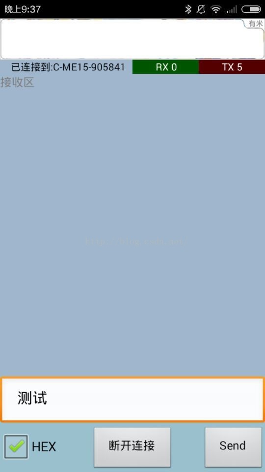

晕哥,你这个操作没看懂啊,这个是怎末连接的的呢,手机蓝牙连接ubuntu蓝牙,然后串口用来调试?另求一个手机的串口助手,我把能找到的蓝牙串口助手都试了一遍,都没法联通开发板上ap6212的蓝牙,但是手机自己的蓝牙倒是可以连上,

偶,这样啊,那就是串口连接蓝牙芯片和电脑,然后手机连接蓝牙收发了是吧,谢啦。不过我现在碰到的问题是没有蓝牙串口助手能连接上:o

不知道晕哥用的手机上的串口助手是什么,我搞到头皮发麻,各种连接,压根连不上

这个最后一张图片不是手机串口助手吗??
#24 2021-05-19 15:54:53
已发帖子: 3,410
积分: 1907
Re: 很早以前的Win7 VMWare Ubuntu12.04LTS/15.10 使用AP6210B蓝牙模块记录(2016-02-18)
不太记得了,我想了一下,这个应该是在Ubuntu跑了蓝牙转串口的应用程序,图片是手机上面的蓝牙串口app?
