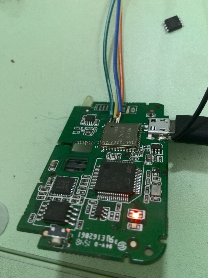

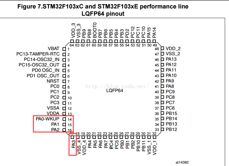

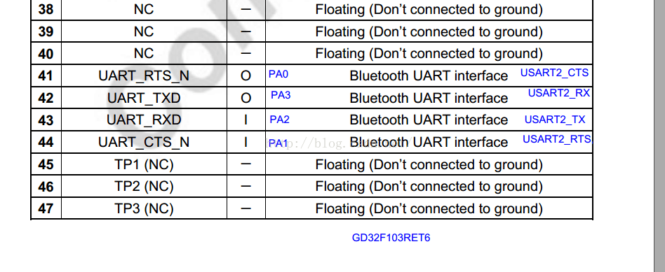

很早以前的Win7 VMWare Ubuntu12.04LTS/15.10 使用AP6210B蓝牙模块记录(2016-02-18)

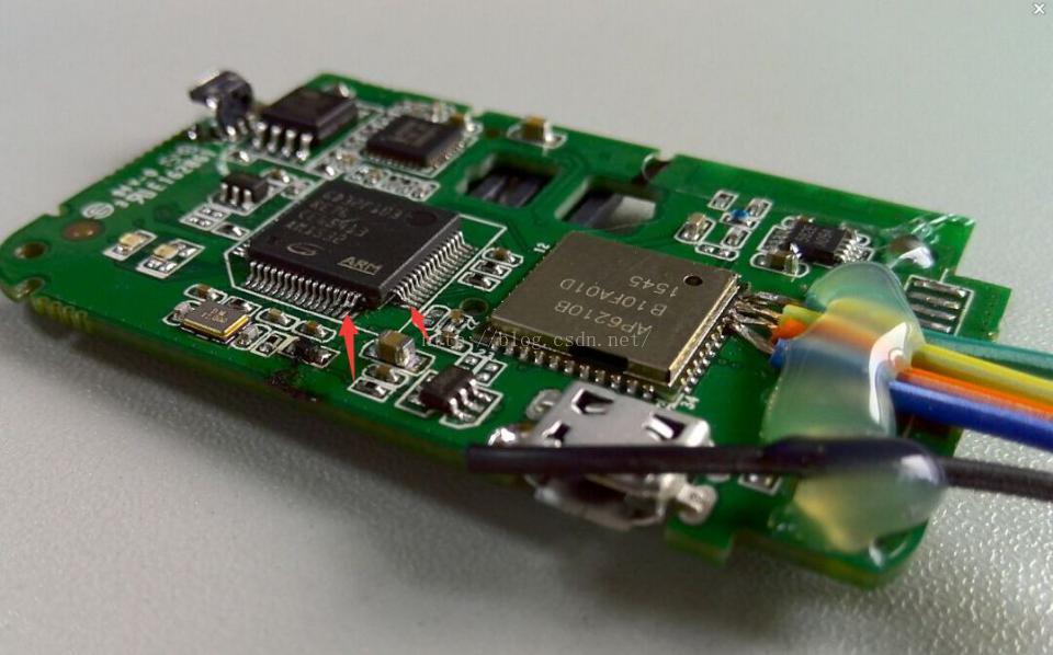

硬件上要把GD32的四个串口引脚断开, 从AP6210B的串口飞线, 接USB的FT232R, 挂载到VMWARE+UBUNTU上

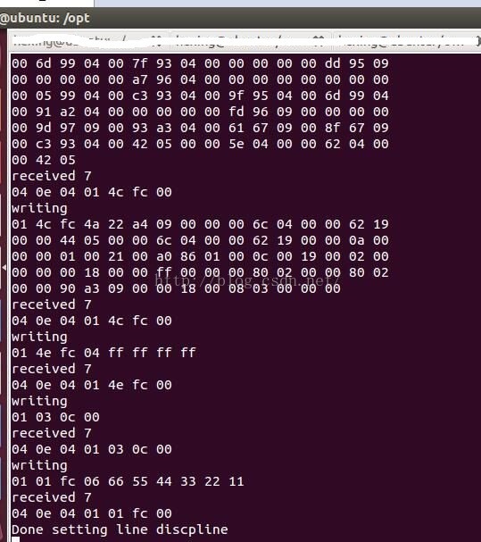

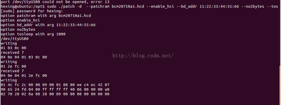

执行Broadcom 蓝牙初始化程序:
http://linux-sunxi.org/Cubietruck/Bluetooth
./brcm_patchram_plus -d  --patchram /lib/firmware/ap6210/bcm20710a1.hcd --enable_hci --bd_addr 11:22:33:44:55:66 --no2bytes --tosleep 1000 /dev/ttyS1
brcm_patchram_plus源码:
http://distro.ibiblio.org/fatdog/source/700/patches/brcm_patchram_plus.c
AP6210B/bcm2076b1.hcd 补丁:
https://github.com/thesawolf/android_device_rockchip_rk3188/tree/master/libs/bluetooth/firmware

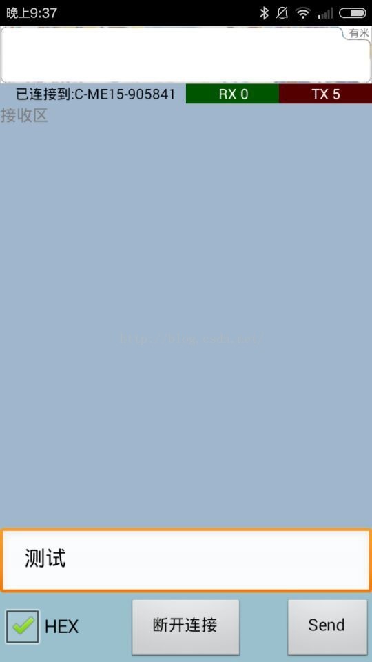

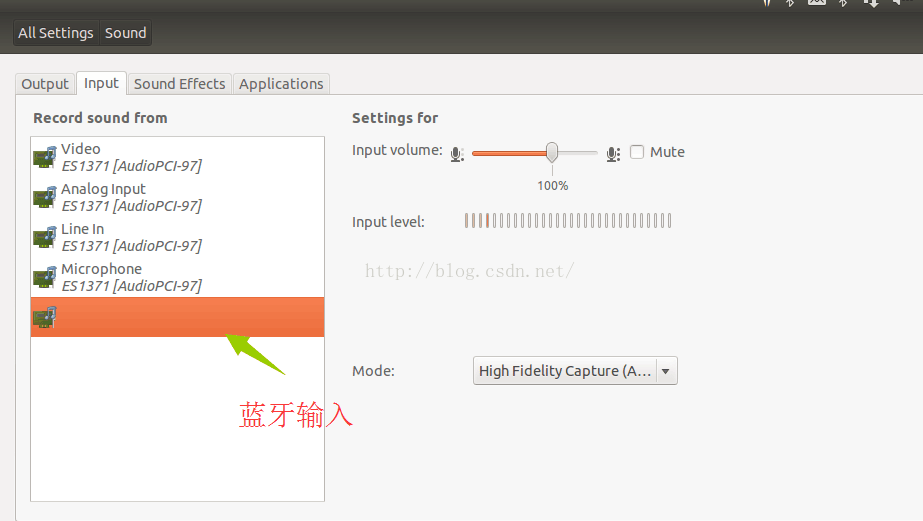

无论做A2DP source还是sink, 声音都卡出翔了, 估计应该是串口的速率没设置好, 博通的蓝牙模组上3Mbps问题不大。

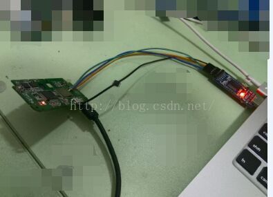

楼主 #5 2018-05-05 08:51:58
已发帖子: 9,445
Re: 很早以前的Win7 VMWare Ubuntu12.04LTS/15.10 使用AP6210B蓝牙模块记录(2016-02-18)

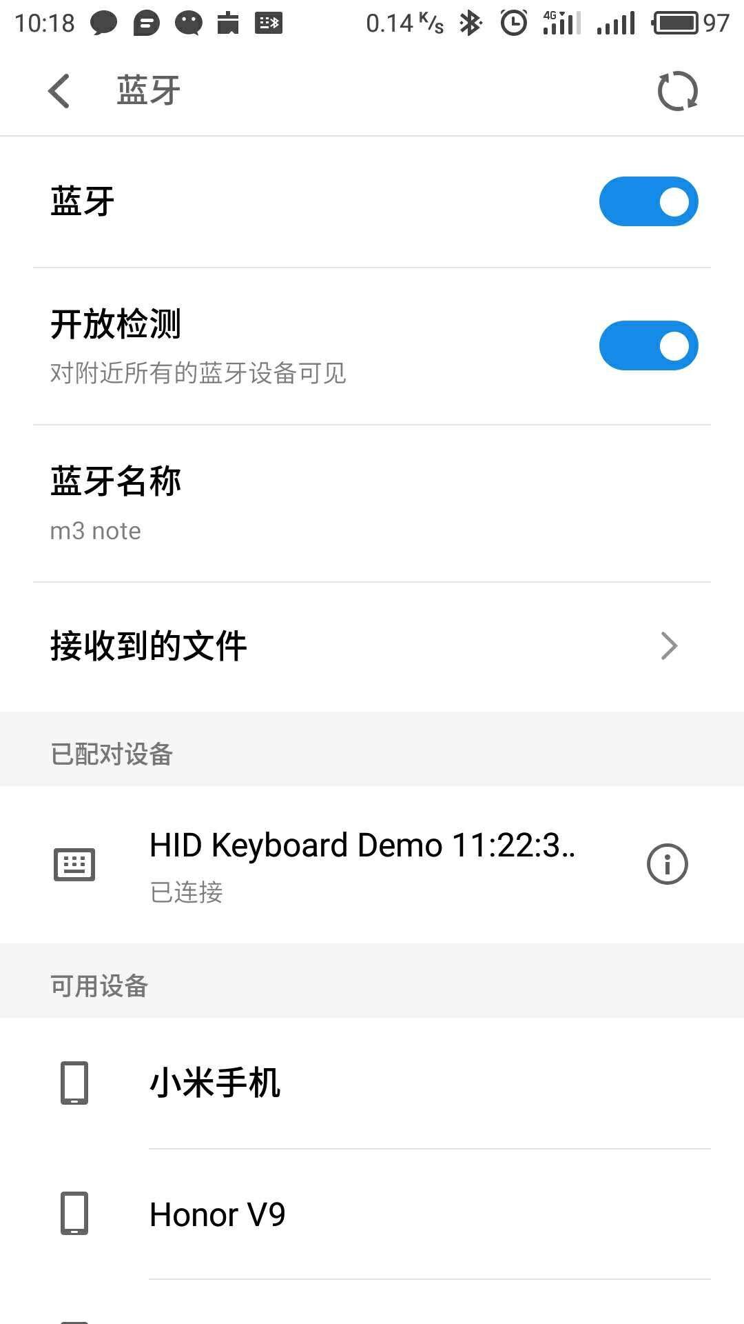

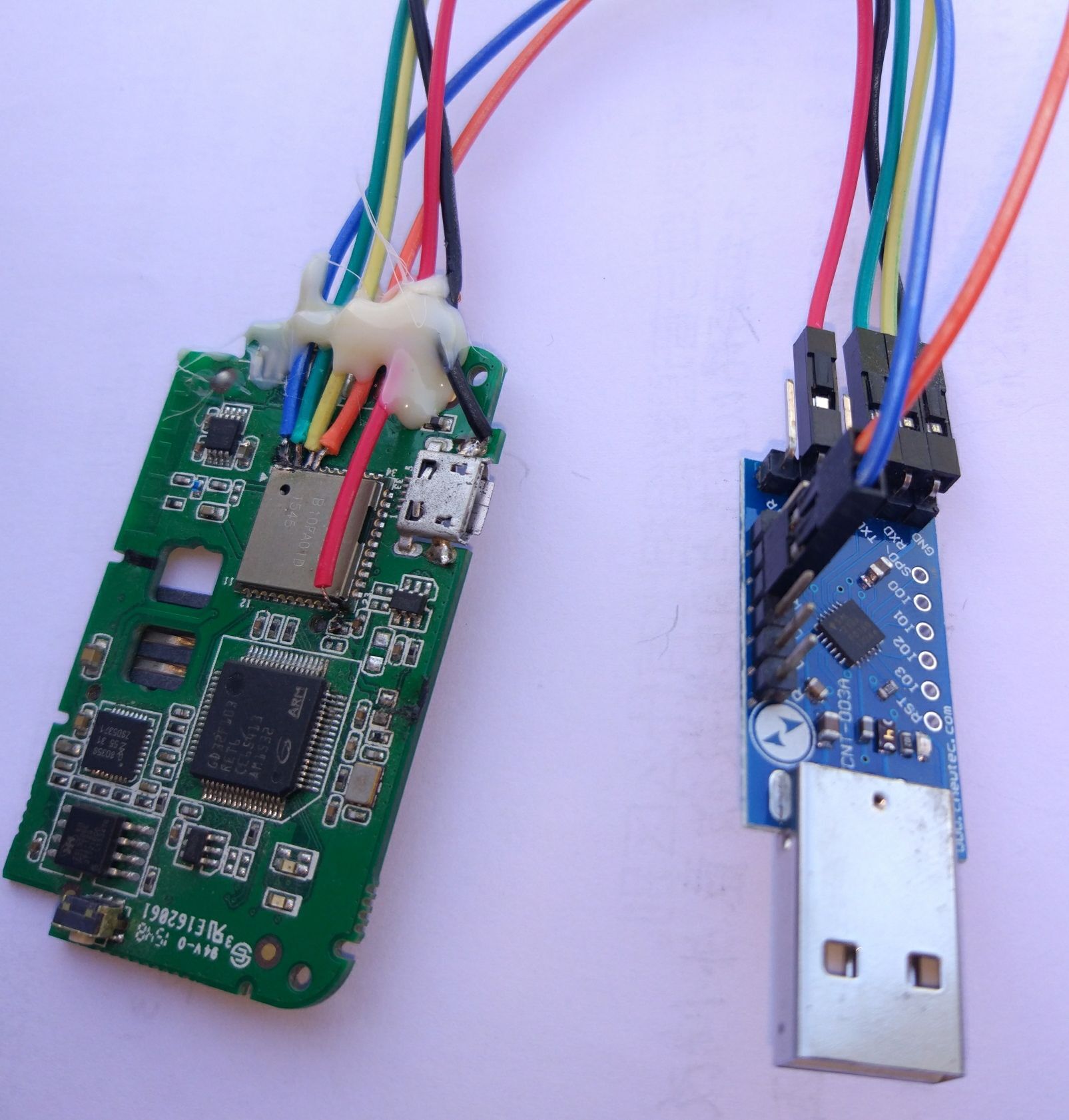

时隔几年从箱底里面拿出来, 接上新买的 cp2104 转换板晒一晒:

运行扫码,仍然很正常:
xxx@ubuntu:/opt/rtl8723bs_bt$ sudo hcitool scan
Scanning ...
    B0:E5:ED:80:XX:F9    Honor V9
    74:23:44:D1:XX:56    小米手机
xxx@ubuntu:/opt/rtl8723bs_bt$ sudo hcitool lescan
LE Scan ...
CE:36:5F:C0:XX:9B (unknown)
B0:E5:ED:4F:XX:0B (unknown)
CE:36:5F:C0:XX:9B MI Band 2

试一试执行初始化程序:
sudo ./brcm_patchram_plus -d  --patchram bcm20710a1.hcd --bd_addr 11:22:33:44:55:66 --no2bytes --tosleep 1000 /dev/ttyUSB1
xxx@ubuntu:/opt/rtl8723bs_bt$ sudo ./brcm_patchram_plus -d  --patchram bcm20710a1.hcd --bd_addr 11:22:33:44:55:66 --no2bytes --tosleep 1000 /dev/ttyUSB1
writing
01 03 0c 00
received 7
04 0e 04 01 03 0c 00
writing
01 2e fc 00
received 7
04 0e 04 01 2e fc 00
writing
01 4c fc 2c 00 00 09 00 01 08 00 ee c4 ec 42 07
90 65 24 fd 04 00 ff ff ff ff 40 06 00 00 00 a0
02 70 20 02 0a 00 28 00 09 00 00 00 00 00 00 00
received 7
04 0e 04 01 4c fc 00
writing
01 4c fc ff 28 00 09 00 41 29 00 42 43 4d 32 30
37 30 32 41 31 20 47 65 6e 65 72 69 63 20 55 41
52 54 20 43 6c 61 73 73 20 31 20 40 20 32 36 20
4d 48 7a 00 69 02 00 00 00 5d 0c 00 0a 64 e6 b0
00 00 88 98 42 5a 33 43 5f 09 00 3c 28 01 00 04
00 04 f7 0c 0a 6f 00 98 16 08 00 c6 00 f3 02 5d
00 66 03 30 00 c9 00 e1 02 68 00 5c 03 36 00 c3
00 e2 02 6a 00 53 03 3c 00 c2 00 e1 02 6c 00 4e
03 41 00 c5 00 d6 02 72 00 4a 03 43 00 c3 00 ce
02 79 00 42 03 48 00 c5 00 c0 02 83 00 3a 03 4e
00 c8 00 bf 02 82 00 3b 03 4e 00 c9 00 bc 02 84
00 37 03 52 00 08 08 07 07 07 07 07 07 06 06 06
06 05 05 05 05 02 c0 68 01 94 fc 0e 00 ff ff 00
00 66 02 00 00 30 fc 0e 00 ff ff 0f 00 63 04 00
00 00 fd 0e 00 ff ff 0f 00 68 02 00 00 88 fc 0e
00 ff ff 00 00 00 04 00 00 2c fc 0e 00 ff ff 00
00 49 04
received 7
writing
01 4c fc ff 23 01 09 00 00 00 70 fc 0e 00 ff ff
00 00 0b 09 00 00 74 fc 0e 00 ff ff 00 00 2e 01
00 00 d8 ff 0e 00 ff ff 00 00 62 19 00 00 d0 fc
0e 00 ff ff 00 00 20 c9 00 00 c8 fc 0e 00 ff ff
00 00 38 85 00 00 dc fc 0e 00 ff ff 00 00 1c c8
00 00 cc fd 0e 00 ff ff 00 00 04 80 00 00 5c fc
0e 00 ff ff 00 00 02 00 00 00 20 fc 0e 00 ff ff
00 00 19 21 00 00 e0 fc 0e 00 00 80 00 00 00 00
00 00 c0 fc 0e 00 ff ff 00 00 22 00 00 00 94 8f
08 00 ff ff ff ff 00 12 00 12 98 8f 08 00 ff ff
00 00 00 12 00 00 9c 8f 08 00 00 ff ff ff 00 09
09 09 cc fc 0e 00 ff ff 00 00 2b 45 00 00 78 00
0f 00 ff ff ff ff 0d 08 09 09 68 00 0f 00 ff 00
ff ff 0d 00 0d 0d 6c 00 0f 00 ff 00 ff ff 0d 00
0d 0d 90 00 0f 00 00 00 00 ff 00 00 00 80 0c 01
0f 00 00 00 ff ff 00 00 08 08 88 00 0f 00 f0 00
00 00 80
received 7
writing
01 4c fc ff 1e 02 09 00 00 00 00 2c 01 0f 00 ff
00 00 00 07 00 00 00 24 01 0f 00 00 00 00 ff 00
00 00 05 30 01 0f 00 00 ff 00 00 00 08 00 00 20
01 0f 00 00 00 00 ff 00 00 00 06 d0 7b 00 01 04
0a 08 fc 0e 00 ff ff 00 00 2e 36 00 00 0c fc 0e
00 ff ff 00 00 2c ae 00 00 10 fc 0e 00 ff ff 00
00 2a ac 00 00 14 fc 0e 00 ff ff 00 00 a2 22 00
00 18 fc 0e 00 ff ff 00 00 1d 20 00 00 1c fc 0e
00 ff ff 00 00 0d 15 00 00 20 fc 0e 00 ff ff 00
00 85 8d 00 00 24 fc 0e 00 ff ff 00 00 83 11 00
00 28 fc 0e 00 ff ff 00 00 00 01 00 00 98 ff 0e
00 ff ff 00 00 3e 41 00 00 c3 16 00 12 69 14 19
31 08 70 04 78 36 04 24 30 60 71 80 76 4a 31 08
29 0a 6f 21 00 02 30 19 05 cb 00 00 00 ba 14 7f
71 00 a7 00 00 00 92 00 00 00 00 14 00 00 00 00
00 00 00 00 00 00 0a 08 00 f4 0a 08 00 00 01 00
00 58 01
received 7
writing
01 4c fc ff 19 03 09 00 00 1f cf 09 00 10 0f 0c
6e f0 b0 09 f0 60 d1 09 00 01 04 03 03 6b 14 20
20 6b 1a 24 00 ff 01 08 08 0a 13 06 11 02 0f fe
0d fa 0b f6 09 f2 07 ee 05 0a 13 06 11 02 0f fe
0d fa 0b f6 09 f2 07 ee 05 03 01 00 01 82 d6 00
04 06 02 02 0a 23 3c 5a 6e 7d 80 00 80 00 80 00
80 00 80 00 80 00 80 02 80 02 80 02 80 02 80 02
80 02 14 ff 20 88 0a ff 61 00 00 00 00 00 00 00
00 00 00 00 00 00 14 ff 20 82 0a ff 61 00 00 00
00 00 00 00 00 00 00 00 00 00 14 ff 20 00 0a ff
61 00 00 00 00 00 00 00 00 00 00 00 00 00 14 ff
20 08 0a ff 61 00 00 00 00 00 00 00 00 00 00 00

received 7
writing

77 00 23
received 7
writing
01 4c fc ff 3e 7b 09 00 23 60 02 f0 bc fb 01 90
00 99 48 68 40 01 0b d4 b0 68 00 28 05 d0 03 68
23 60 b3 68 1c 60 b4 60 11 e0 b4 60 24 60 0e e0
f0 68 00 28 05 d0 03 68 23 60 f3 68 1c 60 f4 60
01 e0 f4 60 24 60 21 1c 28 1c 90 f7 8c f8 01 23
bb 40 16 49 08 68 18 43 08 60 01 98 02 f0 9b fb
e8 69 00 06 c0 0e 0a 28 03 d1 38 1c 73 f7 a5 ff
09 e0 08 28 07 d1 38 1c 6c f7 58 fe 03 e0 20 1c
99 f7 c3 fc 5a e7 00 20 02 b0 f0 bd c0 46 bc c8
08 00 64 1b 08 00 bf c1 08 00 88 50 08 00 7c 29
08 00 44 a3 09 00 4c a3 09 00 6c cf 05 00 74 29
08 00 70 b5 82 b0 00 23 01 93 5f 49 08 68 20 28
00 d1 b6 e0 10 28 5a d1 5d 49 08 68 77 f7 5f fa
05 1c 5b 4e 30 1c 76 f7 82 ff 00 28 11 d0 04 1c
f8 22 13 58 01 22 13 43 f8 22 13 50 eb 69 c0 69
07 21 0b 40 88 43 18 43 e0 61 28 68 77 f7 98 f9
0c e0 2c
received 7
writing
01 4c fc ff 39 7c 09 00 1c 31 1c 28 1c 28 30 06
22 bc f7 9f fe f8 20 43 59 02 20 83 43 f8 20 43
51 31 1c 20 1c 8c f7 e5 fd 00 28 05 d0 f8 20 03
59 01 20 03 43 f8 20 03 51 20 1c ff f7 56 fc 02
f0 24 fb 01 23 21 68 8b 40 40 4a 11 68 19 43 11
60 02 f0 23 fb 20 68 6c f7 f9 fc e3 69 f8 20 83
43 10 20 03 43 e3 61 20 68 01 21 6c f7 5d fe 20
1c 8f f7 99 fe 20 1c fe f7 c6 fe ff 23 31 48 03
60 59 e0 ff 23 01 33 98 42 4a d1 2e 48 76 f7 29
ff 04 1e 50 d0 77 f7 95 fb e3 69 01 20 00 06 83
43 f8 20 83 43 10 20 03 43 e3 61 e3 6c 5b 00 5b
08 e3 64 ec 21 0b 59 00 06 83 43 0b 51 20 1c 00
21 7b f7 0d fc 20 1c 00 21 7b f7 64 fc 6b 46 01
aa 21 1c 4c 31 20 1c 28 30 96 f7 64 fa 00 28 06
d0 01 9b 00 2b 03 d0 20 1c 7b f7 5c f8 03 e0 21
1c 00 20 78 f7 3e f8 ff 23 12 48 03 60 14 48 03
68 01 2b
received 7
writing
01 4c fc 5c 34 7d 09 00 18 d1 e3 69 1b 04 15 d4
11 48 03 68 00 2b 03 d1 10 48 03 68 0e 48 03 60
8c f7 00 fd 0a e0 40 28 02 d1 8d f7 d8 fc 05 e0
01 23 5b 02 98 42 01 d1 8d f7 69 fc 01 20 02 b0
70 bd c0 46 d4 50 08 00 8c 06 08 00 e8 50 08 00
b4 c4 08 00 88 c8 08 00 88 50 08 00 48 a4 09 00
received 7
writing
01 4c fc ff bc 7d 09 00 9f 48 00 23 03 60 83 60
70 47 70 b5 9d 49 0b 68 18 0a 9d 4a 40 28 03 d1
9c 49 d1 60 9c 49 06 e0 9c 49 01 43 d1 60 03 02
19 18 9b 4b c9 18 9b 4d 29 60 9b 4c 9b 49 63 68
5b 0e 24 68 e4 07 e4 0f 63 40 09 d0 40 28 07 d1
7f 24 64 02 0b 68 96 4d 2b 40 01 25 ed 04 06 e0
fd 24 24 02 0b 68 92 4d 2b 40 03 25 ad 04 0b 60
0b 68 2b 43 0b 60 00 23 8e 4e 33 60 03 04 0b 21
09 04 59 18 21 43 03 26 31 43 8b 4e 31 60 0f 30
10 60 70 bd 10 b5 7c 4a 13 68 00 2b 05 d0 61 21
01 22 0a 54 6e f7 5b ff 05 e0 04 1c 6e f7 b5 fd
20 1c 00 f0 b0 f8 10 bc 08 bc 18 47 10 b5 04 1c
7e 48 41 6a 00 29 02 d1 83 6a 02 2b 09 d9 03 29
04 d1 83 6a ff 20 36 30 83 42 02 d2 20 1c 6e f7
f7 ff 60 23 76 48 19 5d 40 5c 80 21 01 43 75 4a
11 60 6d 48 03 68 74 4a 13 60 43 68 17 20 80 06
03 43 53
received 7
writing
01 4c fc ff b7 7e 09 00 60 ff f7 85 ff a3 7b 70
4a 13 60 00 23 6f 4a 13 60 08 21 13 20 6d f7 67
fe 10 bd 30 b5 04 1c 00 29 27 d1 ff f7 c9 ff 6a
4d 61 34 21 78 69 4a 00 23 d0 56 01 29 07 d1 7d
f7 b5 ff 00 06 01 0c 28 68 65 4a 10 40 06 e0 7d
f7 ad ff 00 06 00 0e 29 68 09 0a 09 02 08 43 28
60 4a 4a 11 68 5f 48 41 43 49 4a 10 68 00 0a 04
30 bd f7 6c f9 5c 4a 10 60 14 e0 02 29 07 d1 01
23 5a 49 0b 60 40 34 60 7f 76 f7 a5 f8 0a e0 05
29 08 d1 00 23 55 49 0b 60 ff f7 6e fc 00 28 01
d1 8c f7 40 ff 30 bc 08 bc 18 47 00 b5 37 4a 01
1c 13 68 00 2b 0d d0 93 68 00 2b 0a d1 93 89 93
60 60 31 0a 78 00 23 02 2a 00 d2 53 1c 0b 70 6e
f7 c8 fe 08 bc 18 47 00 00 2c 49 03 7d 02 2b 07
d1 08 68 43 1e 00 d3 0b 60 88 68 43 1e 00 d3 8b
60 70 47 10 b5 03 7d 09 2b 0c d1 3d 4c 3d 4a 10
68 77 f7
received 7
writing
01 4c fc 70 b2 7f 09 00 00 f9 20 60 60 68 80 21
88 43 60 60 3a 4a d0 78 20 62 10 bc 08 bc 18 47
70 b5 83 b0 00 24 36 4e 4e 25 65 43 ab 19 99 1c
35 48 06 22 02 f0 7d f9 00 28 03 d0 01 34 04 2c
f1 d3 05 e0 a9 19 48 78 00 02 09 78 08 43 00 e0
00 20 01 a9 c8 70 08 21 00 0a 02 aa 10 70 01 23
01 a8 83 70 68 46 83 1d 28 48 03 22 93 f7 0d f8
03 b0 70 bd
received 7
writing
01 4c fc ff 1e 80 09 00 f0 b5 06 1c 0f 1c 05 4c
63 68 ff 2b 45 d1 01 20 76 f7 03 fe 60 60 ff 28
3f d1 00 20 7f e0 4c a4 09 00 94 06 08 00 c8 89
0e 00 40 c0 7d c0 44 7e 00 00 00 d0 7d c0 04 3e
00 00 8c 80 0e 00 40 a5 09 00 b8 8a 0e 00 ff ff
c3 ff 94 83 0e 00 98 83 0e 00 6c 21 08 00 a8 06
08 00 a4 86 0e 00 40 82 0e 00 00 83 0e 00 f8 80
0e 00 04 83 0e 00 92 03 08 00 ff 00 ff ff 71 02
00 00 9c 83 0e 00 f0 fc 0e 00 00 82 0e 00 50 a4
09 00 0b a7 09 00 d3 a5 09 00 b7 c1 08 00 b6 fc
00 00 2a 4d 01 23 eb 74 21 69 28 1c 6e f7 06 fc
27 60 a3 89 a3 60 26 49 79 43 26 48 00 68 00 0a
04 30 bd f7 90 f8 24 49 08 60 24 23 2b 74 02 23
6b 74 31 23 ab 74 28 1c 60 30 00 23 03 70 01 23
43 70 00 23 83 70 c3 70 2b 62 5d 20 02 23 43 55
60 68 77 f7 54 f8 a8 73 01 23 eb 73 18 4f 39 1c
30 1c 8c
received 7
writing
01 4c fc 79 19 81 09 00 f7 a7 fe 60 68 77 f7 49
f8 39 1c 6e f7 4a fa 31 1c 13 48 06 22 bc f7 29
fc 21 69 28 1c 6e f7 db fb 01 20 f0 bd 09 48 03
68 00 2b 00 d0 01 23 00 2b 09 d0 00 7d 00 28 06
d0 07 28 01 d0 00 20 00 e0 01 20 00 28 00 d0 01
20 70 47 64 51 08 00 71 02 00 00 94 06 08 00 9c
83 0e 00 40 a5 09 00 0b a7 09 00 00 b5 f8 21 0b
58 5b 07 02 d4 04 21 80 f7 20 fb 00 bd
received 7
writing
01 4c fc ff 98 81 09 00 30 b5 05 1c 04 1c 08 79
00 02 c9 78 08 43 01 21 76 f7 15 fd 00 28 02 d1
12 23 2b 70 0e e0 08 34 f4 21 09 58 49 07 49 0f
00 d0 01 21 a1 71 5c 30 00 88 e0 71 00 0a 20 72
03 23 eb 70 30 bd 00 00 70 b5 82 b0 05 1c 00 24
20 01 23 18 1b 01 45 48 1e 18 f8 21 88 59 40 07
1a d4 30 68 76 f7 de ff 69 68 88 42 14 d1 30 1c
77 f7 04 f9 00 28 0f d0 3d 4b 69 46 0b 80 02 23
8b 70 5c 23 98 5b c8 70 00 0a 01 a9 08 70 39 4a
69 46 30 1c 81 f7 8a f8 01 34 0b 2c d8 d3 01 23
35 4a 13 76 68 68 72 f7 32 fe 68 68 73 f7 46 fb
68 68 b2 f7 73 f9 69 68 30 48 6e f7 28 fe 69 68
2f 48 6e f7 24 fe 69 68 2e 48 6e f7 20 fe 69 68
2d 48 6e f7 1c fe 6c 68 00 2c 45 d1 0c 23 63 43
2a 48 1d 18 a8 7a 02 28 31 d3 04 28 0e d3 2e d1
28 1c 82 f7 04 ff 06 1c 28 80 00 23 6b 72 e8 79
76 f7 18
received 7
writing
01 4c fc 95 93 82 09 00 ff a0 30 06 81 0c 30 28
e0 28 1c 82 f7 f6 fe 28 80 00 23 6b 72 eb 79 99
00 5b 18 9b 01 1b 49 5e 18 31 1c b8 31 48 71 00
23 0b 71 c4 36 b3 79 00 2b 15 d0 73 79 2b 80 b3
79 6b 80 33 79 6b 72 28 1c 82 f7 db fe 70 71 30
1d 07 e0 00 28 07 d0 28 1c 82 f7 d3 fe 28 80 28
1c 09 30 00 23 03 70 01 34 0e 2c b9 d3 02 b0 70
bd 88 38 08 00 53 0c 00 00 43 72 01 00 cc 2f 08
00 b4 2e 08 00 68 2e 08 00 1c 2e 08 00 d0 37 08
00 40 49 08 00 14 0b 08 00
received 7
writing
01 4c fc ff 7e 83 09 00 f0 b5 05 1c 13 23 5b 04
9f 4f 3b 60 08 21 05 20 6d f7 06 fc 9d 4f 3b 68
9d 48 03 40 3b 60 3b 68 c0 07 03 43 3b 60 8b 4f
3b 68 02 27 3b 43 89 4f 3b 60 97 4c 98 48 20 62
01 23 97 4f 3b 60 97 4f b8 68 60 62 78 68 60 65
a8 69 24 30 c1 78 80 22 0a 43 93 4f 3a 60 93 4e
83 78 b0 7b 00 2b 0e d1 92 4d 00 21 b0 f7 2f f9
b1 69 08 1c 24 30 42 78 13 02 00 7b 18 43 00 22
b0 f7 3c fb 09 e0 01 21 b0 f7 21 f9 8a 4d 8a 4a
13 68 01 20 40 06 03 43 13 60 88 48 05 60 88 48
83 8a 88 48 03 60 00 23 23 60 f0 bd 05 23 83 81
83 69 26 33 18 78 01 28 0f d1 00 21 cb 43 82 49
0b 60 00 23 4b 60 7d 49 0b 68 80 20 03 43 0b 60
7a 49 0b 68 80 04 03 43 0b 60 70 47 00 b5 c3 69
00 2b 23 d0 13 23 5b 04 69 4a 13 60 5f 4a 13 68
5d 4a 13 60 5b 4a 13 68 59 4a 13 60 55 4a 13 68
64 4a 13
received 7
writing
01 4c fc c7 79 84 09 00 60 72 48 72 4a 11 68 41
60 72 4a 11 68 41 61 71 4a 11 68 81 60 71 4a 13
68 03 60 70 4a 13 68 70 4a 13 60 61 48 6e f7 0f
fb 08 bc 18 47 00 00 30 b5 05 23 83 81 6c 4a 11
68 06 22 0a 40 06 2a 02 d1 81 69 2a 31 08 e0 8b
07 02 d4 81 69 2c 31 03 e0 4b 07 04 d4 81 69 2e
31 0b 88 01 33 0b 80 13 23 5b 04 49 49 0b 60 50
49 cb 69 00 2b 12 d1 52 4c 25 68 c3 7b 01 2b 0c
d1 23 68 80 20 83 43 23 60 02 20 99 f7 47 fc 80
23 1d 43 a0 68 99 04 08 43 a0 60 25 60 30 bc 08
bc 18 47 13 23 5b 04 3a 48 03 60 41 48 c3 69 00
2b 02 d1 43 48 03 68 03 60 70 47 00 b5 00 29 01
d1 ff f7 24 ff 08 bc 18 47 00 00
received 7
writing
01 4c fc ff ac 86 09 00 f0 b5 81 b0 05 1c 0c 1c
08 79 00 02 c9 78 08 43 52 d0 00 20 ad f7 98 fb
ff 28 01 d1 09 23 4c e0 07 1c ad f7 52 fb 00 23
03 81 21 79 09 02 e2 78 11 43 81 86 c1 86 05 1c
83 f7 9b f8 2e 1c b0 36 73 88 58 08 e8 80 63 79
25 2b 0e d2 39 48 00 90 05 21 bc f7 63 fc 61 79
c8 08 49 07 49 0f 01 22 8a 40 00 9b 19 5c 11 43
19 54 b0 7b ff 23 3d 33 43 43 31 48 19 18 00 91
28 1c af f7 4e fd 2f 48 85 66 25 21 28 1c fd f7
db ff 30 7b 00 21 af f7 83 ff 05 23 ab 80 38 1c
af f7 ce fd 00 99 9e 31 01 20 08 70 38 1c 00 21
00 f0 35 f8 a2 79 e1 79 38 1c 00 f0 05 f8 01 e0
12 23 2b 70 01 b0 f0 bd f0 b5 0c 1c 17 1c ad f7
00 fb 06 1c 20 1d b4 f7 df fb 05 1e 1e d0 b1 8d
0b 05 1b 0d 01 20 40 03 18 43 21 04 08 43 2b 1c
a9 07 89 0f 01 d1 18 60 06 e0 18 70 00 0a 58 70
00 0a 98
received 7
writing
01 4c fc ff a7 87 09 00 70 00 0a d8 70 3a 06 12
0e 21 04 09 0c 28 1d 91 f7 5b f9 28 1c b2 f7 4a
ff f0 bd 30 b5 0c 1c ff 23 3d 33 43 43 05 48 c5
18 01 f0 74 fd a2 35 2c 80 01 f0 78 fd 30 bd c0
46 f4 4e 08 00 34 9d 08 00 38 b0 08 00 00 b5 c3
7b 01 2b 05 d1 ac 49 0b 78 00 2b 01 d1 01 23 0b
70 b2 f7 59 fa 08 bc 18 47 00 00 00 b5 2c 22 a7
49 a7 48 bc f7 b7 f8 a6 48 a6 4b 18 60 a6 49 41
60 a6 49 81 61 a6 49 c1 61 00 bd 00 b5 01 7d 03
29 01 d0 04 29 02 d1 b2 f7 a2 fa 09 e0 03 7d 06
2b 02 d1 00 f0 08 f8 03 e0 09 2b 01 d1 b2 f7 c8
fa 08 bc 18 47 00 00 70 b5 82 b0 05 1c 04 1c 80
34 e3 7a 00 2b 08 d0 03 6d be 33 19 78 08 20 ae
f7 07 fd 00 23 a3 76 e3 72 63 78 03 2b 28 d0 a8
7b 99 f7 2b f8 40 08 21 8c 43 1a 1e 04 36 0c 61
8c 00 29 1d d0 8e 42 1b d3 60 78 01 28 06 d1 68
8c bc f7
received 7
writing
01 4c fc ff a2 88 09 00 d4 fc 06 28 03 d1 3e 20
02 e0 04 28 03 d0 08 20 2b 6d af 33 18 70 03 23
63 70 28 1c 6e f7 86 f8 2b 6d be 33 19 78 05 20
ae f7 d9 fc 31 e0 60 68 00 28 08 d0 00 90 00 23
01 93 69 46 a8 7b 99 f7 4d f9 00 23 63 60 63 78
03 2b 11 d0 ff 20 19 30 28 5a 86 42 09 d8 a8 7b
85 f7 6d fb 00 28 04 d1 28 1c b2 f7 a7 fd 00 28
02 d0 6d 49 c8 78 0c e0 63 78 00 2b 07 d1 6b 4b
a8 7b 18 5c 03 28 02 d2 68 49 88 78 01 e0 66 49
48 78 a8 74 28 1c b2 f7 83 fc 02 b0 70 bd 70 b5
04 1c 0e 1c 5a 4d 28 78 00 28 02 d0 01 38 28 70
28 78 01 28 04 d8 5e 4a 13 68 5e 49 0b 40 13 60
00 28 16 d0 20 1c 98 30 c3 78 00 2b 02 d1 81 88
ca 06 0e d5 83 79 00 2b 11 d0 31 1c 20 1c b0 f7
d1 f9 2b 78 01 2b 0a d9 31 1c 20 1c b0 f7 9d f9
05 e0 20 1c af f7 62 fe 20 1c b2 f7 0b fc 70 bd
f0 b5 81
received 7
writing
01 4c fc ff 9d 89 09 00 b0 04 1c 05 1c 80 35 00
27 af 81 ef 76 ff 23 05 33 c6 18 f3 7d 01 33 f3
75 c3 7b 01 2b 13 d1 73 78 00 2b 19 d1 44 48 03
68 9b 07 15 d5 a0 7b 98 f7 85 ff 80 08 41 00 a0
69 81 42 0d d0 98 f7 19 ff 40 00 68 60 08 e0 01
23 73 70 36 48 03 78 a3 74 01 23 db 07 b3 61 b7
70 37 48 00 68 00 90 83 07 22 d5 35 49 0b 68 5b
06 02 d4 00 98 43 07 10 d5 a0 7b 98 f7 63 ff 40
08 28 84 6b 78 01 2b 08 d1 02 23 6b 70 23 6d 58
89 00 01 68 84 20 1c b2 f7 aa fa f3 7d 01 2b 07
d1 7d f7 09 fa 01 1c 20 1c ae f7 a0 fc 01 f0 e5
f9 7d f7 01 fa b0 74 00 99 06 22 0a 40 06 2a 1e
d1 23 6d be 33 18 78 85 f7 ed fa 20 1c 00 f0 bf
f8 f0 78 01 28 04 d8 1b 49 80 00 0b 5c 01 33 0b
54 e3 7b 00 99 20 1c 00 2b 02 d1 ff f7 5a ff 01
e0 00 f0 6d f8 20 1c af f7 e3 fd af 72 34 e0 b7
75 8b 07
received 7
writing
01 4c fc c8 98 8a 09 00 2a d5 a8 7a 10 49 0b 78
98 42 25 d2 1e e0 c0 46 fd cc 08 00 78 e4 05 00
80 a5 09 00 78 15 08 00 2b 88 09 00 9b 89 09 00
ed 87 09 00 74 15 08 00 e3 c0 08 00 1c 80 0e 00
ff bf ff ff bc 8b 0e 00 40 15 08 00 ec b0 08 00
1c cd 08 00 e3 7b 00 2b 02 d0 01 30 a8 72 06 e0
2b 7e 00 2b 00 d0 2f 76 20 1c b2 f7 58 fb 01 b0
f0 bc 08 bc 18 47 00 00 f0 b5 06 1e 20 d0 07 68
00 2f 1d d0 40 7c ad f7 2e f9 05 1c 70 7c 18 21
41 43 0c 48 44 18 78 68 90 f7 cd fd 98 f7 4e fd
38 1c 98 f7 05 fd 00 23 33 60 21 7a 01 31 21 72
21 7a 05 48 02 78 a8 8d 90 f7 02 fd 00 23 23 72
f0 bd c0 46 f4 b0 08 00 7c 15 08 00
received 7
writing
01 4c fc ff 64 8b 09 00 70 b5 05 1c 0e 1c 04 1c
80 34 a3 7f 00 2b 1e d0 b0 f7 d3 f8 18 4a 53 7c
01 2b 09 d9 e3 7e 00 2b 02 d1 a0 8b c1 06 03 d5
31 1c 28 1c b0 f7 98 f8 cd 23 58 5d 00 28 0a d0
ff 23 05 33 e8 18 83 7d 00 2b 04 d0 43 78 00 2b
01 d1 01 23 83 70 0b 49 0b 68 1b 07 0f d5 63 78
02 2b 0c d1 ff 20 16 30 28 5c 00 28 07 d0 a0 89
80 04 80 0e 00 23 00 28 00 d1 01 23 23 76 70 bd
ec cc 08 00 e0 2c 08 00 f0 b5 04 1c 05 1c 3a 48
06 68 98 35 a8 88 07 12 f3 06 d9 0f e9 70 73 07
d9 0f 03 07 da 0f 00 2f 04 d0 34 48 03 68 5b 03

option patchram with arg bcm20710a1.hcd
option bd_addr with arg 11:22:33:44:55:66
option no2bytes
option tosleep with arg 1000
/dev/ttyUSB1
和一楼不同了,  去掉了 --enable_hci 这个参数.

看log, 应该初始化成功了。

可以搜索到附近的 蓝牙设备了.
运行一个 键盘demo:

同事的魅族手机能搜到这个鼠标设备了,但是我的MI5搜不到:

我的蓝牙键盘demo也成功啦!!哈哈 跟我的三星C5手机连上了!
但是还是经常会出现多发几次reset命令的情况,我觉得还是跟流控的那两个引脚有关系。。。

晕哥,你这个操作没看懂啊,这个是怎末连接的的呢,手机蓝牙连接ubuntu蓝牙,然后串口用来调试?另求一个手机的串口助手,我把能找到的蓝牙串口助手都试了一遍,都没法联通开发板上ap6212的蓝牙,但是手机自己的蓝牙倒是可以连上,
#18 2021-05-19 14:11:45
已发帖子: 3,394
migu 说:
串口是蓝牙HCI口, 并不是用来调试的, 调试Ubuntu的虚拟控制台。
#19 2021-05-19 14:45:09
migu
注册时间: 2021-05-19
migu 说:
偶,这样啊,那就是串口连接蓝牙芯片和电脑,然后手机连接蓝牙收发了是吧,谢啦。不过我现在碰到的问题是没有蓝牙串口助手能连接上:o
#20 2021-05-19 14:57:02
已发帖子: 3,394
没错就是这么连的,本站右上角搜一下btstack,另外一个轻量级协议栈。
#21 2021-05-19 15:31:59
migu
注册时间: 2021-05-19
不知道晕哥用的手机上的串口助手是什么,我搞到头皮发麻,各种连接,压根连不上
#22 2021-05-19 15:37:59
已发帖子: 3,394
migu 说:
你仔细看帖, 我没有用串口助手噢, 原理貌似通过命令行把串口设备名传递给hci。
#23 2021-05-19 15:46:22
migu
注册时间: 2021-05-19
执行Broadcom 蓝牙初始化程序:
https://whycan.cn/files/members/3/20160218142727628.jpg
https://whycan.cn/files/members/3/20160218142745134.jpg
https://whycan.cn/files/members/3/20160218142913041.jpg
https://whycan.cn/files/members/3/20160218142921614.png
https://whycan.cn/files/members/3/20160218142925541.png
https://whycan.cn/files/members/3/20160218142938287.jpg
https://whycan.cn/files/members/3/20160218142942229.png
https://whycan.cn/files/members/3/20160218142948370.png
https://whycan.cn/files/members/3/20160218142952662.jpg
这个最后一张图片不是手机串口助手吗??
#24 2021-05-19 15:54:53
已发帖子: 3,394
不太记得了,我想了一下,这个应该是在Ubuntu跑了蓝牙转串口的应用程序,图片是手机上面的蓝牙串口app?
