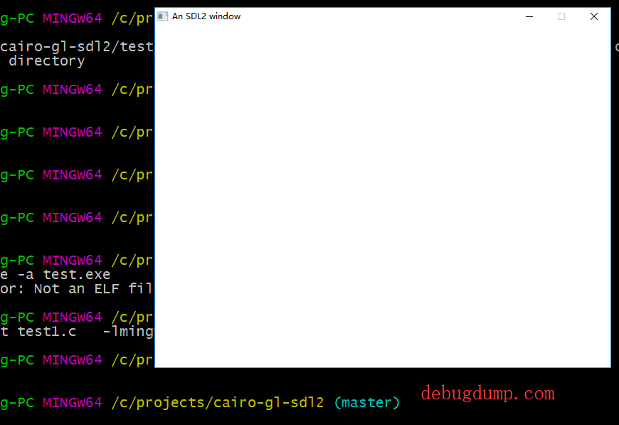

windows mingw 搭建SDL开发环境:
https://whycan.cn/t_687.html#p2375
官方例程:
https://wiki.libsdl.org/SDL_CreateWindow
// Example program:
// Using SDL2 to create an application window
#include "SDL.h"
#include <stdio.h>
int main(int argc, char* argv[]) {
    SDL_Window *window;                    // Declare a pointer
    SDL_Init(SDL_INIT_VIDEO);              // Initialize SDL2
    // Create an application window with the following settings:
    window = SDL_CreateWindow(
        "An SDL2 window",                  // window title
        SDL_WINDOWPOS_UNDEFINED,           // initial x position
        SDL_WINDOWPOS_UNDEFINED,           // initial y position
        640,                               // width, in pixels
        480,                               // height, in pixels
        SDL_WINDOW_OPENGL                  // flags - see below
    // Check that the window was successfully created
    if (window == NULL) {
        // In the case that the window could not be made...
        printf("Could not create window: %s\n", SDL_GetError());
        return 1;
    // The window is open: could enter program loop here (see SDL_PollEvent())
    SDL_Delay(3000);  // Pause execution for 3000 milliseconds, for example
    // Close and destroy the window
    SDL_DestroyWindow(window);
    // Clean up
    SDL_Quit();
运行结果:

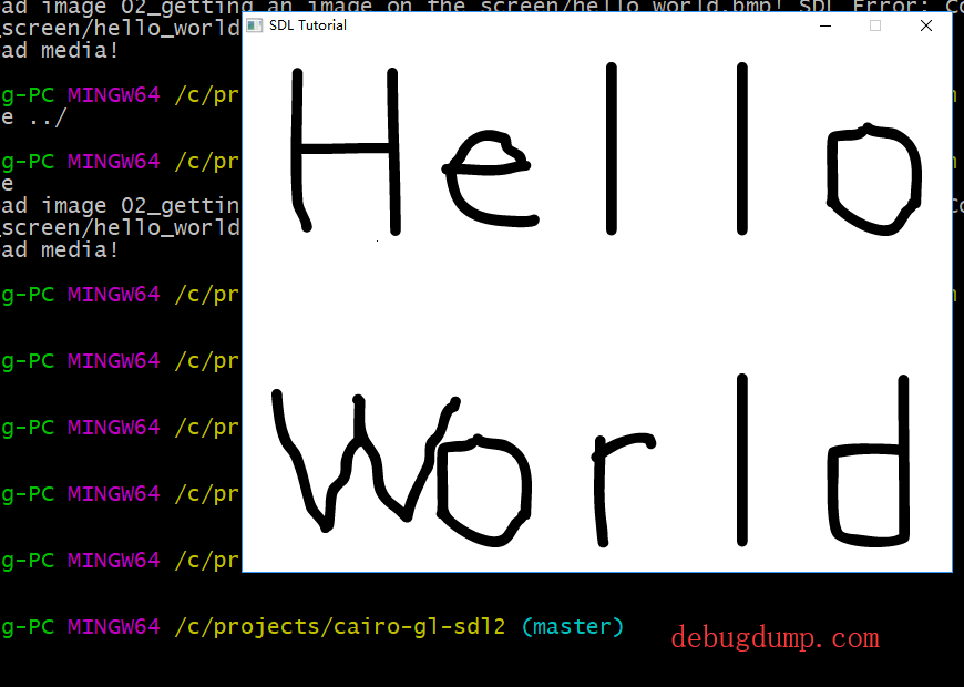

楼主 #3 2018-07-01 07:49:10
已发帖子: 9,520
Re: SDL 基本使用
http://lazyfoo.net/tutorials/SDL/02_getting_an_image_on_the_screen/index.php
/*This source code copyrighted by Lazy Foo' Productions (2004-2015)
and may not be redistributed without written permission.*/
//Using SDL and standard IO
#include <SDL2/SDL.h>
#include <stdio.h>
//Screen dimension constants
const int SCREEN_WIDTH = 640;
const int SCREEN_HEIGHT = 480;
//Starts up SDL and creates window
bool init();
//Loads media
bool loadMedia();
//Frees media and shuts down SDL
void close();
//The window we'll be rendering to
SDL_Window* gWindow = NULL;
//The surface contained by the window
SDL_Surface* gScreenSurface = NULL;
//The image we will load and show on the screen
SDL_Surface* gHelloWorld = NULL;
bool init()
	//Initialization flag
	bool success = true;
	//Initialize SDL
	if( SDL_Init( SDL_INIT_VIDEO ) < 0 )
		printf( "SDL could not initialize! SDL_Error: %s\n", SDL_GetError() );
		success = false;
	else
		//Create window
		gWindow = SDL_CreateWindow( "SDL Tutorial", SDL_WINDOWPOS_UNDEFINED, SDL_WINDOWPOS_UNDEFINED, SCREEN_WIDTH, SCREEN_HEIGHT, SDL_WINDOW_SHOWN );
		if( gWindow == NULL )
			printf( "Window could not be created! SDL_Error: %s\n", SDL_GetError() );
			success = false;
		else
			//Get window surface
			gScreenSurface = SDL_GetWindowSurface( gWindow );
	return success;
bool loadMedia()
	//Loading success flag
	//Load splash image
	gHelloWorld = SDL_LoadBMP( "02_getting_an_image_on_the_screen/hello_world.bmp" );
	if( gHelloWorld == NULL )
		printf( "Unable to load image %s! SDL Error: %s\n", "02_getting_an_image_on_the_screen/hello_world.bmp", SDL_GetError() );
		success = false;
	return success;
void close()
	//Deallocate surface
	SDL_FreeSurface( gHelloWorld );
	gHelloWorld = NULL;
	//Destroy window
	SDL_DestroyWindow( gWindow );
	gWindow = NULL;
	//Quit SDL subsystems
	SDL_Quit();
int main( int argc, char* args[] )
	//Start up SDL and create window
	if( !init() )
		printf( "Failed to initialize!\n" );
	else
		//Load media
		if( !loadMedia() )
			printf( "Failed to load media!\n" );
		else
			//Apply the image
			SDL_BlitSurface( gHelloWorld, NULL, gScreenSurface, NULL );
			//Update the surface
			SDL_UpdateWindowSurface( gWindow );
			//Wait two seconds
			SDL_Delay( 2000 );
	//Free resources and close SDL
	close();

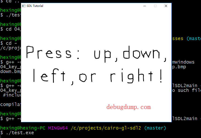

楼主 #5 2018-07-01 08:22:08
已发帖子: 9,520
Re: SDL 基本使用
//Using SDL, standard IO, and strings
#include <stdio.h>
#include <string>
//Key press surfaces constants
enum KeyPressSurfaces
	KEY_PRESS_SURFACE_DEFAULT,
	KEY_PRESS_SURFACE_UP,
	KEY_PRESS_SURFACE_DOWN,
	KEY_PRESS_SURFACE_LEFT,
	KEY_PRESS_SURFACE_RIGHT,
	KEY_PRESS_SURFACE_TOTAL
bool init();
//Loads media
bool loadMedia();
void close();
//Loads individual image
SDL_Surface* loadSurface( std::string path );
//The images that correspond to a keypress
SDL_Surface* gKeyPressSurfaces[ KEY_PRESS_SURFACE_TOTAL ];
//Current displayed image
SDL_Surface* gCurrentSurface = NULL;
bool init()
	//Initialize SDL
		printf( "SDL could not initialize! SDL Error: %s\n", SDL_GetError() );
		success = false;
	else
		//Create window
			printf( "Window could not be created! SDL Error: %s\n", SDL_GetError() );
			success = false;
		else
	return success;
bool loadMedia()
	//Load default surface
	gKeyPressSurfaces[ KEY_PRESS_SURFACE_DEFAULT ] = loadSurface( "04_key_presses/press.bmp" );
	if( gKeyPressSurfaces[ KEY_PRESS_SURFACE_DEFAULT ] == NULL )
		printf( "Failed to load default image!\n" );
		success = false;
	//Load up surface
	gKeyPressSurfaces[ KEY_PRESS_SURFACE_UP ] = loadSurface( "04_key_presses/up.bmp" );
	if( gKeyPressSurfaces[ KEY_PRESS_SURFACE_UP ] == NULL )
		printf( "Failed to load up image!\n" );
		success = false;
	//Load down surface
	gKeyPressSurfaces[ KEY_PRESS_SURFACE_DOWN ] = loadSurface( "04_key_presses/down.bmp" );
	if( gKeyPressSurfaces[ KEY_PRESS_SURFACE_DOWN ] == NULL )
		printf( "Failed to load down image!\n" );
		success = false;
	//Load left surface
	gKeyPressSurfaces[ KEY_PRESS_SURFACE_LEFT ] = loadSurface( "04_key_presses/left.bmp" );
	if( gKeyPressSurfaces[ KEY_PRESS_SURFACE_LEFT ] == NULL )
		printf( "Failed to load left image!\n" );
		success = false;
	//Load right surface
	gKeyPressSurfaces[ KEY_PRESS_SURFACE_RIGHT ] = loadSurface( "04_key_presses/right.bmp" );
	if( gKeyPressSurfaces[ KEY_PRESS_SURFACE_RIGHT ] == NULL )
		printf( "Failed to load right image!\n" );
		success = false;
	return success;
void close()
	//Deallocate surfaces
	for( int i = 0; i < KEY_PRESS_SURFACE_TOTAL; ++i )
		SDL_FreeSurface( gKeyPressSurfaces[ i ] );
		gKeyPressSurfaces[ i ] = NULL;
	//Destroy window
	gWindow = NULL;
	SDL_Quit();
	//Load image at specified path
	SDL_Surface* loadedSurface = SDL_LoadBMP( path.c_str() );
	if( loadedSurface == NULL )
		printf( "Unable to load image %s! SDL Error: %s\n", path.c_str(), SDL_GetError() );
	return loadedSurface;
	if( !init() )
	else
		//Load media
		if( !loadMedia() )
		else
			//Main loop flag
			bool quit = false;
			//Event handler
			SDL_Event e;
			//Set default current surface
			gCurrentSurface = gKeyPressSurfaces[ KEY_PRESS_SURFACE_DEFAULT ];
			//While application is running

http://lazyfoo.net/tutorials/SDL/04_key_presses/index.php
这个demo演示响应 up/down/left/right 按键事件.

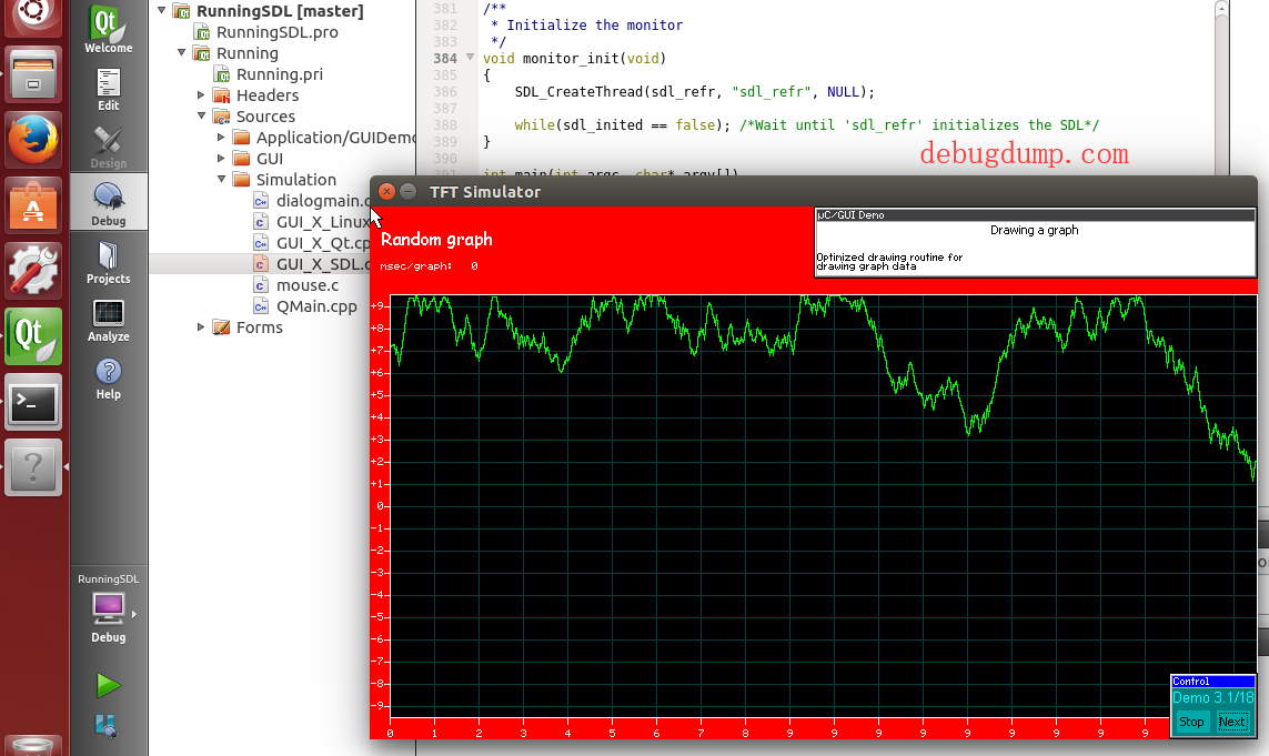

终于把 ucgui 3.98 移植到 SDL 平台上了,感觉颜色有点不对劲, 得再改一改。
