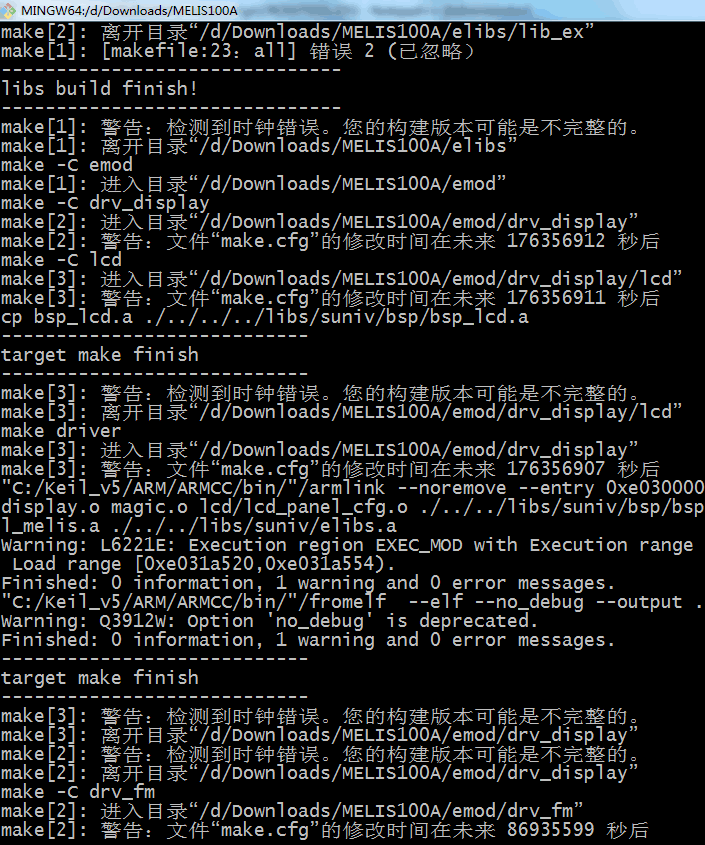

楼主 #4 2018-11-03 14:58:45
Re: 试一试用MDK ARMCC 编译全志官方f1c100s sdk --- melis
正在愉快的编译

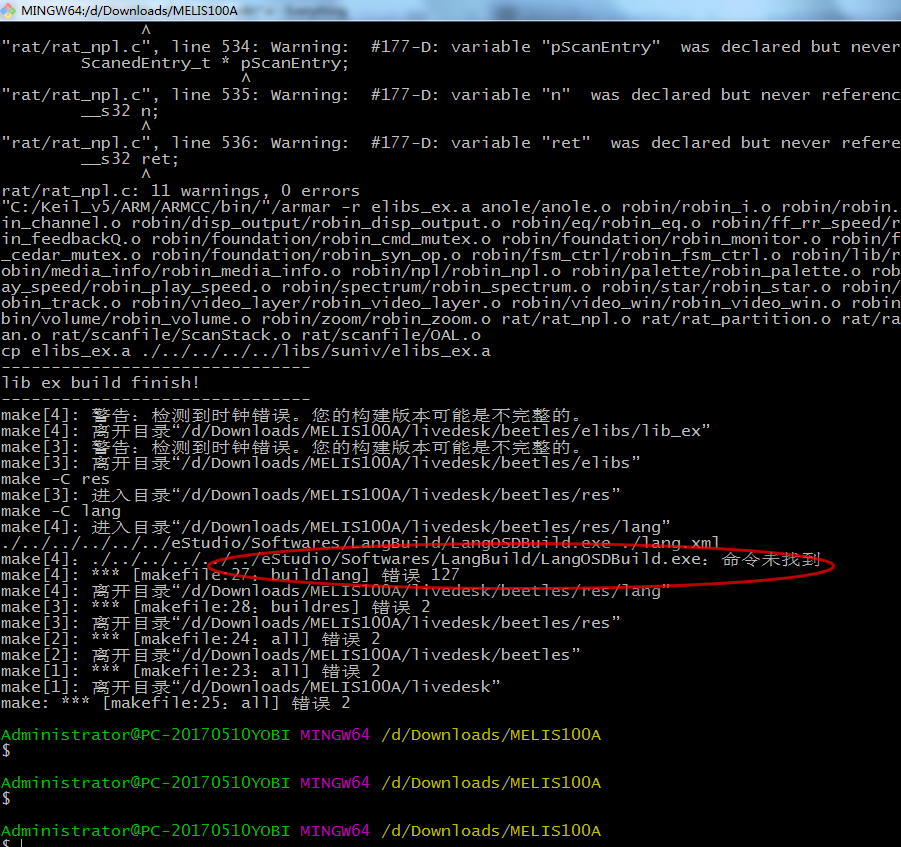

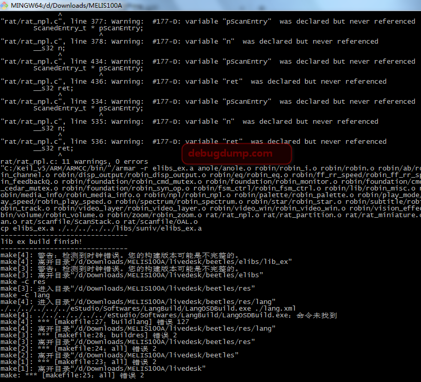

楼主 #5 2018-11-03 15:00:50
"rat/rat_npl.c", line 436: Warning: #177-D: variable "ret" was declared but never referenced
__s32 ret;
"rat/rat_npl.c", line 534: Warning: #177-D: variable "pScanEntry" was declared but never referenced
ScanedEntry_t * pScanEntry;
"rat/rat_npl.c", line 535: Warning: #177-D: variable "n" was declared but never referenced
__s32 n;
"rat/rat_npl.c", line 536: Warning: #177-D: variable "ret" was declared but never referenced
__s32 ret;
rat/rat_npl.c: 11 warnings, 0 errors
"C:/Keil_v5/ARM/ARMCC/bin/"/armar -r elibs_ex.a anole/anole.o robin/robin_i.o robin/robin.o robin/ab/robin_ab.o robin/channel/rob in_channel.o robin/disp_output/robin_disp_output.o robin/eq/robin_eq.o robin/ff_rr_speed/robin_ff_rr_speed.o robin/foundation/rob in_feedbackQ.o robin/foundation/robin_cmd_mutex.o robin/foundation/robin_monitor.o robin/foundation/cmdQ.o robin/foundation/robin _cedar_mutex.o robin/foundation/robin_syn_op.o robin/fsm_ctrl/robin_fsm_ctrl.o robin/lib/robin_misc.o robin/lyric/robin_lyric.o r obin/media_info/robin_media_info.o robin/npl/robin_npl.o robin/palette/robin_palette.o robin/play_mode/robin_play_mode.o robin/pl ay_speed/robin_play_speed.o robin/spectrum/robin_spectrum.o robin/star/robin_star.o robin/subtitle/robin_subtitle.o robin/track/r obin_track.o robin/video_layer/robin_video_layer.o robin/video_win/robin_video_win.o robin/vision_effect/robin_vision_effect.o ro bin/volume/robin_volume.o robin/zoom/robin_zoom.o rat/rat_npl.o rat/rat_partition.o rat/rat_miniature.o rat/rat.o rat/scanfile/Sc an.o rat/scanfile/ScanStack.o rat/scanfile/OAL.o
cp elibs_ex.a ./../../../../libs/suniv/elibs_ex.a
lib ex build finish!
make[4]: 警告:检测到时钟错误。您的构建版本可能是不完整的。
make[4]: 离开目录“/d/Downloads/MELIS100A/livedesk/beetles/elibs/lib_ex”
make[3]: 警告:检测到时钟错误。您的构建版本可能是不完整的。
make[3]: 离开目录“/d/Downloads/MELIS100A/livedesk/beetles/elibs”
make -C res
make[3]: 进入目录“/d/Downloads/MELIS100A/livedesk/beetles/res”
make -C lang
make[4]: 进入目录“/d/Downloads/MELIS100A/livedesk/beetles/res/lang”
./../../../../../eStudio/Softwares/LangBuild/LangOSDBuild.exe ./lang.xml
make[4]:./../../../../../eStudio/Softwares/LangBuild/LangOSDBuild.exe:命令未找到
make[4]: *** [makefile:27:buildlang] 错误 127
make[4]: 离开目录“/d/Downloads/MELIS100A/livedesk/beetles/res/lang”
make[3]: *** [makefile:28:buildres] 错误 2
make[3]: 离开目录“/d/Downloads/MELIS100A/livedesk/beetles/res”
make[2]: *** [makefile:24:all] 错误 2
make[2]: 离开目录“/d/Downloads/MELIS100A/livedesk/beetles”
make[1]: *** [makefile:23:all] 错误 2
make[1]: 离开目录“/d/Downloads/MELIS100A/livedesk”
make: *** [makefile:25:all] 错误 2
编译完成
但是缺少可执行文件,导致打包不能进行。

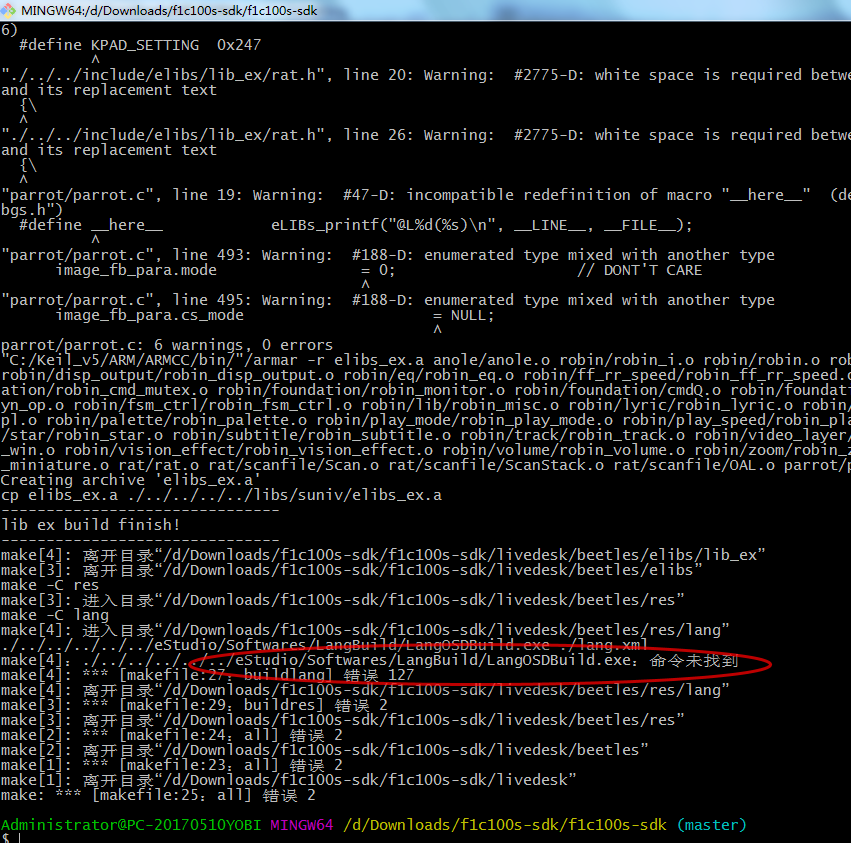

楼主 #6 2018-11-03 16:08:23
弄来的两个SDK都有这个问题。

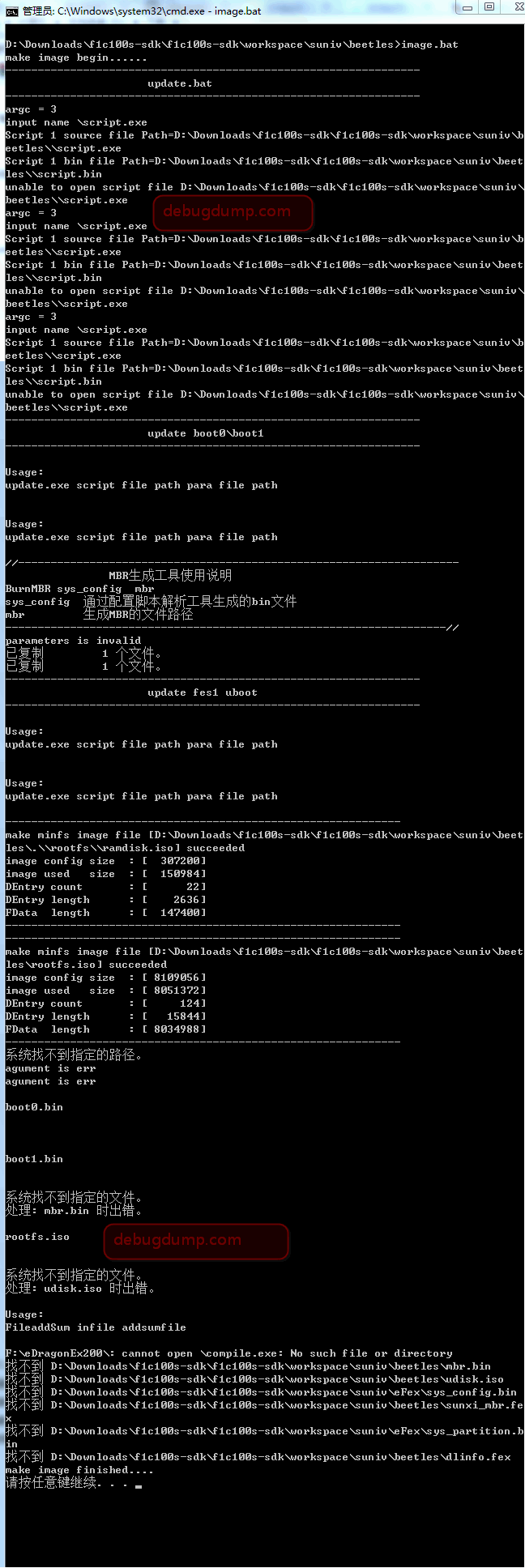

用 MDK 编译 melis SDK倒是没有问题, 打包的时候挂了, 可能缺少 eDragonEx220, 我电脑上只发现 eDragonEx200。
晕哥,是不是可以直接将eDragonEx200 rename成eDragonEx220 ?
楼主 #15 2018-11-05 14:25:42
我就是这么测试的,到最后仍然打包失败。

古城砖头
注册时间: 2019-09-09
/files/members/3/20181103145947.png
编译完成
但是缺少可执行文件,导致打包不能进行。
晕哥,这个编译错误的问题,刚好我前几天在编译一个Melis的例子工程时也碰到" LangOSBuilder.exe:命令未找到"的编译错误,后来发现是 includes/cfgs/CROSSTOOL.CFG文件中的一个定义不对, 将这个文件打开后,把其中的ESUDIOROOT = $(SDKROOT)/../eStudio修改为ESUDIOROOT = $(SDKROOT)/eStudio即可,这个编译错误就没了。
再一个,请问下,本帖子中你编译的这个 MELIS100A.7z从哪里下载呢?

我几乎完成了此操作,但我陷入了这个错误。
有人知道吗?
I have almost done it, but i am stuck on this error.
is there anybody know?
make image begin...
argc = 2
input name ..\eFex\sys_config.fex
Script 1 source file Path=F:\melis\melis2\workspace\suniv\phoenix\..\eFex\sys_config.fex
Script 1 bin file Path=F:\melis\melis2\workspace\suniv\phoenix\..\eFex\sys_config.bin
parser 1 file ok
        1 file(s) copied.
        1 file(s) copied.
argc = 2
input name part_config.fex
Script 1 source file Path=F:\melis\melis2\workspace\suniv\phoenix\part_config.fex
Script 1 bin file Path=F:\melis\melis2\workspace\suniv\phoenix\part_config.bin
parser 1 file ok
..\..\..\..\eStudio\Softwares\eDragonEx200\compile: image.cfg:1: unexpected symbol near ';'
make image finished...
Press any key to continue . . .
#87 2019-12-14 06:18:09
Ken
注册时间: 2019-01-06
已发帖子: 59
积分: 54
@Biftor, that's it. Although there is the error of "unexpected symbol near ';'", the image file (ePDKv100.img) should has already been created under the folder of "Melis100A\workspace\suniv\beetles".

make image begin......
.\..\eFex\sys_version.fex
.\..\eFex\sys_config.fex
已复制         1 个文件。
已复制         1 个文件。
                      update.bat
argc = 2
input name .\..\eFex\sys_config.fex
Script 1 source file Path=J:\wsl\f1c100s\melis\MELIS100A\workspace\suniv\beetles\.\..\eFex\sys_config.fex
Script 1 bin file Path=J:\wsl\f1c100s\melis\MELIS100A\workspace\suniv\beetles\.\..\eFex\sys_config.bin
parser 1 file ok
argc = 2
input name .\..\eFex\sys_partition.fex
Script 1 source file Path=J:\wsl\f1c100s\melis\MELIS100A\workspace\suniv\beetles\.\..\eFex\sys_partition.fex
Script 1 bin file Path=J:\wsl\f1c100s\melis\MELIS100A\workspace\suniv\beetles\.\..\eFex\sys_partition.bin
parser 1 file ok
argc = 2
input name .\rootfs\app_config.fex
Script 1 source file Path=J:\wsl\f1c100s\melis\MELIS100A\workspace\suniv\beetles\.\rootfs\app_config.fex
Script 1 bin file Path=J:\wsl\f1c100s\melis\MELIS100A\workspace\suniv\beetles\.\rootfs\app_config.bin
parser 1 file ok
                      update boot0\boot1
已复制         1 个文件。
已复制         1 个文件。
                      update fes1 uboot
make minfs image file [J:\wsl\f1c100s\melis\MELIS100A\workspace\suniv\beetles\.\\rootfs\\ramdisk.iso] succeeded
image config size  : [  131072]
image used   size  : [  109888]
DEntry count       : [      17]
DEntry length      : [    2176]
FData  length      : [  106816]
make minfs image file [J:\wsl\f1c100s\melis\MELIS100A\workspace\suniv\beetles\rootfs.iso] succeeded
image config size  : [15360000]
image used   size  : [ 3832316]
DEntry count       : [     106]
DEntry length      : [   13720]
FData  length      : [ 3817980]
boot0.bin
boot1.bin
mbr.bin
rootfs.iso
udisk.iso
FileLengthx=15639552
..\..\..\..\eStudio\Softwares\eDragonEx220\compile: image.cfg:1: unexpected symbol near ';'
make image finished....
楼主 #98 2019-12-27 15:26:31
奇怪, @Biftor 怎么生成了 ePDKv100.img 呢 ? 是不是你打开的文件夹不对, 用 everything 搜一下。
#99 2019-12-27 16:30:26
staunchheart
注册时间: 2019-12-17
已发帖子: 232
积分: 190
感谢Wind Rises,搞好了。
没有装MFC库放到windows/system下,一定要放到system下,不是system32
另外,也可以直接拷到eDragonEx220目录下。
MFC库在本站有
/files/members/1377/none_20190225-1007.rar
#100 2019-12-27 17:43:01
已复制         1 个文件。
已复制         1 个文件。
                      update.bat
argc = 2
Script 1 source file Path=G:\MELIS100A\workspace\suniv\beetles\.\..\eFex\sys_config.fex
Script 1 bin file Path=G:\MELIS100A\workspace\suniv\beetles\.\..\eFex\sys_config.bin
parser 1 file ok
argc = 2
Script 1 source file Path=G:\MELIS100A\workspace\suniv\beetles\.\..\eFex\sys_partition.fex
Script 1 bin file Path=G:\MELIS100A\workspace\suniv\beetles\.\..\eFex\sys_partition.bin
parser 1 file ok
argc = 2
Script 1 source file Path=G:\MELIS100A\workspace\suniv\beetles\.\rootfs\app_config.fex
Script 1 bin file Path=G:\MELIS100A\workspace\suniv\beetles\.\rootfs\app_config.bin
parser 1 file ok
                      update boot0\boot1
boot0 file Path=G:\MELIS100A\workspace\suniv\beetles\Boot0.bin
script file Path=G:\MELIS100A\workspace\suniv\beetles\..\eFex\sys_config.bin
script update boot0 ok
boot1 file Path=G:\MELIS100A\workspace\suniv\beetles\Boot1.bin
length = 71168 Error Code = 0, No error
length=71168
boot: = eGON.BT1jn徊   magic = eGON.BT1
boot: = eGON.BT1髿伮   magic = eGON.BT1
mbr count = 4
partitation file Path=G:\MELIS100A\workspace\suniv\beetles\sys_partition.bin
mbr_name file Path=G:\MELIS100A\workspace\suniv\beetles\sunxi_mbr.fex
download_name file Path=G:\MELIS100A\workspace\suniv\beetles\dlinfo.fex
mbr size = 16
mbr magic softw411
main_key->main_name = mbr
main_key->main_name = partition_start
disk name=ROOTFS
disk name=SYSDATAFS
this is not a partition key
update_for_part_info 0
crc 0 = eb4ce7ad
crc 1 = 9958f9ff
crc 2 = f64db09
crc 3 = 7d70c55b
crc32_total= ae8f68d8
update mbr file ok
已复制         1 个文件。
已复制         1 个文件。
                      update fes1 uboot
fes1 file Path=G:\MELIS100A\workspace\suniv\beetles\fes1.fex
script update fes1 ok
uboot file Path=G:\MELIS100A\workspace\suniv\beetles\u-boot.fex
length = 193272 Error Code = 0, No error
length=193272
boot: = uboot   magic = uboot
source length = 193272  align_size = 16384
source_uboot_name=G:\MELIS100A\workspace\suniv\beetles\u-boot.fex total length = 196608
make minfs image file [G:\MELIS100A\workspace\suniv\beetles\.\\rootfs\\ramdisk.iso] succeeded
image config size  : [  106496]
image used   size  : [  102932]
DEntry count       : [      16]
DEntry length      : [    1888]
FData  length      : [  100372]
make minfs image file [G:\MELIS100A\workspace\suniv\beetles\rootfs.iso] succeeded
image config size  : [ 8109056]
image used   size  : [ 3785780]
DEntry length      : [   13528]
FData  length      : [ 3771444]
boot0.bin
boot1.bin
mbr.bin
rootfs.iso
udisk.iso
FileLengthx=8388608
请按任意键继续. . .
我和97楼的朋友出现相同的问题 make没有问题 打包没有生产ePAK100.img文件
请问97楼的朋友搞定这个了么
楼主 #101 2019-12-27 17:52:01
解决方案在99楼

伍零壹
注册时间: 2019-12-16
已发帖子: 161
积分: 39
解决方案在99楼
搞定了 是99的方法 自己挖了个坑

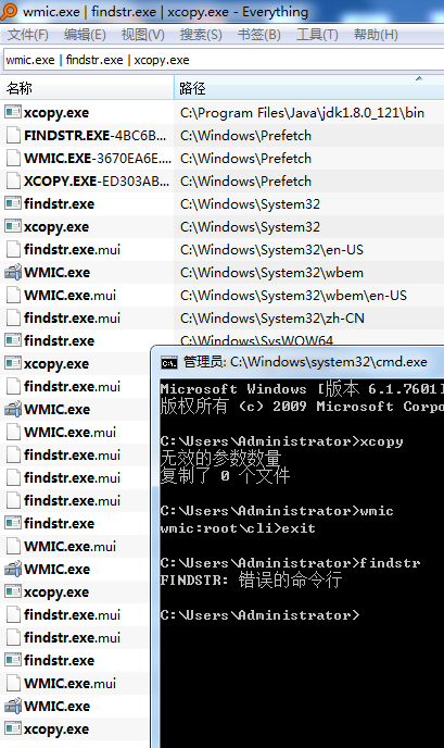

@晕哥 新手一名,安装了cygwin64 编译meils,提示FIND:参数格式错误,求助晕哥
make -C elibs
make[1]: Entering directory `E:/linux/MELIS100A/elibs'
make -C libc
make[2]: Entering directory `E:/linux/MELIS100A/elibs/libc'
make -f makelib
FIND: 参数格式不正确
FIND: 参数格式不正确
FIND: 参数格式不正确
FIND: 参数格式不正确
FIND: 参数格式不正确
FIND: 参数格式不正确
FIND: 参数格式不正确
FIND: 参数格式不正确
make[3]: Entering directory `E:/linux/MELIS100A/elibs/libc'
"D:\Program Files\ARM\RVCT\Programs\4.0\400\win_32-pentium"/armar -r elibs.a  ./
mediainfo/GetAudio_format.a
chmod 777 elibs.a
rm ./../../libs/suniv/elibs.a
cp elibs.a ./../../libs/suniv/elibs.a
chmod 777 ./../../libs/suniv/elibs.a
make -C abilib
FIND: 参数格式不正确
FIND: 参数格式不正确
FIND: 参数格式不正确
FIND: 参数格式不正确
make[4]: Entering directory `E:/linux/MELIS100A/elibs/libc/abilib'
"D:\Program Files\ARM\RVCT\Programs\4.0\400\win_32-pentium"/armar -r aeabi.a
cp aeabi.a ./../../../libs/suniv/aeabi.a
cp: 无法获取'aeabi.a' 的文件状态(stat): No such file or directory
make[4]: *** [all] Error 1
make[4]: Leaving directory `E:/linux/MELIS100A/elibs/libc/abilib'
make[3]: *** [all] Error 2
make[3]: Leaving directory `E:/linux/MELIS100A/elibs/libc'
make[2]: *** [all] Error 2
make[2]: Leaving directory `E:/linux/MELIS100A/elibs/libc'
make[1]: *** [all] Error 2
make[1]: Leaving directory `E:/linux/MELIS100A/elibs'
make: *** [all] Error 2
楼主 #111 2020-02-02 14:49:14
貌似你的 cygwin64 find 命令和批处理里面的命令不兼容,
我的用的是git自带的msys shell和MDK编译的:
https://git-scm.com/download/win
https://download.tortoisegit.org/tgit/2.9.0.0/TortoiseGit-2.9.0.0-32bit.msi
https://download.tortoisegit.org/tgit/2.9.0.0/TortoiseGit-2.9.0.0-64bit.msi
#112 2020-02-02 16:28:56
Sam
注册时间: 2019-12-06
已发帖子: 55
积分: 50
感谢@晕哥,删除了Cygwin 后重新安装了一边,make选择了一下版本,现在可以编译了。编译时间有些长,各种警告,但是没有错误。。。 成功后再总结 tongue

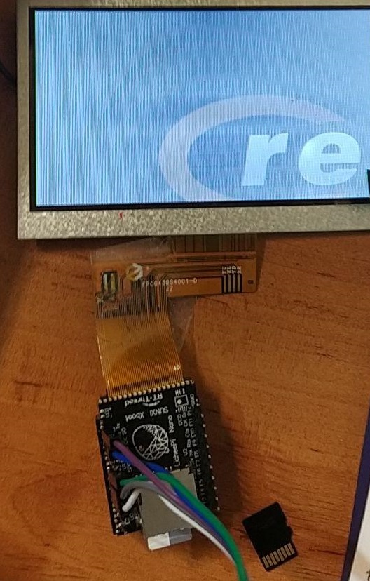

按照晕哥和九霄天外的帖子,用cygwin,mdk 成功编译和打包了。也正常刷入flash了,但启动后lcd没有画面,串口输出如下:
BOOT0 is starting
DBG: init jtag OK
init dram , base is 0x80000000
init dram , clk is 120
init dram , access_mode is 1
init dram , cs_num is 1
init dram , ddr8_remap is 0
init dram , sdr_ddr is 1
init dram , bwidth is 16
init dram , col_width is 10
init dram , row_width is 13
init dram , bank_size is 4
init dram , cas is 3
init dram , size is 0
dram init successed,size is 64
DBG: init heap OK, base address is 0x80000000, size is 0x00100000
DBG: load boot1 from spinor
DBG: init spinor OK
DBG: the size of BOOT1 is 71168
DBG: src_sum = 0x0xc7eb64fd
DBG: sum = 0x0xc7eb64fd
succeed in loading BOOT1
jump to BOOT1
DBG: boot1 starting!
DBG: init heap OK, base address is 0x80800000, size is 0x00100000
begin to init file system
DBG: init block device OK
DBG: init mini file system OK
DBG: mount c partition OK
0
jump to kernal
port=4,port_num=1,mul_sel=6 eint_num=1 trigger=2
然后就没有了。看了下晕哥的贴子里面的信息, jump to kernal后面应该是Mount Parts Thread running.....
用melis包里面的img和sam编译的img,会出现real的画面一段时间后自动黑屏,自己编译的不出现real画面。
对melis包里的文件,不编译只修改sys_config.fex修改串口后,也会出现real画面,串口出来的信息也是一样。
板子不是nano,是F1c500的,没有TF卡,没有按键,有触摸。 原来的固件可以正常启动的。
想请教下晕哥启动出了什么问题?
下载的melis的包里面,好多bmp文件电脑上都打不开,自己编译后没有显示与这个有关吗?
最近编辑记录 xrff_z (2020-03-10 09:22:24)
SDK软硬件有限制的,不是melis的SDK在所有平台上都能跑,应用方向不同,SDK不同;
你用的C100A的SDK,那是100S早期的前身,不带DDR; 所以C500跑不起来是正常的,能跑起来才不正常

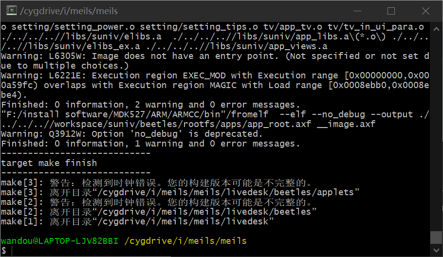

/files/members/3210/QQ%E5%9B%BE%E7%89%8720200409084704.png
晕哥我用MDK5编译了,结果提示可能是不完整的,这个编译结果对吗?
楼主 #121 2020-04-09 09:04:12
看有没有生成img文件,如果有一般就没问题。那个提示是文件时间不对的问题,可能那些lib显示成2024年什么的

请原谅我是小白,原来不是这么操作的,需要打开SDK->workspace->suniv->beetles,点击image.bat,我按照99楼的做了但是出现下面的问题
'wmic' 不是内部或外部命令,也不是可运行的程序
或批处理文件。
'findstr' 不是内部或外部命令,也不是可运行的程序
或批处理文件。
或批处理文件。
或批处理文件。
已复制 1 个文件。
已复制 1 个文件。
update.bat
'xcopy' 不是内部或外部命令,也不是可运行的程序
或批处理文件。
或批处理文件。
argc = 2
Script 1 source file Path=I:\meils\SDK\workspace\suniv\beetles\.\..\eFex\sys_config.fex
Script 1 bin file Path=I:\meils\SDK\workspace\suniv\beetles\.\..\eFex\sys_config.bin
parser 1 file ok
argc = 2
Script 1 source file Path=I:\meils\SDK\workspace\suniv\beetles\.\..\eFex\sys_partition.fex
Script 1 bin file Path=I:\meils\SDK\workspace\suniv\beetles\.\..\eFex\sys_partition.bin
parser 1 file ok
argc = 2
Script 1 source file Path=I:\meils\SDK\workspace\suniv\beetles\.\rootfs\app_config.fex
Script 1 bin file Path=I:\meils\SDK\workspace\suniv\beetles\.\rootfs\app_config.bin
parser 1 file ok
update boot0\boot1
已复制 1 个文件。
已复制 1 个文件。
update fes1 uboot
image file have no free space
load module file [I:\meils\SDK\workspace\suniv\beetles\ramfs\mod\slib.mod] failed
make image failed when file [I:\meils\SDK\workspace\suniv\beetles\ramfs\mod\slib.mod]
process diretory [I:\meils\SDK\workspace\suniv\beetles\ramfs\mod] failed
make image failed when directory [I:\meils\SDK\workspace\suniv\beetles\ramfs\mod]
make minfs image failed
make minfs image [I:\meils\SDK\workspace\suniv\beetles\.\\rootfs\\ramdisk.iso] failed
make minfs image file [I:\meils\SDK\workspace\suniv\beetles\rootfs.iso] succeeded
image used size : [ 3801136]
FData length : [ 3786800]
系统找不到指定的路径。
boot0.bin
boot1.bin
mbr.bin
rootfs.iso
系统找不到指定的文件。
处理: udisk.iso 时出错。
系统找不到指定的路径。
系统找不到指定的路径。
系统找不到指定的路径。
找不到 I:\meils\SDK\workspace\suniv\beetles\udisk.iso
请按任意键继续. . .
#125 2020-04-09 11:58:31
歌以咏志
注册时间: 2019-09-21
已发帖子: 219
积分: 210
提示很明显了啊,wmic,findstr,xcopy这些命令都找不到,I:\meils\SDK\workspace\suniv\beetles\udisk.iso 这个文件也找不到
#126 2020-04-09 12:48:10
mcu1234mcu
注册时间: 2020-02-22
积分: 18
对,这些命令在哪里可以找到呢?:rolleyes
#127 2020-04-09 16:05:54
路人甲
注册时间: 2017-09-07
已发帖子: 202
积分: 199.5
wmic.exe | findstr.exe | xcopy.exe
这些是 Windows 内置命令
#128 2020-04-10 05:54:18
mcu1234mcu
注册时间: 2020-02-22
积分: 18
路人甲 wrote:
/files/members/25/2020-04-09_160441.png
这些是 Windows 内置命令
是的,我发现我的windows下也有这些命令,但是打包的时候还是出现那样的提示,我用的windows10
#129 2020-04-10 08:55:44
xrff_z
注册时间: 2019-10-10
已发帖子: 26
积分: 26
设置下系统path变量 增加C:\Windows\System32 试试
#130 2020-04-10 09:01:16
歌以咏志
注册时间: 2019-09-21
已发帖子: 219
积分: 210
你用 cygwin shell ? 有可能你的 shell有问题,建议用晕哥一楼用的 git 自带的shell
