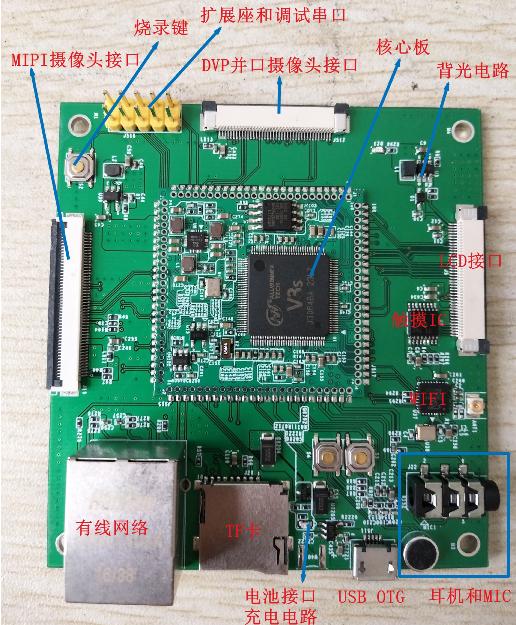

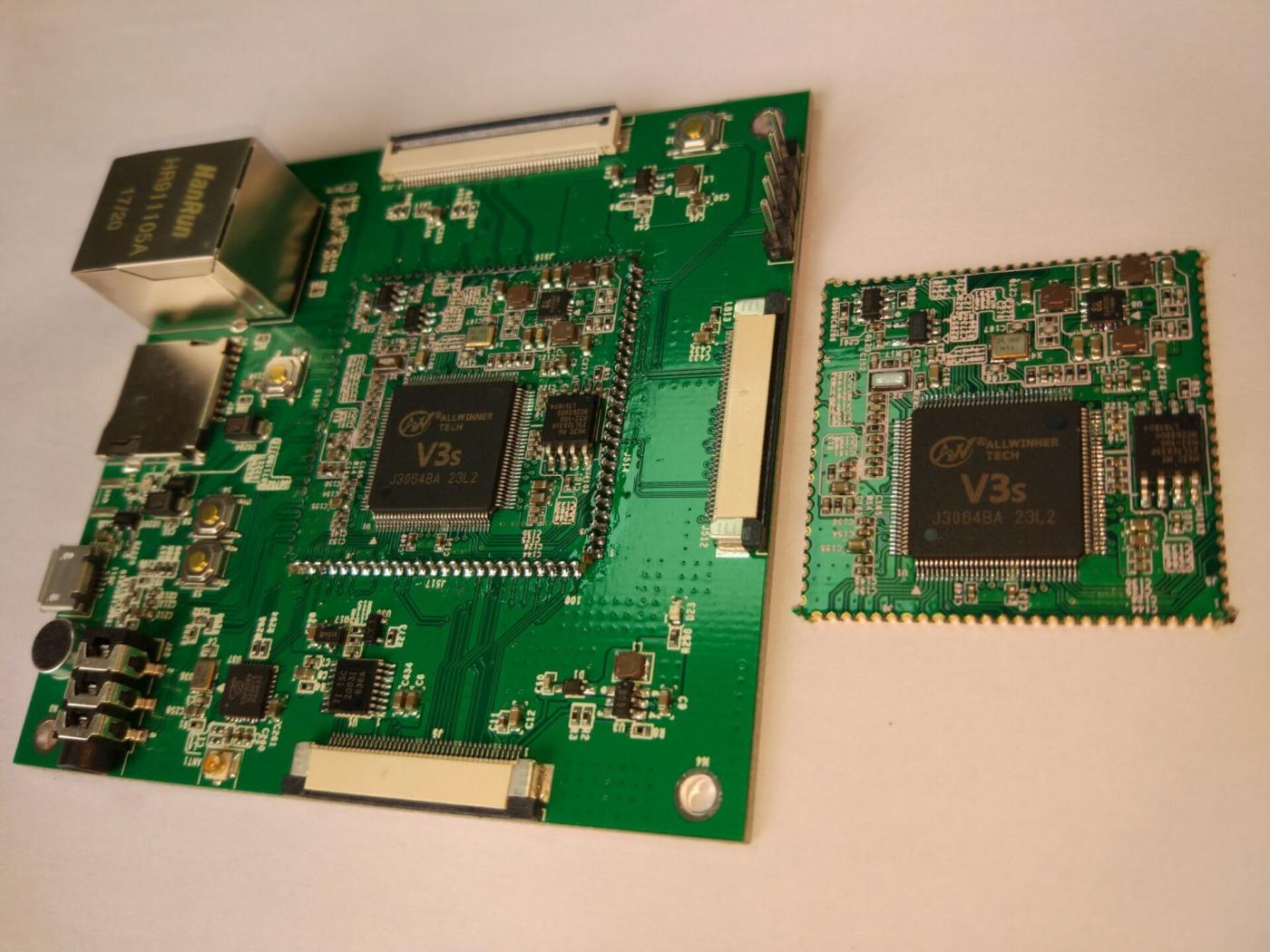

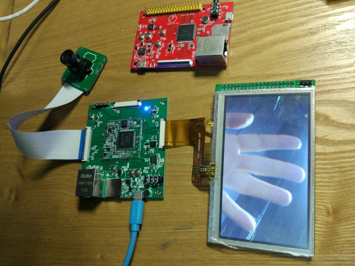

任性买了一片海豚派新的开发板和核心板

/ # ++Camera test[    5.341070] [DISP] ready enter pm_runtime_get_sync, device0
[    5.374221] [VFE]vfe_open
[    5.377144] [VFE]..........................vfe clk open!.......................
[    5.385831] gen_pool_alloc:nbits = 1,size = 3584,order = 12
[    5.392068] chunk->start_addr = 0x42300000,chunk->end_addr = 0x43ffffffchunk->avail = 29356032
[    5.401639] end_bit = 7424
[    5.404779] gen_pool_alloc:nbits = 1,size = 1536,order = 12
[    5.410999] chunk->start_addr = 0x42300000,chunk->end_addr = 0x43ffffffchunk->avail = 29351936
[    5.420568] end_bit = 7424
[    5.423669] gen_pool_alloc:nbits = 3,size = 8448,order = 12
[    5.429865] chunk->start_addr = 0x42300000,chunk->end_addr = 0x43ffffffchunk->avail = 29347840
[    5.439439] end_bit = 7424
[    5.442542] gen_pool_alloc:nbits = 3,size = 8448,order = 12
[    5.448725] chunk->start_addr = 0x42300000,chunk->end_addr = 0x43ffffffchunk->avail = 29335552
[    5.458314] end_bit = 7424
[    5.461410] gen_pool_alloc:nbits = 3,size = 8448,order = 12
[    5.467605] chunk->start_addr = 0x42300000,chunk->end_addr = 0x43ffffffchunk->avail = 29323264
[    5.477184] end_bit = 7424
[    5.480273] gen_pool_alloc:nbits = 3,size = 8448,order = 12
[    5.486456] chunk->start_addr = 0x42300000,chunk->end_addr = 0x43ffffffchunk->avail = 29310976
[    5.496041] end_bit = 7424
[    5.499133] gen_pool_alloc:nbits = 3,size = 8448,order = 12
[    5.505341] chunk->start_addr = 0x42300000,chunk->end_addr = 0x43ffffffchunk->avail = 29298688
[    5.514917] end_bit = 7424
[    5.517999] [VFE]vfe_open ok
[    5.521600] [VFE]Set vfe core clk = 216000000, after Set vfe core clk = 180000000
[    5.542177] vfe_gpio_write:gpio_type = 2,status = 0
[    5.547610] os_gpio_write:set gpio 35 to 0
[    5.552175] os_gpio_write:set gpio 35 to 0
[    5.579967] vfe_gpio_write:gpio_type = 2,status = 1
[    5.585413] os_gpio_write:set gpio 35 to 1
[    5.589954] os_gpio_write:set gpio 35 to 1
[    5.594575] [VFE]mclk on
[    5.621732] [VFE CCI_0 ERR] Status error at addr_8bit = 6c, wr_flag = 1, val = 5c000a30
[    5.636051] [VFE CCI_0 ERR] Status error at addr_8bit = 6c, wr_flag = 1, val = 5c000a30
[    5.645428] [VFE CCI_0 ERR] Status error at addr_8bit = 6c, wr_flag = 1, val = 5c000a30
[    5.654793] [VFE CCI_0 ERR] Status error at addr_8bit = 6c, wr_flag = 1, val = 5c000a30
[    5.663714] [OV2710 Raw]error at sensor_detect
[    5.668641] [OV2710 Raw]chip found is not an target chip.
[    5.674639] [VFE_ERR]sensor initial error when selecting target device!
DP_StartDevice error![    5.682345] [VFE]vfe_close
DPCameraStart error = 1
把买的上一版本的摄像头和屏幕拿出来,仍然挺好用。
晕哥,这个什么时候写个入坑教程呀
楼主 #20 2018-07-22 12:13:46
已发帖子: 9,393
Re: 任性买了一片海豚派新的开发板和核心板
离成功不远了,改天整理一下。
用sunxi-fel 烧录,可以用lcd,摄像头等。
一直错误搜索log,全搜到了晕哥这,关于这个摄像头的问题有解决吗晕哥
