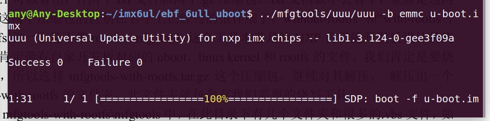

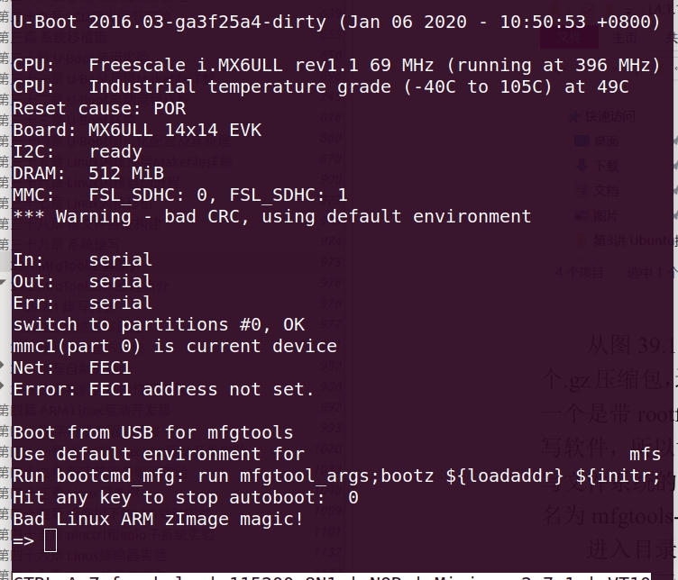

楼主 #10 2020-01-07 15:41:11
已发帖子: 1,436
积分: 1385.5
Re: 请教,安装mfgtools for linux报错。
用uuu命令烧录u-boot到emmc里,结果usb端一直是这个信息:
而串口端是这个:
最近编辑记录 Gentlepig (2020-01-07 15:41:24)

any@Any-Desktop:~/imx6ul/ebf_6ull_buildroot/output/images$ ~/imx6ul/mfgtools/uuu/uuu -b emmc u-boot.imx
uuu (Universal Update Utility) for nxp imx chips -- lib1.3.124-0-gee3f09a
Success 0    Failure 0
1:31     1/ 1 [=================100%=================] SDP: boot -f u-boot.imx
串口有如下提示:
U-Boot 2016.03 (Jan 08 2020 - 16:59:37 +0800)
CPU:   Freescale i.MX6ULL rev1.1 69 MHz (running at 396 MHz)
CPU:   Industrial temperature grade (-40C to 105C) at 46C
Reset cause: POR
Board: MX6ULL 14x14 EVK
I2C:   ready
DRAM:  512 MiB
MMC:   FSL_SDHC: 0, FSL_SDHC: 1
MMC: no card present
*** Warning - MMC init failed, using default environment
In:    serial
Out:   serial
Err:   serial
Net:   FEC1
Error: FEC1 address not set.
Boot from USB for mfgtools
Use default environment for                              mfgtools
Run bootcmd_mfg: run mfgtool_args;bootz ${loadaddr} ${initrd_addr;
Bad Linux ARM zImage magic!
uuu u-boot.imx是烧录到ram里,uuu -b emmc u-boot.imx是烧录到emmc里。
看提示,我烧录到ram里是成功的,但烧录到emmc里,没提示成功,也没提示失败。
