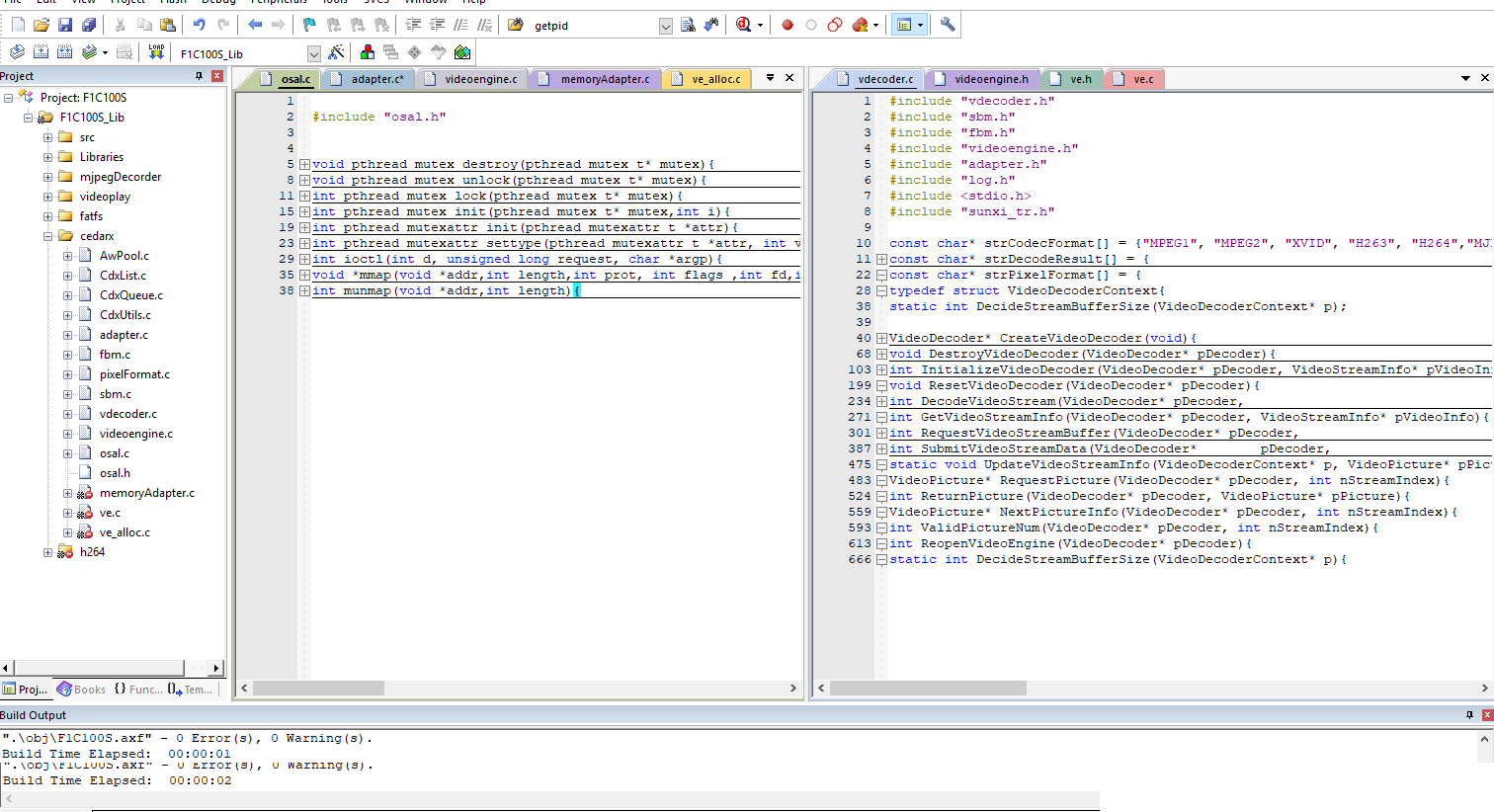

Recently, i have studied closely the feasability of implementing the H264 hardware decoding on bare metal / RTOS for the SUNIV familly (F1C100S). I will try to keep some references here, and start to share ressources.
My understanding of the allwinner driver is as follow.

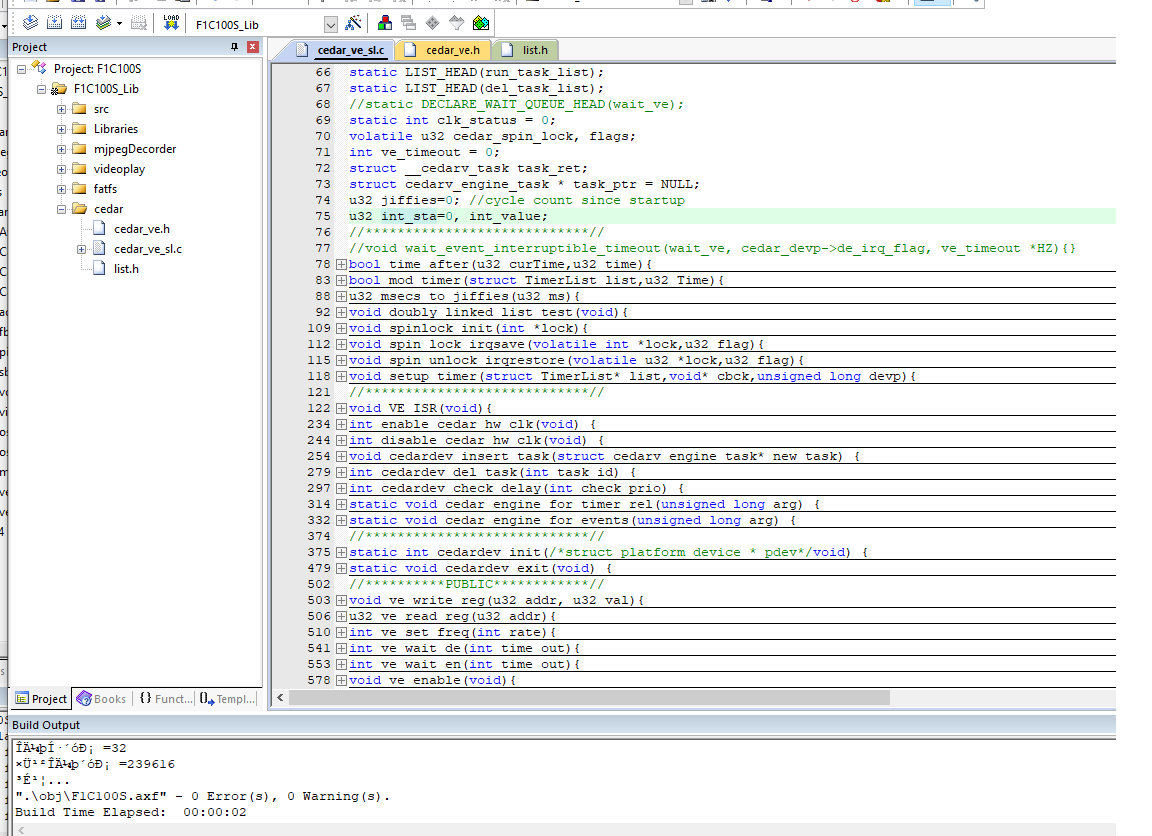

VE
in charge of low level operations. Mainly consists of a state machine driven by the VE engine interrupt, it uses two timers and a tasklist.
I think this core can run bare metal (at least for PoC), there is nothing special about it. To use with RTOS only the mutexes wrapper have to be implemented. I replaced ioctl by direct functions. After few hours i was able to integrate this part into the bare metal MDK project, with few more efforts it should work OK.
This core is 3 files, cedar_ve_sl.c cedar_ve.h and list.h (linux doubly linked list implementation).
i used these source source: https://github.com/mirkerson/c600/tree/master/linux-3.10/drivers/media/cedar-ve
ve.zip
CedarX
in charge of all data handling, composed of various blocks, FB, VB, vdecoder + plugins, OMX.
Naturally this depends on mutexes due to numerous async operation, however, it is probably possible to run it in bare metal with scheduler or other trick.
After wfew hours of work the project compiles without error. Various things had to be modified. RTOS dependencies are wrapped in osal.c.  pixelformat.c has extended inline asm which requires ARMCC 6, so pay attention to the MDK compiler version.
I used these source : https://github.com/allwinner-zh/media-codec/tree/master/sunxi-cedarx/SOURCE
cedarx.zip
A paper from allwinner about the architecture of LibVE and few other documents
https://github.com/linux-sunxi/cedarx-libs/blob/master/doc/Libve%20User%20Guide-2011.7.6.pdf
A non compiled version of CEDAR module of MELIS here:
https://github.com/caochunjie45/test/tree/master/eMod/mod_cedar
Sadly this still relies on other compiled libraries, so it does not contain all the sources required to write the h264 driver, but it is helpful nontheless.
Of course, it would be great if we can find the full sources of an old MELIS, or just the sources of H264 driver (maybe some former Alwinner employee can help to give an old H264 PoC? or an old driver?), anyway we can always try by ourselves, it is always interesting.
I will add the MDK projects after a little bit of cleaning
