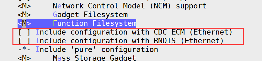

Re: 基于f1c200s运行linux的学习记录.
adb参考
分享个licheepi nano镜像,支持adb调试
https://whycan.com/t_2794.html#p22739
原linux的config文件按帖子配置出错
# install_listener('tcp:5037','*smartsocket*')
[   62.563118] read descriptors
[   62.566072] read strings
[   62.568693] udc-core: couldn't find an available UDC - added [g_ffs] to list of pending drivers
参考链接:https://www.jianshu.com/p/d341022167b4
发现没有musb_hdrc
参考下贴的config(修改后的config文件使用,出现提示类似(N/m/y)时,直接回车用默认的)
终于搞好了荔枝派nano linux uboot瘦身 + usb gadget hid + gt911触控 + littlevgl demo
https://whycan.com/t_2688.html#p21453
对比log
发现启动缺少musb-hdrc.1.auto
修改.config
出错变成
# sh adb.sh
[   17.357434] file system registered
[   21.803710] read descriptors
[   21.806665] read strings
[   21.809611] using random self ethernet address
[   21.814076] using random host ethernet address
[   21.818608] using random self ethernet address
[   21.823135] using random host ethernet address
[   21.828983] usb0: HOST MAC de:ce:81:cb:df:5c
[   21.833560] usb0: MAC 32:c6:c7:a5:db:e1
[   21.837708] g_ffs gadget: g_ffs ready
[   38.085937] g_ffs gadget: high-speed config #1: FunctionFS + RNDIS
电脑识别成com口,继续找原因
https://whycan.com/t_2794.html#p30104
最近编辑记录 nice (2023-02-07 13:13:29)

楼主 #14 2023-02-07 10:53:26
nice
注册时间: 2021-01-02
积分: 45
楼主 #15 2023-02-07 13:12:12
nice
注册时间: 2021-01-02
积分: 45
pcb没有USB id脚,DTS修改
&usb_otg {
    dr_mode = "peripheral"; /* otg host peripheral */
&usbphy {
    //usb0_id_det-gpio = <&pio 4 2 GPIO_ACTIVE_HIGH>; /* PE2 */
测试可用ADB的.config文件
adb_ok_linux.zip
参考链接:ubuntu下配置adb模块进入adb shell
Windows下安装使用ADB,简单易懂教程
最近编辑记录 nice (2023-02-07 14:29:54)
