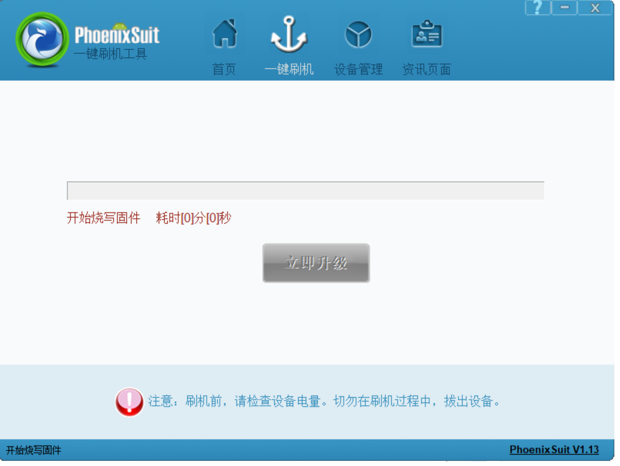

T507烧录问题
遇到T07能进入烧录模式,但进度一直为0。。。
有大佬碰到过没?

使用 PhoenixUSBPro_V_4.1.0    DebugView 查看调试信息,如下:
00000008    20:54:44    [26180] DevicePlugIn: \\?\USB#VID_1F3A&PID_EFE8#6&5e931a0&2&1#{0e57c50f-0ccc-4ad2-a895-93c5ed119860},BOOL to AWUSB:1
00000009    20:54:44    [23240] 2023-04-06 20:54:44,801 [AcPowerNotification][2.00.16][23240]-1F3AEFE8 UsbDeviceAdded
00000010    20:54:44    [26180] ***************************************
00000011    20:54:44    [26180] ********ToolEntry_fel************
00000012    20:54:44    [26180] ***************************************
00000013    20:54:44    [26180] fel: get flag = 0x56!
00000014    20:54:44    [26180] Img_OpenItem now!
00000015    20:54:44    [26180] Img_OpenItem[FES     ][FES_1-0000000000]
00000016    20:54:44    [26180] down file length = 9e80.
00000017    20:54:44    [26180] magic eGON.BT0X*簚? it is fes1
00000018    20:54:44    [26180] down and run fes1 at addr 0x28000
00000019    20:54:44    [26180] Clear dram log OK.
00000020    20:54:44    [26180] DeviceEvent jzr = NULL: wParam=0x7  lParam=0x0
00000021    20:54:45    [26180] DOWN FES1_dram OK
00000022    20:54:45    [23240] 2023-04-06 20:54:45,778 [AcPowerNotification][2.00.16][23240]-04036001 UsbDeviceAdded
00000023    20:54:45    [26180] DevicePlugIn: 2,BOOL to AWUSB:0
00000024    20:54:45    [26180] DeviceEvent jzr = NULL: wParam=0x7  lParam=0x0
00000025    20:54:45    [4644] DBT_DEVICEARRIVAL
00000026    20:54:46    [26180] DeviceEvent jzr = NULL: wParam=0x7  lParam=0x0
到这就不动了。。。

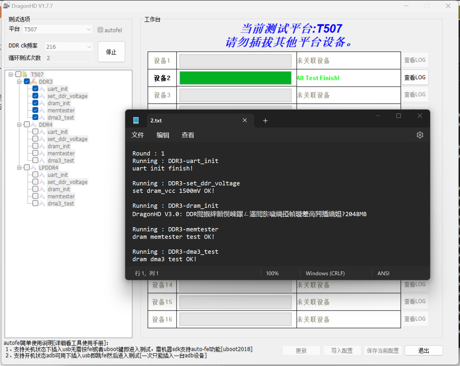

使用DragonHDV1.7.7 能通过测试:
