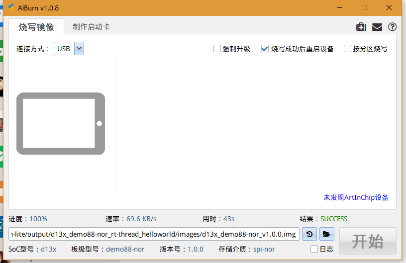

第一块D133CBS 烧录并运行成功
USB烧录貌似时间有点长需要46秒 镜像大小2.90M 明天吧屏幕焊接号应该就能显示了
 Pre-Boot Program ... (2023-11-14 13:46:14)SPINOR
tinySPL [Built on Nov 21 2023 11:14:09]

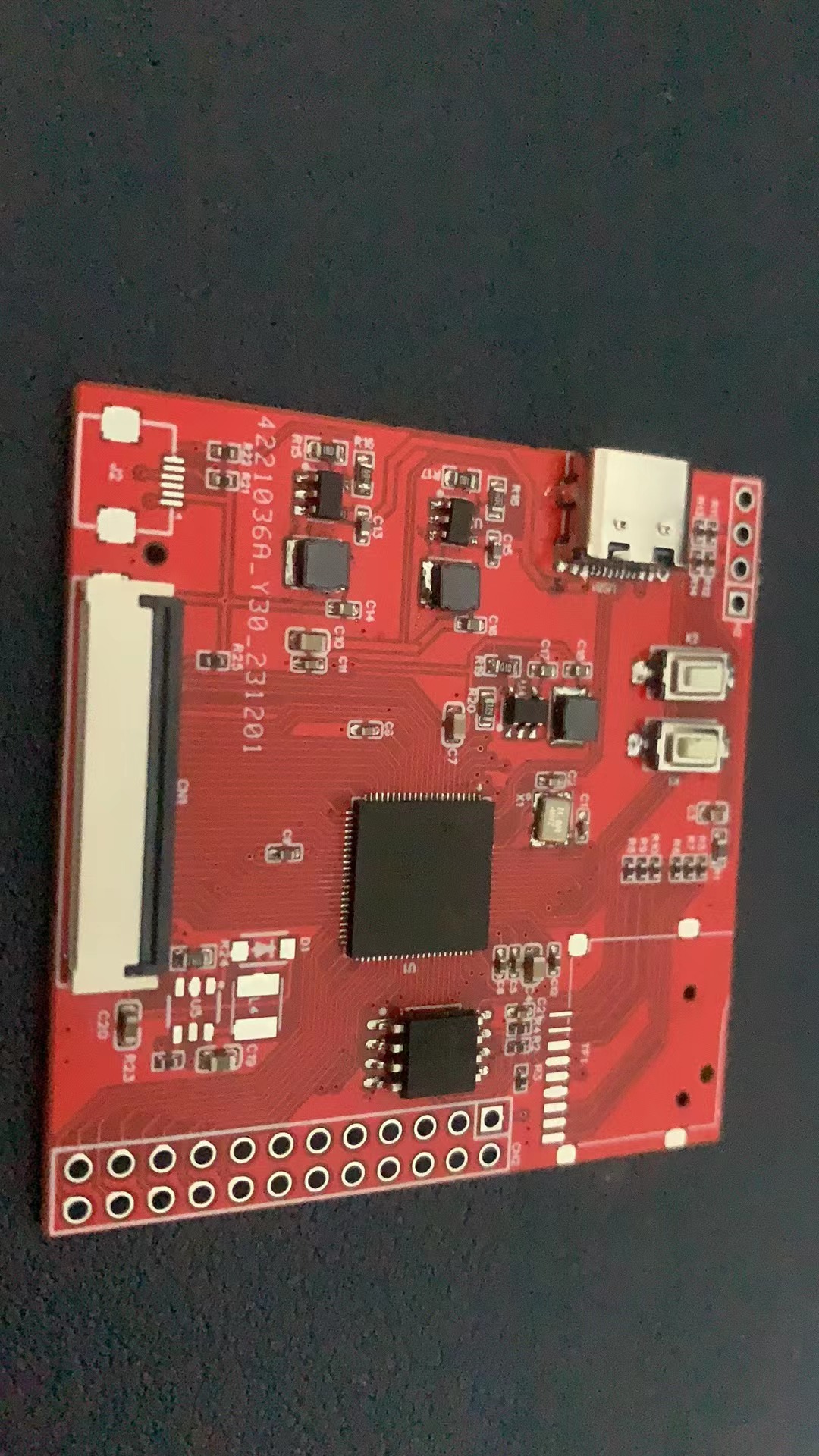

我另外一个 众筹的帖子里面有原理图呢
目前这块板子 缺少电源指示灯 串口丝印忘打了,
烧录官方的sdk 目前rgb 无法显示 触摸好像也成功 ,硬件上来说 我在f1c100s 40pin 和触摸画过三四款板子了,原理图应该问题不大 没有内容显示 暂时还不知道问题在哪

longwu911 wrote:
这个是几层板?
没几个东西 就两层板 5cm*5cm
就三路电源 晶振 40PIN RGB RTP SD卡 外加引出IO

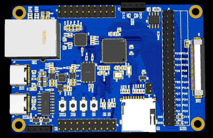

板子接口稍微有点少,我画的板子,基本接口都接出来了。

请教一下,这种屏幕排线怎么焊接的?会把座焊坏吗?
我是嘉立创smt的, 68pin的我开了钢网 买了鹿仙子焊台 准备手帖焊这个应该不在话下
/files/members/739/D133CBS.png
usb 转串口有ch340e 封装小很多

是的,一直用开340C,手头还有一些剩余,就一直用下来了。

大佬开源嘛,想自己折腾个开发板学习学习:D

还没发出去打板,等验证所有功能OK后,可分享出来,

这个芯片不支持电阻屏吧?没看到你板子上放电容触控接口。
下载手册看了下,集成rtp的,PA8-11。

烧录信息如下:
[debug] Software Version: "1.3.6"
[debug] Machine Name: "DESKTOP-HQF1R40"
[debug] System Name: "Windows 10 (10.0)"
[debug] CPU Architecture: "x86_64"
[debug] Parse the image header from "F:/MCU/ArtinChip/luban-lite/output/d13x_demo88-nor_rt-thread_helloworld/images/d13x_demo88-nor_v1.0.0.img"
[debug] Soc type: "d13x"
[debug] Board type: "demo88-nor"
[debug] Image version: "1.0.0"
[debug] Storage type: "spi-nor"
[debug] Storage ID: ""
[debug] Meta count: "5"
[debug] Refresh the partition tree ...
[debug] Part name: image.target.spl , size: 130320
[debug] Part name: image.target.os , size: 698716
[debug] Part name: image.target.rodata , size: 2093056
[debug] Current connect type: 0
[debug] No device available
[debug] WinEvent: Some devnode changed
[debug] There are "1" device available
[debug] Try to connect the ArtInChip device "1:3-1" ...
[debug] Try to get Usb device hd info...
[debug] Get Usb device hd info success
[debug] The status of ArtInChip device: true
[debug] Start burn online ...
[debug] Progress range: 0 ~ 3055616
[debug] Burn Image file "F:/MCU/ArtinChip/luban-lite/output/d13x_demo88-nor_rt-thread_helloworld/images/d13x_demo88-nor_v1.0.0.img" ...
[debug] Meta 0 image.updater.spl , size 130320 ...
[debug] Blocksize 4 , chunk 1048576 * 0 , rest 130320
[debug] Offset: 4608 Size: 130320
[debug] Dev "1:3-1" Send the rest data 130320
[error] aicupg_trans_recv_pkt()208: CSW size 0, Pipe error(-9)
[error] aicupg_cmd_send_fwc_data_final()777: Recv resp failed, expect 16, got 0
[debug] Don't check the result of image.updater.spl
[debug] Meta 1 image.info , size 2048 ...
[error] aicupg_trans_send_pkt()80: CBW tag 0x51, size 0, Pipe error(-9)
[error] aicupg_cmd_get_hwinfo()106: Send command failed. ret = 0, siz = 16
[debug] Wait to reconnect dev "1:3-1"
[debug] QTime("02:21:30.613") Wait for Dev "1:3-1" ready
[warn ] Set upg work mode: 0
[debug] Blocksize 1 , chunk 1048576 * 0 , rest 2048
[debug] Offset: 0 Size: 2048
[debug] Dev "1:3-1" Send the rest data 2048
[debug] Meta 2 image.target.spl , size 130320 ...
[debug] Blocksize 2048 , chunk 1048576 * 0 , rest 130320
[debug] Offset: 135680 Size: 130320
[debug] Meta 3 image.target.os , size 698716 ...
[debug] Blocksize 2048 , chunk 1048576 * 0 , rest 698716
[debug] Offset: 266752 Size: 698716
[debug] Dev "1:3-1" Send the rest data 698716
[debug] Meta 4 image.target.rodata , size 2093056 ...
[debug] Blocksize 2048 , chunk 1048576 * 1 , rest 1044480
[debug] Offset: 967168 Size: 2093056
[debug] Dev "1:3-1" Send chunk 0 ...
[debug] Dev "1:3-1" Send the rest data 1044480
[debug] Burn online successfully!
[debug] Insert statistic of "2024-01-23"
[debug] Reboot the device ...
[error] aicupg_trans_send_pkt()104: CSW tag 0xbe, size 0, Pipe error(-9)
找到第一次烧写的截图了,39s。现在每次烧录都是2s,我怀疑我是不是只有第一次烧录成功了...
后来烧写显示成功了,但是仍执行的第一次烧写的程序...
最近编辑记录 Gentlepig (2024-01-23 11:53:04)
