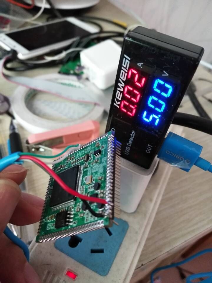

针对Lichee Pi Zero的Debian问题。
我想在Lichee Pi Zero上运行Debian,来源:https://licheepizero.us/ 8. [Downloads]。但是所有图像都会出现以下错误:
U-Boot SPL 2017.01-rc2-00055-gc41fbfe7b5 (Jan 20 2017 - 00:39:08)
DRAM: 0 MiB
ERROR ### Please RESET the board
任何经过测试的SD卡图片?

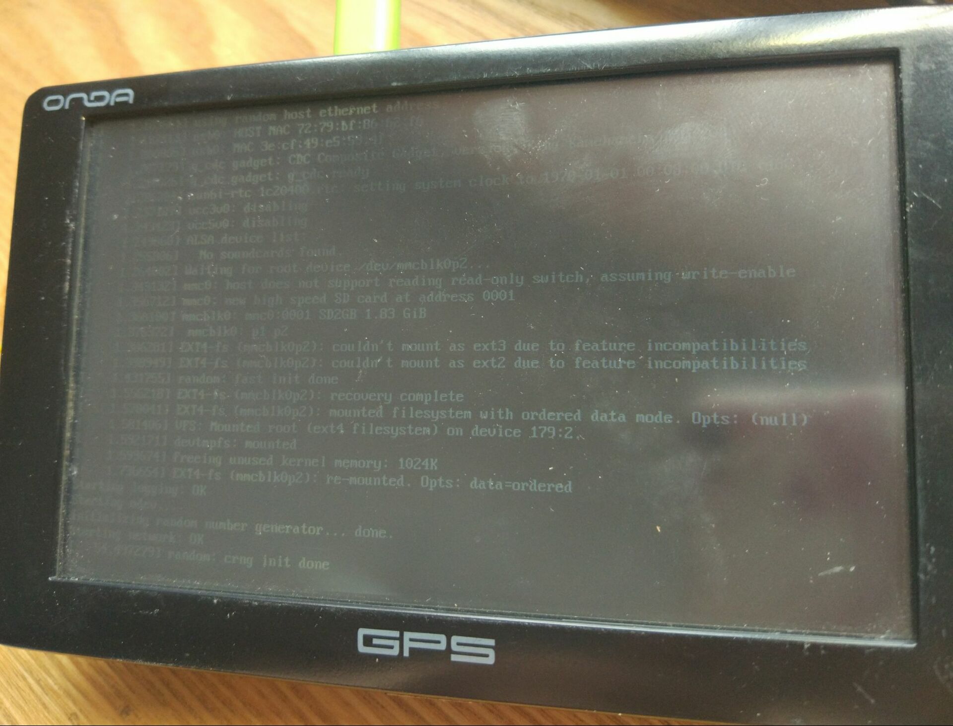

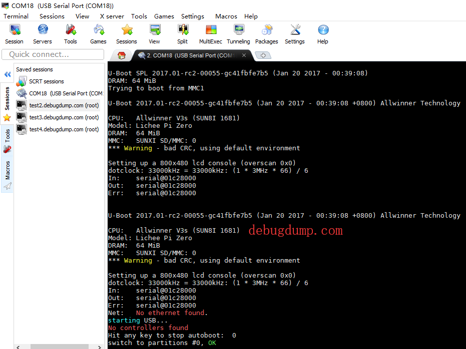

#2 2018-10-02 08:45:13
已发帖子: 9,516
Re: 针对Lichee Pi Zero的Debian问题。
DRAM: 64 MiB
Trying to boot from MMC1
U-Boot 2017.01-rc2-00055-gc41fbfe7b5 (Jan 20 2017 - 00:39:08 +0800) Allwinner Te                                                                             chnology
Model: Lichee Pi Zero
DRAM:  64 MiB
MMC:   SUNXI SD/MMC: 0
In:    serial@01c28000
Out:   serial@01c28000
Err:   serial@01c28000
DRAM:  64 MiB
In:    serial@01c28000
Net:   No ethernet found.
starting USB...
No controllers found
switch to partitions #0, OK
mmc0 is current device
Scanning mmc 0:1...
Found U-Boot script /boot.scr
reading /boot.scr
292 bytes read in 16 ms (17.6 KiB/s)
reading zImage
3987024 bytes read in 655 ms (5.8 MiB/s)
9262 bytes read in 28 ms (322.3 KiB/s)
   Loading Device Tree to 42dfa000, end 42dff42d ... OK
[    0.000000] Linux version 4.10.2-licheepi-zero+ (zp@ubuntu) (gcc version 6.3.1 20170109 (Linaro GCC 6.3-2017.02) ) #15 SMP Sat Apr 15 21:38:23 CST 2017
[    0.000000] OF: fdt:Machine model: Lichee Pi Zero with Dock
[    0.000000] percpu: Embedded 14 pages/cpu @c3dea000 s24652 r8192 d24500 u57344
[    0.000000] Kernel command line: console=ttyS0,115200 panic=5 console=tty0 rootwait root=/dev/mmcblk0p2 earlyprintk rw
[    0.000000] Memory: 53628K/64036K available (6144K kernel code, 213K rwdata, 1472K rodata, 1024K init, 260K bss, 10408K reserved, 0K cma-reserved, 0K highmem)
[    0.000000]       .data : 0xc0a00000 - 0xc0a35600   ( 214 kB)
[    0.000000]        .bss : 0xc0a37000 - 0xc0a781cc   ( 261 kB)
[    0.000000] RCU: Adjusting geometry for rcu_fanout_leaf=32, nr_cpu_ids=1
[    0.000000] arm_arch_timer: Architected cp15 timer(s) running at 24.00MHz (virt).
[    0.000152] clocksource: timer: mask: 0xffffffff max_cycles: 0xffffffff, max_idle_ns: 79635851949 ns
[    0.000361] Console: colour dummy device 80x30
[    0.000797] console [tty0] enabled
[    0.000839] Calibrating delay loop (skipped), value calculated using timer frequency.. 48.00 BogoMIPS (lpj=240000)
[    0.000878] pid_max: default: 32768 minimum: 301
[    0.001029] Mount-cache hash table entries: 1024 (order: 0, 4096 bytes)
[    0.001057] Mountpoint-cache hash table entries: 1024 (order: 0, 4096 bytes)
[    0.001781] CPU: Testing write buffer coherency: ok
[    0.002221] /cpus/cpu@0 missing clock-frequency property
[    0.002266] CPU0: thread -1, cpu 0, socket 0, mpidr 80000000
[    0.002658] Setting up static identity map for 0x40100000 - 0x40100058
[    0.003459] smp: Bringing up secondary CPUs ...
[    0.003502] smp: Brought up 1 node, 1 CPU
[    0.003523] SMP: Total of 1 processors activated (48.00 BogoMIPS).
[    0.003542] CPU: All CPU(s) started in SVC mode.
[    0.004354] devtmpfs: initialized
[    0.007272] VFP support v0.3: implementor 41 architecture 2 part 30 variant 7 rev 5
[    0.007595] clocksource: jiffies: mask: 0xffffffff max_cycles: 0xffffffff, max_idle_ns: 19112604462750000 ns
[    0.007651] futex hash table entries: 256 (order: 2, 16384 bytes)
[    0.007822] pinctrl core: initialized pinctrl subsystem
[    0.008867] NET: Registered protocol family 16
[    0.009372] DMA: preallocated 256 KiB pool for atomic coherent allocations
[    0.010754] hw-breakpoint: found 5 (+1 reserved) breakpoint and 4 watchpoint registers.
[    0.010805] hw-breakpoint: maximum watchpoint size is 8 bytes.
[    0.022763] SCSI subsystem initialized
[    0.023094] usbcore: registered new interface driver usbfs
[    0.023177] usbcore: registered new interface driver hub
[    0.023304] usbcore: registered new device driver usb
[    0.023547] pps_core: LinuxPPS API ver. 1 registered
[    0.023573] pps_core: Software ver. 5.3.6 - Copyright 2005-2007 Rodolfo Giometti <giometti@linux.it>
[    0.023621] PTP clock support registered
[    0.023867] Advanced Linux Sound Architecture Driver Initialized.
[    0.025715] clocksource: Switched to clocksource arch_sys_counter
[    0.026585] simple-framebuffer 43e89000.framebuffer: framebuffer at 0x43e89000, 0x177000 bytes, mapped to 0xc4080000
[    0.026638] simple-framebuffer 43e89000.framebuffer: format=x8r8g8b8, mode=800x480x32, linelength=3200
[    0.033547] Console: switching to colour frame buffer device 100x30
[    0.043373] simple-framebuffer 43e89000.framebuffer: fb0: simplefb registered!
[    0.057294] NET: Registered protocol family 2
[    0.061700] TCP established hash table entries: 1024 (order: 0, 4096 bytes)
[    0.065575] TCP bind hash table entries: 1024 (order: 1, 8192 bytes)
[    0.069470] TCP: Hash tables configured (established 1024 bind 1024)
[    0.073311] UDP hash table entries: 256 (order: 1, 8192 bytes)
[    0.077106] UDP-Lite hash table entries: 256 (order: 1, 8192 bytes)
[    0.081022] NET: Registered protocol family 1
[    0.085318] RPC: Registered named UNIX socket transport module.
[    0.089097] RPC: Registered udp transport module.
[    0.092682] RPC: Registered tcp transport module.
[    0.096169] RPC: Registered tcp NFSv4.1 backchannel transport module.
[    0.101936] workingset: timestamp_bits=30 max_order=14 bucket_order=0
[    0.114545] NFS: Registering the id_resolver key type
[    0.118207] Key type id_resolver registered
[    0.121580] Key type id_legacy registered
[    0.124935] nform: OHCI generic platform driver
[    0.925360] usbcore: registered new interface driver usb-storage
[    0.934648] usbcore: registered new interface driver ums-freecom
[    0.944226] udc-core: couldn't find an available UDC - added [g_cdc] to list of pending drivers
[    0.956992] input: 1c22800.lradc as /devices/platform/soc/1c22800.lradc/input/input0
[    0.969364] sun6i-rtc 1c20400.rtc: rtc core: registered rtc-sun6i as rtc0
[    0.979656] sun6i-rtc 1c20400.rtc: RTC enabled
[    0.987605] i2c /dev entries driver
[    0.995973] input: ns2009_ts as /devices/platform/soc/1c2ac00.i2c/i2c-0/0-0048/input/input1
[    1.009110] sunxi-wdt 1c20ca0.watchdog: Watchdog enabled (timeout=16 sec, nowayout=0)
[    1.075765] sunxi-mmc 1c0f000.mmc: base:0xc405f000 irq:23
[    1.131237] mmc0: host does not support reading read-only switch, assuming write-enable
[    1.143169] mmc0: new SDHC card at address 0001
[    1.151917] sunxi-mmc 1c10000.mmc: base:0xc4063000 irq:24
[    1.162026] usbcore: registered new interface driver usbhid
[    1.171318] usbhid: USB HID core driver
[    1.179780] mmcblk0: mmc0:0001 SD 14.9 GiB
[    1.189875] sun4i-codec 1c22c00.codec: ASoC: /soc/codec-analog@01c23000 not registered
[    1.201785] sun4i-codec 1c22c00.codec: Failed to register our card
[    1.213049]  mmcblk0: p1 p2
[    1.223697] NET: Registered protocol family 17
[    1.232001] Key type dns_resolver registered
[    1.239914] Registering SWP/SWPB emulation handler
[    1.253371] usb_phy_generic.0.auto supply vcc not found, using dummy regulator
[    1.265061] musb-hdrc musb-hdrc.1.auto: MUSB HDRC host driver
[    1.274600] musb-hdrc musb-hdrc.1.auto: new USB bus registered, assigned bus number 1
[    1.287557] hub 1-0:1.0: USB hub found
[    1.295130] hub 1-0:1.0: 1 port detected
[    1.303582] using random self ethernet address
[    1.311702] using random host ethernet address
[    1.320729] usb0: HOST MAC xx:xx:xx:xx:xx:xx
[    1.328629] usb0: MAC xx:xx:xx:xx:xx:xx
[    1.335969] g_cdc gadget: CDC Composite Gadget, version: King Kamehameha Day 2008
[    1.346932] g_cdc gadget: g_cdc ready
[    1.356609] sun4i-codec 1c22c00.codec: Codec <-> 1c22c00.codec mapping ok
[    1.369155] sun6i-rtc 1c20400.rtc: setting system clock to 1970-01-01 00:00:12 UTC (12)
[    1.381007] vcc5v0: disabling
[    1.387472] ALSA device list:
[    1.393721]   #0: V3s Audio Codec
[    1.402019] EXT4-fs (mmcblk0p2): couldn't mount as ext3 due to feature incompatibilities
[    1.415078] EXT4-fs (mmcblk0p2): couldn't mount as ext2 due to feature incompatibilities
[    1.430785] mmc1: new high speed SDIO card at address 0001
[    1.478521] random: fast init done
[    1.709675] random: crng init done
[    4.101521] EXT4-fs (mmcblk0p2): recovery complete
[    4.130481] EXT4-fs (mmcblk0p2): mounted filesystem with ordered data mode. Opts: (null)
[    4.141875] VFS: Mounted root (ext4 filesystem) on device 179:2.
[    4.161077] devtmpfs: mounted
[    4.168668] Freeing unused kernel memory: 1024K
[    4.499261] systemd[1]: RTC configured in localtime, applying delta of 480 minutes to system time.
[    4.523503] systemd[1]: systemd 215 running in system mode. (+PAM +AUDIT +SELINUX +IMA +SYSVINIT +LIBCRYPTSETUP +GCRYPT +ACL +XZ -SECCOMP -APPARMOR)
[    4.544278] systemd[1]: Detected architecture 'arm'.
[    4.639521] systemd[1]: Failed to insert module 'autofs4'
[    4.648857] systemd[1]: Failed to insert module 'ipv6'
[    4.672185] systemd[1]: Set hostname to <licheepi>.
[    5.284713] systemd[1]: Starting Forward Password Requests to Wall Directory Watch.
[    5.296880] systemd[1]: Started Forward Password Requests to Wall Directory Watch.
[    5.308323] systemd[1]: Expecting device dev-ttyS0.device...
[    5.321874] systemd[1]: Starting Remote File Systems (Pre).
[    5.334977] systemd[1]: Reached target Remote File Systems (Pre).
[    7.055402] r8723bs: loading out-of-tree module taints kernel.
[    7.075256] RTL8723BS: module init start
[    7.082134] RTL8723BS: rtl8723bs v4.3.5.5_12290.20140916_BTCOEX20140507-4E40
[    7.092049] RTL8723BS: rtl8723bs BT-Coex version = BTCOEX20140507-4E40
[    7.102512] pnetdev = c31d8000
[    7.155216] RTL8723BS: rtw_ndev_init(wlan0)
[    7.180137] RTL8723BS: module init ret =0
[    7.244716] systemd-udevd[89]: starting version 215
[    7.653647] EXT4-fs (mmcblk0p2): re-mounted. Opts: (null)
[    8.493048] Adding 131068k swap on /swap.  Priority:-1 extents:2 across:139260k SS
[    8.562660] ns2009: module license 'unspecified' taints kernel.
[    8.562665] Disabling lock debugging due to kernel taint
[    8.562764] ns2009: Unknown symbol devm_kmalloc (err 0)
[    9.246994] FAT-fs (mmcblk0p1): Volume was not properly unmounted. Some data may be corrupt. Please run fsck.
[    9.879675] systemd-journald[82]: Received request to flush runtime journal from PID 1
[   15.923648] rtl8723bs: accquire FW from file:rtlwifi/rtl8723bs_nic.bin
Debian GNU/Linux 8 licheepi ttyS0
licheepi login: [   20.077981] RTL8723BS: nolinked power save enter
licheepi login: licheepi
Password:
Last login: Tue Jun 20 09:09:42 CST 2017 from desktop-xxxx.lan on pts/0

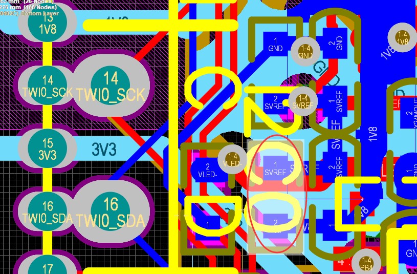

正常的启动信息是这样的,
DRAM: 0 MiB 看起来是硬件有问题, 没有检测到 DRAM ?
是。坏电容C60。
SVREF_C60
20181002183225
PCB显示R45,C60位于上方。

smartcar wrote:
没测过, 看到Q群别的网友测过V3s核心板, 20mA@5.0V
20 mA @ 5V看起来很低。我刚刚测量了我的电路板 (@ 5V, SD-card):
  • Uboot加载110-120 mA
  • 以太网初始化:180-210 mA
  • 正常工作(启用以太网):140-180 mA
@晕哥。注意到你有V3S定制板,你能测量1.8 V和1.2 V的电流吗?
