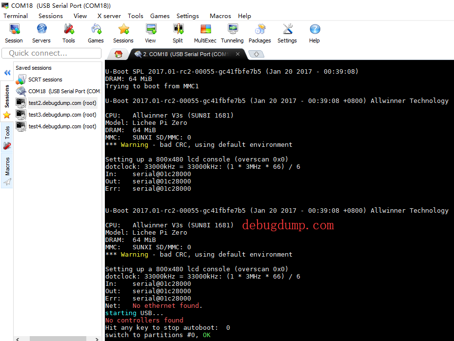

针对Lichee Pi Zero的Debian问题。
我想在Lichee Pi Zero上运行Debian,来源:https://licheepizero.us/ 8. [Downloads]。但是所有图像都会出现以下错误:
U-Boot SPL 2017.01-rc2-00055-gc41fbfe7b5 (Jan 20 2017 - 00:39:08)
DRAM: 0 MiB
任何经过测试的SD卡图片?

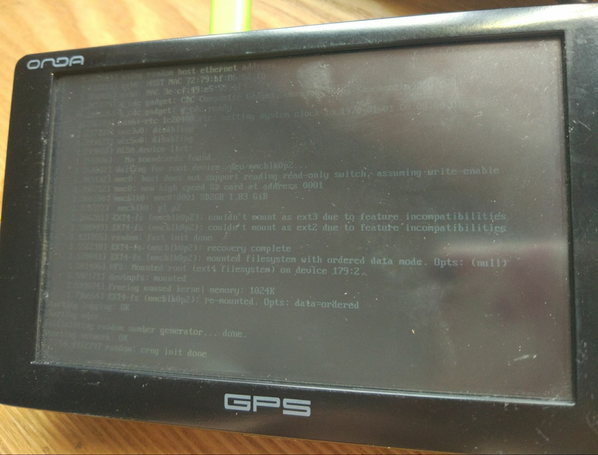

#2 2018-10-02 08:45:13
已发帖子: 9,442
Re: 针对Lichee Pi Zero的Debian问题。
DRAM: 64 MiB
Trying to boot from MMC1
U-Boot 2017.01-rc2-00055-gc41fbfe7b5 (Jan 20 2017 - 00:39:08 +0800) Allwinner Te                                                                             chnology
Model: Lichee Pi Zero
DRAM:  64 MiB
MMC:   SUNXI SD/MMC: 0
In:    serial@01c28000
Out:   serial@01c28000
Err:   serial@01c28000
DRAM:  64 MiB
In:    serial@01c28000
Net:   No ethernet found.
starting USB...
No controllers found
switch to partitions #0, OK
mmc0 is current device
Scanning mmc 0:1...
Found U-Boot script /boot.scr
reading /boot.scr
292 bytes read in 16 ms (17.6 KiB/s)
reading zImage
3987024 bytes read in 655 ms (5.8 MiB/s)
9262 bytes read in 28 ms (322.3 KiB/s)
   Loading Device Tree to 42dfa000, end 42dff42d ... OK
[    0.000000] Linux version 4.10.2-licheepi-zero+ (zp@ubuntu) (gcc version 6.3.1 20170109 (Linaro GCC 6.3-2017.02) ) #15 SMP Sat Apr 15 21:38:23 CST 2017
[    0.000000] OF: fdt:Machine model: Lichee Pi Zero with Dock

[    1.369155] sun6i-rtc 1c20400.rtc: setting system clock to 1970-01-01 00:00:12 UTC (12)
[    1.381007] vcc5v0: disabling
[    1.387472] ALSA device list:
[    1.393721]   #0: V3s Audio Codec
[    1.402019] EXT4-fs (mmcblk0p2): couldn't mount as ext3 due to feature incompatibilities
[    1.415078] EXT4-fs (mmcblk0p2): couldn't mount as ext2 due to feature incompatibilities
[    1.430785] mmc1: new high speed SDIO card at address 0001
[    1.478521] random: fast init done
[    1.709675] random: crng init done
[    4.101521] EXT4-fs (mmcblk0p2): recovery complete
[    4.130481] EXT4-fs (mmcblk0p2): mounted filesystem with ordered data mode. Opts: (null)
[    4.141875] VFS: Mounted root (ext4 filesystem) on device 179:2.
[    4.161077] devtmpfs: mounted
[    4.168668] Freeing unused kernel memory: 1024K
[    4.499261] systemd[1]: RTC configured in localtime, applying delta of 480 minutes to system time.
[    4.523503] systemd[1]: systemd 215 running in system mode. (+PAM +AUDIT +SELINUX +IMA +SYSVINIT +LIBCRYPTSETUP +GCRYPT +ACL +XZ -SECCOMP -APPARMOR)
[    4.544278] systemd[1]: Detected architecture 'arm'.
[    4.639521] systemd[1]: Failed to insert module 'autofs4'
[    4.648857] systemd[1]: Failed to insert module 'ipv6'
[    4.672185] systemd[1]: Set hostname to <licheepi>.
[    5.284713] systemd[1]: Starting Forward Password Requests to Wall Directory Watch.
[    5.296880] systemd[1]: Started Forward Password Requests to Wall Directory Watch.
[    5.308323] systemd[1]: Expecting device dev-ttyS0.device...
[    5.321874] systemd[1]: Starting Remote File Systems (Pre).
[    5.334977] systemd[1]: Reached target Remote File Systems (Pre).
[    7.055402] r8723bs: loading out-of-tree module taints kernel.
[    7.075256] RTL8723BS: module init start
[    7.082134] RTL8723BS: rtl8723bs v4.3.5.5_12290.20140916_BTCOEX20140507-4E40
[    7.092049] RTL8723BS: rtl8723bs BT-Coex version = BTCOEX20140507-4E40
[    7.102512] pnetdev = c31d8000
[    7.155216] RTL8723BS: rtw_ndev_init(wlan0)
[    7.180137] RTL8723BS: module init ret =0
[    7.244716] systemd-udevd[89]: starting version 215
[    7.653647] EXT4-fs (mmcblk0p2): re-mounted. Opts: (null)
[    8.493048] Adding 131068k swap on /swap.  Priority:-1 extents:2 across:139260k SS
[    8.562660] ns2009: module license 'unspecified' taints kernel.
[    8.562665] Disabling lock debugging due to kernel taint
[    8.562764] ns2009: Unknown symbol devm_kmalloc (err 0)
[    9.246994] FAT-fs (mmcblk0p1): Volume was not properly unmounted. Some data may be corrupt. Please run fsck.
[    9.879675] systemd-journald[82]: Received request to flush runtime journal from PID 1
[   15.923648] rtl8723bs: accquire FW from file:rtlwifi/rtl8723bs_nic.bin
Debian GNU/Linux 8 licheepi ttyS0
licheepi login: [   20.077981] RTL8723BS: nolinked power save enter
licheepi login: licheepi
Password:
Last login: Tue Jun 20 09:09:42 CST 2017 from desktop-xxxx.lan on pts/0

正常的启动信息是这样的,
DRAM: 0 MiB 看起来是硬件有问题, 没有检测到 DRAM ?

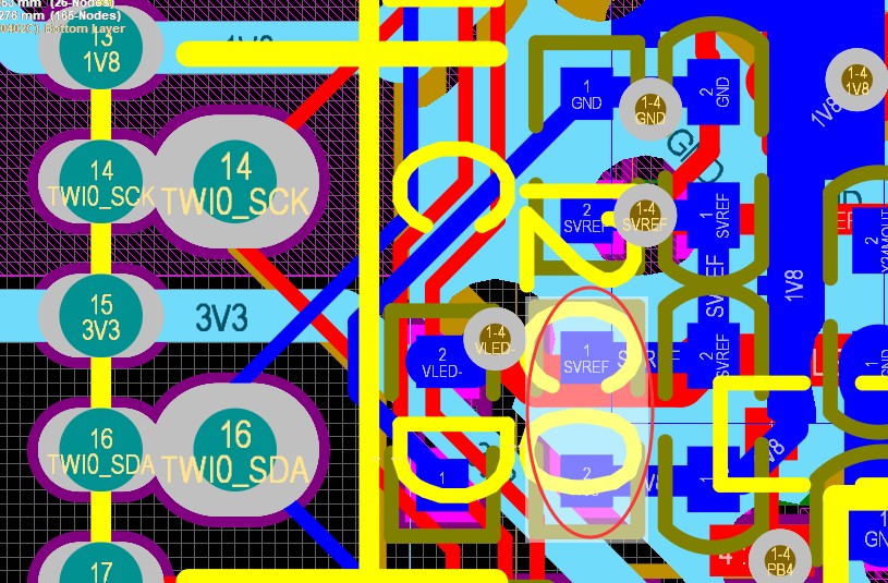

是。坏电容C60。
SVREF_C60
20181002183225
PCB显示R45,C60位于上方。
我按上面的流程走一遍,一切正常!

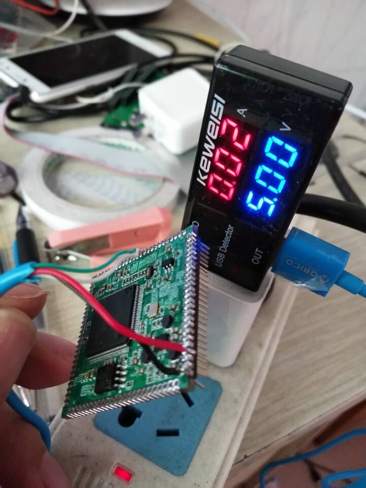

您还拥有3.3 V,1.8 V和1.2 V的V3S最大功率电流 ?

20 mA @ 5V看起来很低。我刚刚测量了我的电路板 (@ 5V, SD-card):
-  Uboot加载110-120 mA
- 以太网初始化:180-210 mA
- 正常工作(启用以太网):140-180 mA
@晕哥。注意到你有V3S定制板,你能测量1.8 V和1.2 V的电流吗?

改天我测一下电流.
