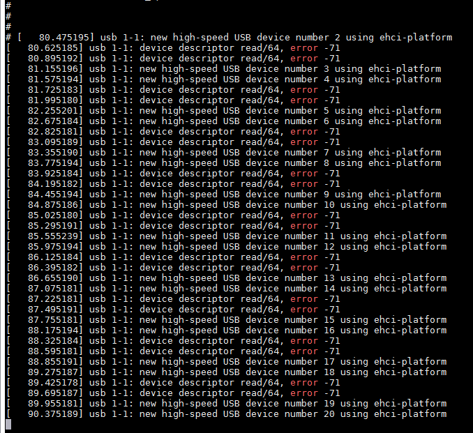

#53 Re: 全志 SOC » 有一个u盘, s3c2416和电脑都可以读写, 但是用V3s不能读写 » 2018-03-15 18:03:57
看来3楼的办法只可以解决一部分问题, 不能解决全部的问题。
#54 Re: 全志 SOC » 有一个u盘, s3c2416和电脑都可以读写, 但是用V3s不能读写 » 2018-03-15 17:45:40
我这里5个U盘, 3个OK, 还有两个插上去控制台毛反应都没有,U盘在电脑都是正常的。
感觉要成背锅侠了。

#69 全志 SOC » 有一个u盘, s3c2416和电脑都可以读写, 但是用V3s不能读写 » 2018-03-06 15:57:49
F1F2
回复: 8
[   80.475195] usb 1-1: new high-speed USB device number 2 using ehci-platform
[   80.625185] usb 1-1: device descriptor read/64, error -71
[   80.895192] usb 1-1: device descriptor read/64, error -71
[   81.155196] usb 1-1: new high-speed USB device number 3 using ehci-platform
[   81.575194] usb 1-1: new high-speed USB device number 4 using ehci-platform
[   81.725183] usb 1-1: device descriptor read/64, error -71
[   81.995180] usb 1-1: device descriptor read/64, error -71
[   82.255201] usb 1-1: new high-speed USB device number 5 using ehci-platform
[   82.675184] usb 1-1: new high-speed USB device number 6 using ehci-platform
[   82.825181] usb 1-1: device descriptor read/64, error -71
[   83.095189] usb 1-1: device descriptor read/64, error -71
[   83.355190] usb 1-1: new high-speed USB device number 7 using ehci-platform
[   83.775194] usb 1-1: new high-speed USB device number 8 using ehci-platform
[   83.925184] usb 1-1: device descriptor read/64, error -71
[   84.195182] usb 1-1: device descriptor read/64, error -71
[   84.455194] usb 1-1: new high-speed USB device number 9 using ehci-platform
[   84.875186] usb 1-1: new high-speed USB device number 10 using ehci-platform
[   85.025180] usb 1-1: device descriptor read/64, error -71
[   85.295191] usb 1-1: device descriptor read/64, error -71
[   85.555239] usb 1-1: new high-speed USB device number 11 using ehci-platform
[   85.975194] usb 1-1: new high-speed USB device number 12 using ehci-platform
[   86.125184] usb 1-1: device descriptor read/64, error -71
[   86.395182] usb 1-1: device descriptor read/64, error -71
[   86.655190] usb 1-1: new high-speed USB device number 13 using ehci-platform
[   87.075181] usb 1-1: new high-speed USB device number 14 using ehci-platform
[   87.225181] usb 1-1: device descriptor read/64, error -71
[   87.495191] usb 1-1: device descriptor read/64, error -71
[   87.755181] usb 1-1: new high-speed USB device number 15 using ehci-platform
[   88.175194] usb 1-1: new high-speed USB device number 16 using ehci-platform
[   88.325184] usb 1-1: device descriptor read/64, error -71
[   88.595181] usb 1-1: device descriptor read/64, error -71
[   88.855191] usb 1-1: new high-speed USB device number 17 using ehci-platform
[   89.275187] usb 1-1: new high-speed USB device number 18 using ehci-platform
[   89.425178] usb 1-1: device descriptor read/64, error -71
[   89.695187] usb 1-1: device descriptor read/64, error -71
[   89.955181] usb 1-1: new high-speed USB device number 19 using ehci-platform
[   90.375189] usb 1-1: new high-speed USB device number 20 using ehci-platform
[   90.525182] usb 1-1: device descriptor read/64, error -71
[   90.795178] usb 1-1: device descriptor read/64, error -71
[   91.055193] usb 1-1: new high-speed USB device number 21 using ehci-platform
[   91.475188] usb 1-1: new high-speed USB device number 22 using ehci-platform
[   91.625182] usb 1-1: device descriptor read/64, error -71
[   91.895191] usb 1-1: device descriptor read/64, error -71
[   92.155179] usb 1-1: new high-speed USB device number 23 using ehci-platform
[   92.575191] usb 1-1: new high-speed USB device number 24 using ehci-platform
[   92.725186] usb 1-1: device descriptor read/64, error -71
[   92.995181] usb 1-1: device descriptor read/64, error -71
[   93.255190] usb 1-1: new high-speed USB device number 25 using ehci-platform
[   93.675185] usb 1-1: new high-speed USB device number 26 using ehci-platform
[   93.825181] usb 1-1: device descriptor read/64, error -71
[   94.095188] usb 1-1: device descriptor read/64, error -71
有一个u盘, s3c2416和电脑都可以读写, 但是用V3s出现这个提示,
格过了, 还是不行
供电应该没有问题,
另一个U盘正常。
有没有办法解决?
