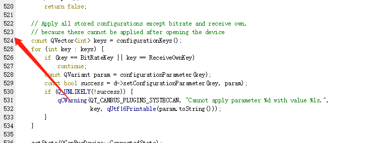

#16 Re: Nuvoton N32905/N32926/NUC972/N9H20/N9H26/N9H30 » qt编写了个界面,尝试打开关闭972的can,结果关闭时提示:Can not disconnect an unconnected devic » 2020-04-28 10:24:56
// Apply all stored configurations except bitrate and receive own,
    // because these cannot be applied after opening the device
