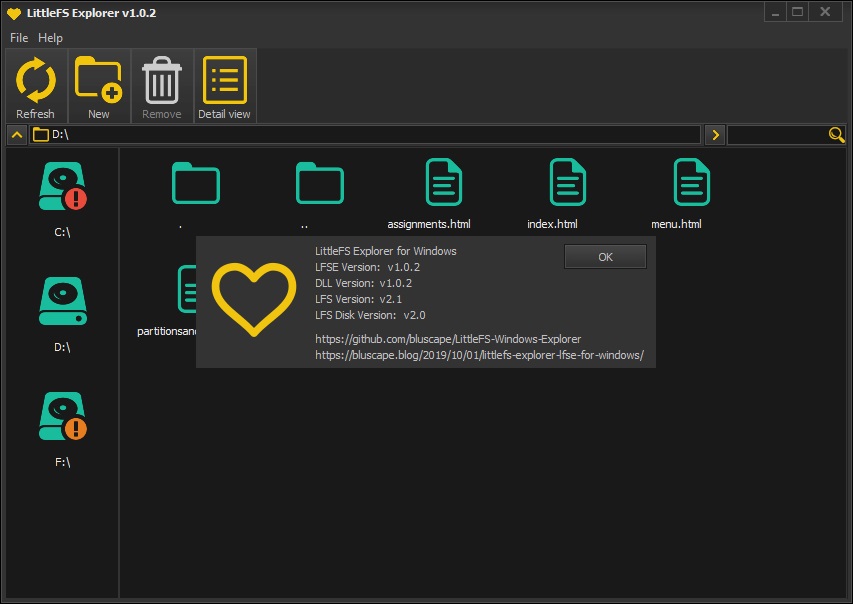

#15 计算机图形/GUI/RTOS/FileSystem/OpenGL/DirectX/SDL2 » 分享LittleFS工具:LittleFS Explorer (LFSE) for Windows » 2020-04-22 08:35:17
fane
回复: 3
https://bluscape.blog/2019/10/01/littlefs-explorer-lfse-for-windows/
The only problem I had with LFS is that I could not edit the file system in a Windows environment because it is not recognized by Windows. There is a FUSE driver for Linux, but I’m developing under Windows, so I needed an interface from where I could format the SD card to LFS, browse, edit, add and remove files. So I decided to write a file explorer for LFS in Windows.
LittleFS
