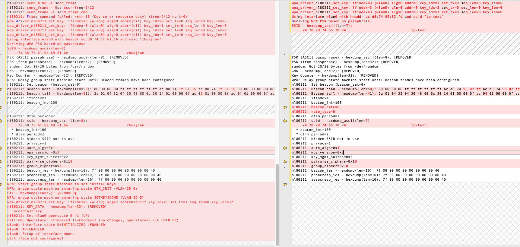

#1 全志 SOC » 求助nano esp8089 AP模式卡主 » 2020-04-16 19:03:06
549531610@qq.com
回复: 0
系统是 Linux version 4.15.0-rc8-licheepi-nano
找不到可以直接用的esp8089固件
编译的这个esp8089的固件
https://github.com/jiangming1399/esp8089/tree/nano-4.15
联网模式成功
modprobe esp8089.ko config=crystal_26M_en=1
ifconfig wlan0 up
wpa_supplicant -B -d -i wlan0 -c /etc/wpa_supplicant.conf
udhcpc -i wlan0
AP模式卡住了
hostapd配置
/etc/hostapd.conf
interface=wlan0
driver=nl80211
ssid=tp-text
hw_mode=g
channel=6
wpa=2
wpa_passphrase=12345678
wpa_key_mgmt=WPA-PSK
wpa_pairwise=TKIP
rsn_pairwise=CCMP
auth_algs=3
macaddr_acl=0
命令
ifconfig wlan0 up && ifconfig wlan0 172.16.1.1  netmask 255.255.255.0 && route add default gw 172.16.1.1 && route add default gw 172.16.1.111 &&echo 1 > /proc/sys/net/ipv4/ip_forward && ifconfig
hostapd -d -B /etc/hostapd.conf

Completing interface initialization
Mode: IEEE 802.11g  Channel: 6  Frequency: 2437 MHz
DFS 0 channels required radar detection
nl80211: Set freq 2437 (ht_enabled=0, vht_enabled=0, bandwidth=20 MHz, cf1=2437 MHz, cf2=0 MHz)
  * freq=2437
  * vht_enabled=0
  * ht_enabled=0
  * channel_type=0
RATE[0] rate=10 flags=0x1
RATE[1] rate=20 flags=0x1
RATE[2] rate=55 flags=0x1
RATE[3] rate=110 flags=0x1
RATE[4] rate=60 flags=0x0
RATE[5] rate=90 flags=0x0
RATE[6] rate=120 flags=0x0
RATE[7] rate=180 flags=0x0
RATE[8] rate=240 flags=0x0
RATE[9] rate=360 flags=0x0
RATE[10] rate=480 flags=0x0
RATE[11] rate=540 flags=0x0
hostapd_setup_bss(hapd=0xb6f312c0 (wlan0), first=1)
wlan0: Flushing old station entries
nl80211: flush -> DEL_STATION wlan0 (all)
wlan0: Deauthenticate all stations
nl80211: send_mlme - da= ff:ff:ff:ff:ff:ff noack=0 freq=0 no_cck=0 offchanok=0 wait_time=0 fc=0xc0 (WLAN_FC_STYPE_DEAUTH) nlmode=3
nl80211: send_mlme -> send_frame
nl80211: send_frame - Use bss->freq=2437
nl80211: send_frame -> send_frame_cmd
nl80211: Frame command failed: ret=-16 (Resource busy) (freq=2437 wait=0)
wpa_driver_nl80211_set_key: ifindex=3 (wlan0) alg=0 addr=0 key_idx=0 set_tx=0 seq_len=0 key_len=0
wpa_driver_nl80211_set_key: ifindex=3 (wlan0) alg=0 addr=0 key_idx=1 set_tx=0 seq_len=0 key_len=0
wpa_driver_nl80211_set_key: ifindex=3 (wlan0) alg=0 addr=0 key_idx=2 set_tx=0 seq_len=0 key_len=0
wpa_driver_nl80211_set_key: ifindex=3 (wlan0) alg=0 addr=0 key_idx=3 set_tx=0 seq_len=0 key_len=0
Using interface wlan0 with hwaddr ac:d0:74:95:02:fd and ssid "tp-text"
Deriving WPA PSK based on passphrase
SSID - hexdump_ascii(len=7):
     74 70 2d 74 65 78 74                              tp-text
PSK (ASCII passphrase) - hexdump_ascii(len=8): [REMOVED]
PSK (from passphrase) - hexdump(len=32): [REMOVED]
random: Got 20/20 bytes from /dev/random
GMK - hexdump(len=32): [REMOVED]
Key Counter - hexdump(len=32): [REMOVED]
WPA: Delay group state machine start until Beacon frames have been configured
nl80211: Set beacon (beacon_set=0)
nl80211: Beacon head - hexdump(len=58): 80 00 00 00 ff ff ff ff ff ff ac d0 74 95 02 fd ac d0 74 95 02 fd 00 00 00 00 00 00 00 00 00 00 64 00 11 04 00 07 74 70 2d 74 65 78 74 01 08 82 84 8b 96 0c 12 18 24 03 01 06
nl80211: Beacon tail - hexdump(len=41): 2a 01 04 32 04 30 48 60 6c 30 14 01 00 00 0f ac 04 01 00 00 0f ac 04 01 00 00 0f ac 02 00 00 7f 08 00 00 00 00 00 00 00 40
nl80211: ifindex=3
nl80211: beacon_int=100
nl80211: beacon_rate=0
nl80211: rate_type=0
nl80211: dtim_period=2
nl80211: ssid - hexdump_ascii(len=7):
  * beacon_int=100
  * dtim_period=2
nl80211: hidden SSID not in use
nl80211: privacy=1
nl80211: auth_algs=0x3
nl80211: wpa_version=0x2
nl80211: key_mgmt_suites=0x2
nl80211: pairwise_ciphers=0x10
nl80211: group_cipher=0x10
nl80211: beacon_ies - hexdump(len=10): 7f 08 00 00 00 00 00 00 00 40
nl80211: proberesp_ies - hexdump(len=10): 7f 08 00 00 00 00 00 00 00 40
nl80211: assocresp_ies - hexdump(len=10): 7f 08 00 00 00 00 00 00 00 40
对比个帖子的日志: https://whycan.cn/p_17130.html
