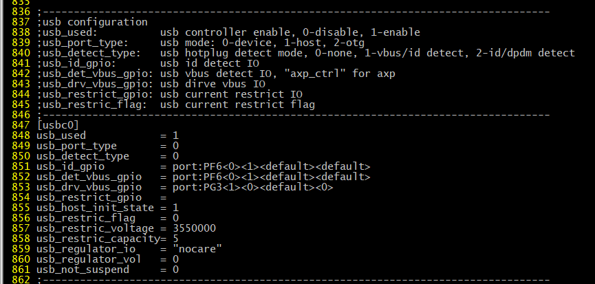

#4 Re: 全志 SOC » 分享个licheepi nano镜像,支持adb调试 » 2020-09-24 20:45:24
晕哥小弟 wrote:
/files/members/1569/20190829093543_20190829-1426.png
改了fex文件,但是还是没有任何反应。
dmesg有个
[   20.036504] gadget_is_softwinner_otg is not -int
[   20.036511] gadget_is_softwinner_otg is not -int
[   20.036531] g_serial gadget: Gadget Serial v2.4
[   20.042744] g_serial gadget: g_serial ready
@晕哥小弟 您好,我遇到和您一样的打印,gadget_is_softwinner_otg is not -int。请问您这个问题解决了没有?

#6 全志 SOC » 使用v3s的bsp内核,想实现usb device功能,尝试失败。主线内核是成功的。是我操作不对,还是bsp内核本身就有问题? » 2020-09-24 18:42:11
henman
回复: 0
我用这个内核https://github.com/Lichee-Pi/linux.git是成功的。
内核配置:Device Drivers->USB support-><*>USB Gadget Support-><M>USB Gadget precomposed configurations-><M>Serial Gadget (with CDC ACM and CDC OBEX support)
insmod g_serial.ko,出现以下打印。
[ 24.083787] g_serial gadget: Gadget Serial v2.4
[ 24.088484] g_serial gadget: g_serial ready
[ 24.469748] g_serial gadget: high-speed config #2: CDC ACM config
我用bsp内核,版本3.4,类似的操作后,出现以下打印。
[ 4316.436502] ep_matches, wrn: endpoint already claimed, ep(0xc048e3cc, 0xc2adde80, ep1in-bulk)
[ 4316.446037] ep_matches, wrn: endpoint already claimed, ep(0xc048e3cc, 0xc2adde80, ep1in-bulk)
[ 4316.455510] ep_matches, wrn: endpoint already claimed, ep(0xc048e418, 0xc2adde80, ep1out-bulk)
[ 4316.465075] gadget_is_softwinner_otg is not -int
[ 4316.470270] gadget_is_softwinner_otg is not -int
[ 4316.476705] g_serial gadget: Gadget Serial v2.4
[ 4316.481815] g_serial gadget: g_serial ready
不知道有没有小伙伴对这块了解,不吝指点一下呢?
